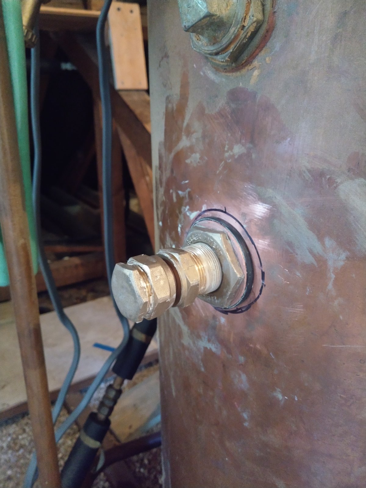

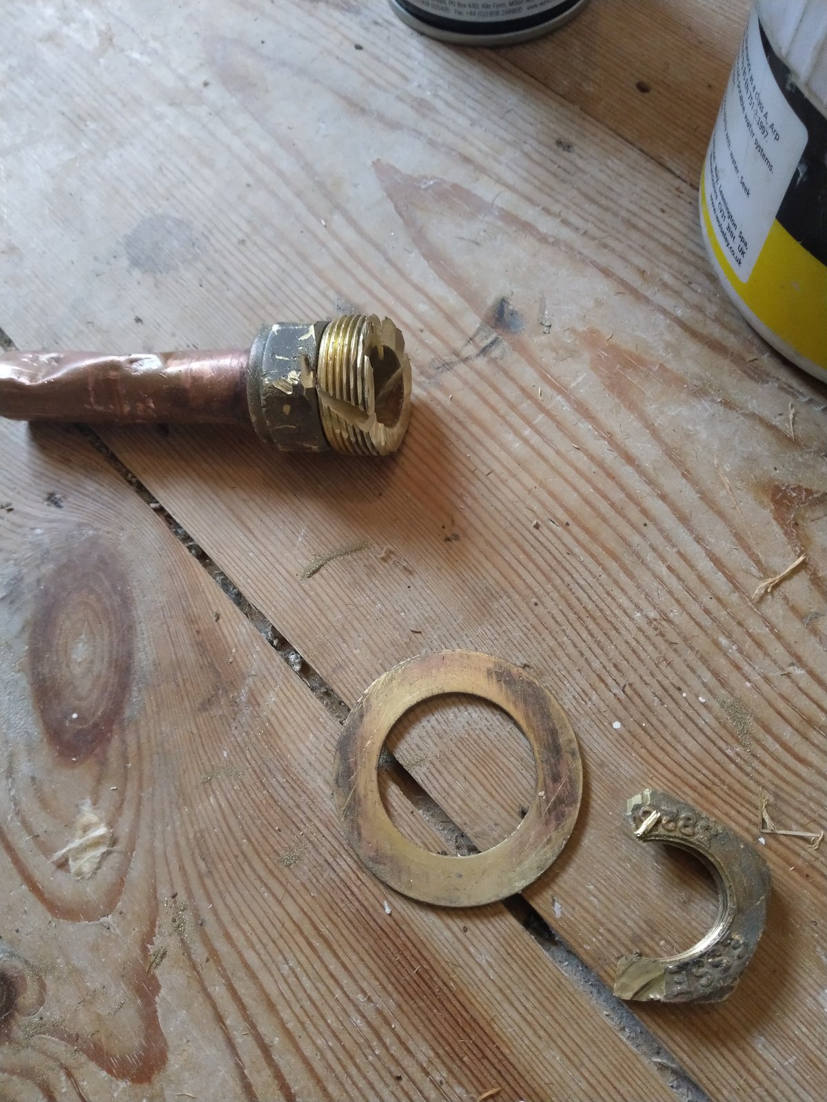

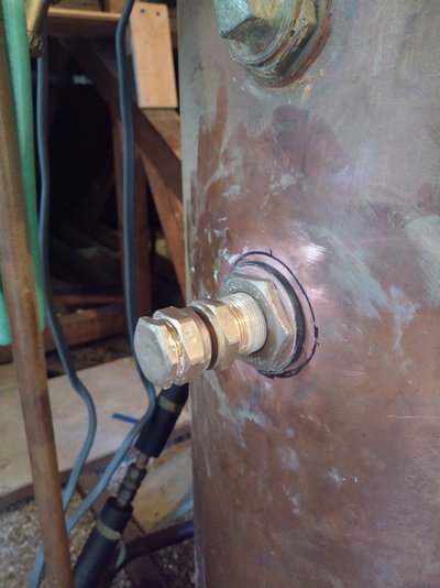

It is a flange. It has some kind of compound behind the nut that's dissolved. It's fitted from the inside before the top of the cylinder is soldered on, poxy piece of work!
I've got a new rubber seal for it but the threads are screwed! I have tried filing and cleaning it up but it's fooked!
New cylinder or possibly solder a plate over the hole????
What's worse is this outlet isn't even used!!!
and that's why I've build the new stud round it, it will be finished when the cylinder goes.
