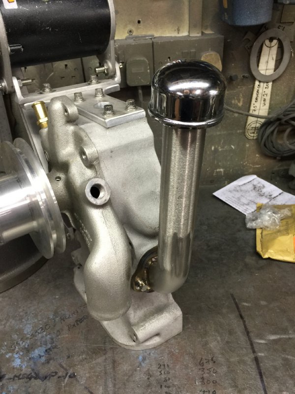

They are ARP 12 point stainless, probably the finest bolts around, they are incredibly strong and you only ever buy one bolt. They also come in chrome moly and are available imperial or metric.
I'm a dealer for ARP so like to use what I sell.
Stunning work as usual !!
Do you have a size list etc so I can put a shopping list together??

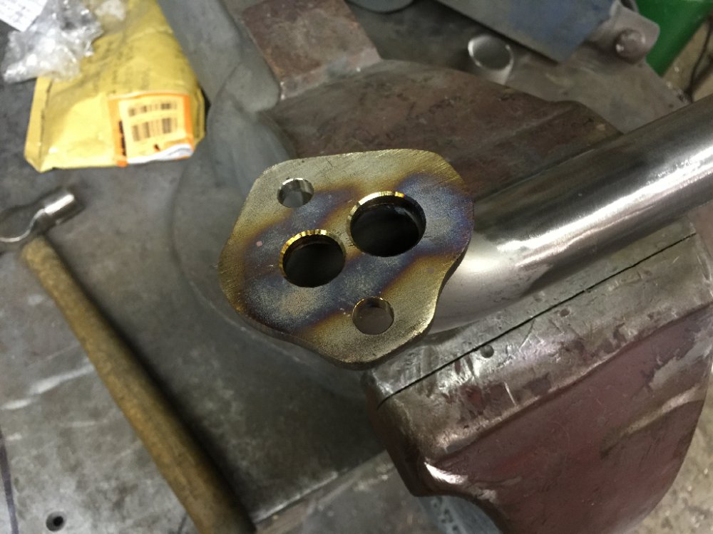

That tall breather tube should only let oil vapour out of breather and no oil.

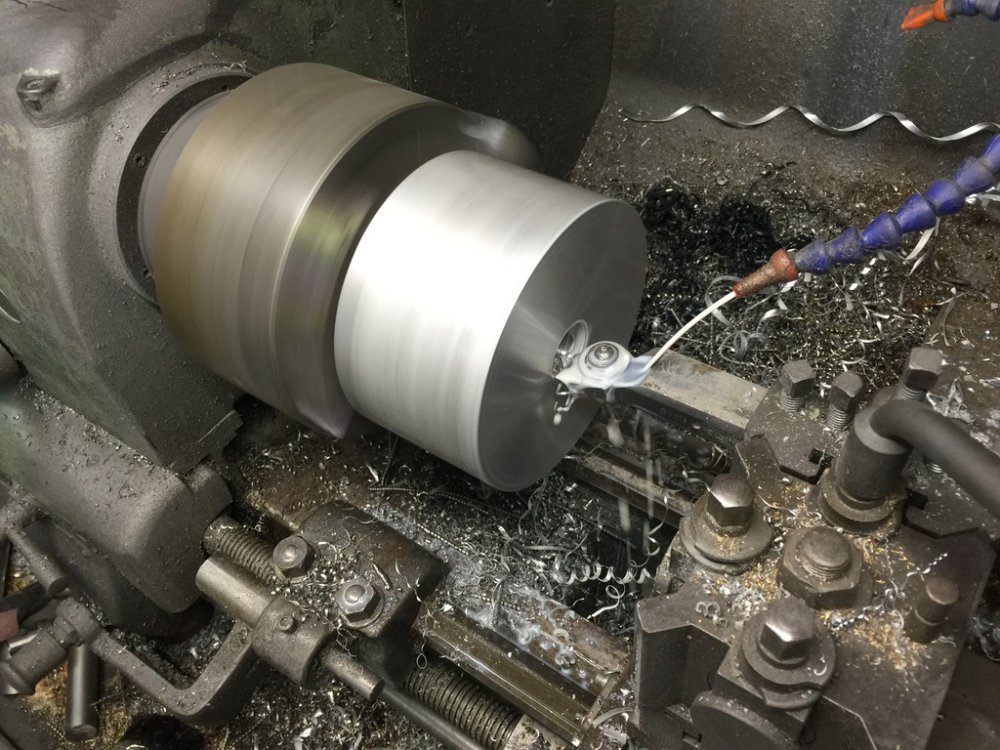

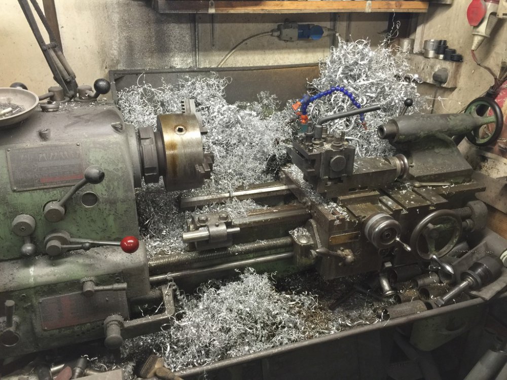

I would have stayed well clear with that lathe chuck spinning, i normally get slapped with a big ball of swarf when its full like that![]()
I like that breather tube idea, neat use of the redundant hole. Had a couple of Moroso breathers on a Rover engine linked the air filter, they leaked oil vapour constantly from the crimped lip underneath until I ran a bead of Sikaflex round them then they were fine.
