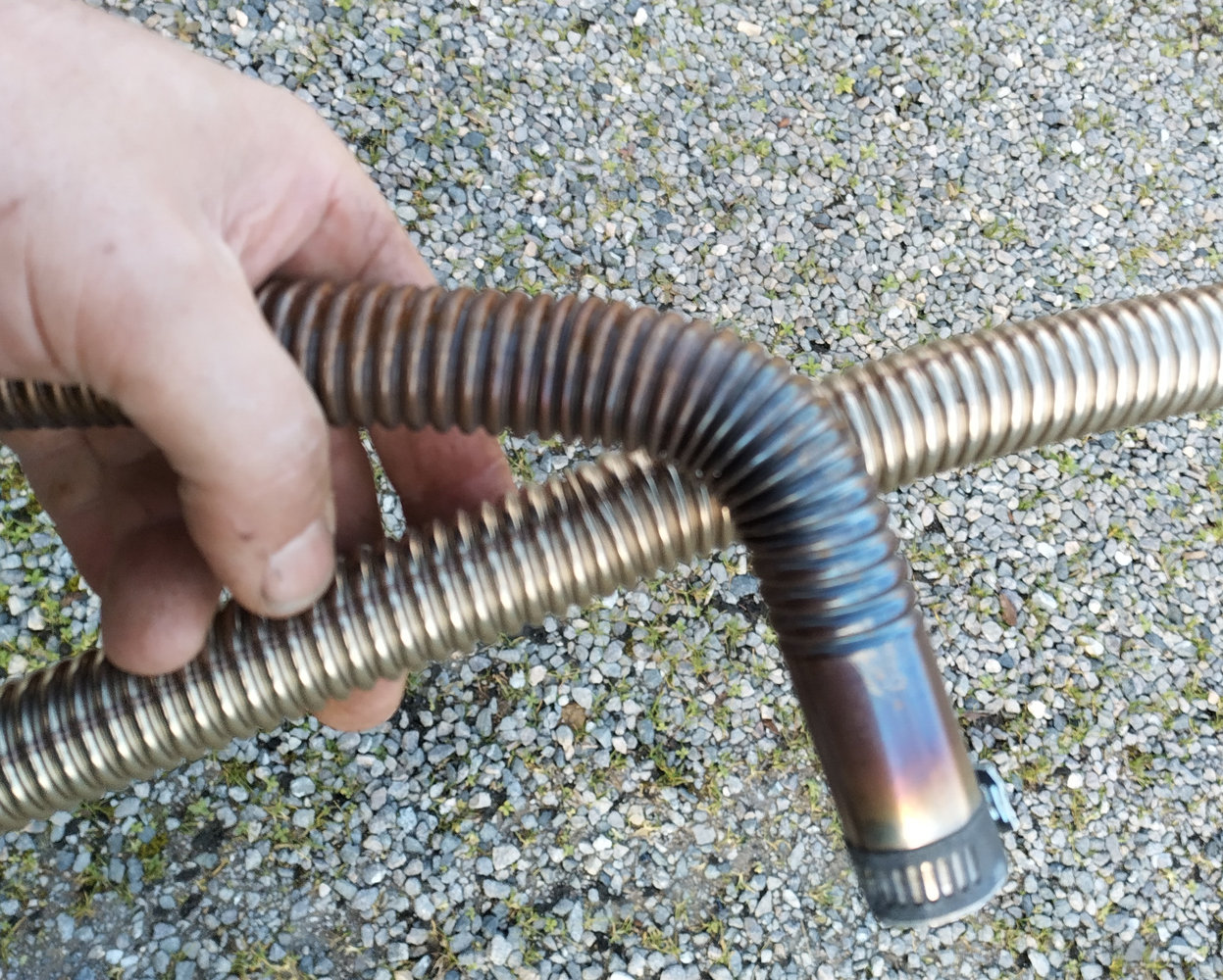

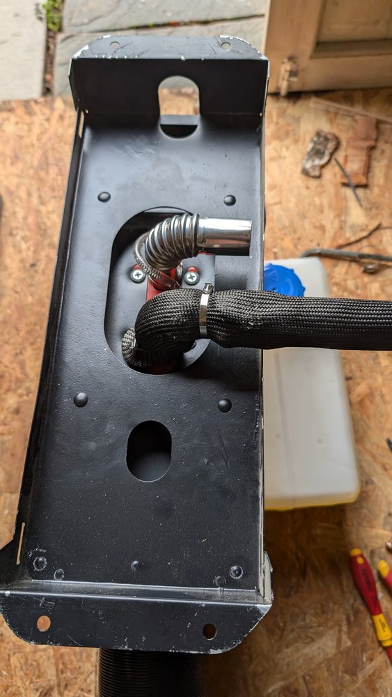

Just out of curiosity I have just put a thermocouple onto the exhaust of my workshop heater (it's been running flat out for an hour+). It shows 238degrees C. The colours on the pipe would tend to back this up, on the bend it is dark straw, the rest is light straw.
It's not accurate but it's a good indication.

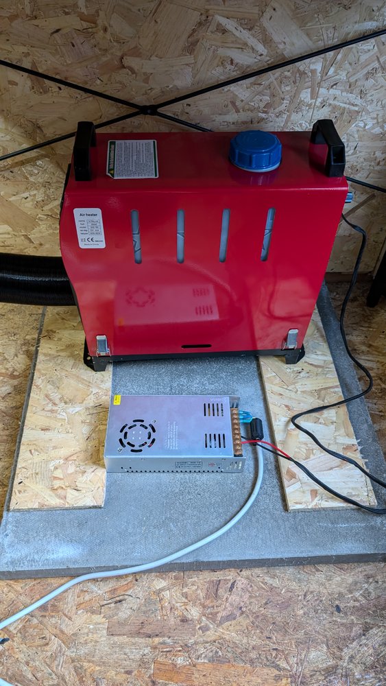

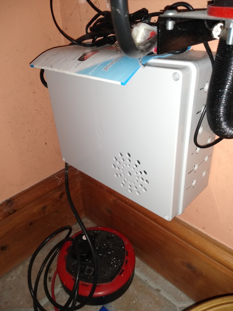

All joking aside the ventilated enclosure is a good idea I must get one for mine.
