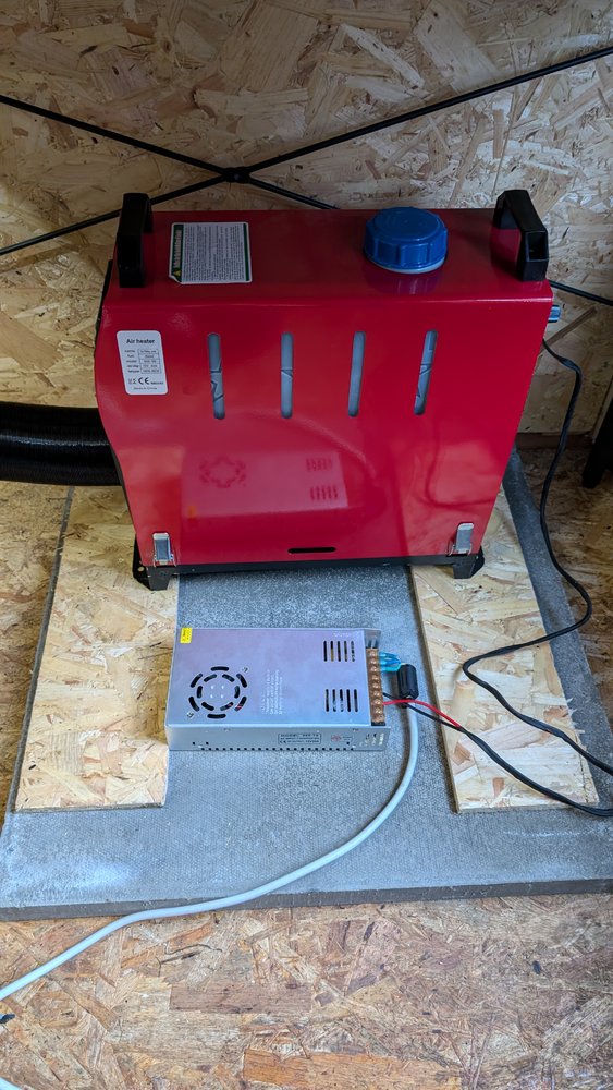

For various reasons I've gone this route for my garden office
Same style I had in the Disco, I wanted self contained to make install cheaper

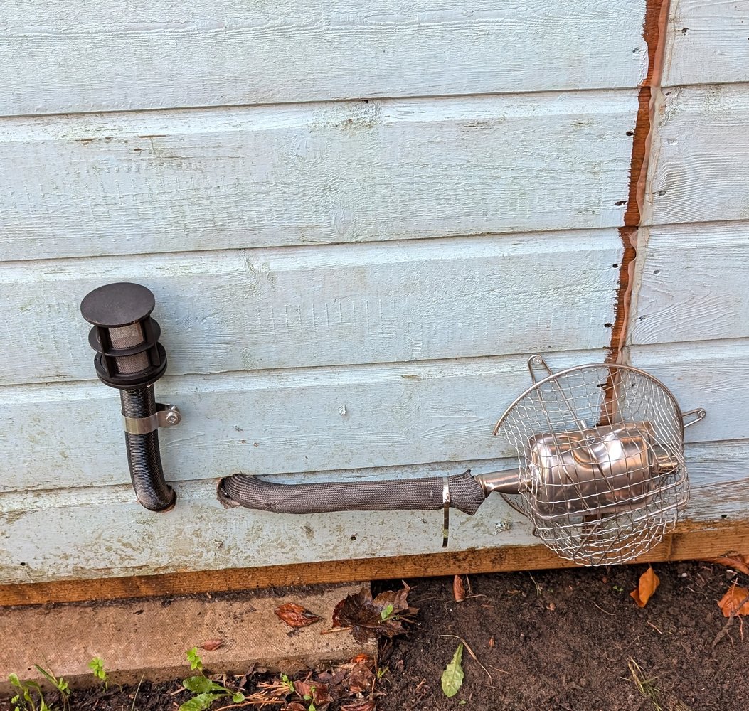

Wrapped the exhaust in 300 degc heat wrap, highest I've seen the burner is 205
Additional bit of wood is due to floor not being finished
Bit of finishing to do on the wall, but it's been on every day this week without issue
Exhaust is at cat height and there is a direct correlation between me having a quiet life and the cat not getting burned
Running on kero, will strip it down once the weather warms up to see how it's doing internally
