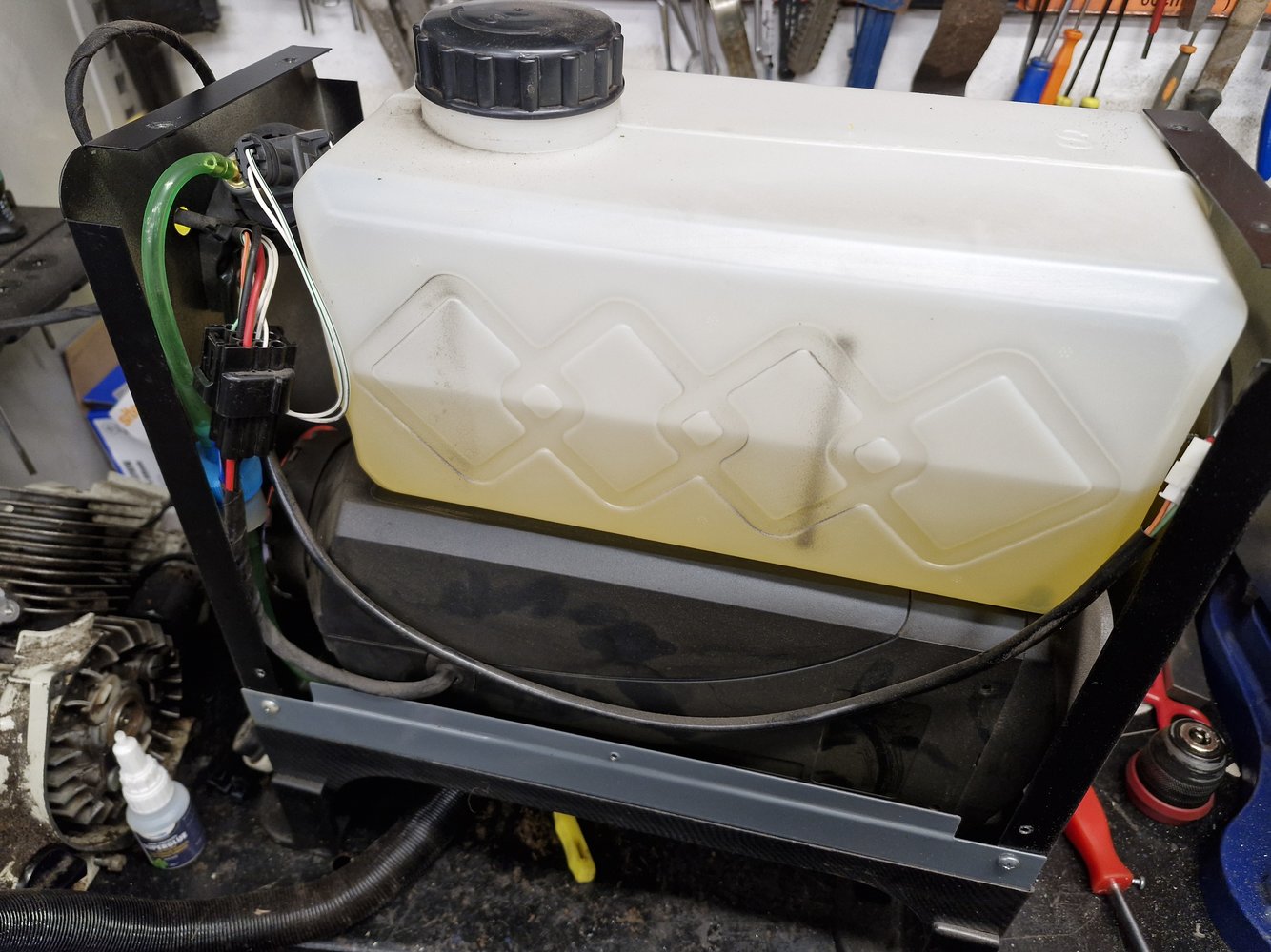

I've been avoiding commenting, as I know how these heaters should be installed, but a couple more minor points.
The 205degC reading, is from the heat sensor which is mounted on the outside of the heater body, not the actual burn temperature. In the dark, with them running at full power, you can usually see the exhaust pipe glowing dull red where it exits the heater, so at that point, it's a lot hotter than 205degC. However by the end of the stock exhaust, it's usually cool enough to not char any wood that it might happen to pass through.![]()
The air inlet should be pointed downwards to avoid any water/condensation running into the heater.
I was deliberately avoiding mentioning the insulation as I'm sure you'll be aware that if the stainless exhaust is glowing, then it's probably a bit hotter than the 300degC rated insulation.You neatly avoided mentioning the insulation as well

Is that a horrible kink in the exhaust pipe?
Same point about exhaust....ensure it has a downhill run - which it may well do.
At least this armchair sitter has a bit paper saying they've been trained to install and maintain mobile diesel heatersI'm sure your view of my install and indeed the exhaust is great from your armchair

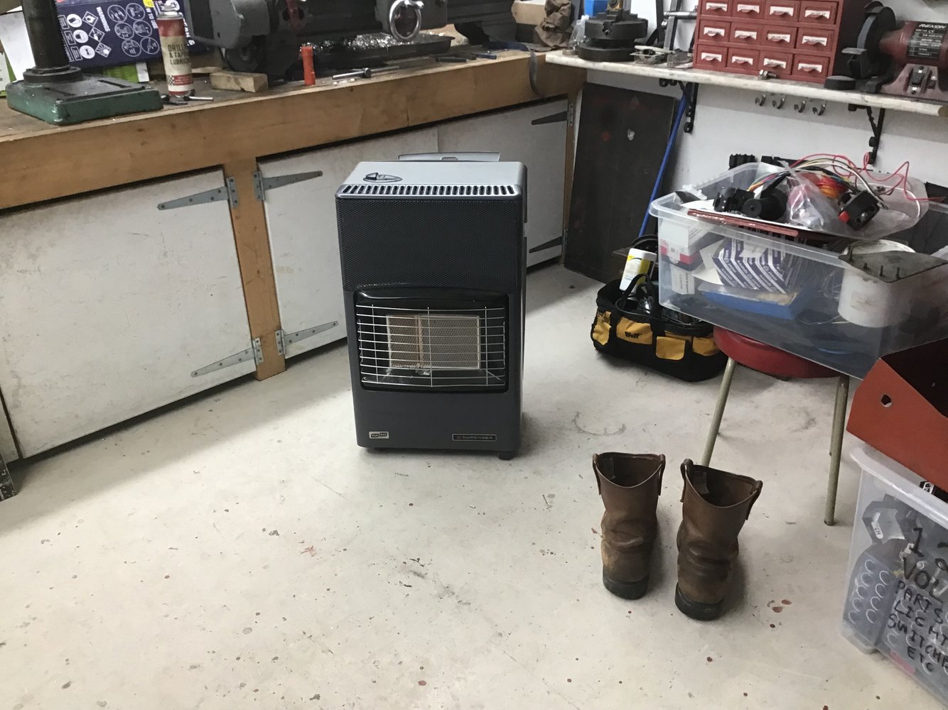

My workshop heater. I remember the days every household had one of these, but you never see them nowadays.
Ten minutes on medium setting and my workshop is like toast.
If I’d known about diesel heaters I’d probably have incorporated one while I was building the place.
