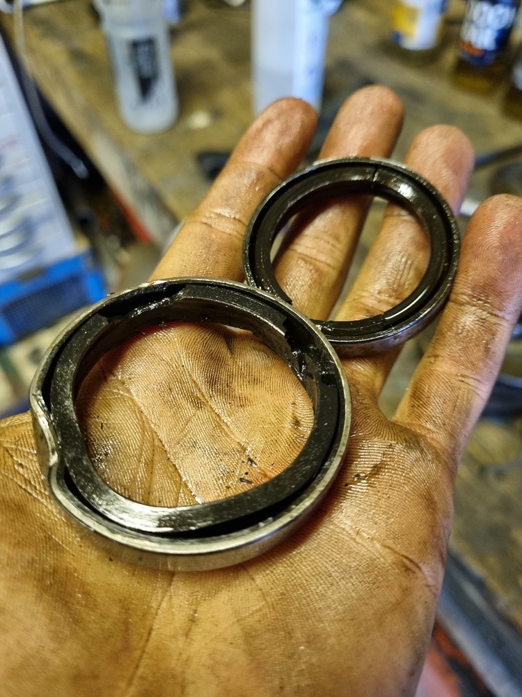

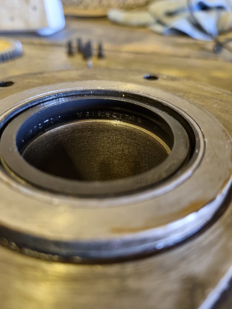

Looks like R4 is a single lip seal with a metal outer, R21 is single lip and rubber coated, sounds like it should be fine to swap them.

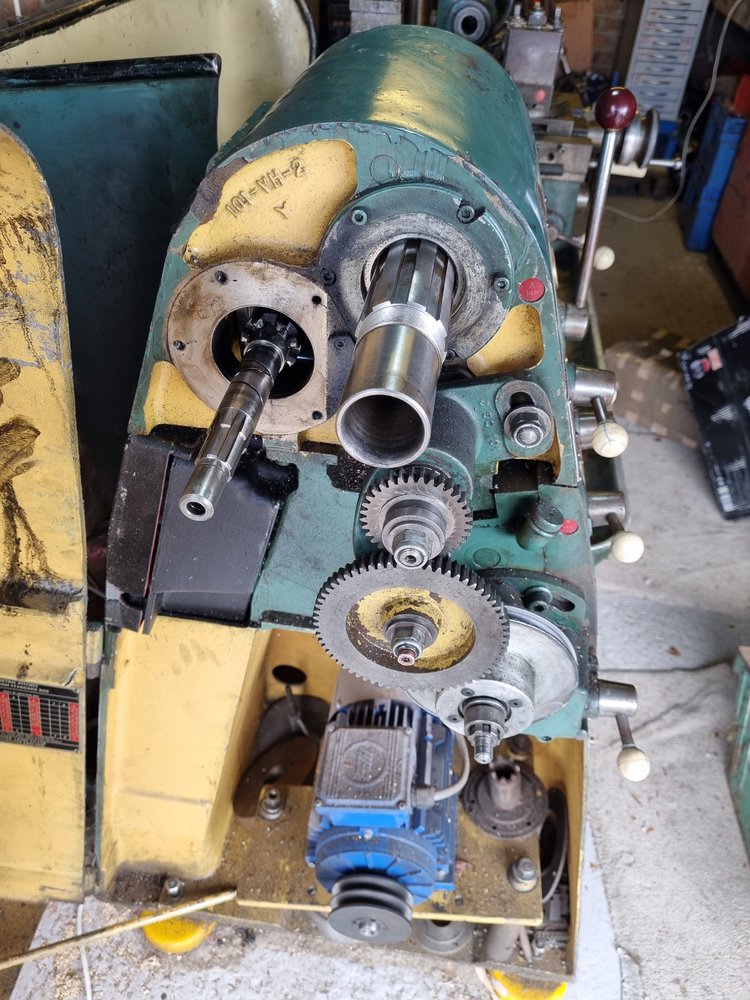

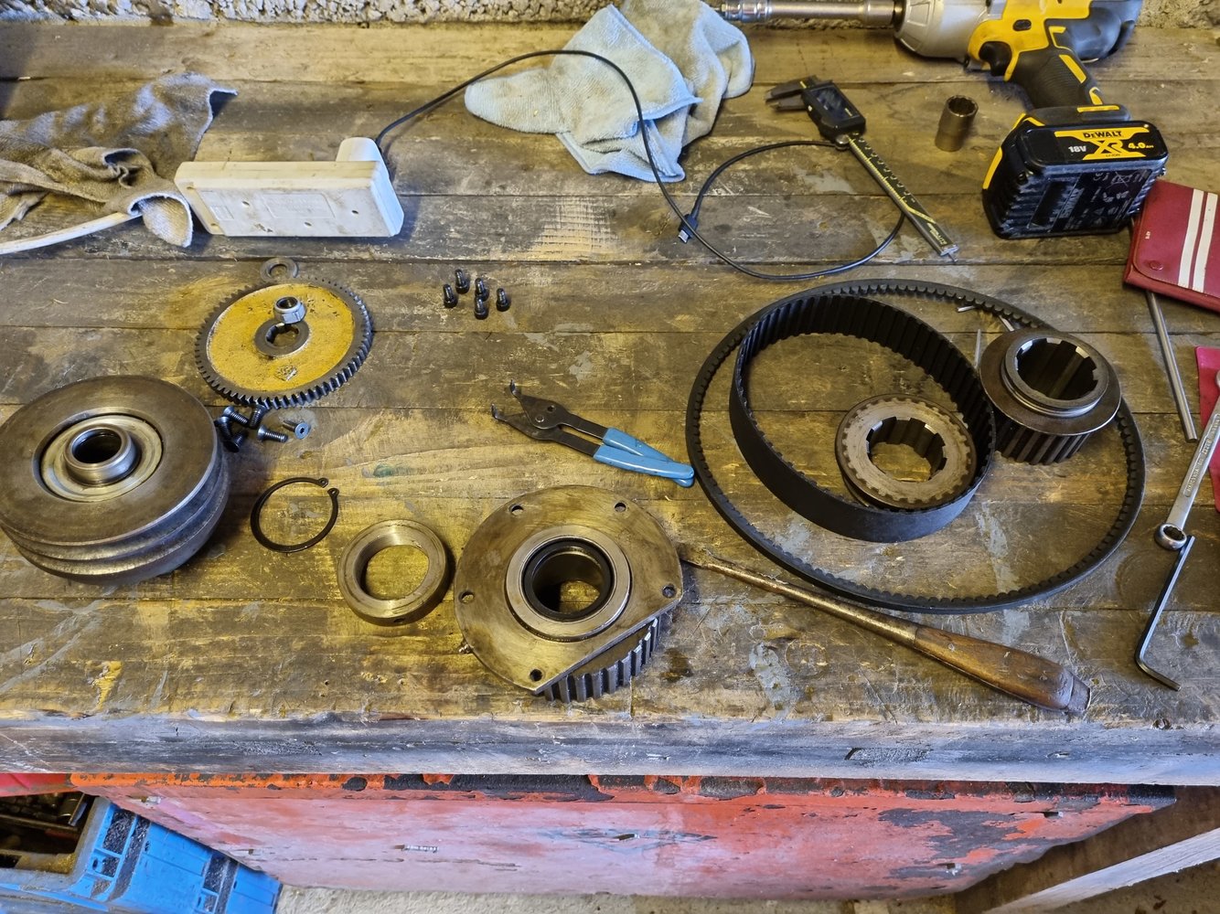

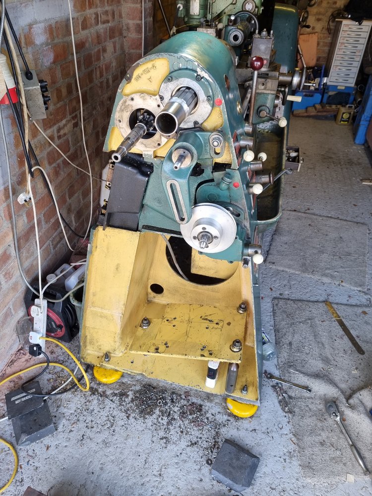

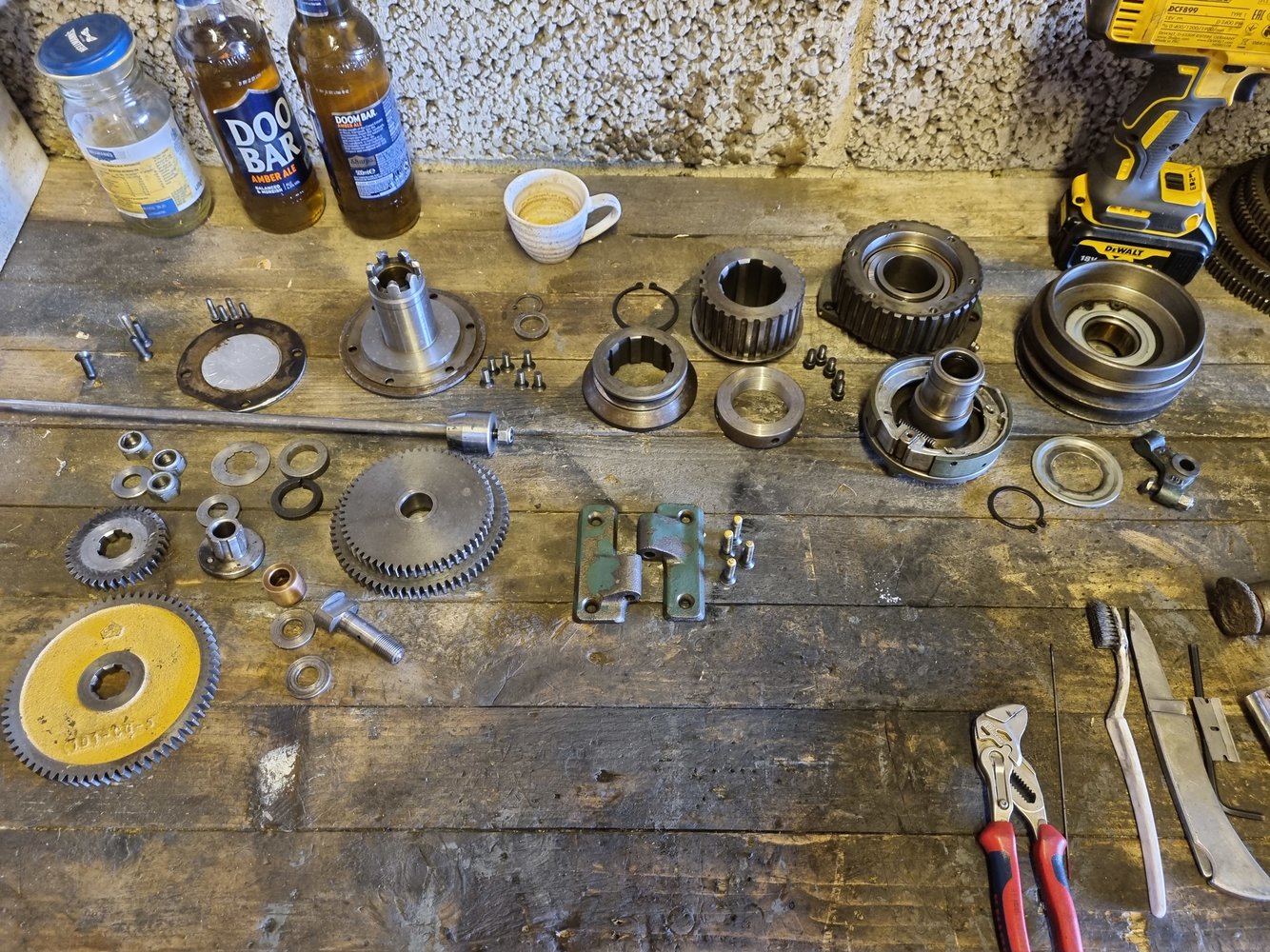

Flipping hell yours cracking on. Want to come do mine!Second seal was a pain in the ass to get to, I undid the six bolts in the last image and fought the big circlip off (Really should get some decent circlip pliers), couldn't pull the bearing off though, in the end had to modify an old C spanner to take off the headstock pulley in order to work the big drive belt off, which leaves just enough room to unbolt the pulley and clutch housing (Part 58 in the diagram, drawn backwards) as one complete unit, the seal sits on the back of it and is also listed incorrectly in the manual. It's labelled "C - Weston W21916237R4", Bearingboys have that one too.Five days delivery though, what am I gonna do without a lathe for a week!
I'll give it all a good clean before reassembling.
Hope your not having a cosy night in with your bird with them mitsNo wonder they leaked, the rubber has gone a bit brittle after 58 (I think?) years.
