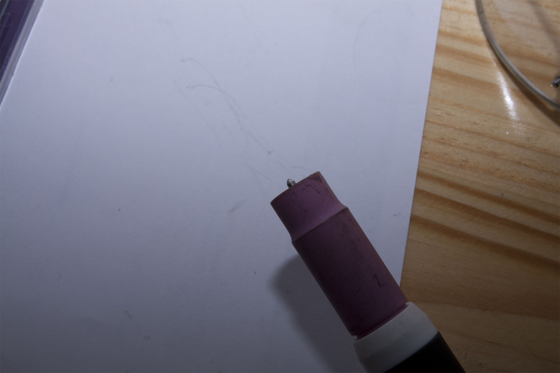

They only had green, grey and red tungstens so i got the grey.
Once i get started things are much easier than before if i loose the arc length it splutters a bit and i can tuck it back in and carry on, with the thinner tungsten it would ball.
But still cant get her to start.
Freshly prepped tungsten will start fine.
Scratching sometimes works.
Using the hot start will work but it leaves a nice ring of soot.

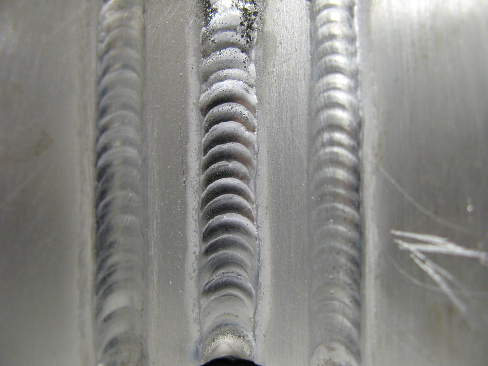

Hi Kai.Hi all,

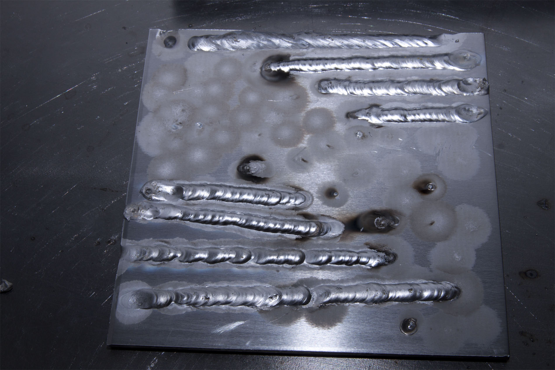

I was a little curious how the AC behavier of my old EWM was, so I made some testing today.
Here are the results:
I had the biggest problems with the start of the weld. Not the HF ignition (hotstart was at 2), but creating a nice shiny puddle. That took some time and I have to leave the arc on some point in the beginning to let the cleaning action doing the job at first. I don´t know how to do that on very thin material. I think that it would melt away..
If there is a shiny puddle, than going forward is not a problem.
My 2.4 elektrodes are to small for something like 150A AC the ball is around 3mm diameter.
I will have to try 3.2 (blue or gold)

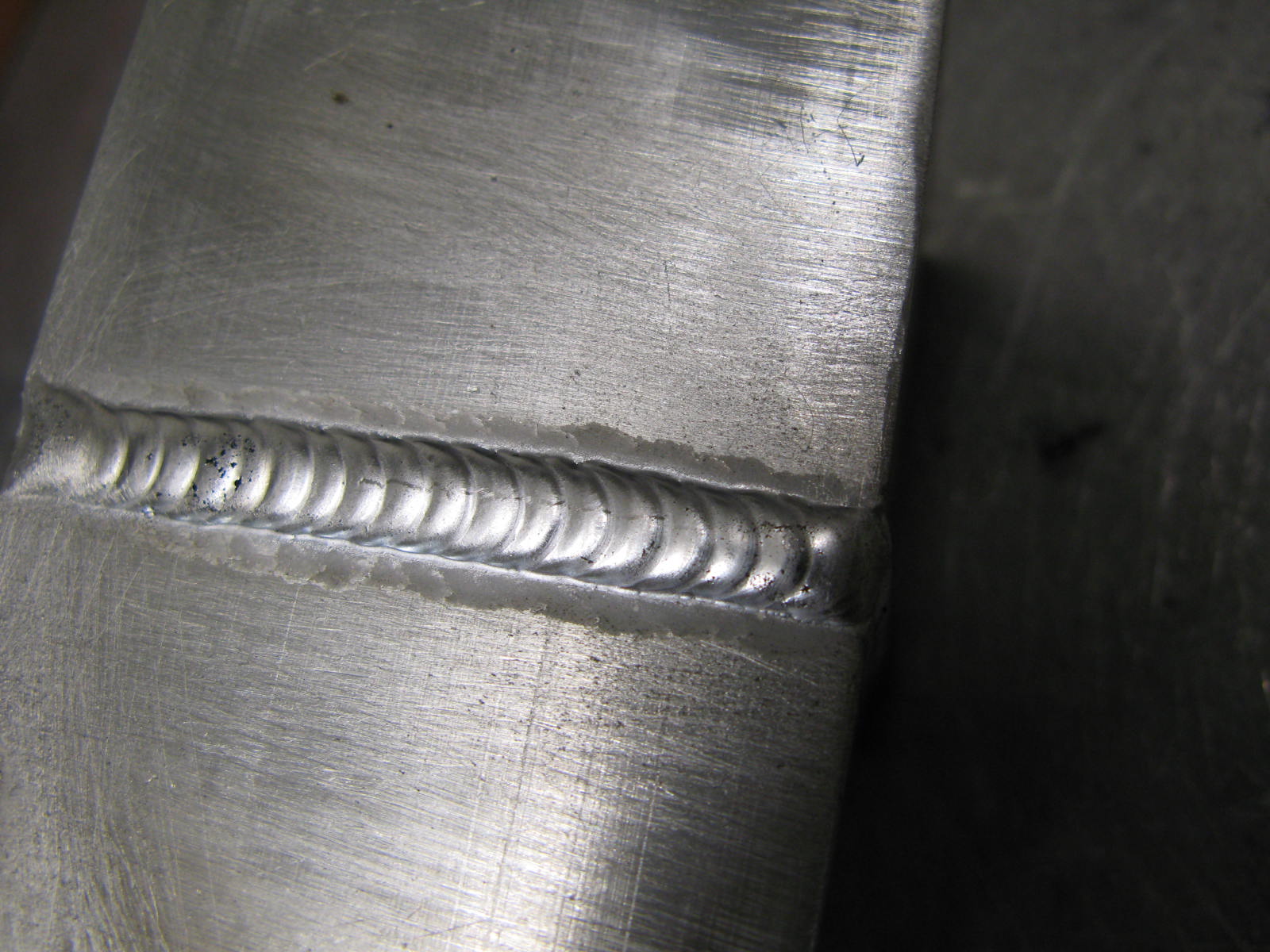

I realized differences when I changed the settings on the machine, but to be honest, I don´t know which to prefer.
125hz and the balance around the middle works o.k. for me.
When the preparation of the material was not o.k. then I had bad problems with horrible uneven and contaminated welds. I had to clean also the innerside of the profile I used.
Anyway the results are not that clean, the surface is not very even and shiny. Maybe more cleaning or different material? What do the pro´s say?
regarding the torch Darren: I had one that drove me crazy. It was a small (size9) torch and I had to weld some bigger material but was to lazy to change the torch. When it became to hot I put it into a pot of water (great idea, I know). After that I had big problems with corrosion/contamination during the welding process. I changed all the small parts, the gas bottle and the pressure regulator without success and at the end the torch body.
Kai
This gets a lot of people when they first start out with Alu and it's the nature of the beast.but creating a nice shiny puddle. That took some time and I have to leave the arc on some point in the beginning to let the cleaning action doing the job at first. I don´t know how to do that on very thin material. I think that it would melt away..

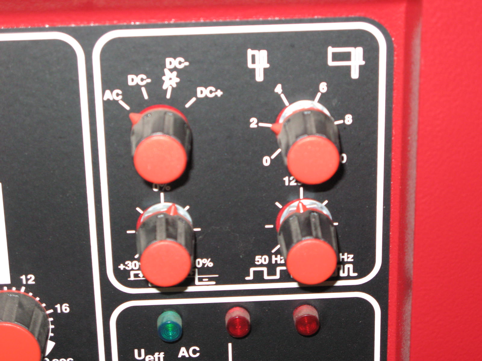

Daz I don't know what that switch does but it's there on the machine ready to be switched about. Don't be frightened to change stuff it (shouldn't) blow up.Just been looking at the manual again. Whats the variable ignition current (search arc)?? Should this be on 0%?
Its the first button on the left after the button for the pedal/switch.
