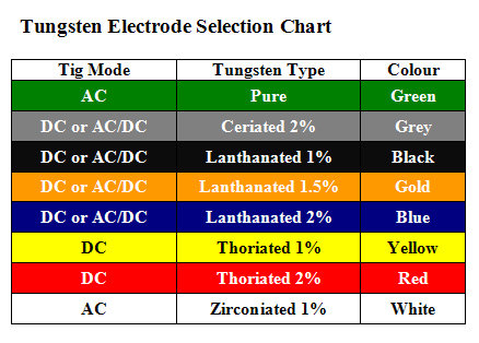

Try and get hold of some 2% Lanthanated. Blue is the usual colour.

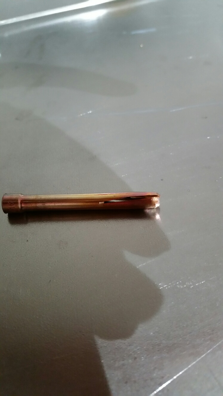

That collet looks pretty twisted up. Get onto Jim Davey he will be able to sort out everything you need. If you're new torch is a 9/20 style, he can do you the brass wedge collets. If it's 17/26 try and get decent consumables like binzel or ck. parweld aren't too bad but there is a difference.

I'm inpatient so i may try and pic up the tungstens locally. They may not have 2% Lanthanated what other flavours could i get?
