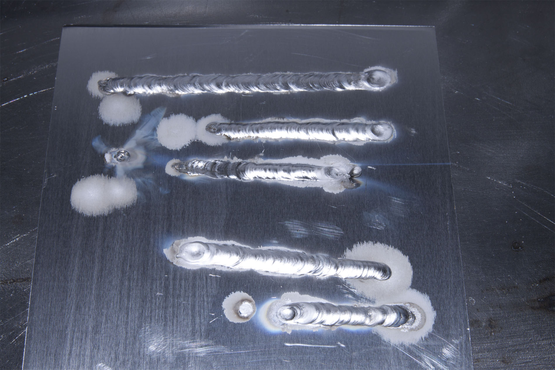

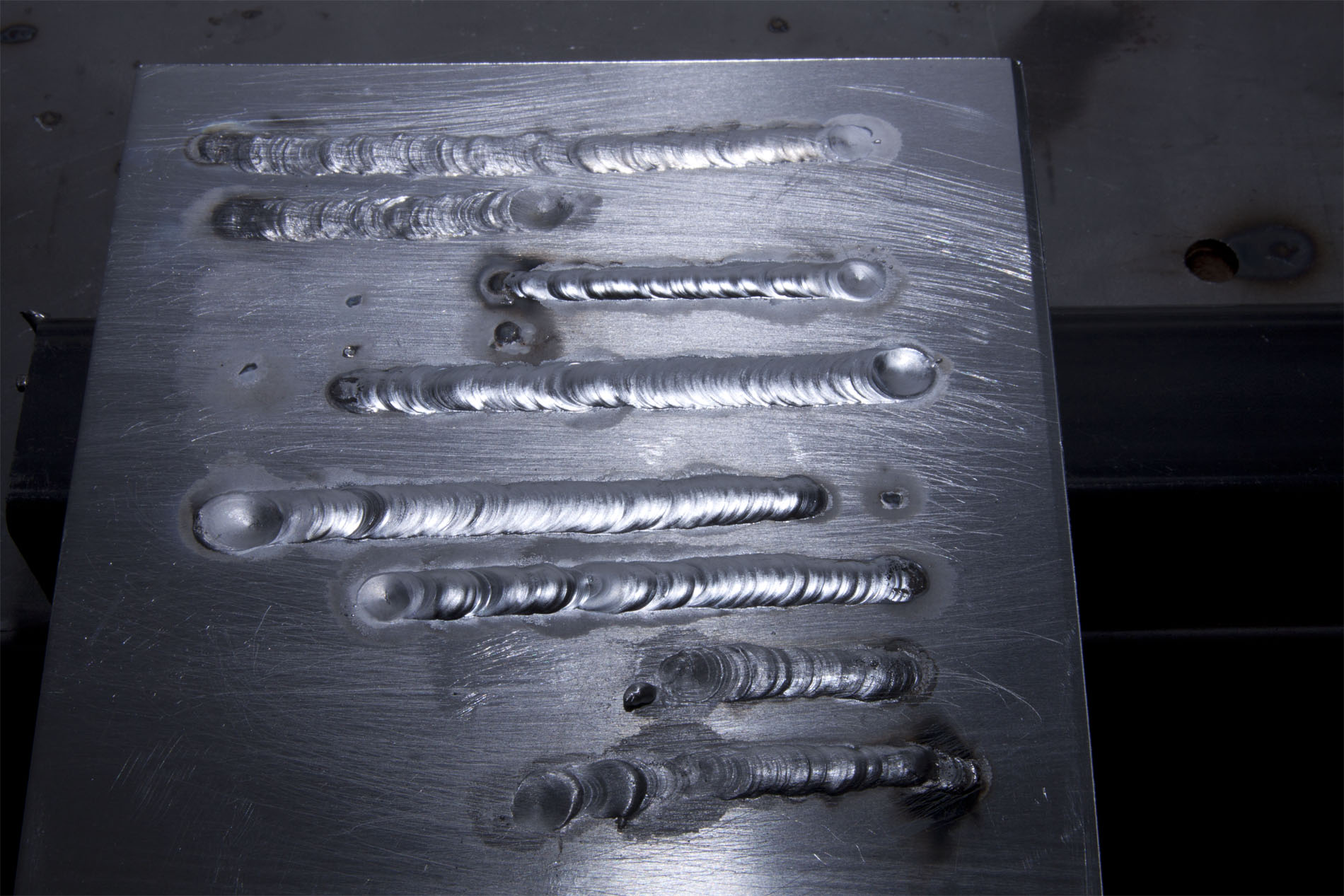

Yep its a pity but getting some great help on here.Shame you're not in the UK as loads of people would be willing to give you some pointers no doubt. You're definitely going about it the right way though, getting the beads on plate nailed is so important.

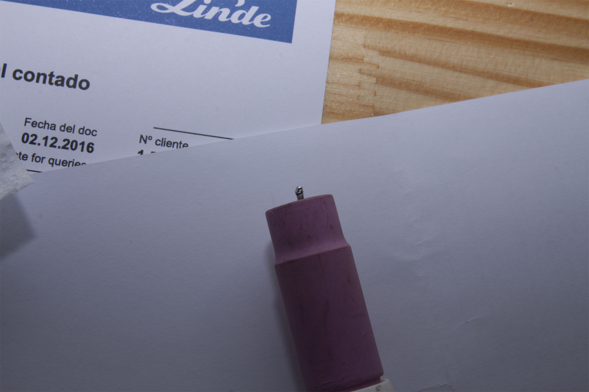

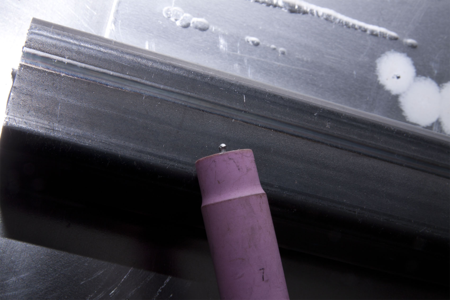

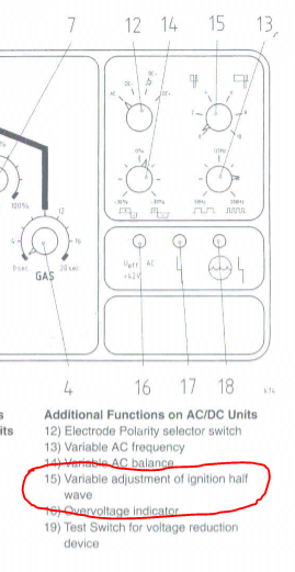

What's it like on the new Alu with a sharp tungsten.It starts well on steel and the scrap bit of aluminium which is really grubby just the new stuff that its struggling on. Its probably me contaminating the tungsten every time i do a run so on the next run it will not start up. If i grind the tungsten flat it will start no problem. Should a 1.6mm tungsten be flat/tapered. Is a 1.6mm tungsten ok for 4mm?
I still think you should have a crack at lift. Hf sounds the issue to me.
Yes if the hf is strong enough. This is why I suggest you try out some lift with your balled electrode. If that strikes every time you have a weak hf. The Fronius had a weak hf which I made better but not great by changing a few settings but then I swapped torches and the difference was night and day.Should i be able to start with a balled tungsten after my first run?

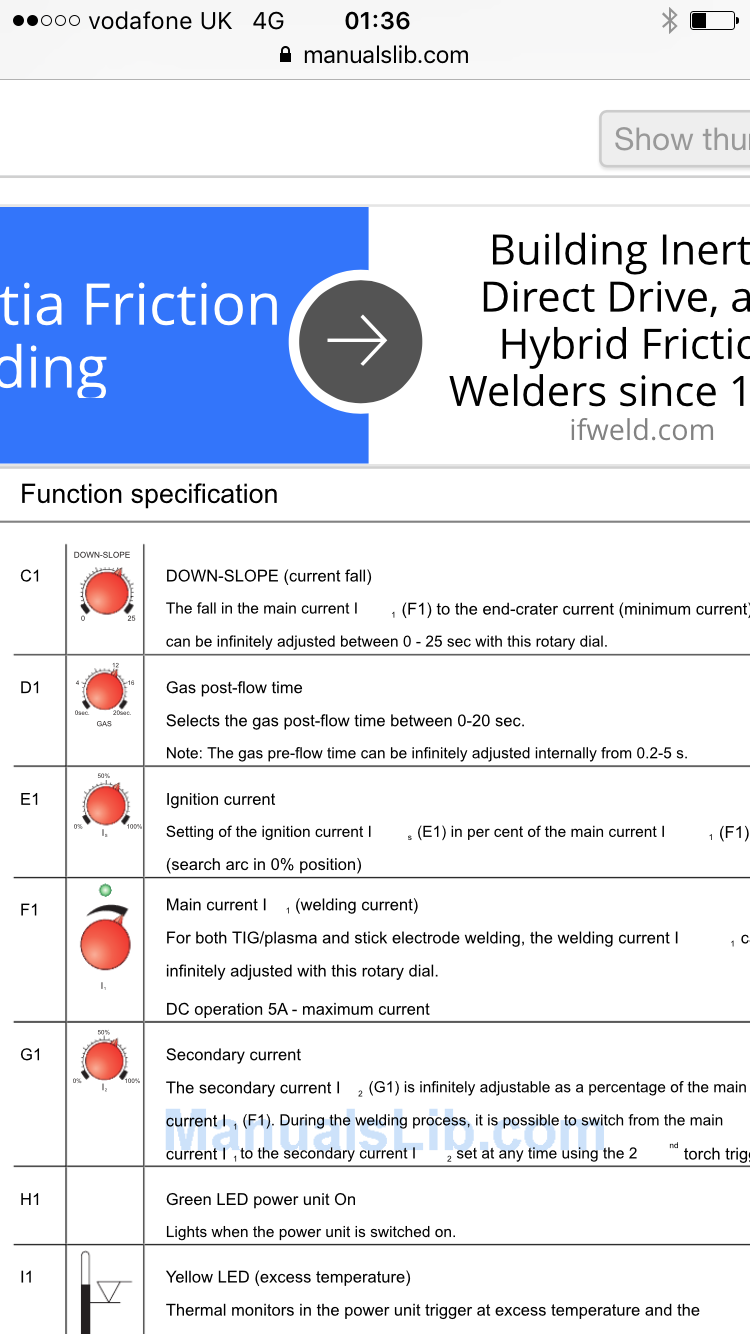

Remember this quote from Hugh about that feature on your machine.

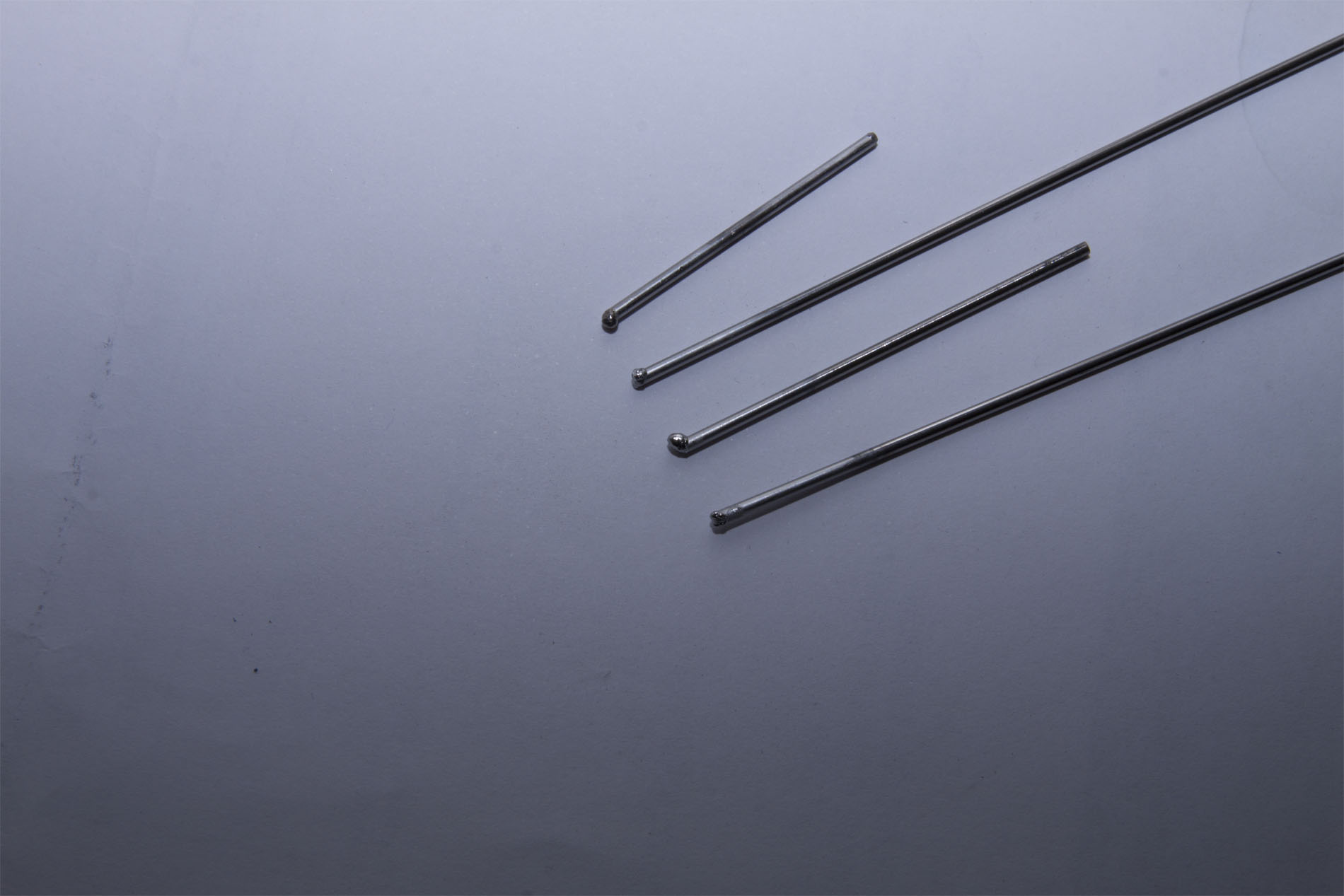

Thanks again Richard i've read that part of the guide over and over, you have some examples.By the way your tungstens are balling waaaaaaay too much. I wrote a section on balance and tungsten stability in the AC guide.
Either turn the balance more towards the EN side of things or step up on tungsten size. That heavy uneven balling will effect the accuracy of where the hf will want to strike and could also cause you striking problems. If it strikes every time hot or cold on DC then your balling is causing you trouble.
Now you have a feature on that machine. Top right knob.
Now is a good time to take it out of zero bud.
I believe this puts ep loading on your electrode at strike up. If that's right what it does is give it a split second of electrode preheat if you like.
This may answer your strike up issues. Turn it up and have a go.

1 is at 70% dc- on the balance
2 is at 60% dc- on the balance
3 is at 50% dc- on the balance.
How do these line up with the +30/-30 on my machine?
70% = -20
60% = -10
50% = 0

I would say what you have written there about the balance settings to be correct and on that basis id be sitting it at -15 and pretty much leaving it alone.
I'm almost convinced now that the striking problem is due to that knob been on zero.
It makes sense because
It's only in AC
It's only when the tungsten is cold and it's only when it's balled.
I'd turn it up to half way and with a cold balled electrode see if you notice a huge difference in its ability to strike.
