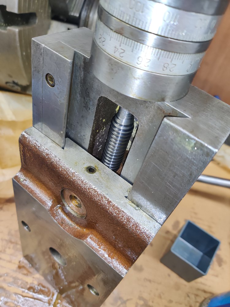

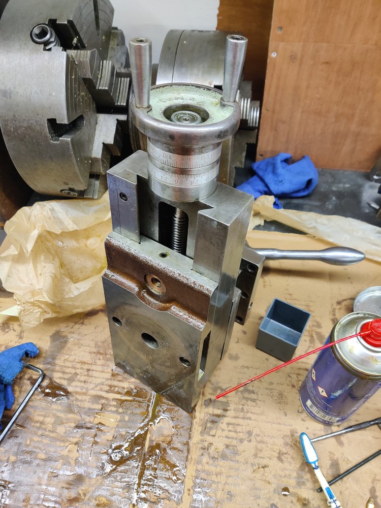

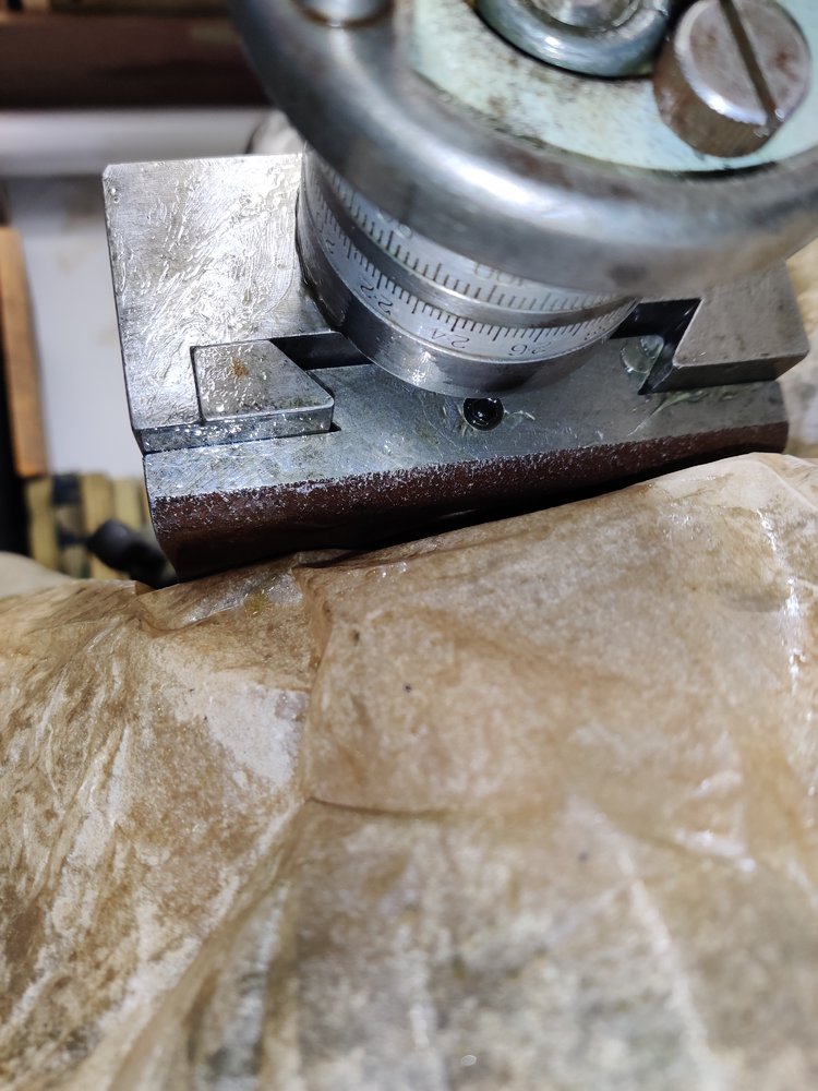

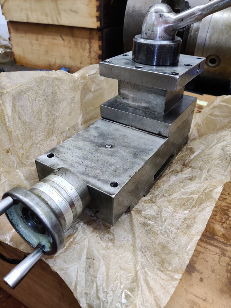

Check the carriage lock isn't on a bit. It's a square head stud on the front, tailstock end of the apron. Actuates a tapered bit underneath against the vee way.That's the toolpost and compound slide rebuilt and wow what a difference turning it really smooth dovetail slid in on an oil slick where as when I was taking it apart I needed a rubber mallet.
Can easily turn one handed nice and accurate and gibs nipped up gives a little more resistance but still real smooth.
Now in oil and paper to keep crap off it and stop surface rust while I get the cross slide and maybe apron sorted as cross slide is quite free at the moment but apron is really stiff moving by hand not sure why.

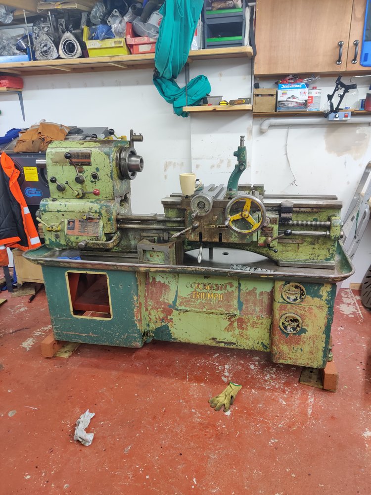

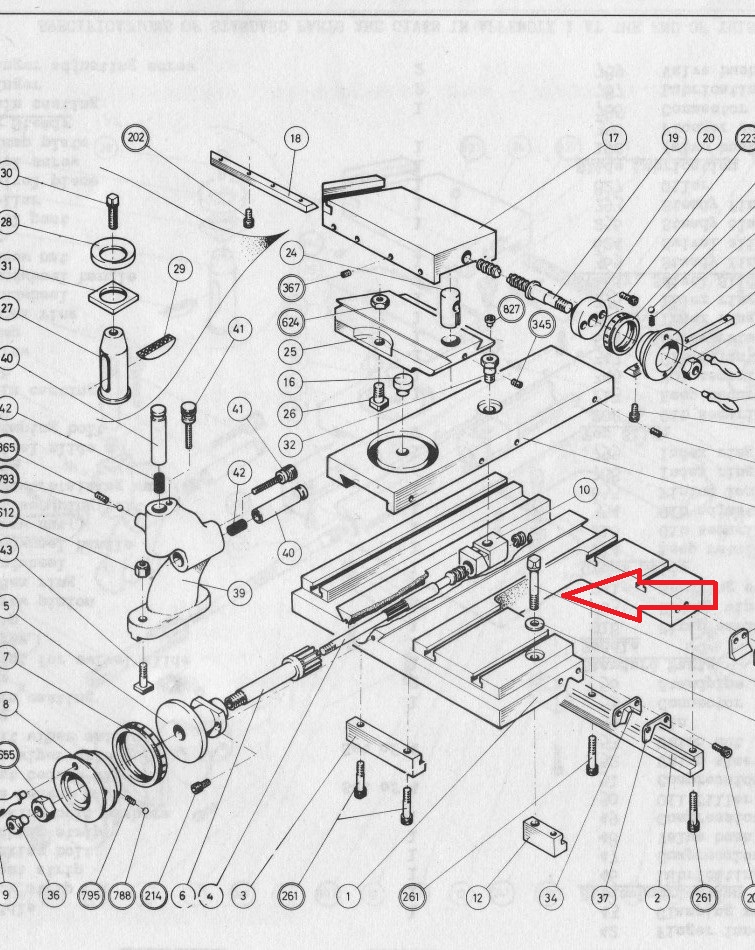

Not following you there , opposite side to the gibsCheck the carriage lock isn't on a bit. It's a square head stud on the front, tailstock end of the apron. Actuates a tapered bit underneath against the vee way.
He is meaning the apron being stiff as you wind along the Z axis to and from the chuck. On the top of the saddle there will be a square head bolt which locks the saddle on the ways.
Most likely muck between part 12 and the saddle which stops it pulling up enough. If it is worn, which I think unlikely unless some monkey has been power feeding with it locked, then you may have to skim a bit off the top of part 12...Funnily enough, mine doesn't work, won't lock up at all so it needs stripped down.

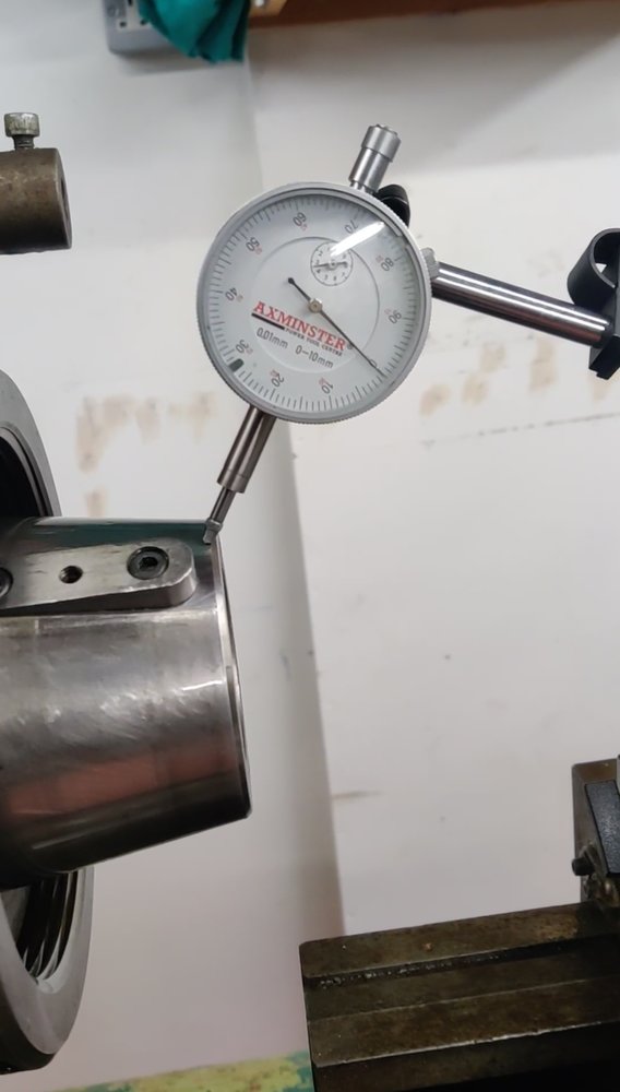

Before you use it in anger, check the Trav-a-Dial is adjusted properly, so that when it says 10mm, it has moved 10mm. Even more so if you end up removing or disturbing it during the clean up. The wheel on it is like a tour de France bicycle tyre, such that its rolling circumference changes depending on what angle it is presented to the 'road'.
