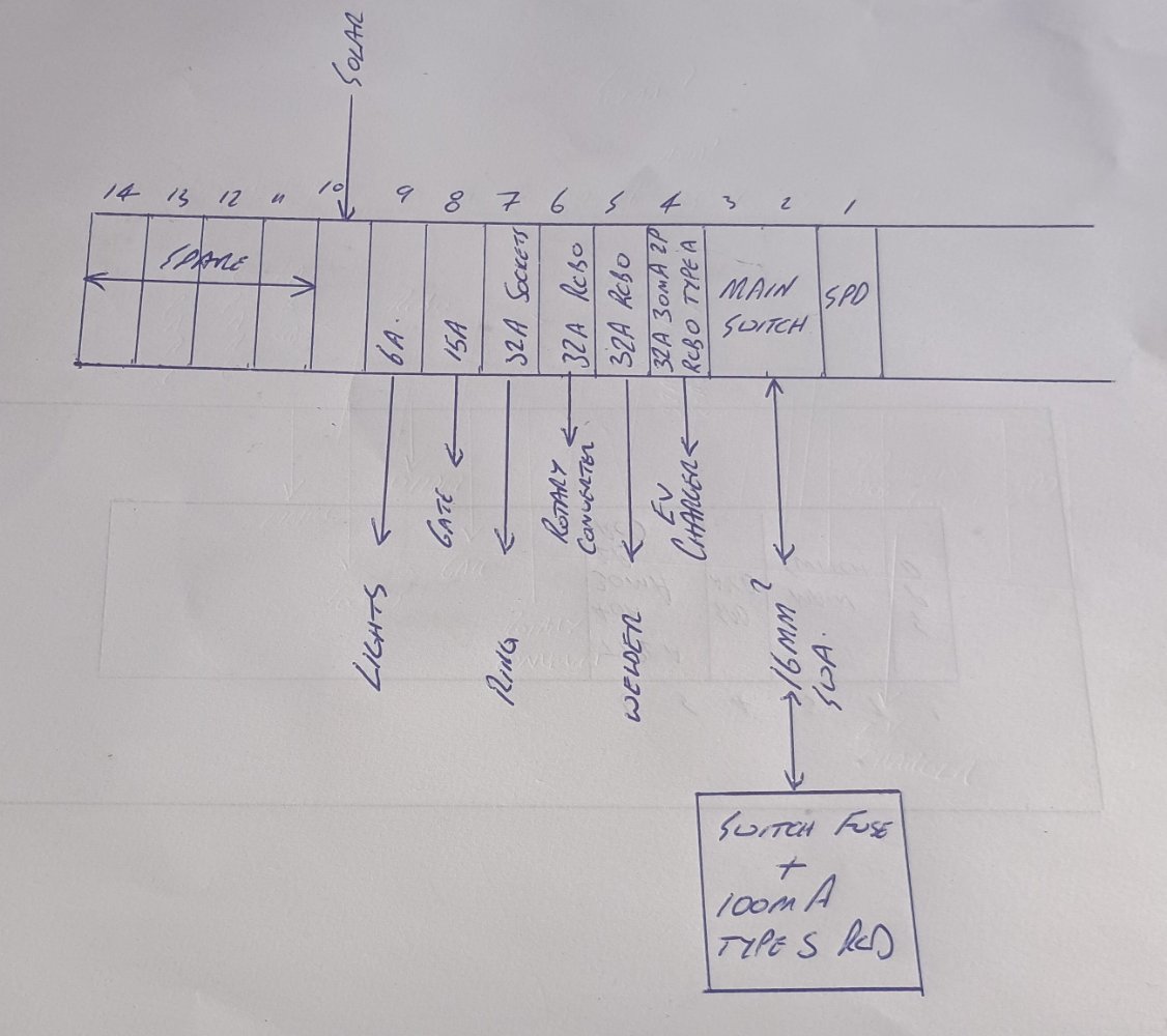

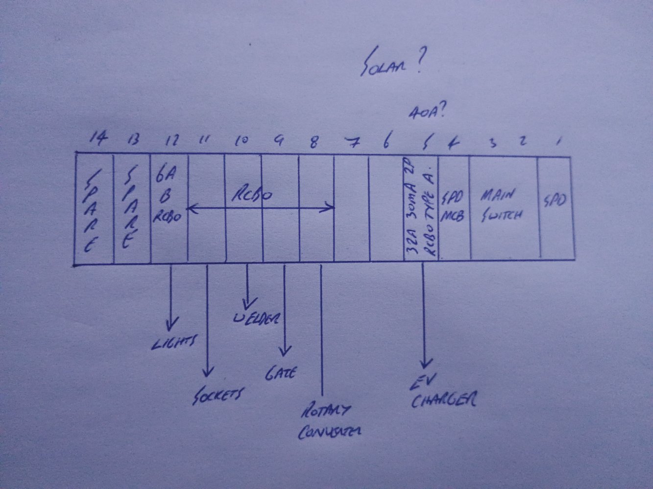

Hope your not planning to charge your car, while running the rotary convertor on a Sunday when your Mrs is cooking Sunday dinner.Well these bits are going to tot up, ah well, do it once etc. Just mulling the new garage cu. It'll be from Fusebox. Just fag packet sketching at the mo.
Can I incorporate the MCB I'll need for future PV in this cu or do I need a separate solar PV combiner etc. Keen to keep as neat as possible.
