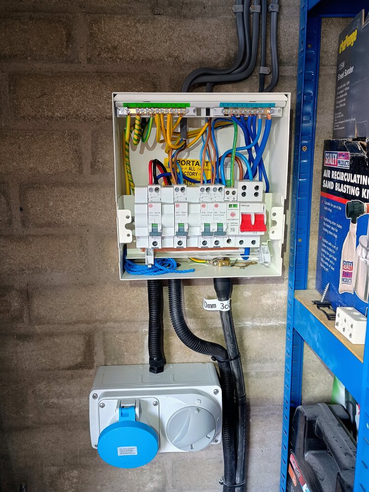

You will actually need two data pairs back to the inlet side in your house. Your car charger and solar both need load info, so will both have their own CTsSurely I can just put a 32A Type A Bi-directional RCBO in the new garage cu then supply the EV charger from that? Thinking 10mm² from house to garage then 6mm² from garage cu to EV charger. I'll have a measure up tomorrow and look at volt drop.

, when I redo the garage roof.Hager RCBOs in the garage.

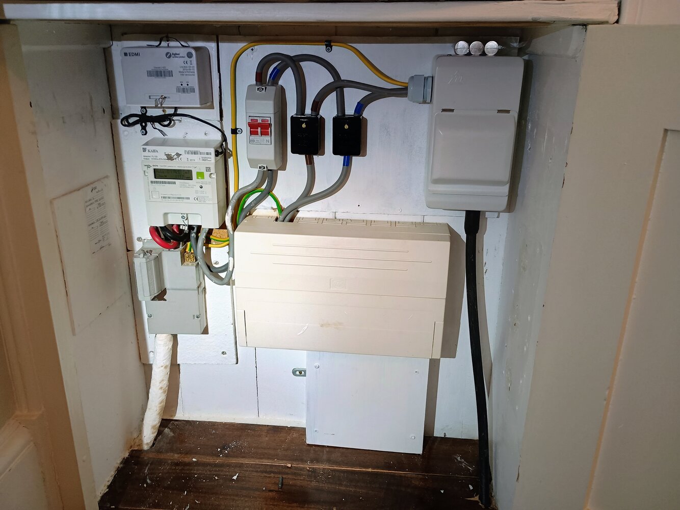

That depends. It needs to go somewhere where it can measure total in/out on your electrical supply. So if the garage is split off with Henlies it needs to get to the meter side of those.You mean the data pair has to go all the way back to the house where the meter is?
However for our solar (Solaredge) it was an actual bit of equipment, not just a CT. So it needed a power supply itself, also needed so it can measure voltage as well as current.

You can run without if your confident you won't blow your main fuse.
and don't take the fuse carrier marking as gospel, it may be marked 100A, but can hold 63A, 80A or 100A fuses, it's best to pull it and physically check.
