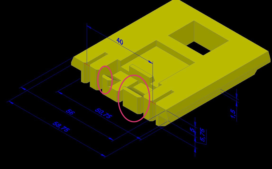

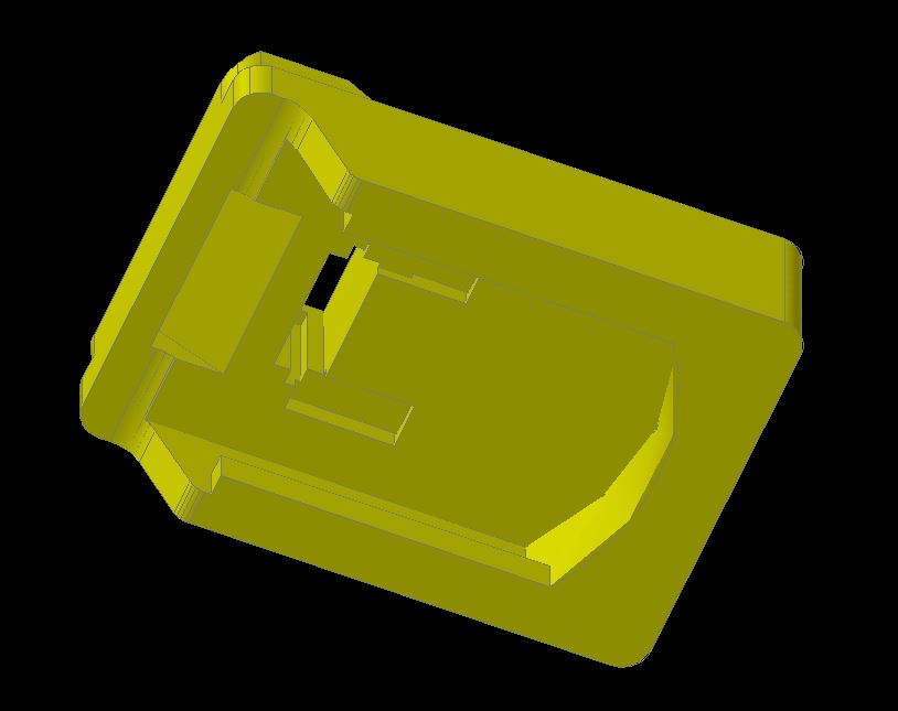

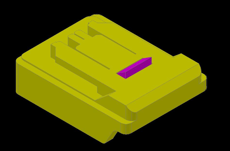

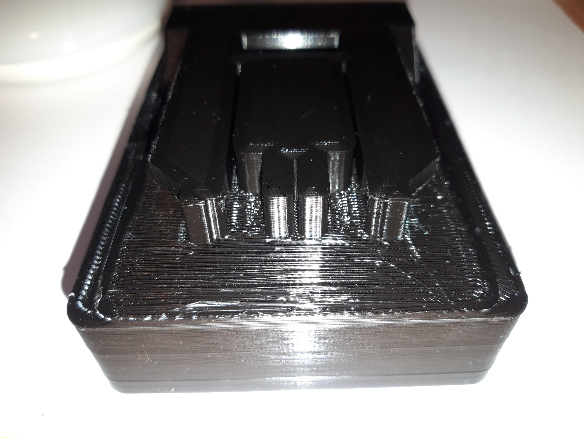

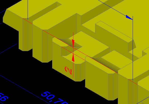

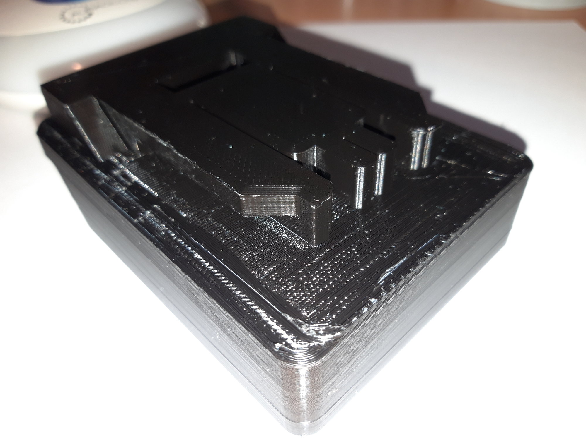

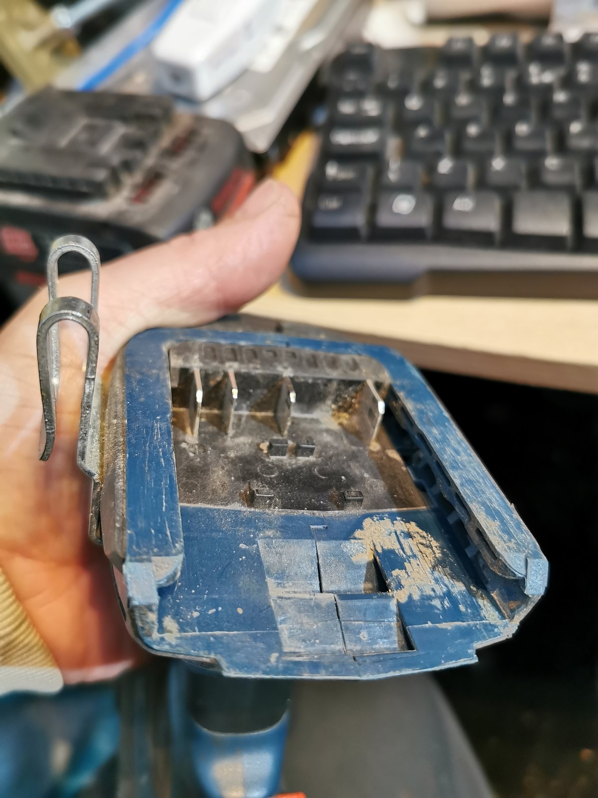

Those two tabs..View attachment 237088 View attachment 237089

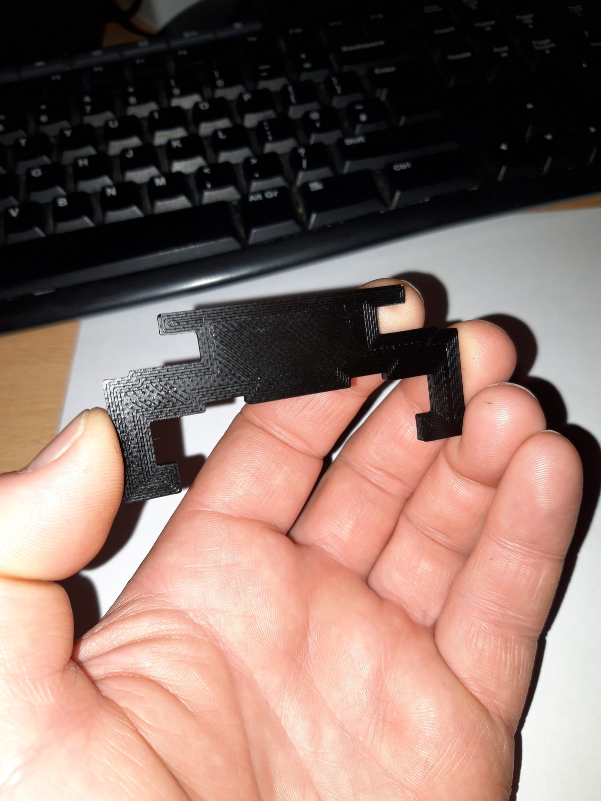

The parts catching are the two black lugs where the blue plastic changes to black.
[View attachment 237085
But I just took 1.6mm of the yellow tabs and it's perfect as you can see.![]()

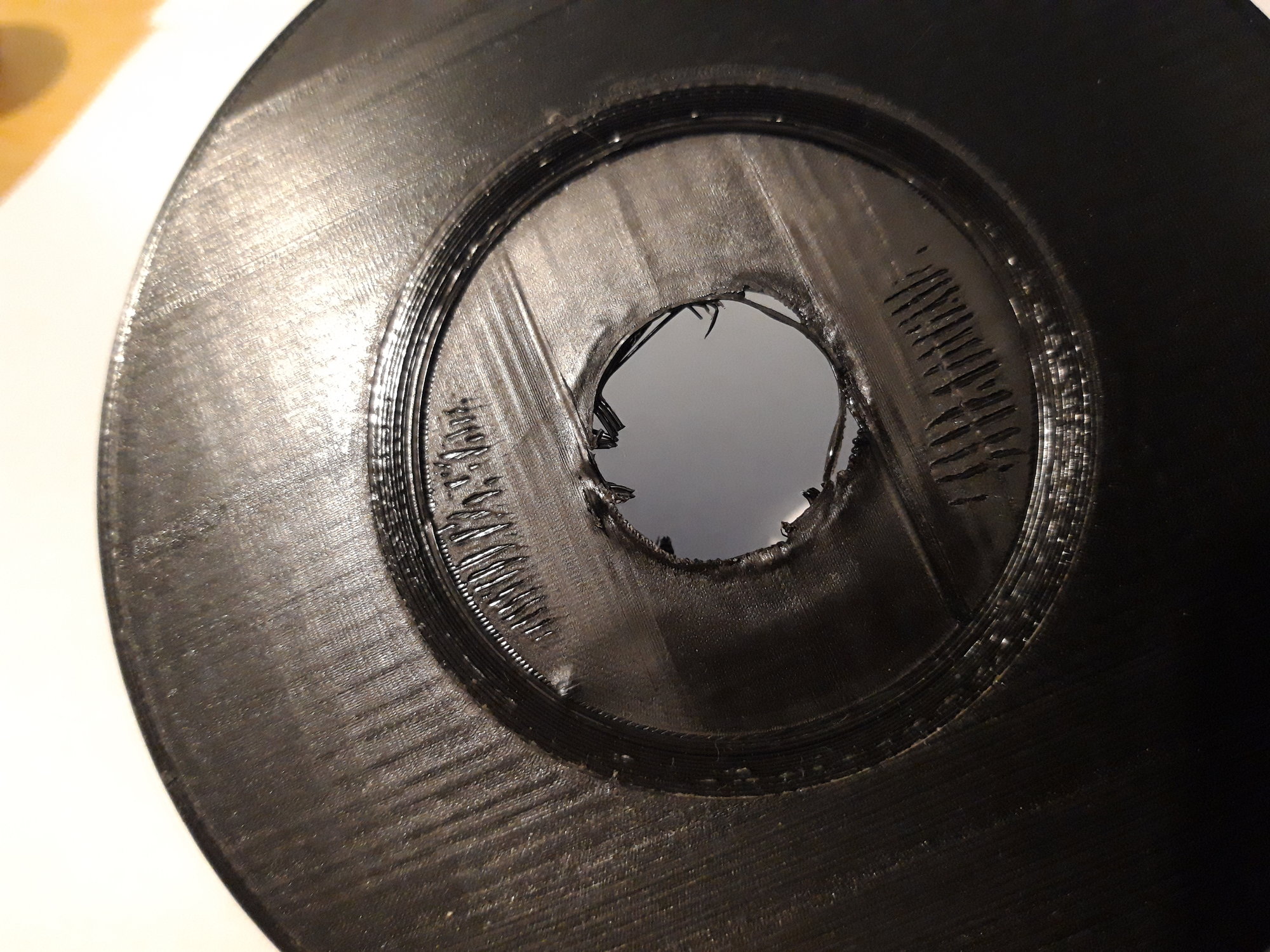

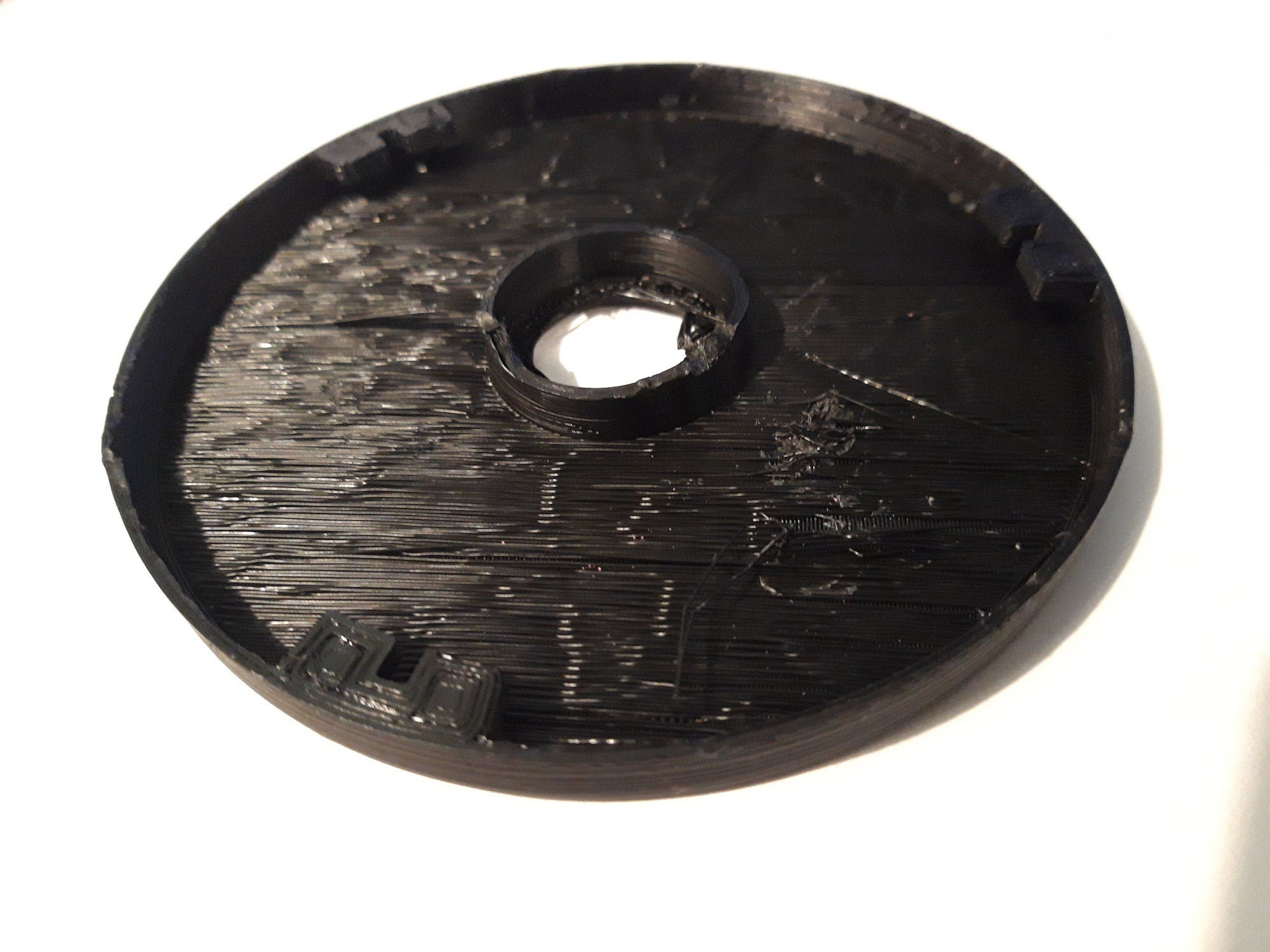

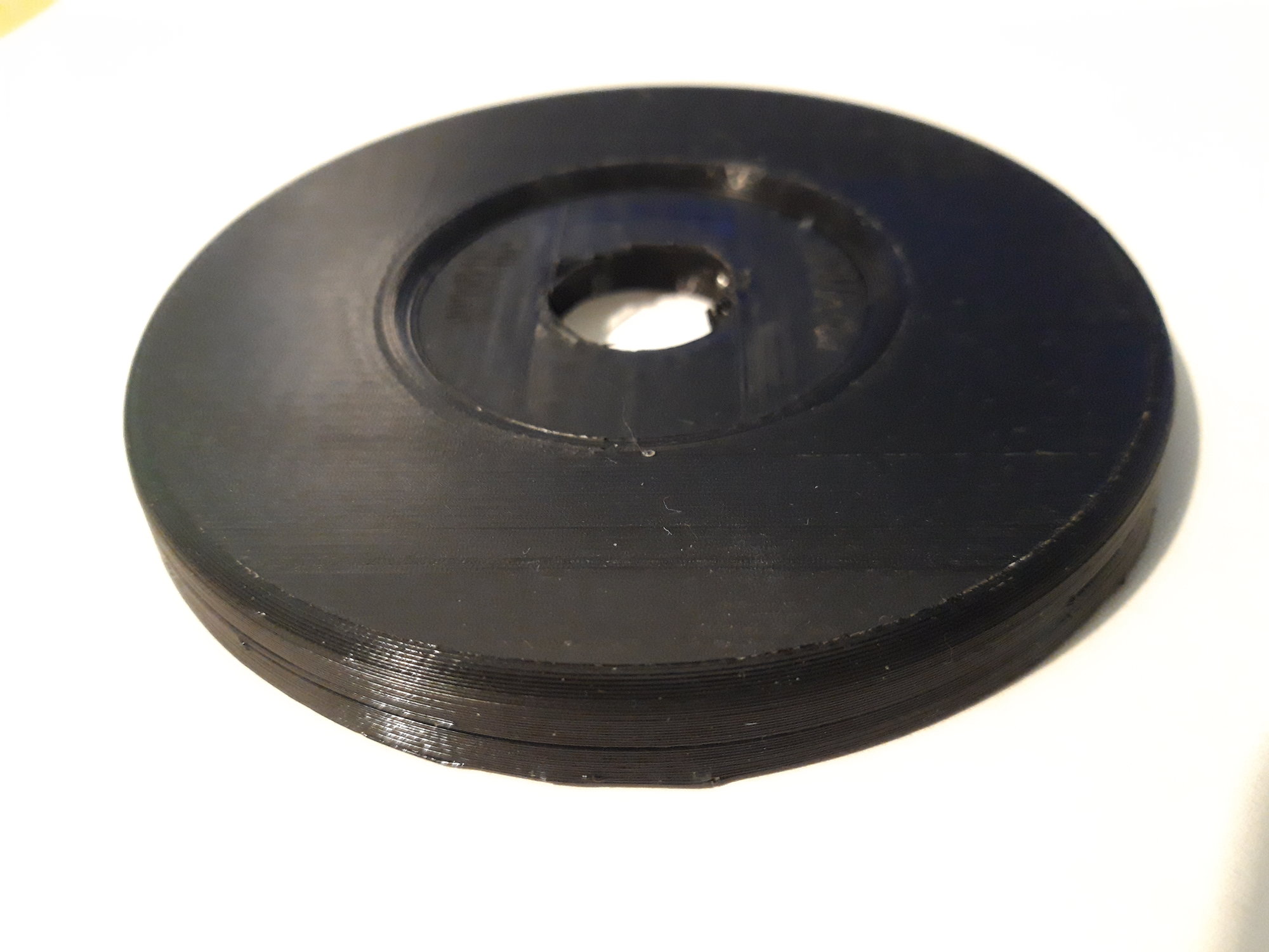

This was another attempt at the Pug petrol cap cover in black RS Pro PLA. 0.2 layers. 200degC head, 50degC bed. 50m/s. 25% infill. Support roof used, 0.7mm horizontal and 0.2mm vertical spacings.
To me it looks rubbish. I don't get involved with the actual printing or Cura or Fusion 360. My lad does all that. If I tell him it looks **** SWMBO tells me off!
Printed this way up:
The underside that had supports:
Tbh he's never been able to get very good surfaces above supports.
And this hole should have been a clean 19mm dia. Lad thinks it's because he chose to iron the top layer of the recess:
Yes I think so. It's relative to where it slides as well. My battery is worn. The printed part is not.So I just need to reduce them in height?
Gotcha. Would 1mm less do it? I'm measuring 3mm on the battery where I've got it as 2mm on the model?
Easy one to sort! On to the pita other end now!

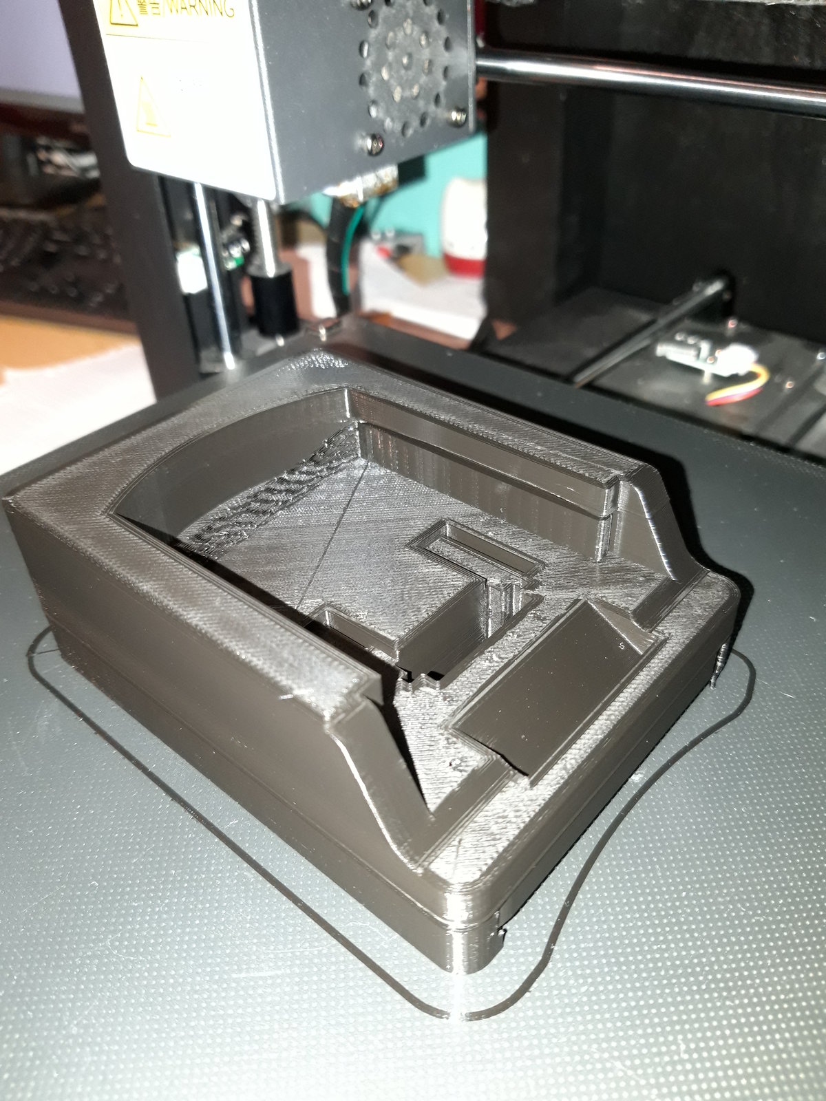

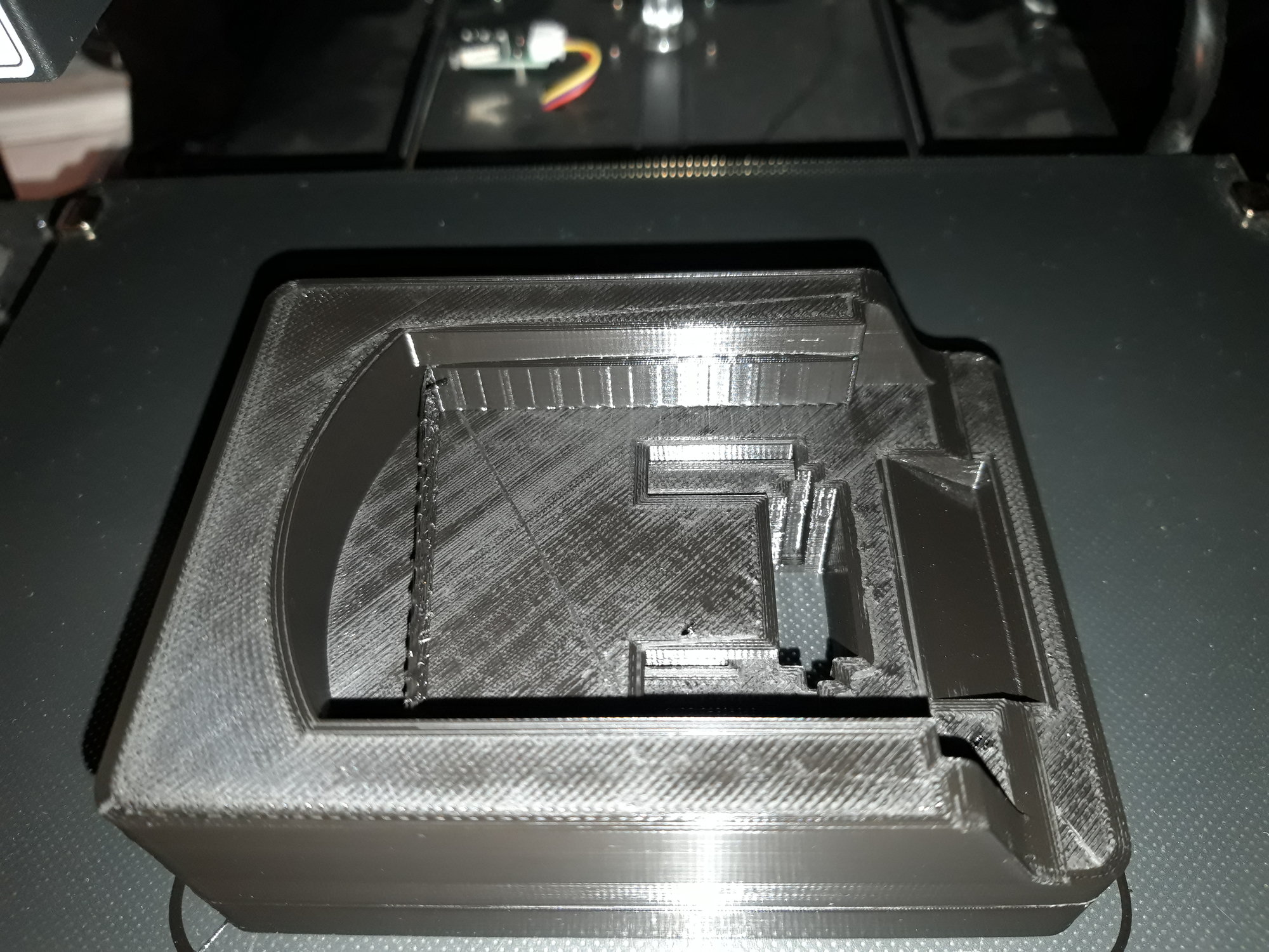

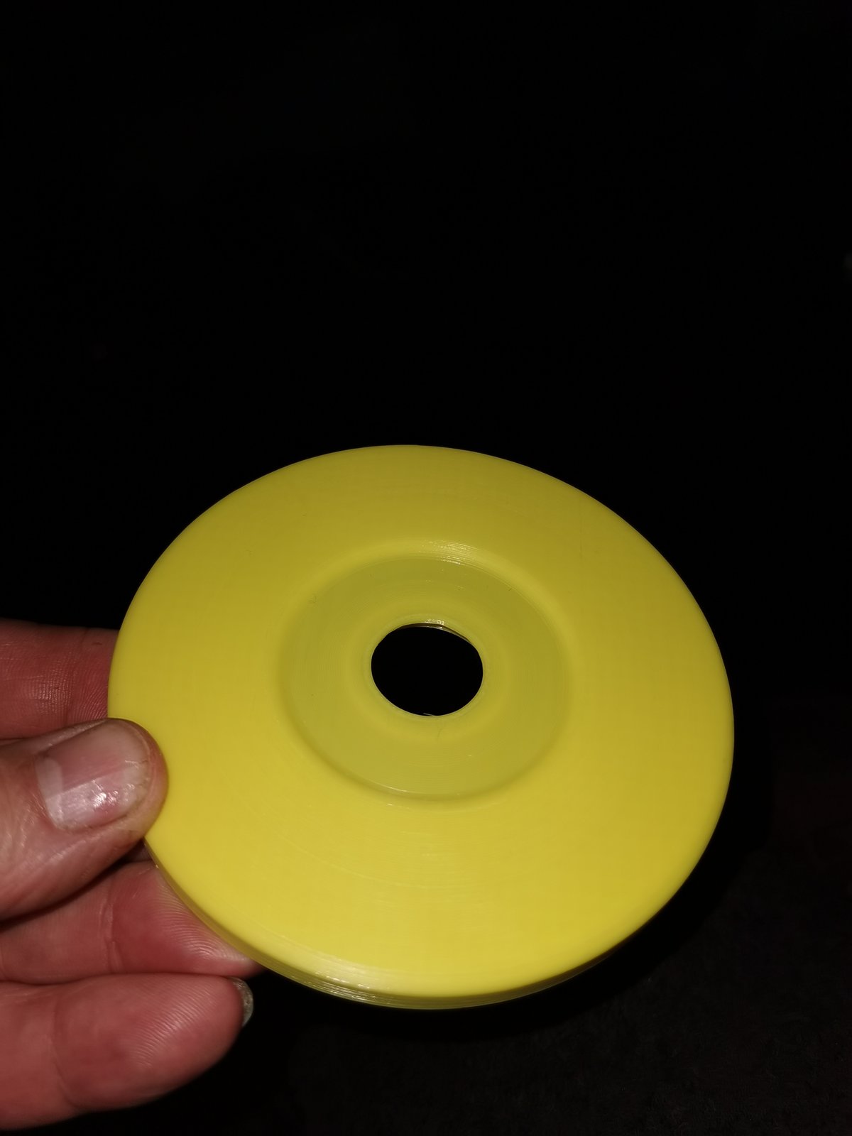

View attachment 237289 View attachment 237291 View attachment 237292 View attachment 237293
The bottom one is as it came of the printer.
Next one up is the reverse side.
Not that happy with the finish but as it's above supports it's passable. But I feel sure with some practice I can smooth it out with adjusted settings.
Third one up is the smoothed out finish.
The top one amazingly is the support. Came out beautiful.....lol
I will send you my Cura profile. It's basically the Chep Cura 4.6 with a couple of mods to smooth it.Liking that a lot. What settings out of interest? What material? The "smoothed out" finish...fume cabinet?
Different material...even colours from the same range can print slightly different. It can get very very frustrating.It doesn't fit!

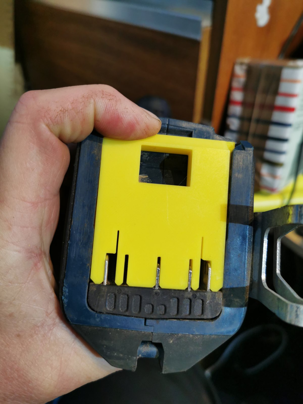

Well, the Makita battery fits the adapter perfectly but the adapter won't then slide into the Ferrex tool. It's just too tight. You can hear the layers cracking if you try and force it!
How can it not fit? @ukracer printed the same. STL I sent him and that fits his Ferrex tool!

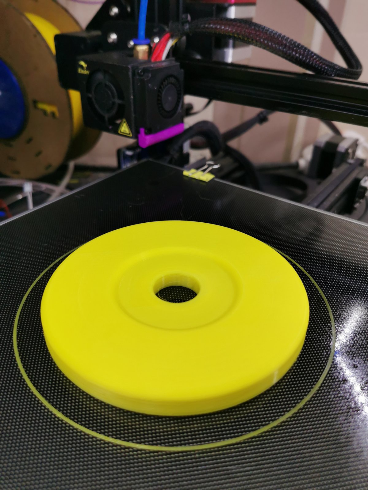

Send it me and I will print with the yellow PLA and see what we get.
Lol...yes I am....what's wrong with it.@ukracer , apologies but if you're mid print with that Makita 2 Ferrex adapter it might not fit!
Lol...yes I am....what's wrong with it.![]()

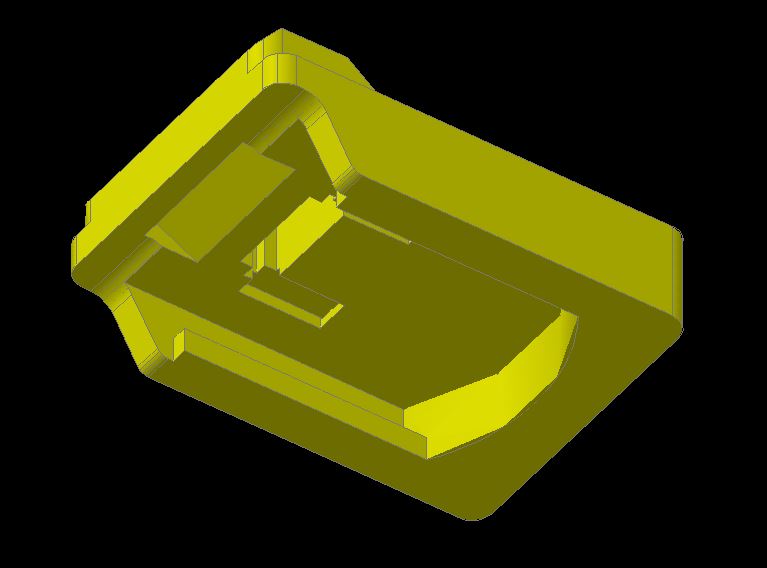

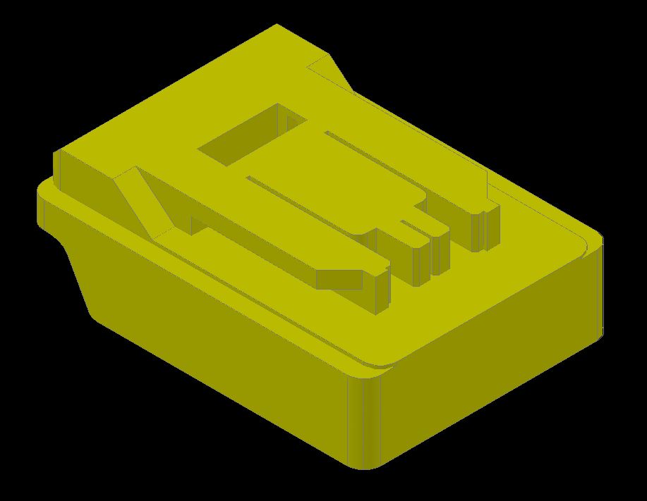

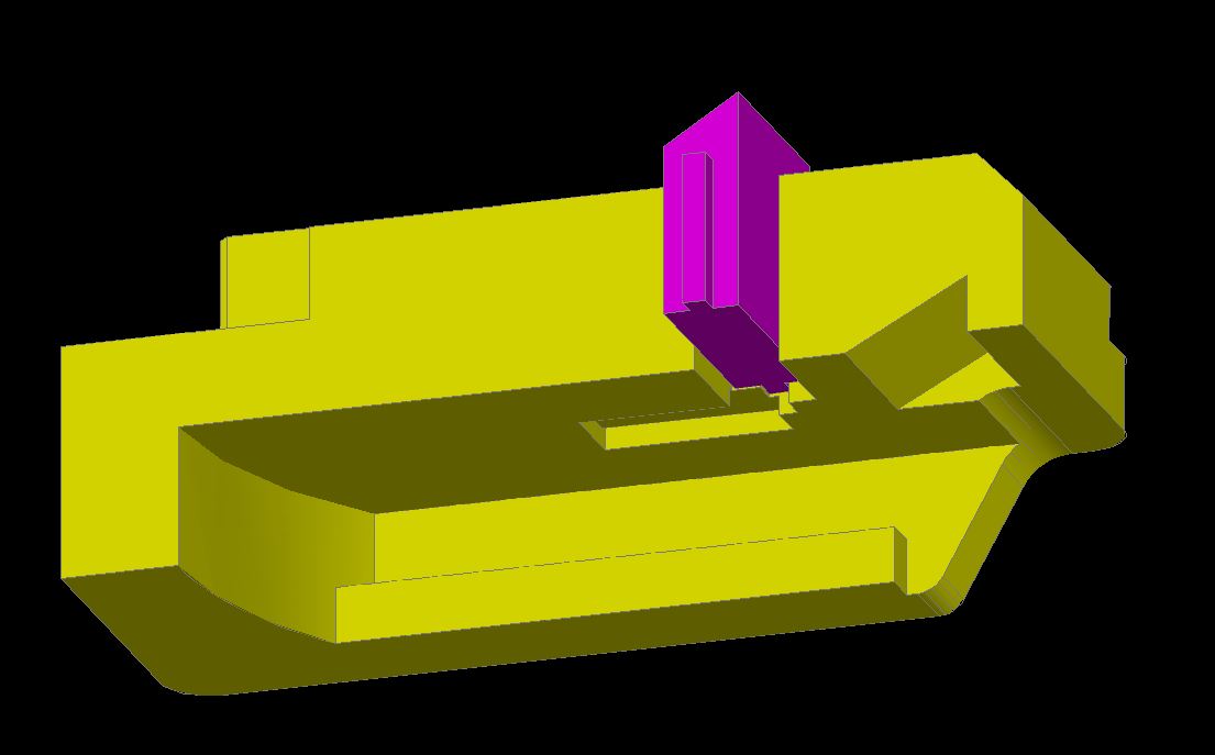

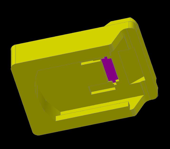

Ok I will let it run not too long to go now..Look at the slice I drew above. That's "5&5" on the bit that slides into the Ferrex on the 2nd test piece that fits, that you printed earlier and said fitted perfect after I corrected the angle.
It didn't fit here. Maybe to with the rough print here or different printer/materials like you said.
Changed it to "6&4". Tried a slice at that and it's a sweet, transition fit pretty much.
I'm going too to widen the slots where the copper fits in. Drawn at 1mm, they're coming out a bit tight here.
