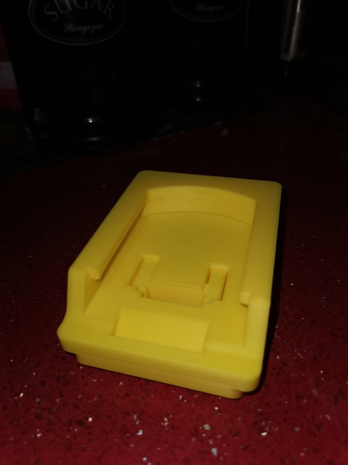

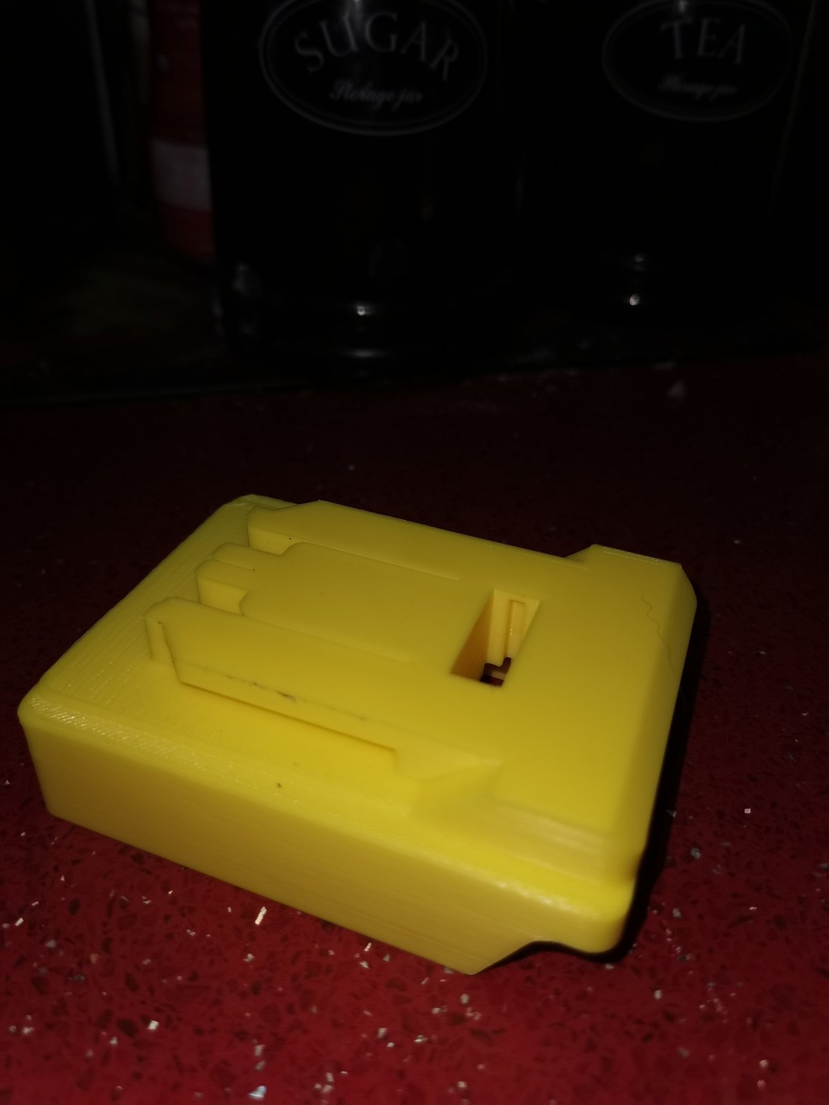

Just been told that the printer was set up to print the 1st layer was set up to print 30% larger by default to improve bed adhesion. That might help explain the slot width (on the face against the the bed) for the copper tabs coming out at nom. 0.79mm rather than 1mm as designed.
Going for a "standing up" print next. Less supports where it's noticeable:
