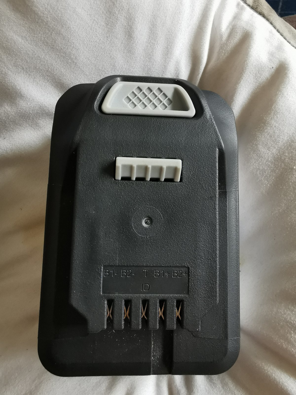

Sorry I did not check photo...View attachment 235220

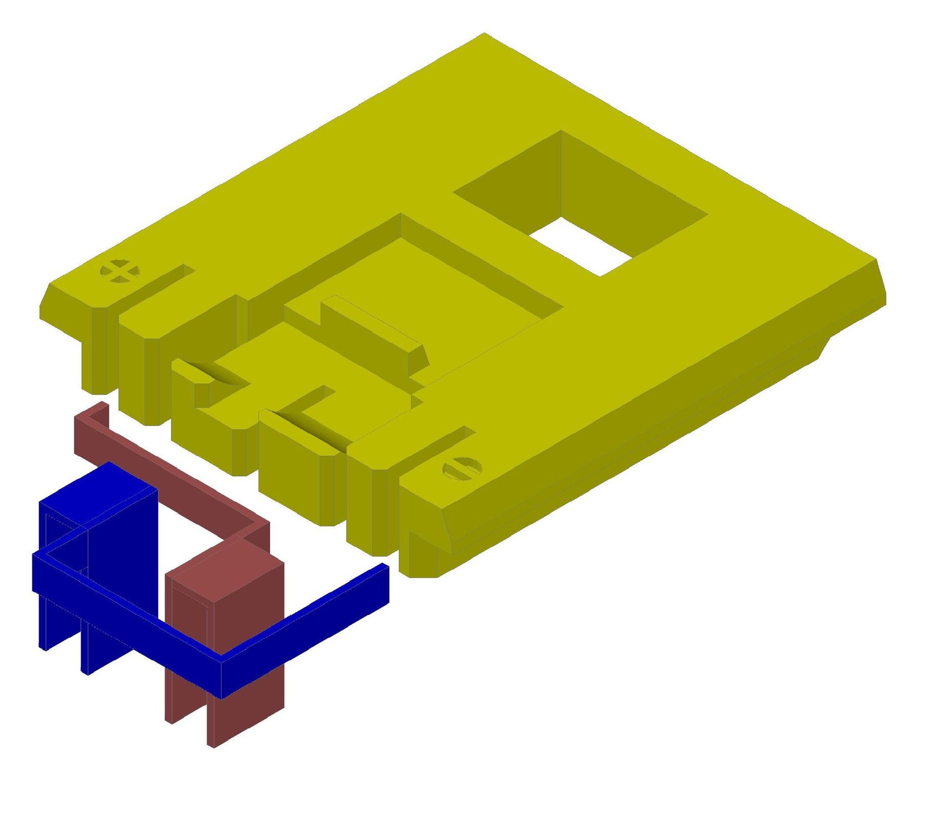

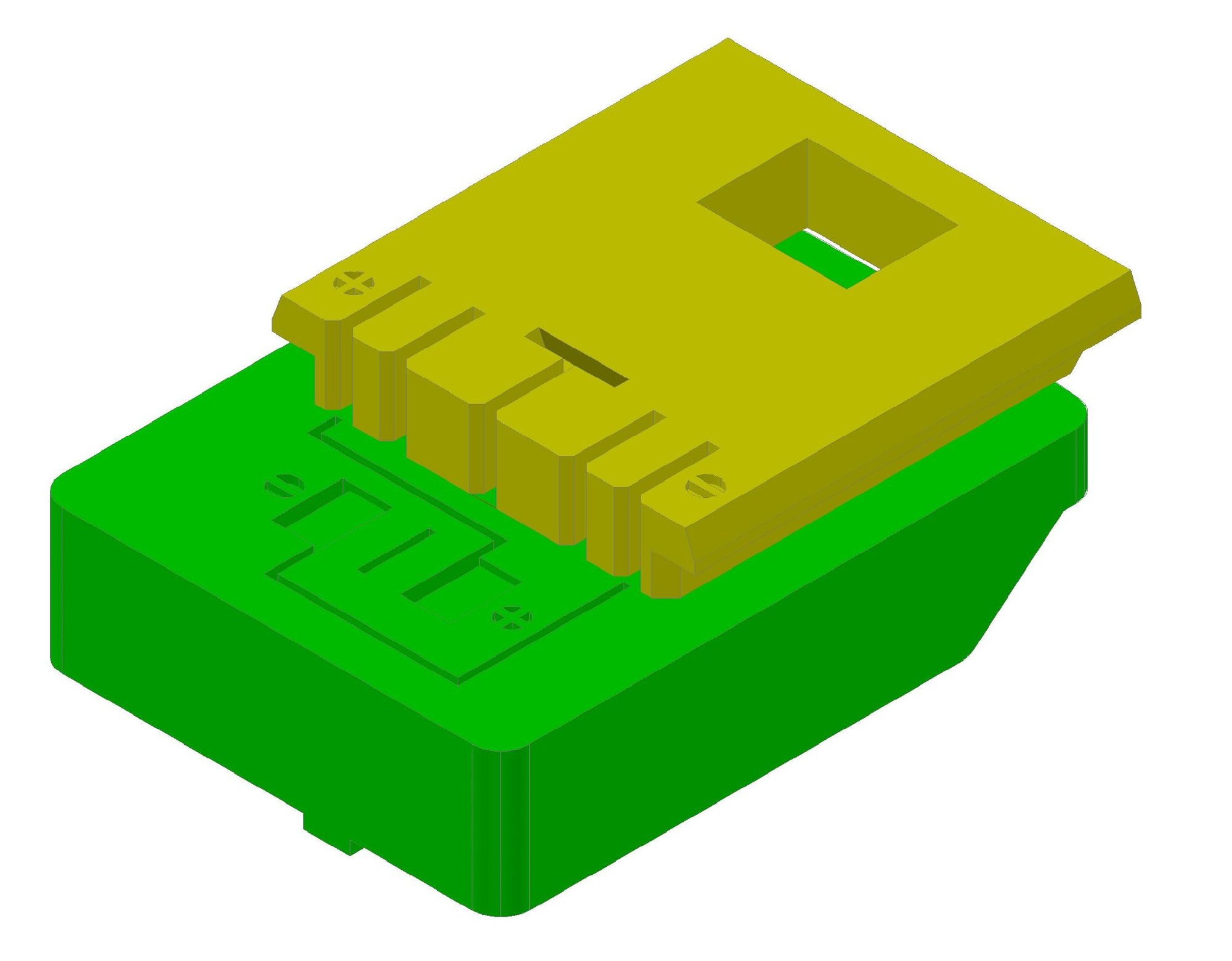

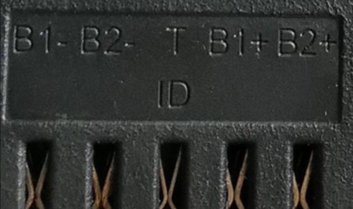

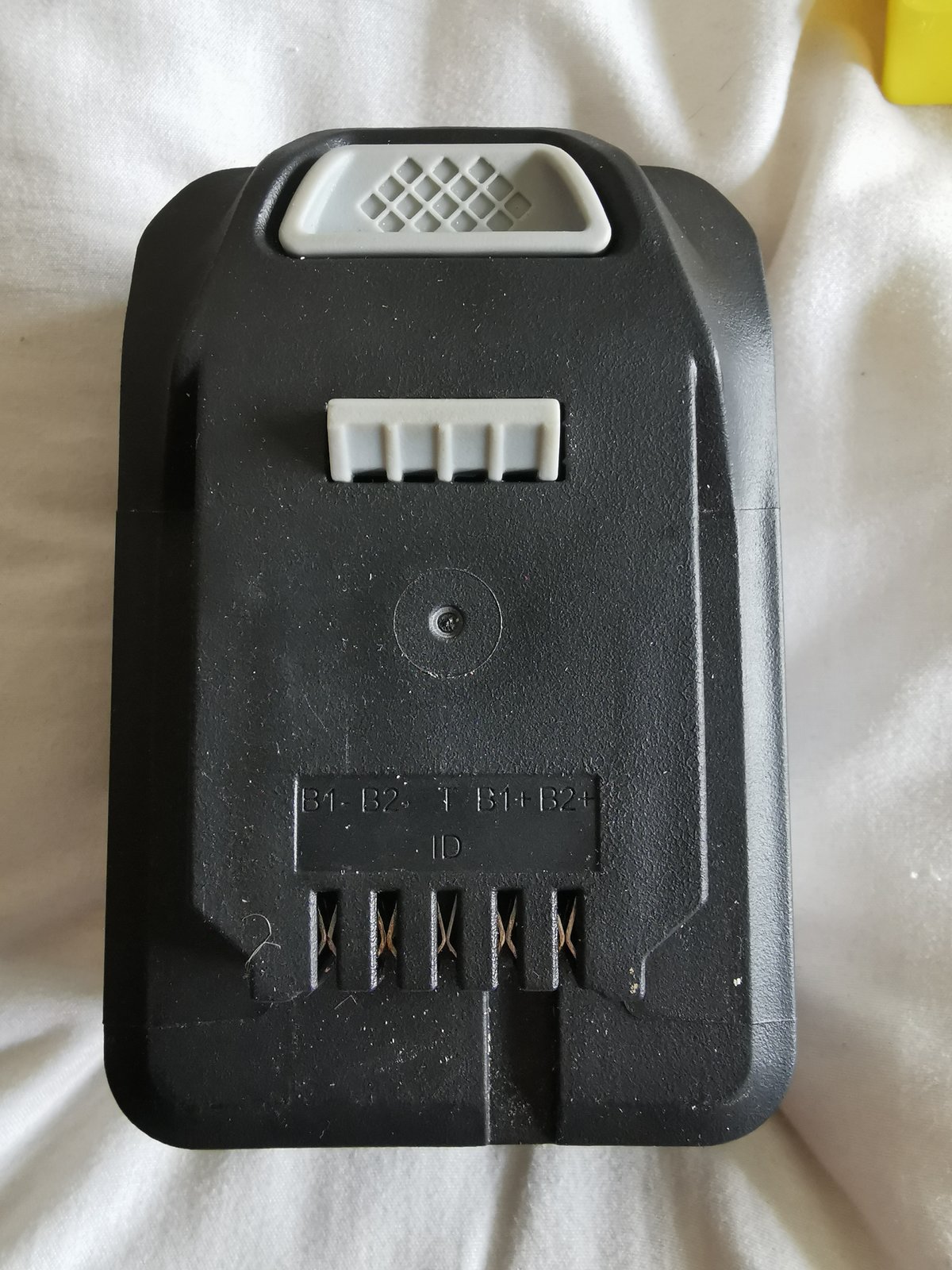

Yeah that is correct....I thought damn when I saw it. LolMust be my phone, still can't see it clearly! Just confirm L to R:
B1-, B2-, T, B1+, B2+
Looks like + & - are on different sides. No bother, can figure a way around that...I think...

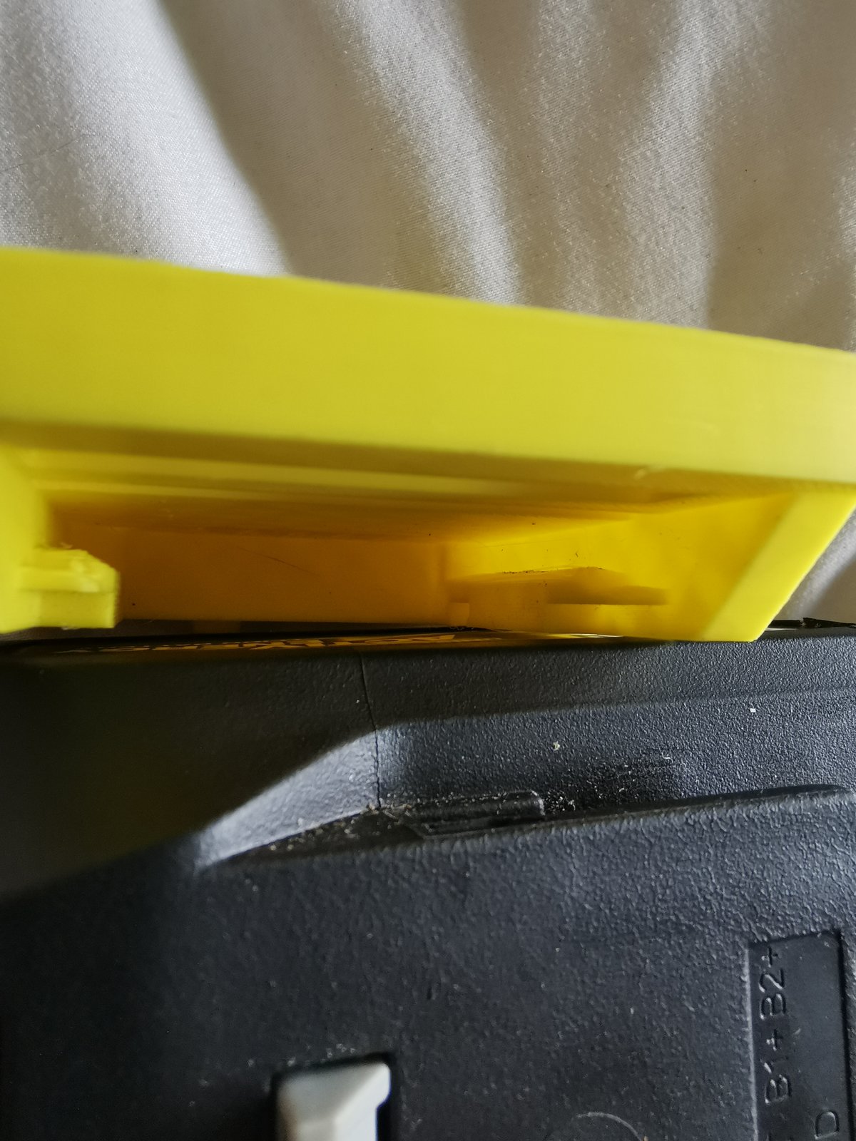

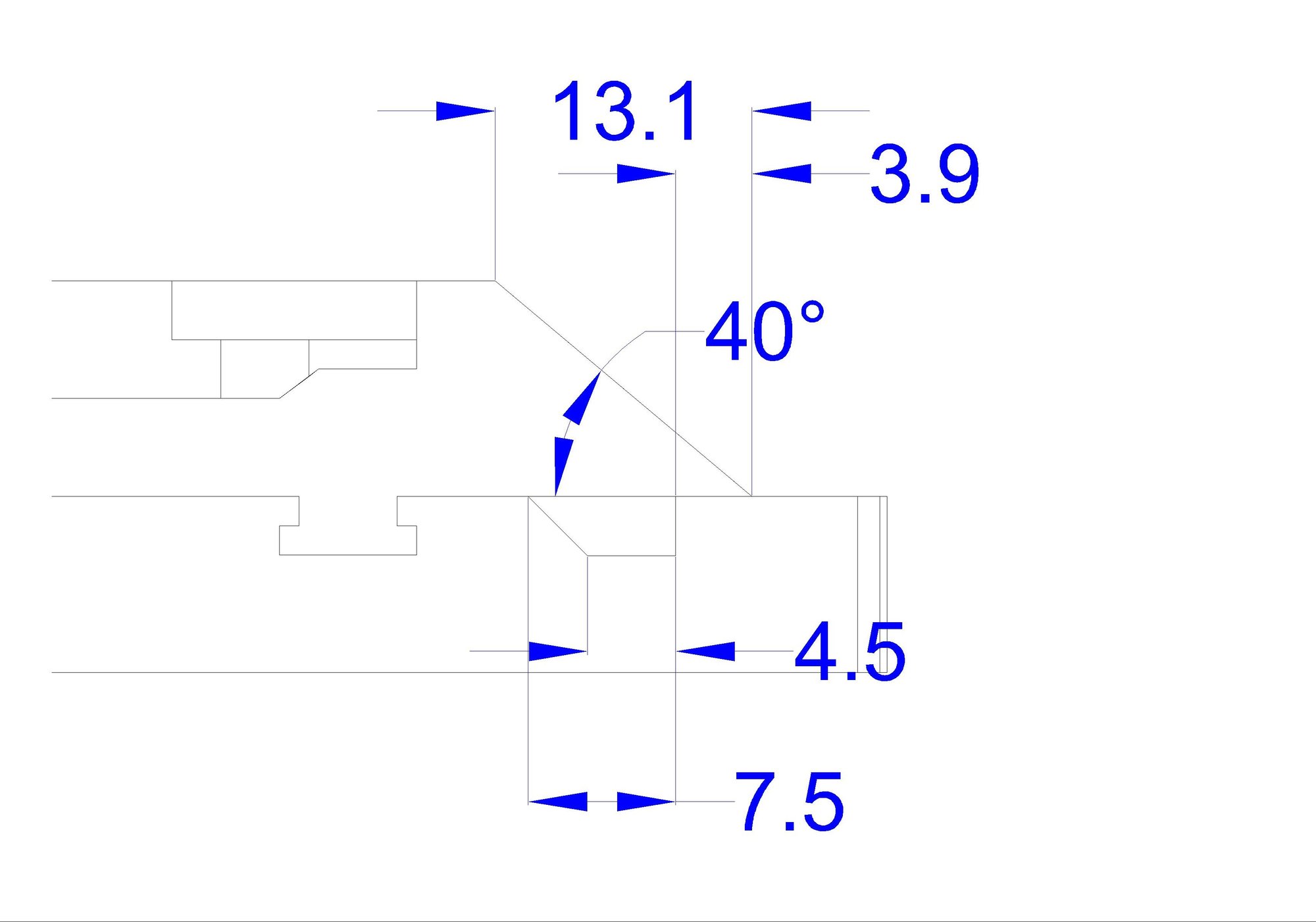

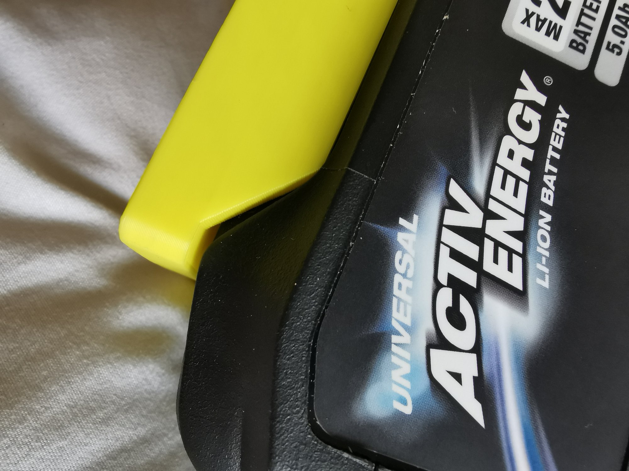

possibly not quite that but Angles get me confused though. lol@ukracer, I reckon that angle should have been shallower. Like 35 deg rather than 40. Just dug the bevel gauge out and took another look. What do you think?

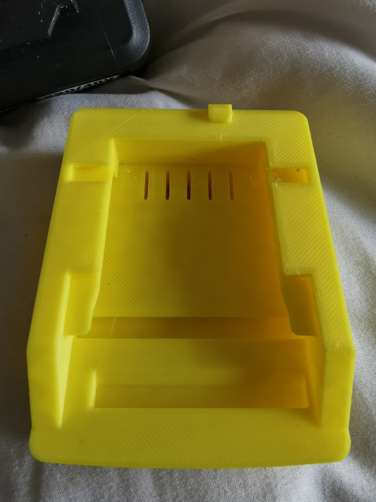

i would guess the print only needs to go further in by 2 or 3 mm .
should click in at that.

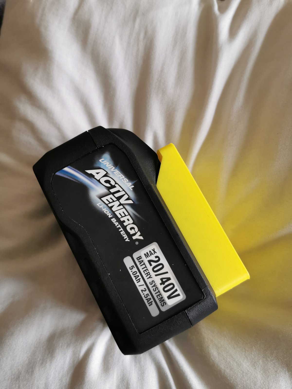

BTW it does have a battery check button I think you asked about that before?

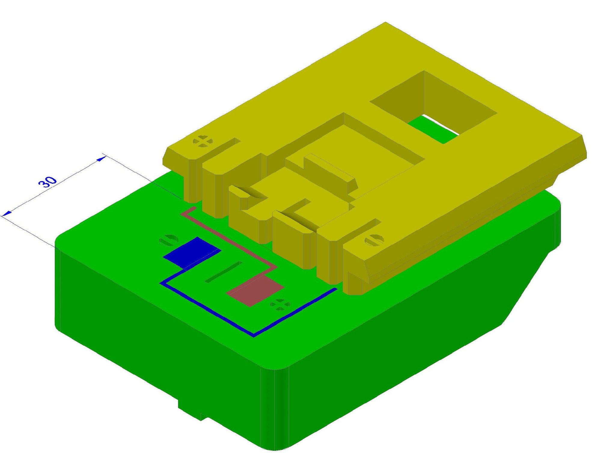

I'd think better without soldering if you can do it

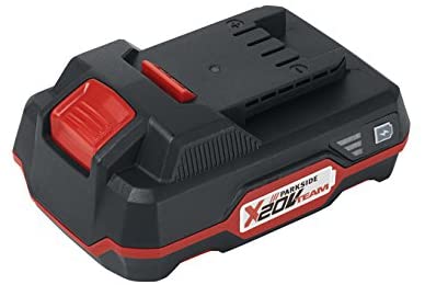

Does anyone know how close the ferrex battery are to the parkside ones?
(I know the parkside is very similar to the draper stormforce) but thinking the strimmer and chain saw may be a good.
