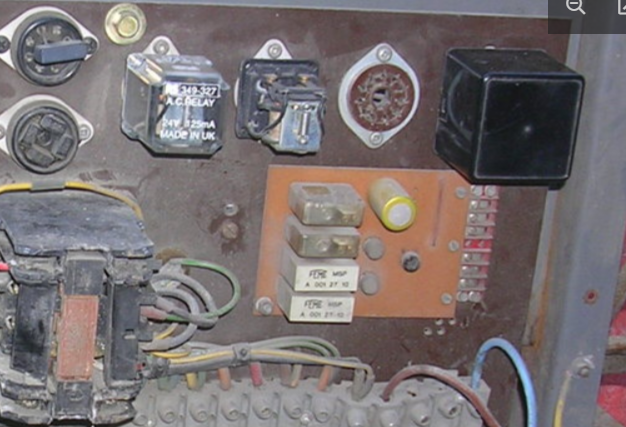

Well the manual's still not viewable.i can not view it. says admin privileges required. i don't believe the print is diy as i scanned it from a manual although it looks like it
i will as soon as i can but it might take a few days. mine still worked when one of those relays fell out. probably the spot weld timer that has never workedWell the manual's still not viewable.
Would you mind reading the missing relay's ID and posting it here, please?

Ring Tech help they usually can helpI noticed the relay with the RS logo on, must be 'relatively' new because they were RadioSpares in them days
I did have a look at rswww.com to see if the number was still relevant, it wasn't which is a bit sad, I was expecting them to still carry it. They probably do but with a different part number.
Any ideas what the middle one is ?

Just had another play around with it. My spot timer is controlled by the relay missing its case, next to the empty space.sorry it has taken me so long to get back to this. just pulled the relay on mine. sorry no markings on it whatsoever it is the same in appearance to the black one next to it except it is 3" long. my machine will still work with this relay removed so i think it's the spot weld timer. i can't check that as it's never worked on mine
