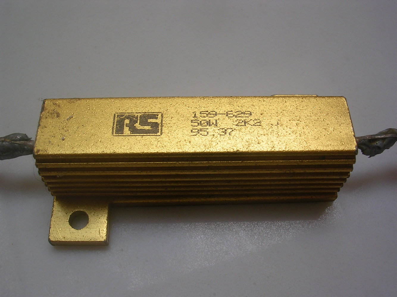

It looks as if the original had been replaced if it's not giving the range, before dashing out and sourcing a new one, measure the current flow through the motor at full speed and also at minimum speed.  That will give a two currents and then the new ww pot size can be chosen a bit better.
