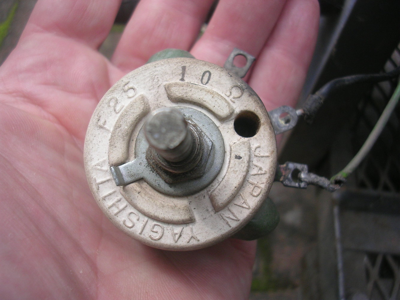

The field coil was being fed 115 vdc in both states, as expected.
The armature - nothing, idling or when triggered.

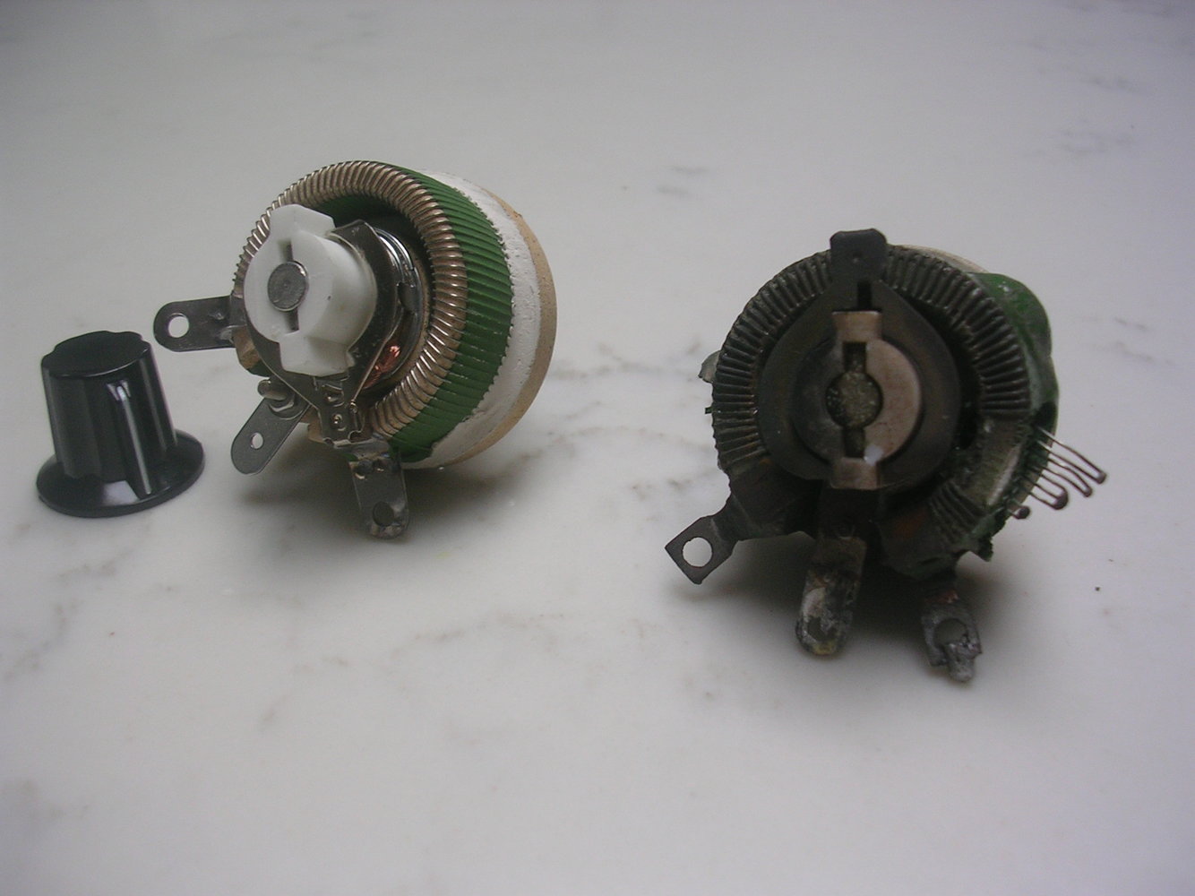

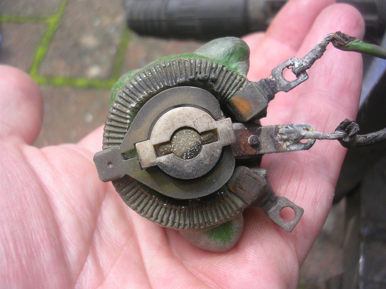

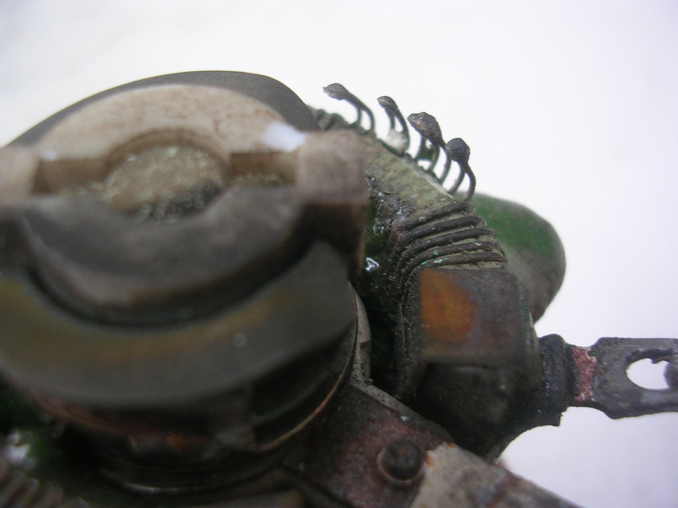

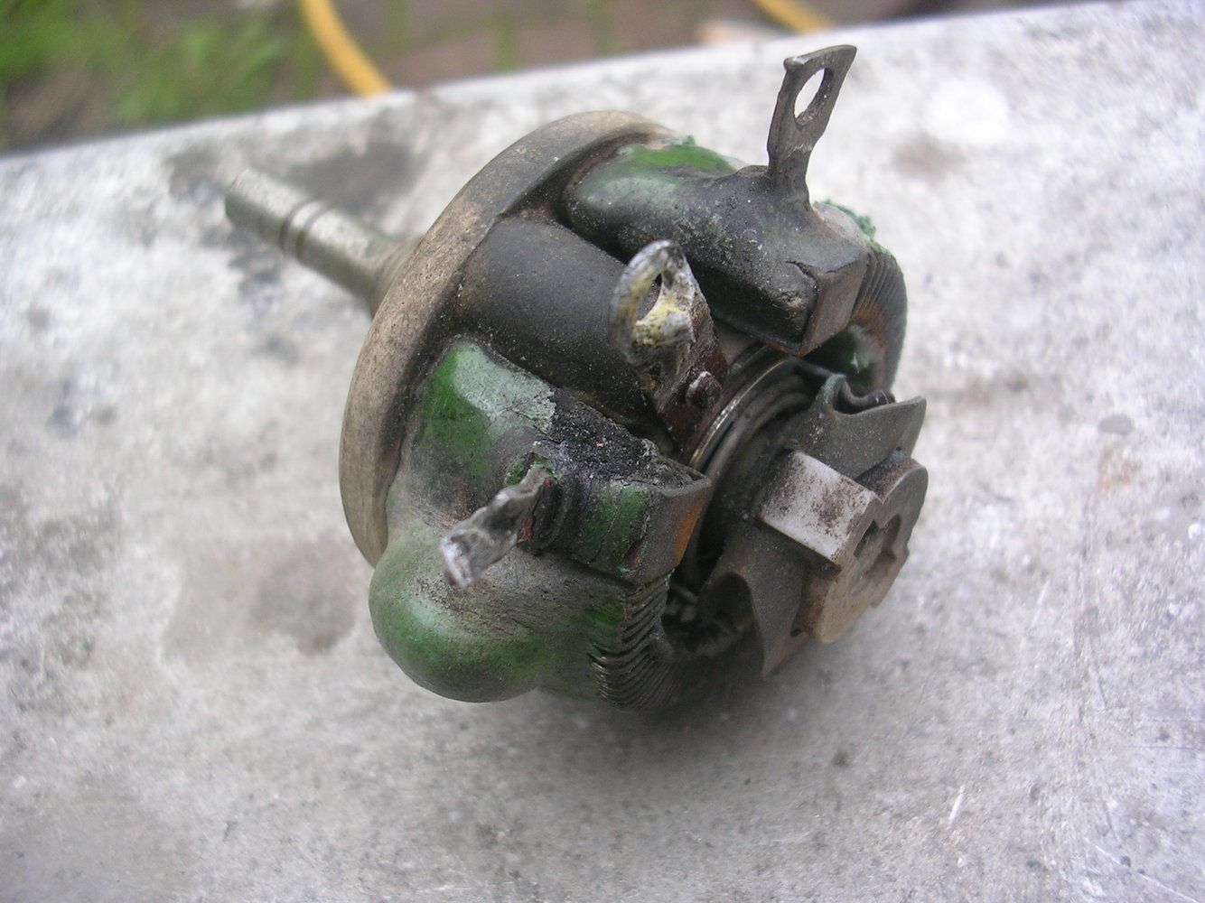

Looking at the pot, yep it has worn on the track and the wiper had to be forced past 90 degrees, whereby it felt awful. I removed it and it has overheated, the damage was clear.
Joined the wires together and the motor now works, slowly, when triggered.
A new 10 Ohm pot, then and it should be sorted, sounds a very low value?
Thanks to all who have helped.
