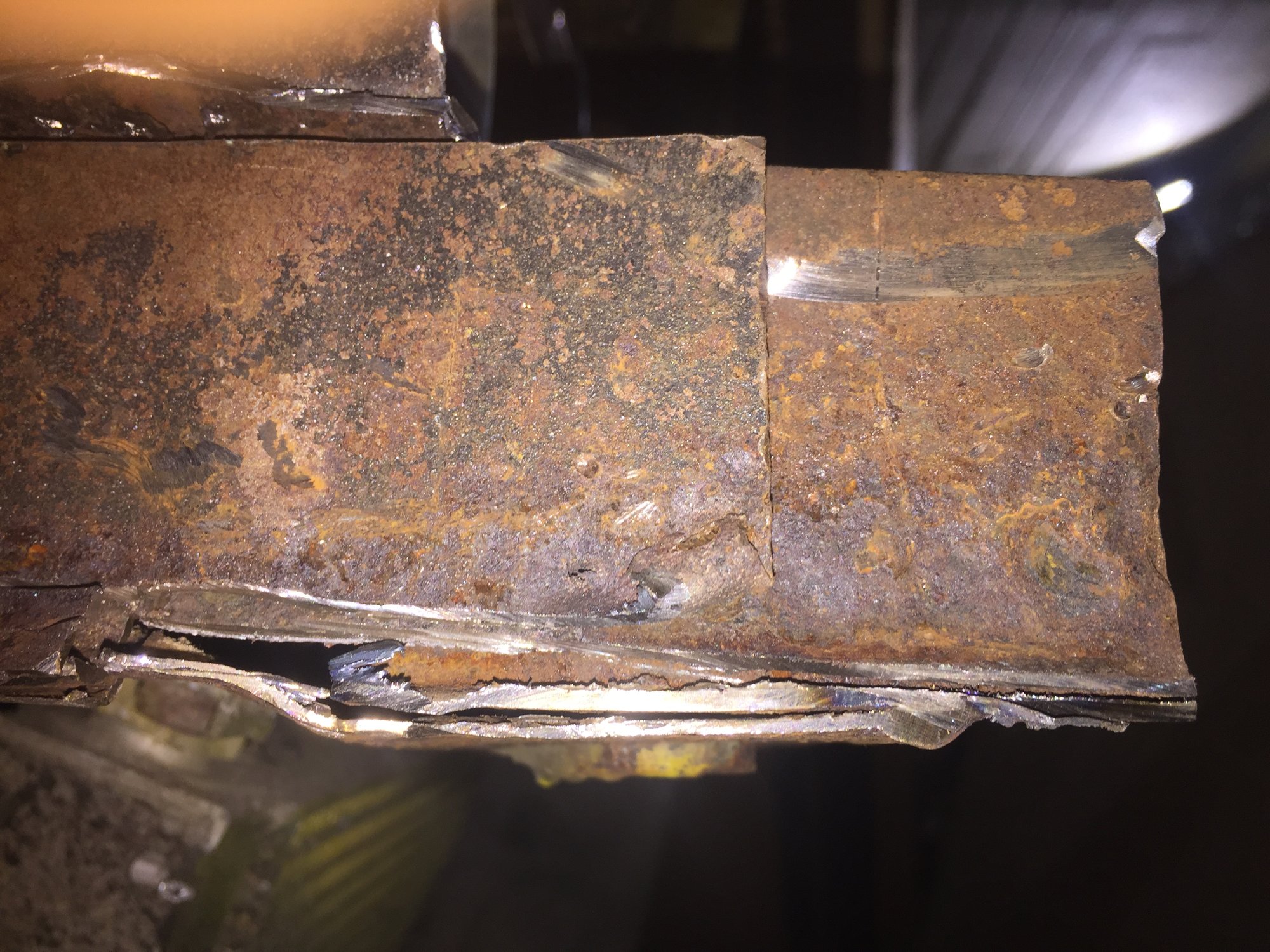

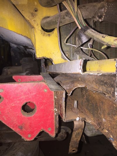

HopefullySoon Member Messages 783 Location Heywood Sep 10, 2018 #241 whats that extra plate hiding .... ahhh that would be this so chassis end leg repair needed 092F63D7-BE5B-4614-8BFD-21396031F756.jpeg 642.1 KB · Views: 87 Last edited: Sep 10, 2018

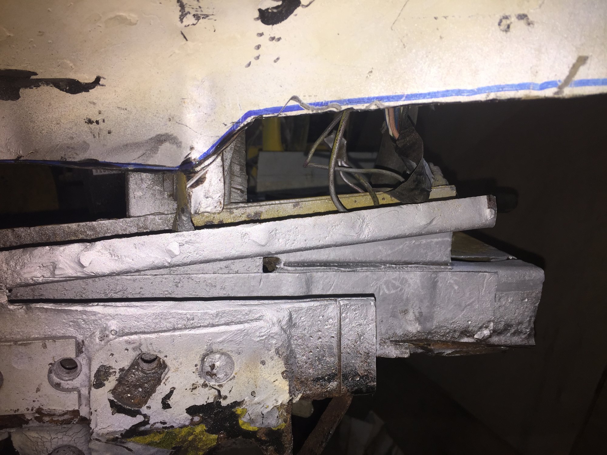

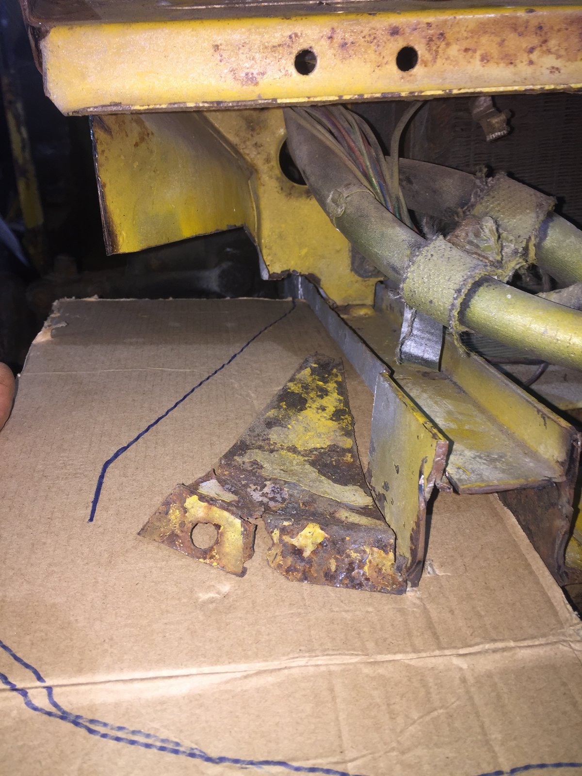

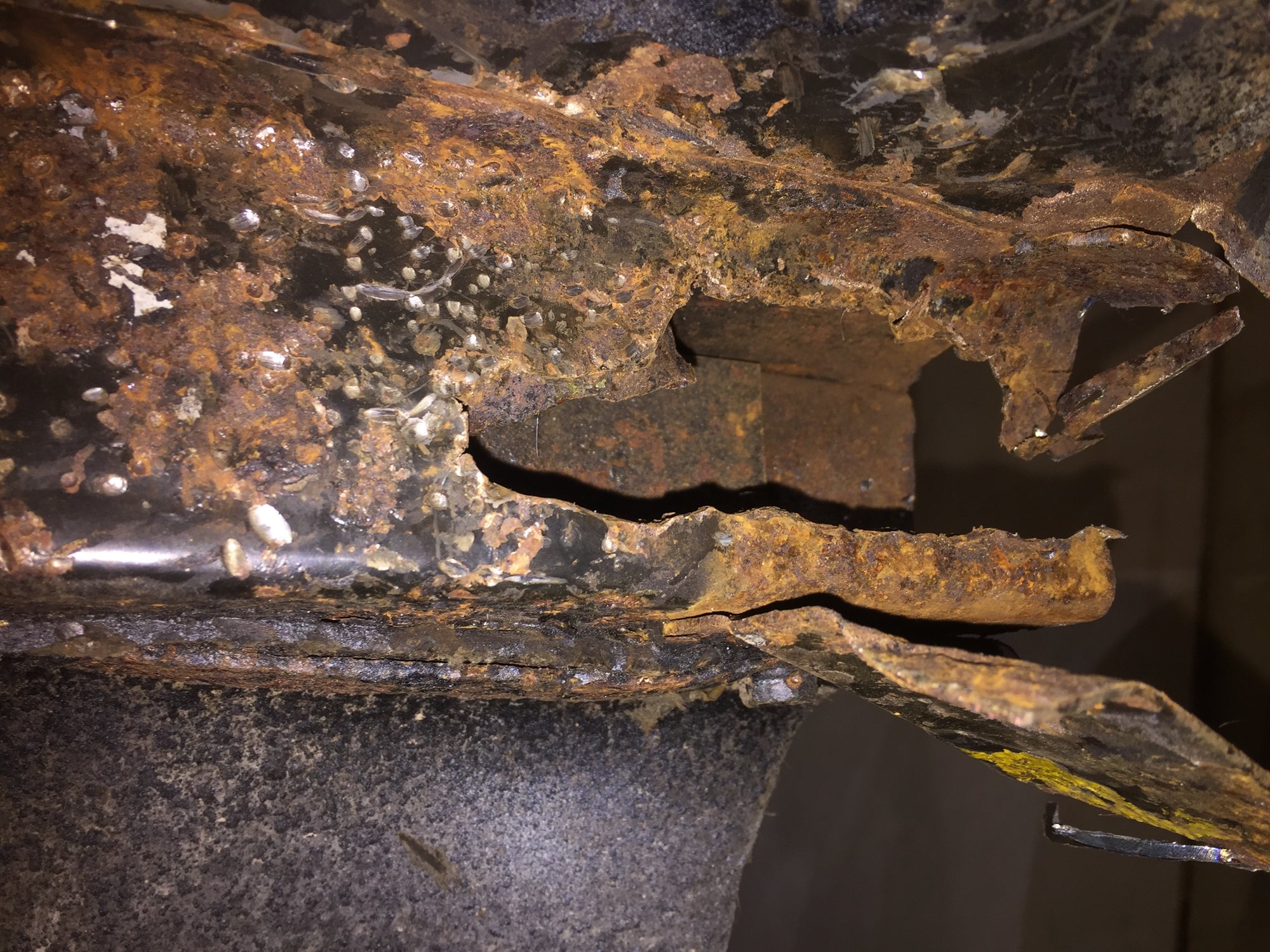

HopefullySoon Member Messages 783 Location Heywood Sep 16, 2018 #242 Work continued today on the pic above (Drivers front chassis) Cut the rot back to this so far 658AA4CF-1642-462D-9961-E87C11FA64A7.jpeg 499.6 KB · Views: 91 66857E67-FE3A-4A08-8A3C-45C3027FA5C2.jpeg 428.7 KB · Views: 141 00FE4144-7D33-43E8-9910-B43E5AD49041.jpeg 269.1 KB · Views: 92

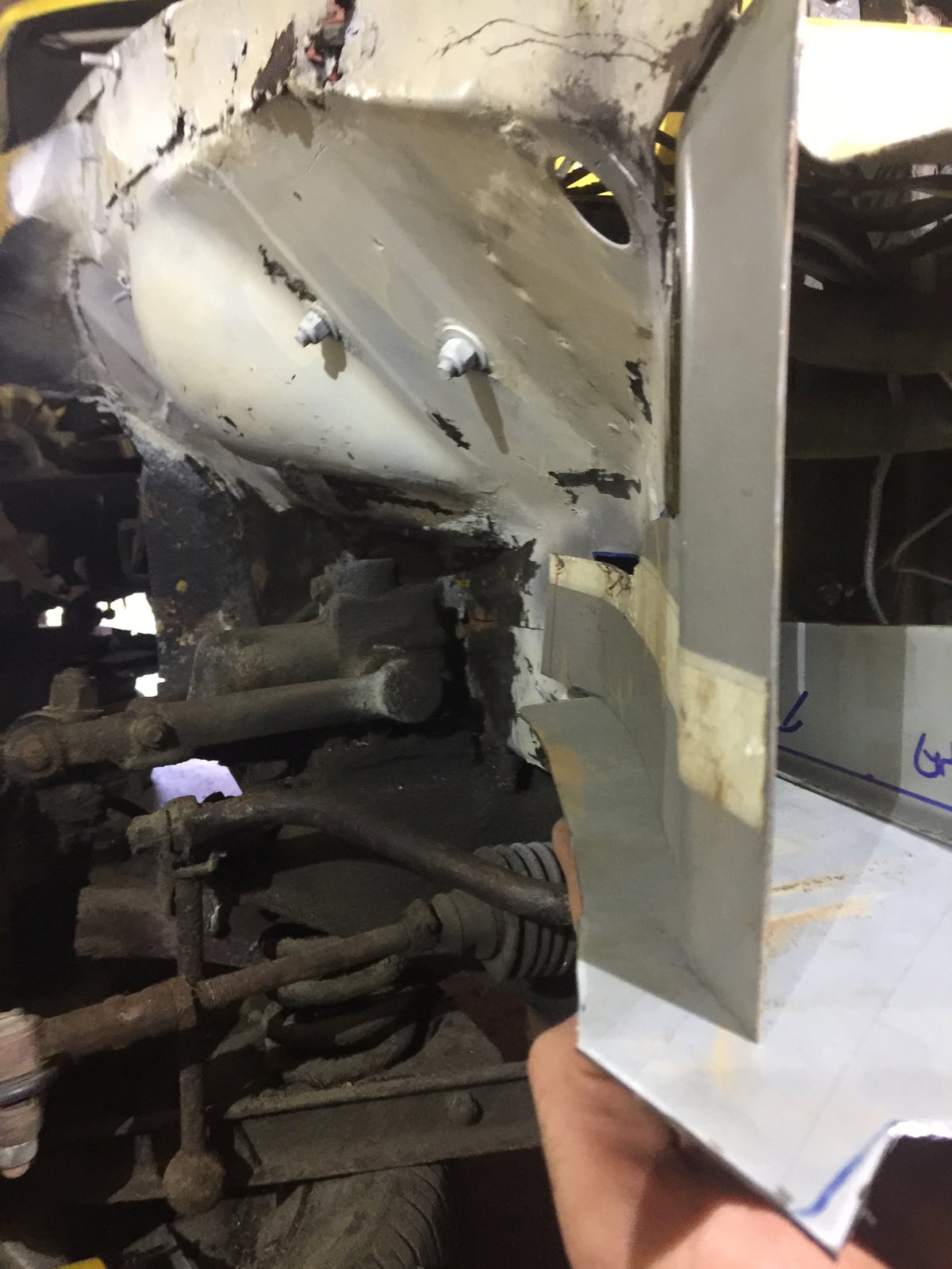

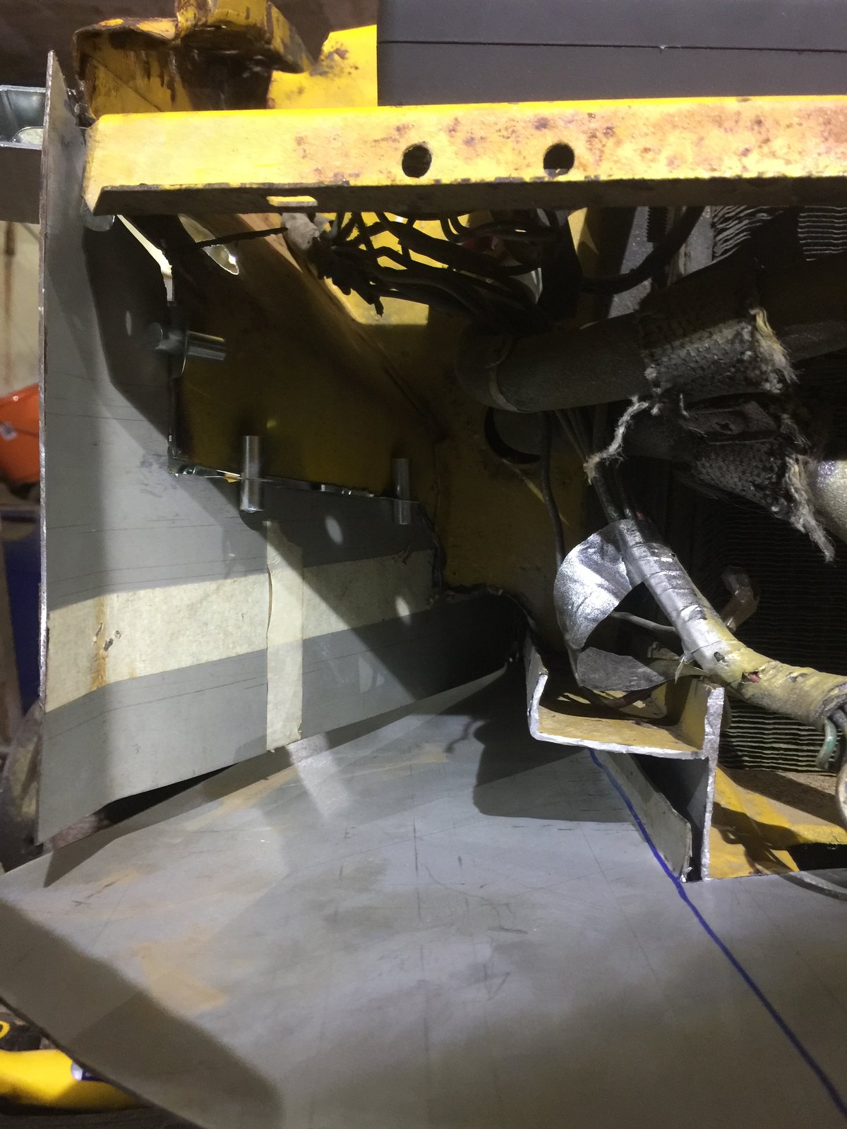

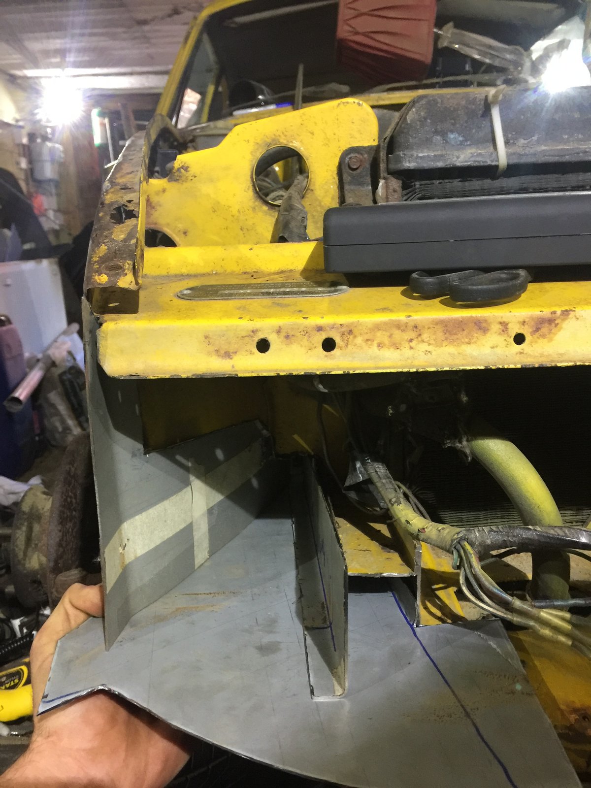

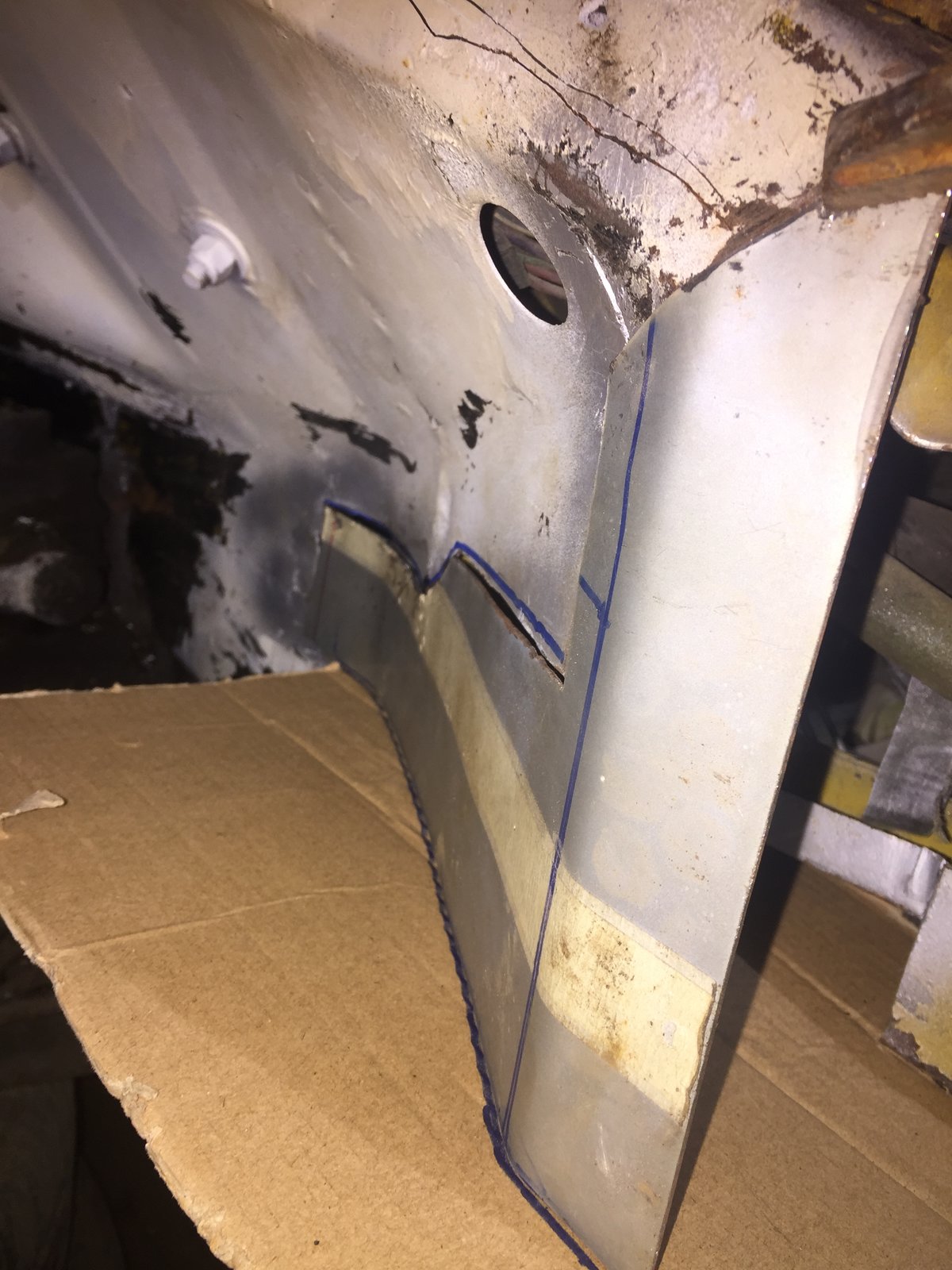

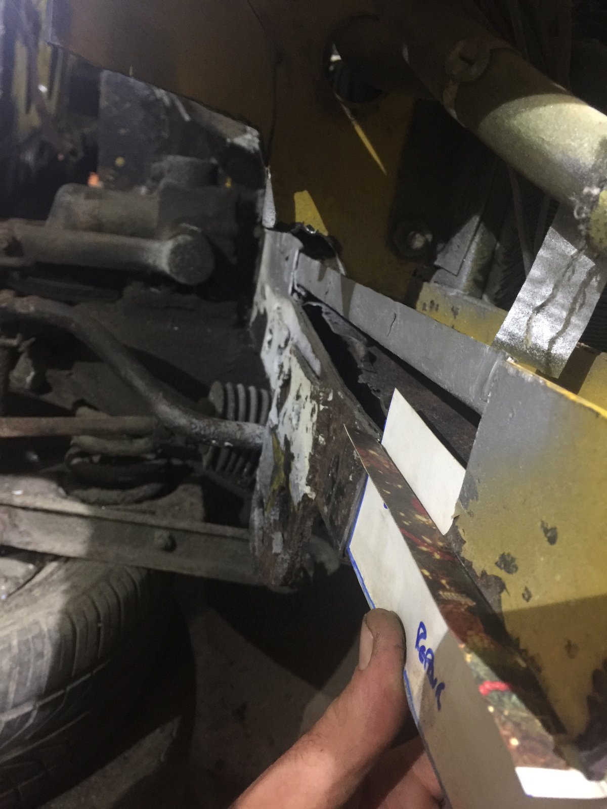

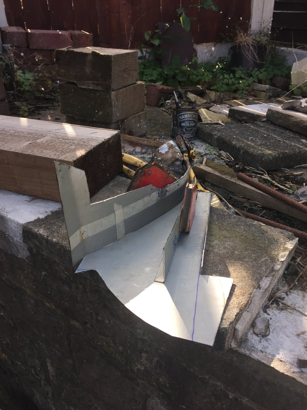

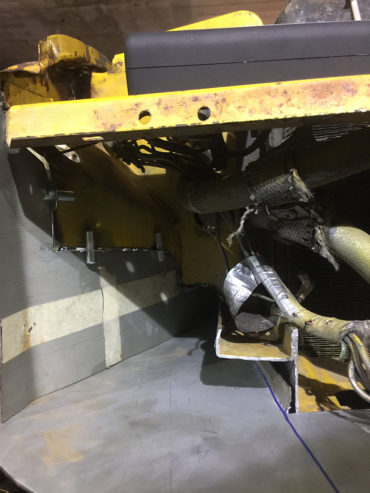

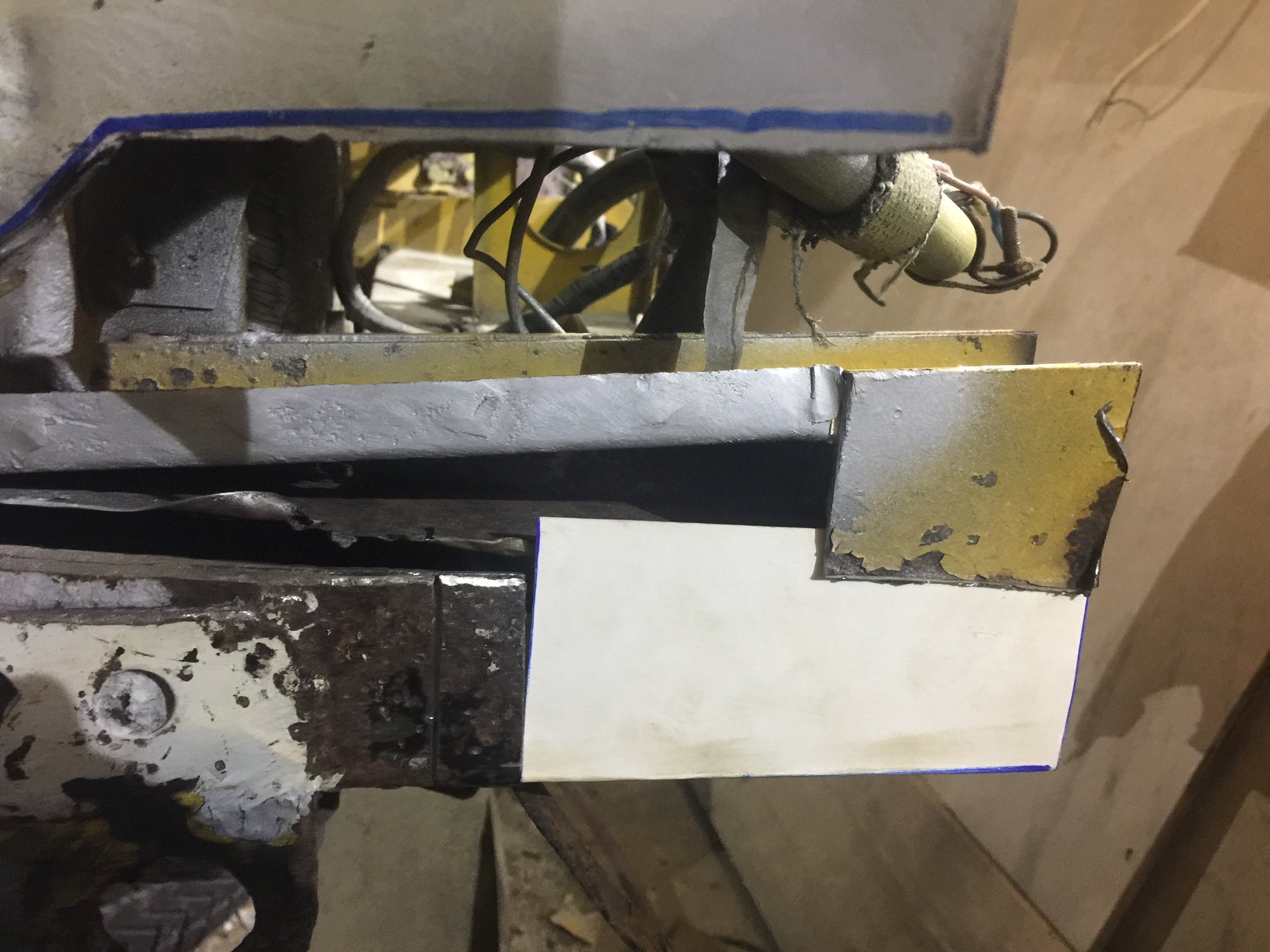

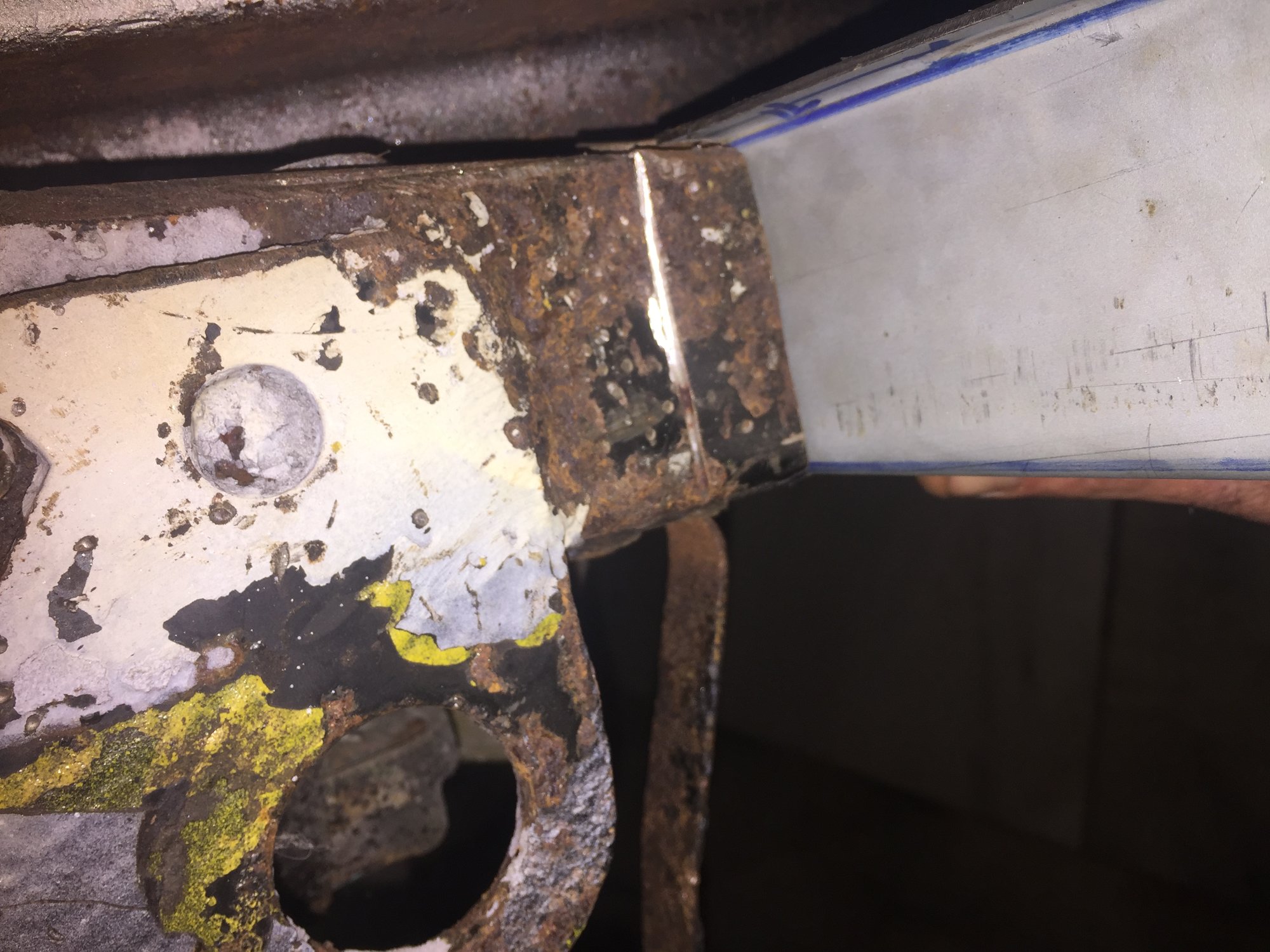

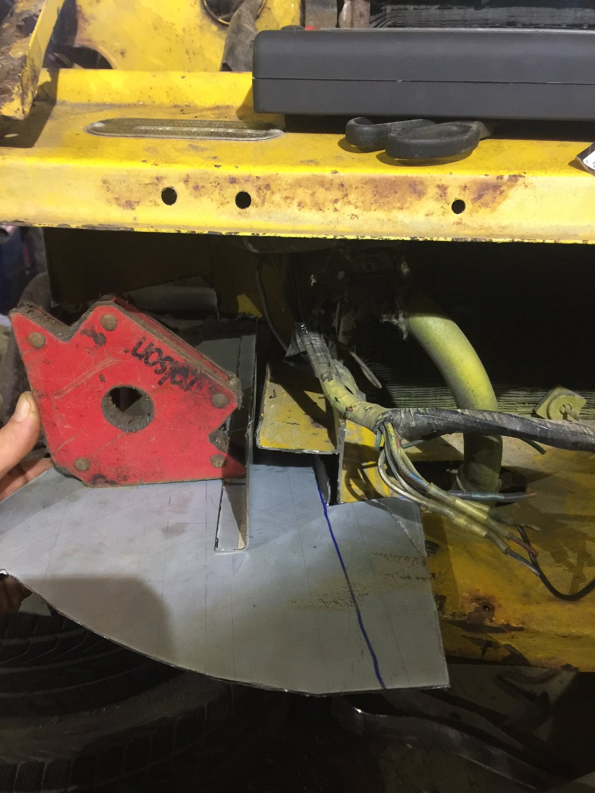

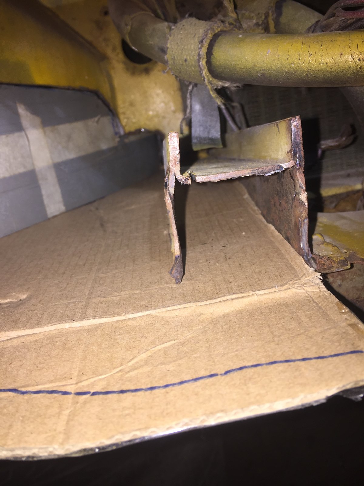

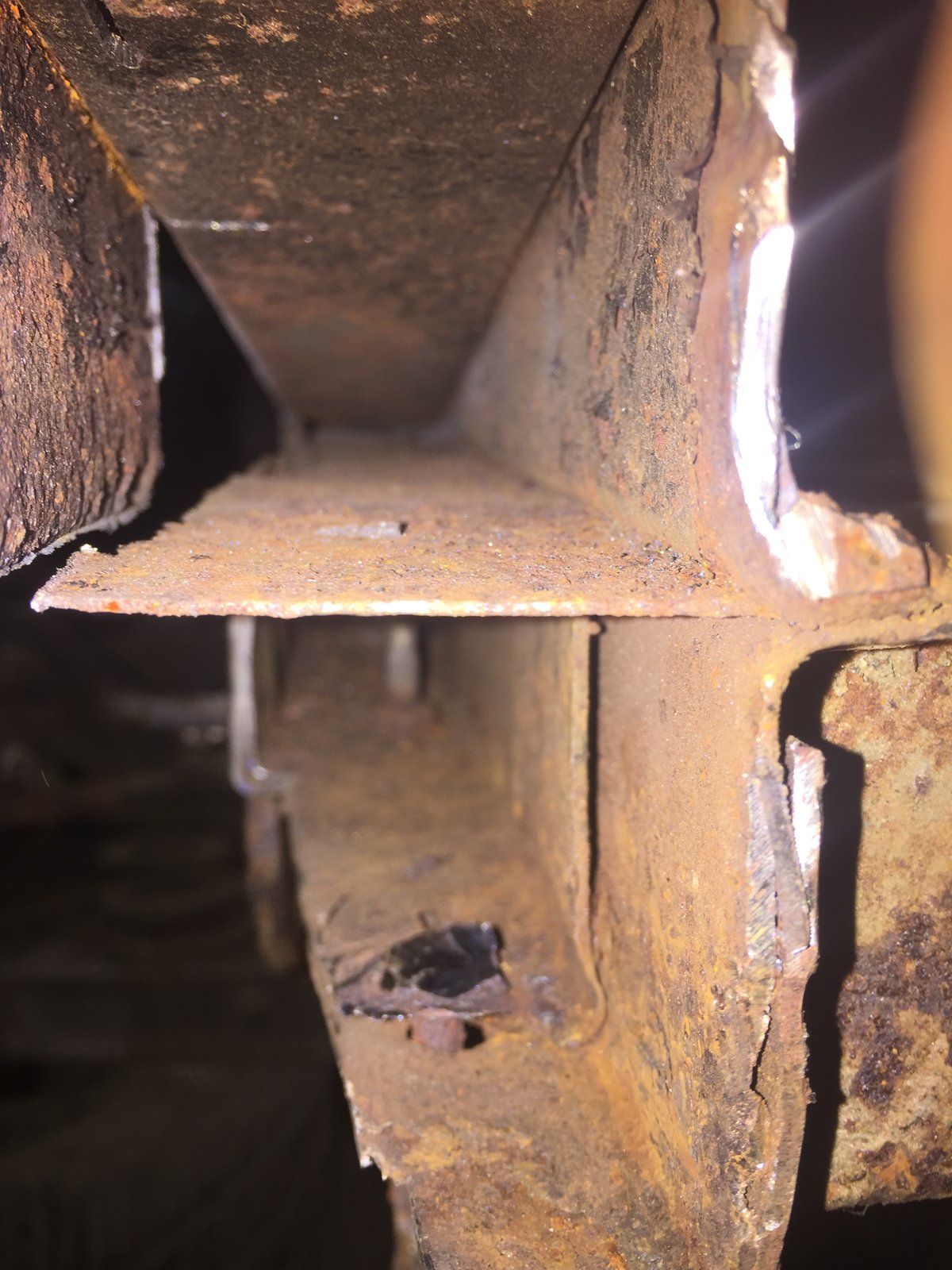

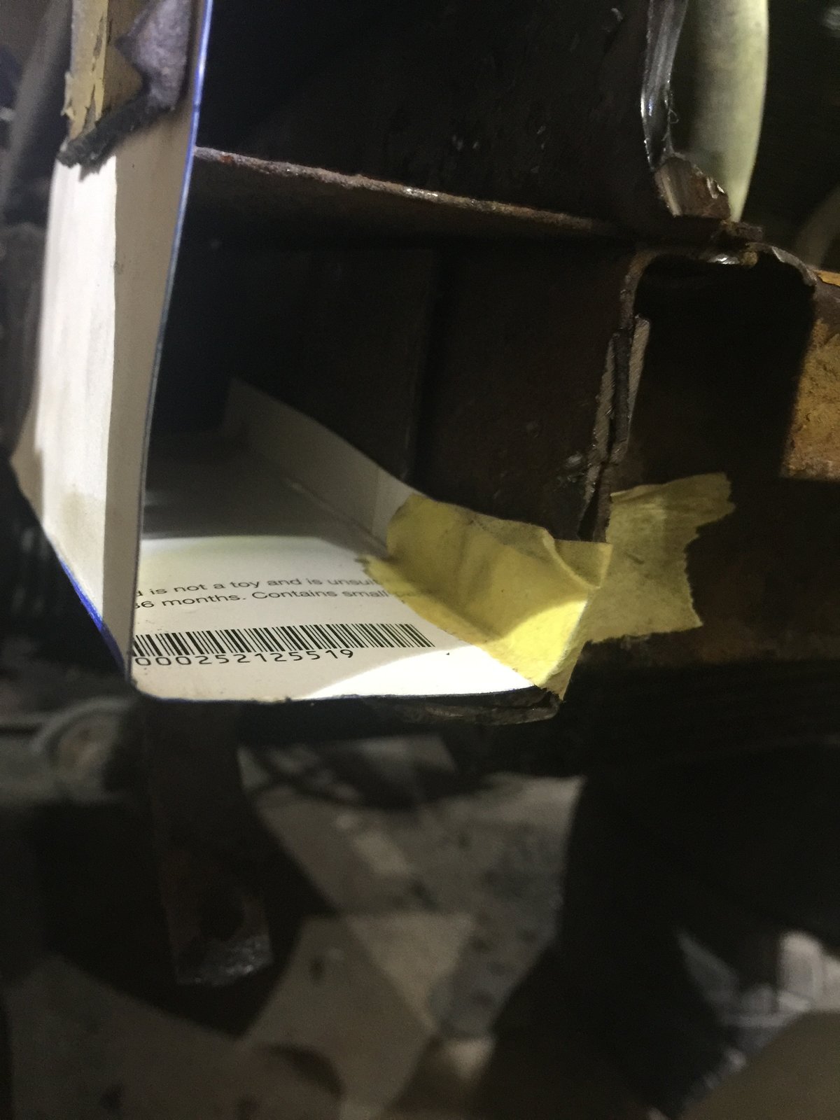

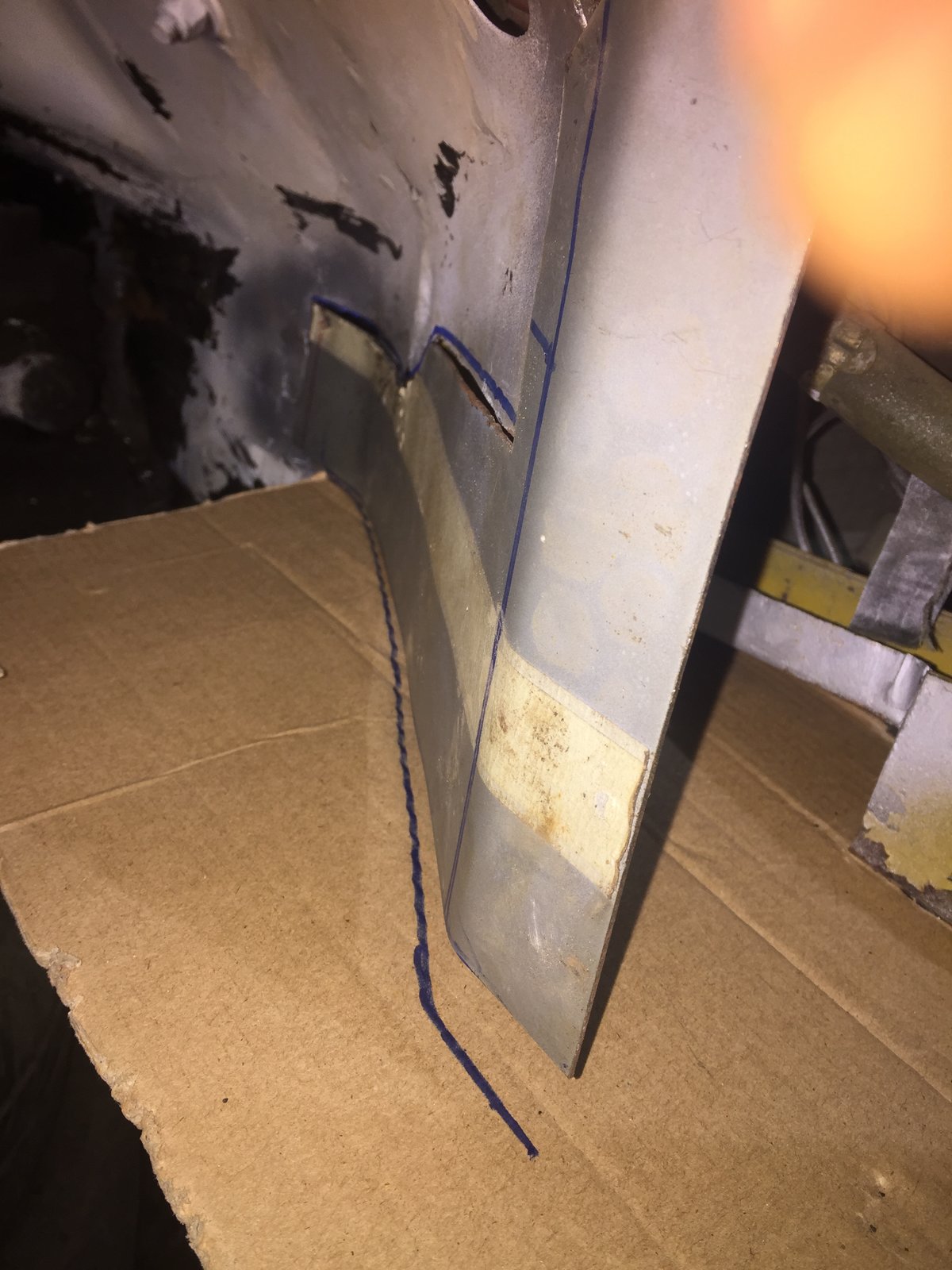

HopefullySoon Member Messages 783 Location Heywood Sep 16, 2018 #243 Started to make up the repair templates Inner first 998F33F0-199B-431D-8BF7-C1ABBA40945B.jpeg 192.4 KB · Views: 85 6423EE91-6465-43BC-A32A-2348982745BE.jpeg 391 KB · Views: 96

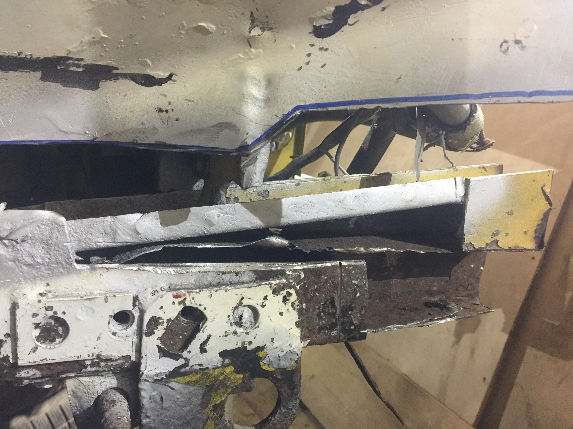

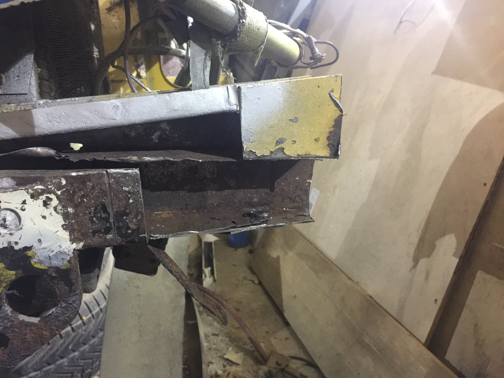

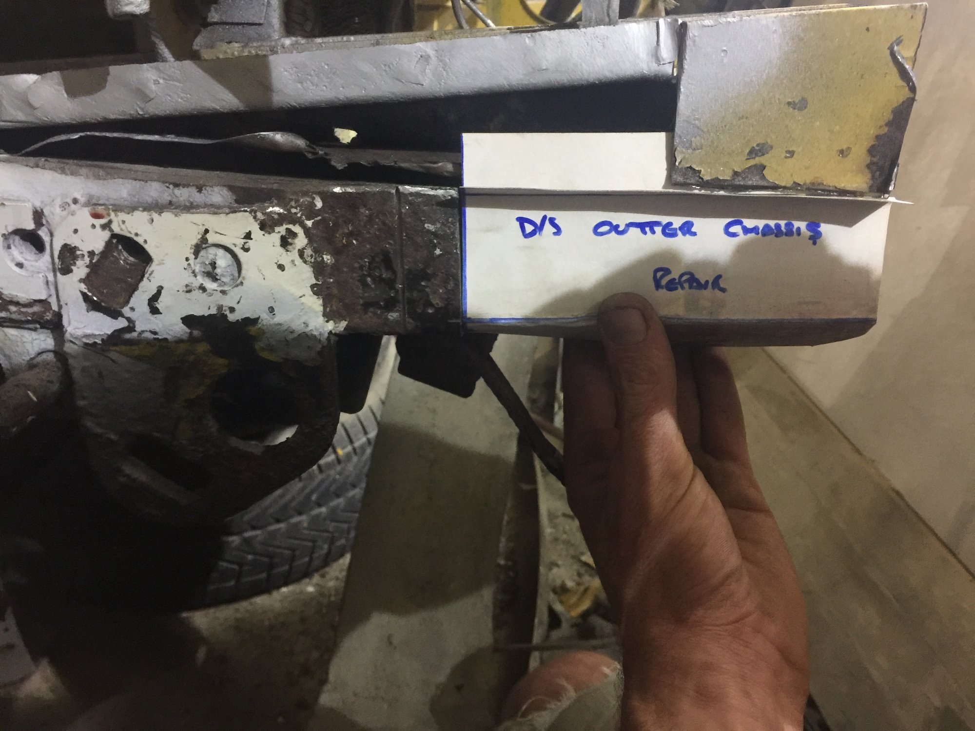

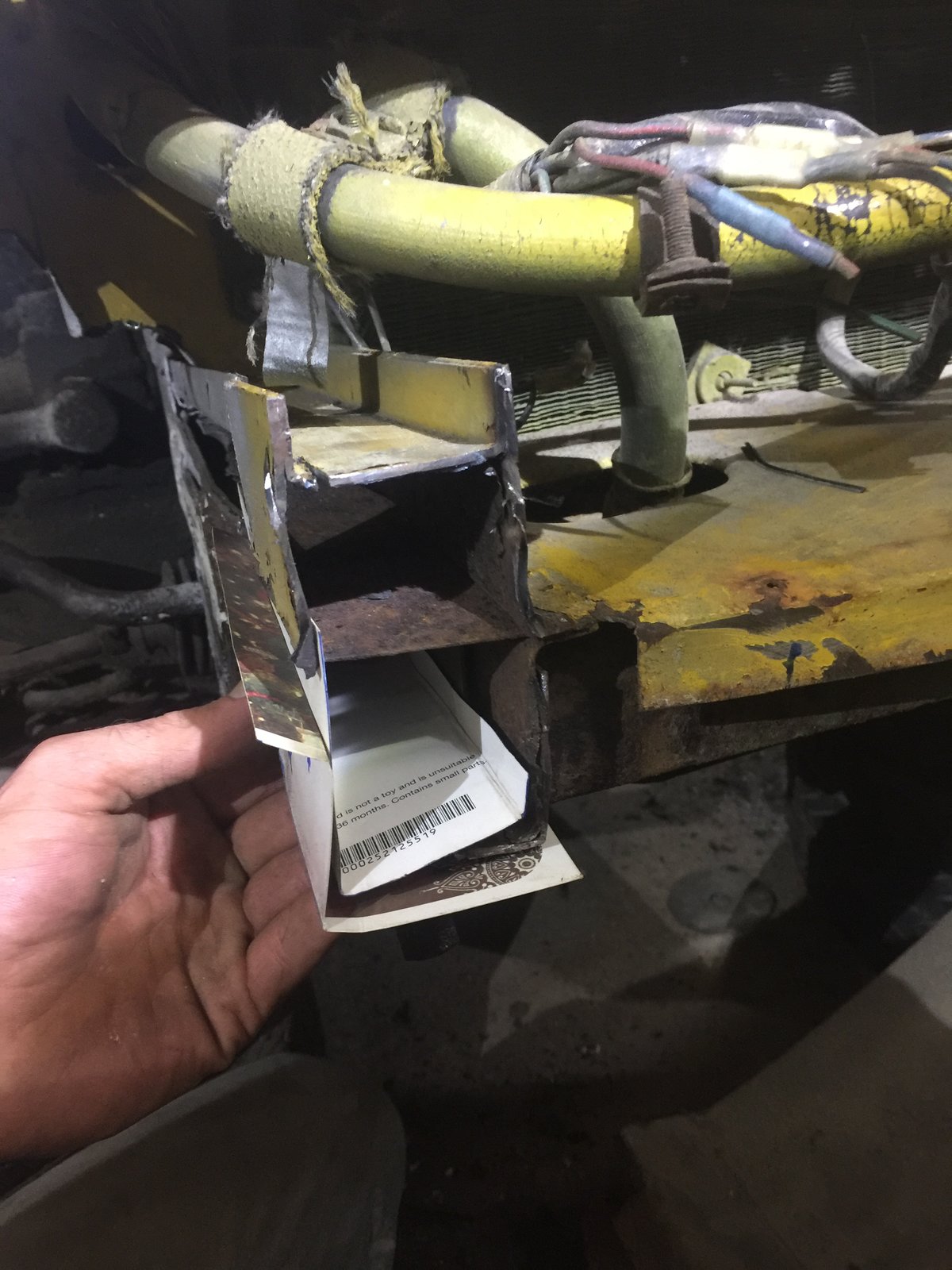

HopefullySoon Member Messages 783 Location Heywood Sep 16, 2018 #244 Then outer 7B3AC532-3C2E-49BD-BF71-FBA1A0B694B6.jpeg 242.9 KB · Views: 89 FA5FDA03-2DF0-4D98-AA0B-F47EF8FE6882.jpeg 386.1 KB · Views: 95 64679624-ECE0-44BF-B582-8DF772CB595E.jpeg 225.3 KB · Views: 86

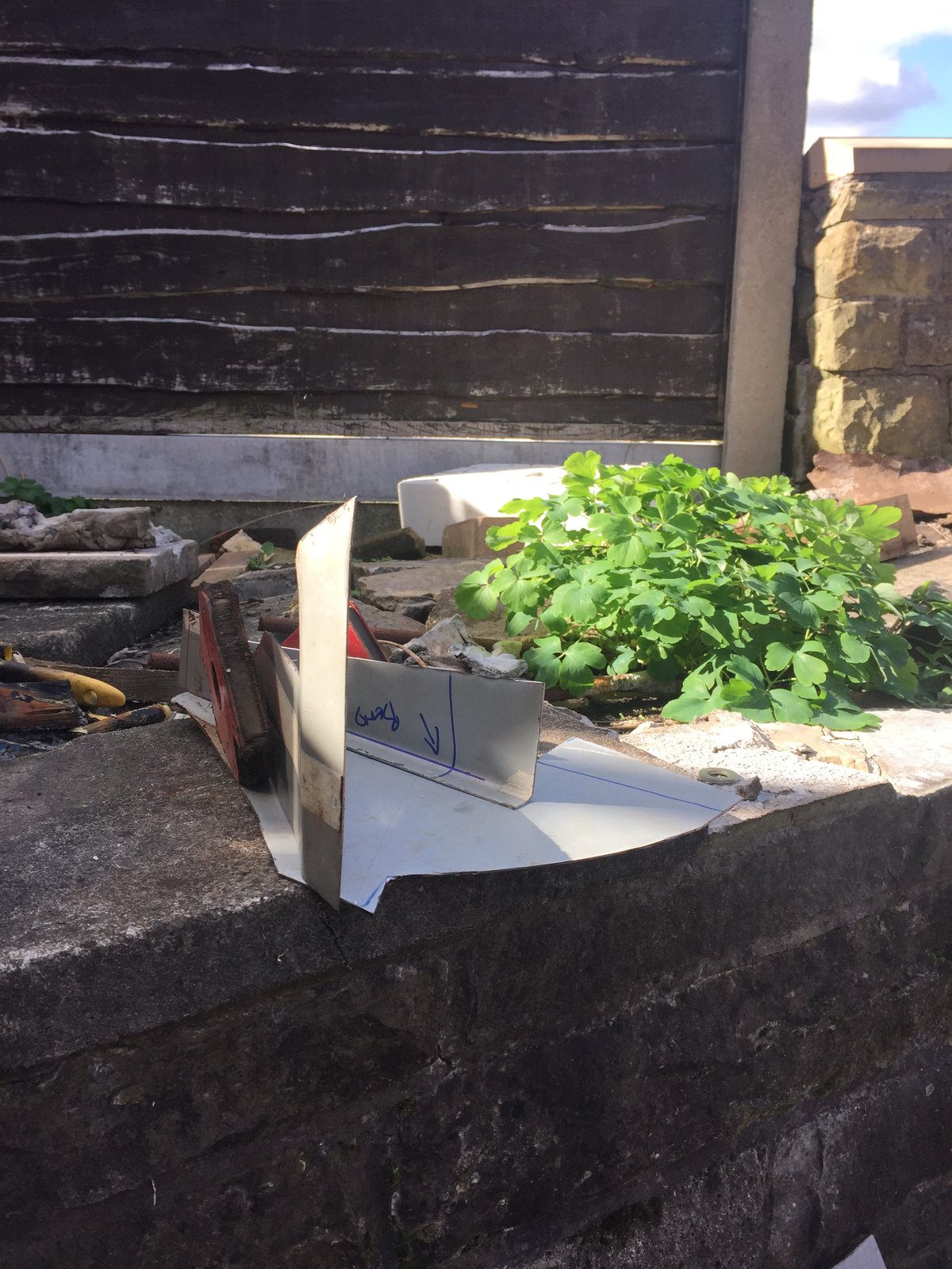

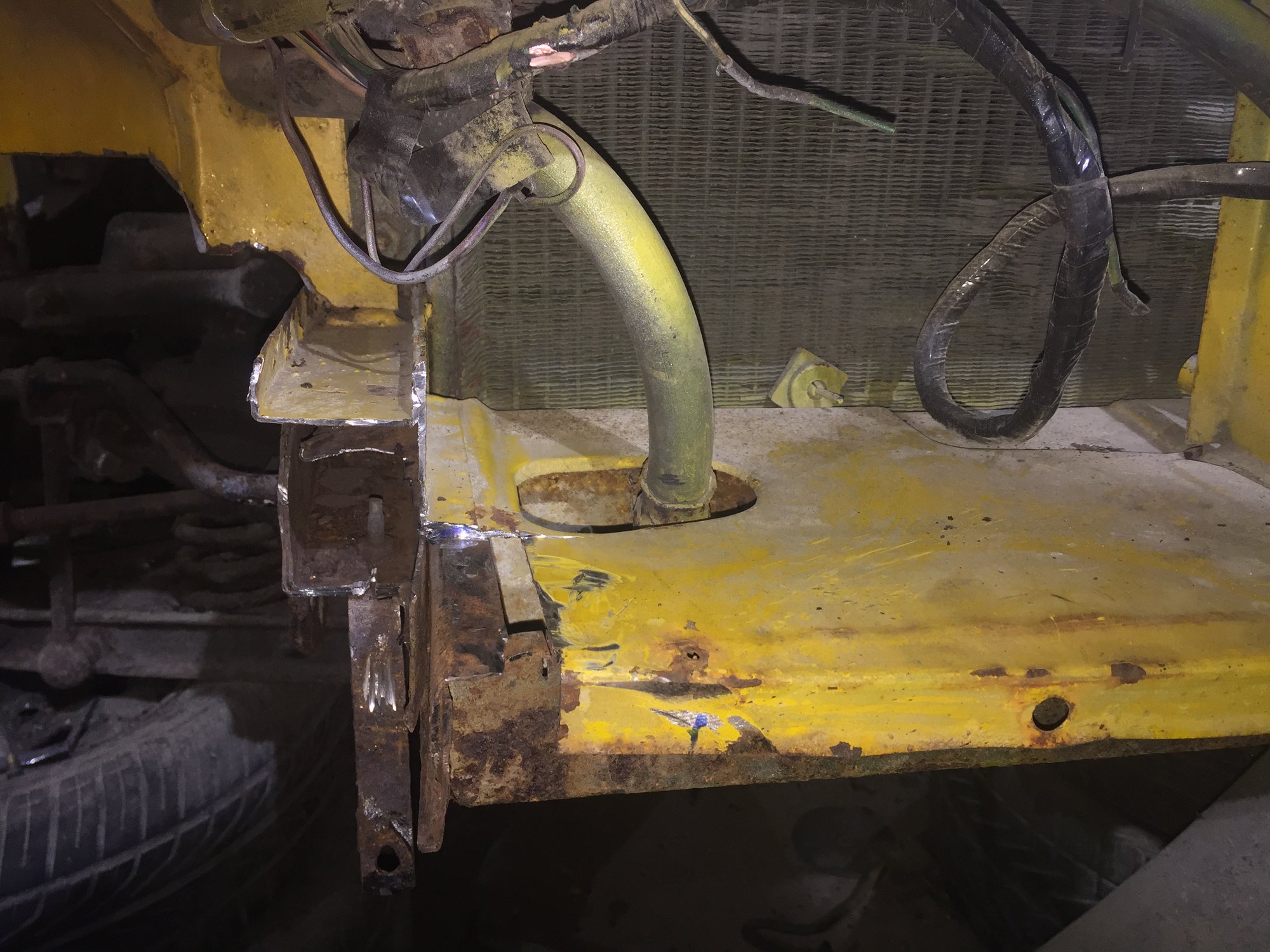

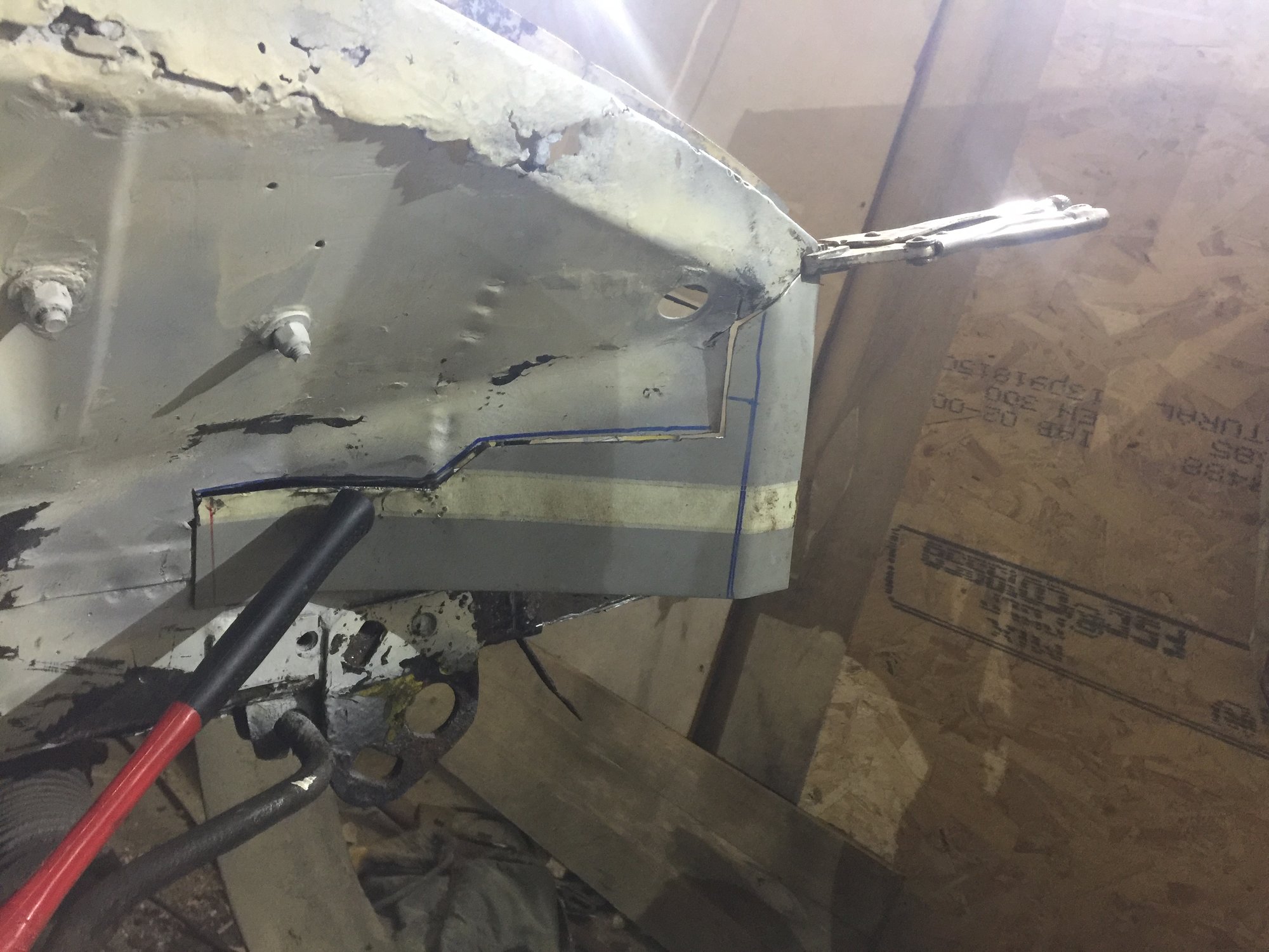

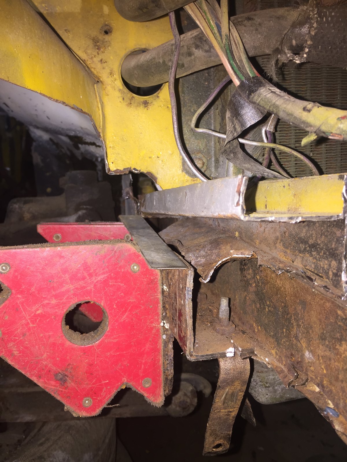

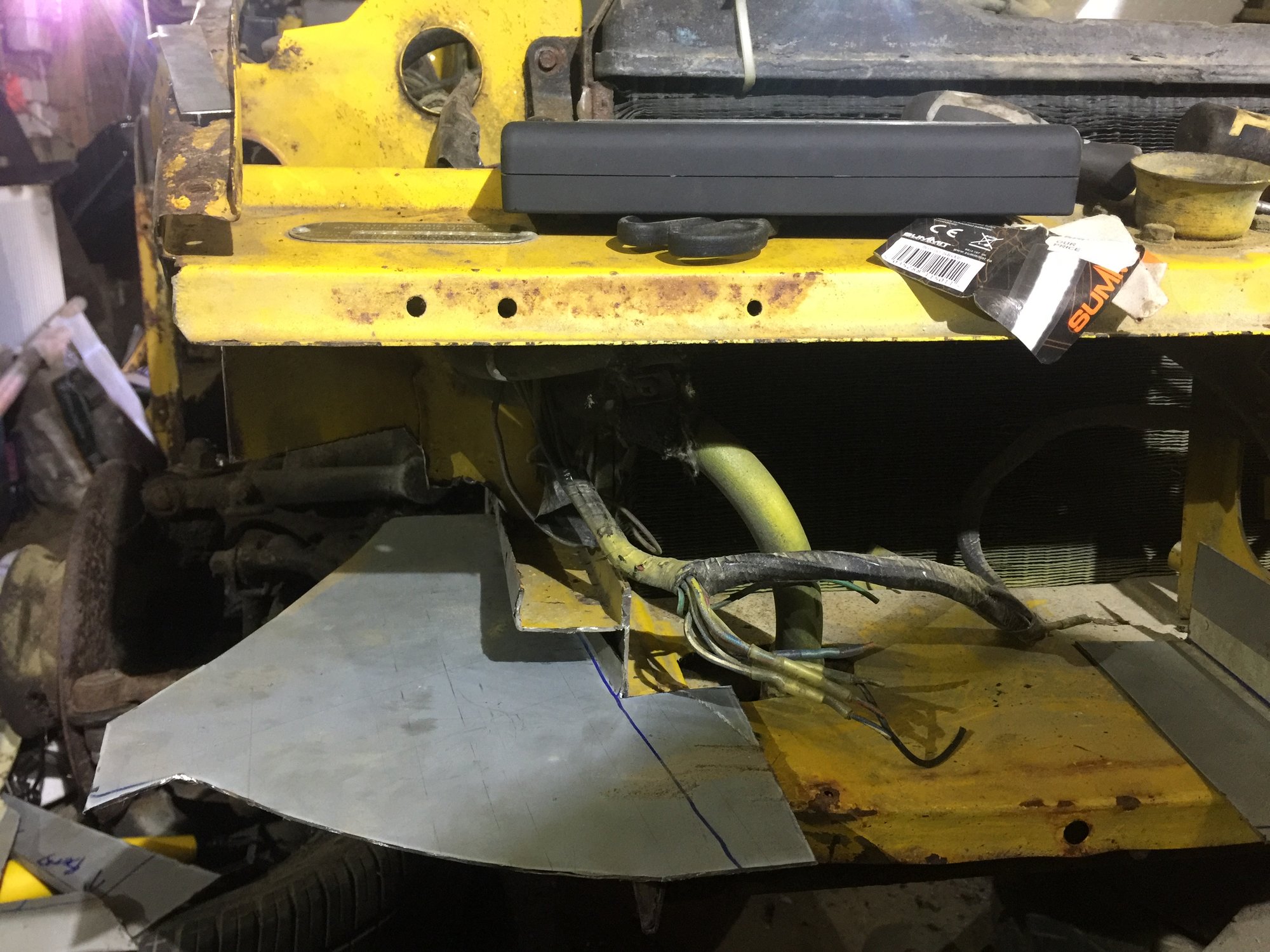

HopefullySoon Member Messages 783 Location Heywood Sep 16, 2018 #245 Still need to decide how I’m going to tackle the steel that runs from one side to the through the rail And got the repair for the inner wing nearly trimmed down to hide all the above 07F38168-8E8E-4CBE-94A5-F696A8F3E8EB.jpeg 361.7 KB · Views: 104
jpmillermatic Member Messages 1,094 Sep 16, 2018 #246 good work, there! Which piece runs through the rail? is it that horizontal cross piece we see that just needs to be extended to fit? makes me wonder how it all was constructed in the first place. JP
HopefullySoon Member Messages 783 Location Heywood Sep 16, 2018 #247 Hi JP Cheers mate The top pic in post 244 shows it best I think for ease of manufacture the same sheet went horizontal through and upper/lower chassis rails welded thru it It extended further to the left untill it go chopped up to the wheel arch repair piece ... Problem is I can't join it as its too far gone further to the left in a side on pic Last edited: Sep 16, 2018

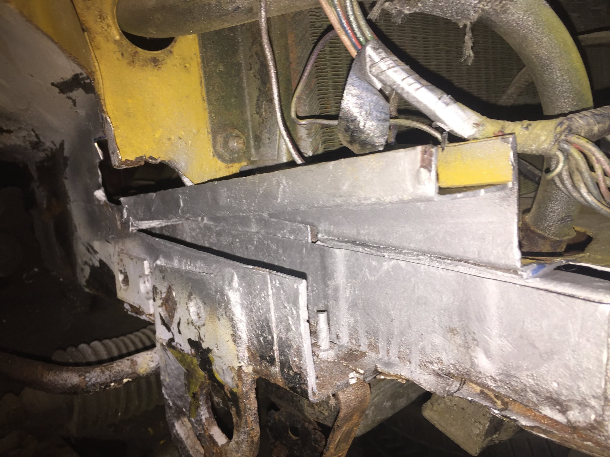

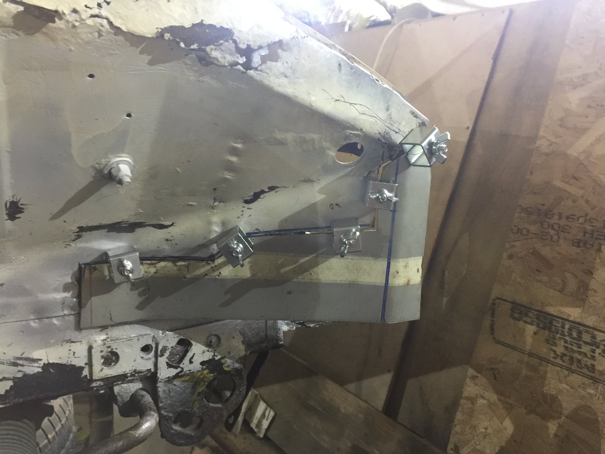

HopefullySoon Member Messages 783 Location Heywood Sep 21, 2018 #248 Work rolls on on the chassis repair From the inner / outer cardboard templates for the chassis repairs steel ones were made 7B20E890-650E-40BE-8617-6BCA2C3EC24E.jpeg 299.8 KB · Views: 82 C6D2E44D-FC73-400F-97A0-4B4E57C4F449.jpeg 402.1 KB · Views: 89

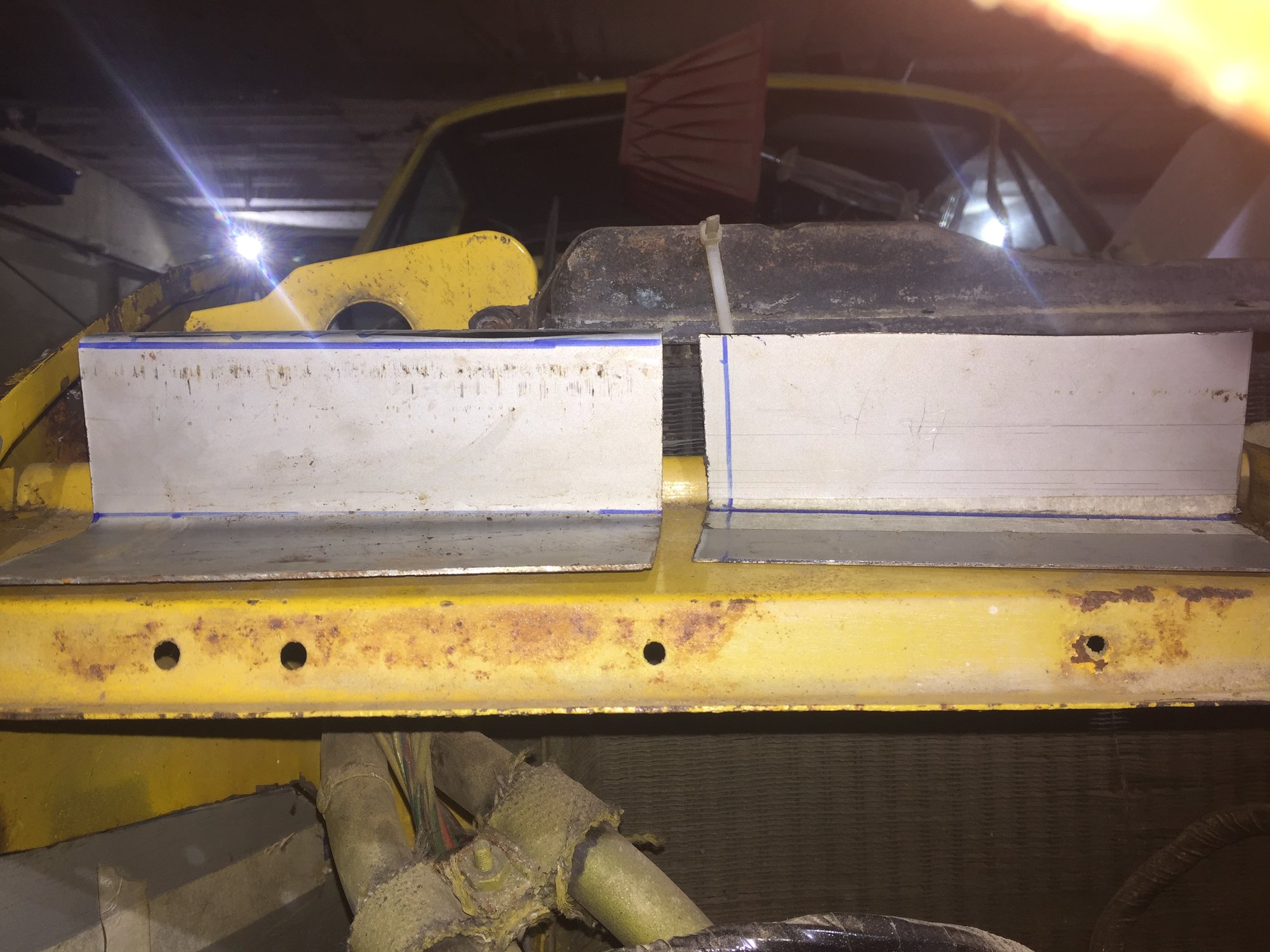

HopefullySoon Member Messages 783 Location Heywood Sep 21, 2018 #249 Check the outer for fit ... yep that’s good to me 0E9B0D82-0733-435D-A1D2-351B83594AB8.jpeg 393.3 KB · Views: 87

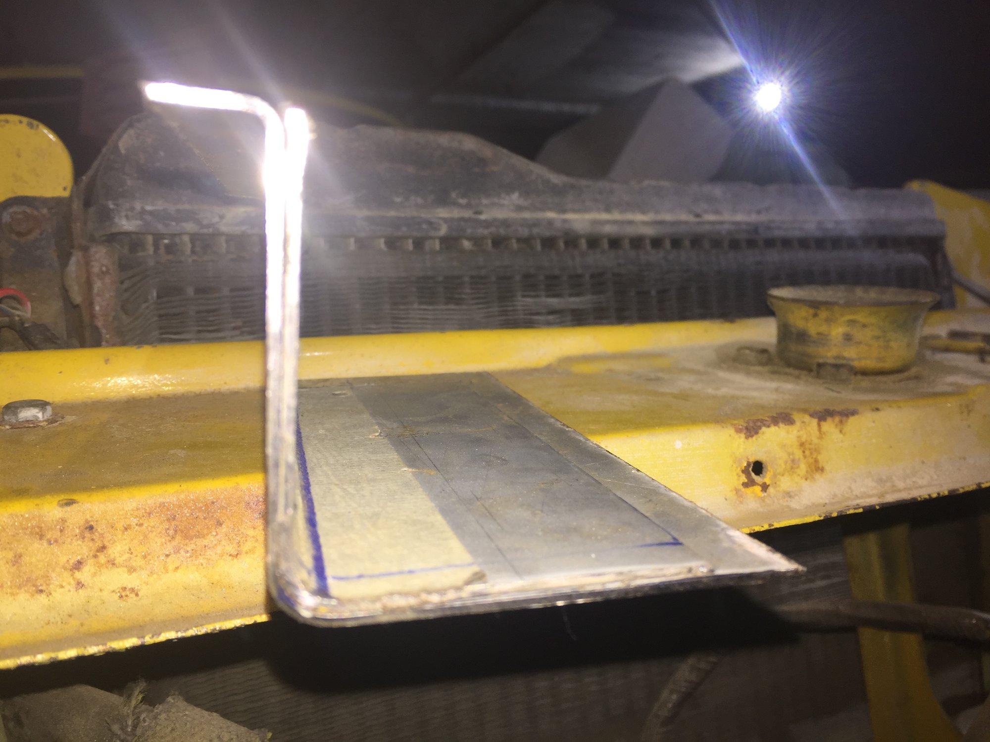

HopefullySoon Member Messages 783 Location Heywood Sep 21, 2018 #250 Decided to fold and plug weld the inner chassis through steel so started to fab that up BFB0747F-7A68-46FC-8799-5D558612C320.jpeg 243.9 KB · Views: 88 B867A70D-0564-4545-994D-2FFEFC9FBB4D.jpeg 242.3 KB · Views: 87 9F40C2DF-D762-4B3D-909C-90BC1A1A53F0.jpeg 254.8 KB · Views: 85

HopefullySoon Member Messages 783 Location Heywood Sep 22, 2018 #253 Managed to catch an hour while SWMBO was out Top chassis rail cut back 3 “ ready for the inset chrome grill .... front valance prepared ready for the new steel ... or so I thought till I looked at the photo again EFA21E70-094F-416A-9031-14AAE3BAE124.jpeg 463.7 KB · Views: 93 1E310C58-D2E3-454D-95E9-8F0E7187BD39.jpeg 286.4 KB · Views: 87
HopefullySoon Member Messages 783 Location Heywood Sep 22, 2018 #254 need to be more presice cutting ... very big note to self DB23E5F3-16C7-47B0-A715-26EEBA55A3BF.jpeg 558.7 KB · Views: 85

HopefullySoon Member Messages 783 Location Heywood Sep 23, 2018 #256 Try them out for fit on the car ... heading the right way and still room for adjustment Bit stuck now till the clamps and Cleco pins arrive so I can sort out final fixing positions 13382FBA-383F-4F55-B8D5-0A929E38F70E.jpeg 448 KB · Views: 91 F3239BC6-3B3B-493D-9BA4-65558DE7FA66.jpeg 258.9 KB · Views: 82 36C5AD2F-8D17-4978-B936-BBF20F6152CF.jpeg 282.7 KB · Views: 93 D15417C8-FD75-43A4-9837-C953B792C626.jpeg 223.8 KB · Views: 88

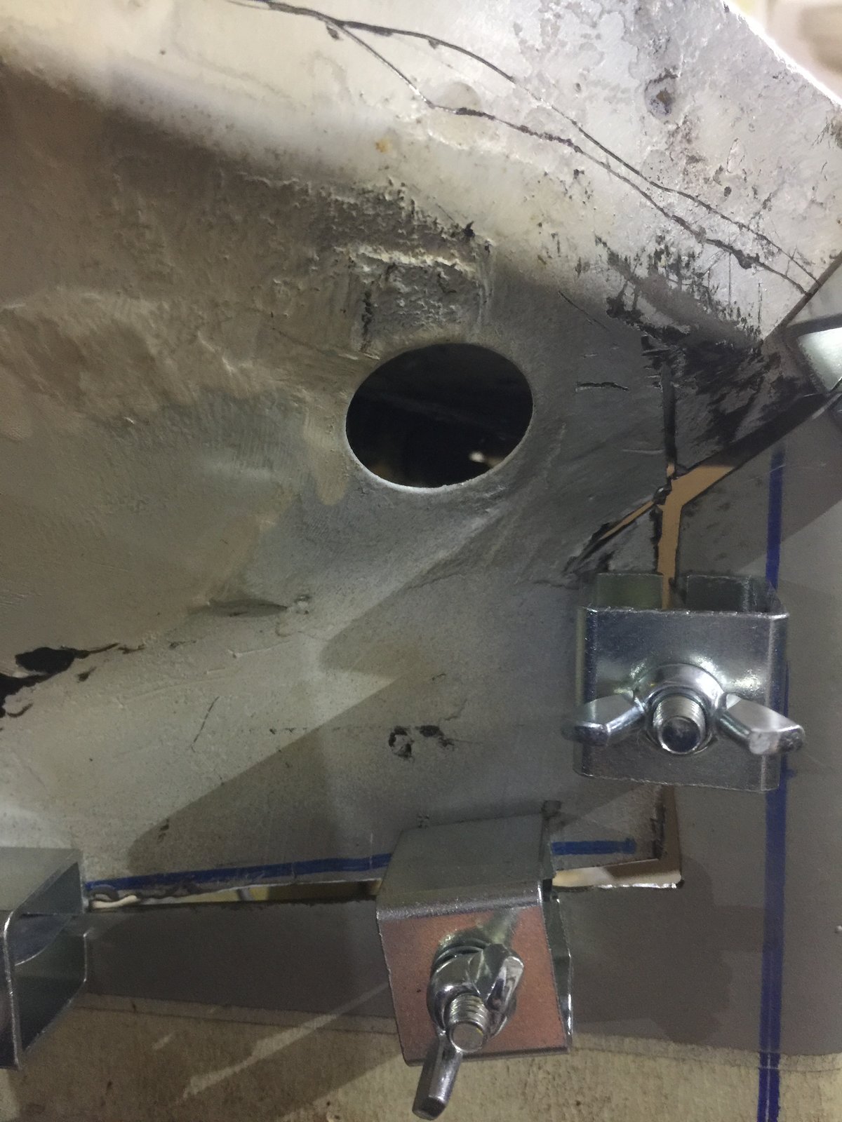

HopefullySoon Member Messages 783 Location Heywood Sep 25, 2018 #258 Managed to grab an hour to do a bit .... Inner steel cut out / cleaned up and weld primed up Had to buy a dremel to get it out ..... bahhh 7613971E-B6BE-4D76-98CF-BBF7DE6A0A02.jpeg 531.1 KB · Views: 103 B1AF1562-2E3F-4D8D-B701-81B4E00258EE.jpeg 466.8 KB · Views: 92

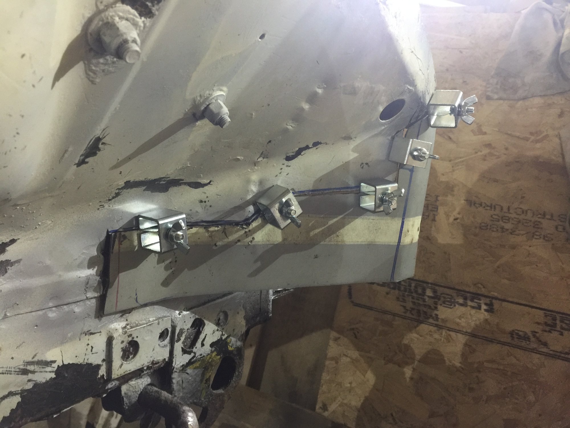

HopefullySoon Member Messages 783 Location Heywood Sep 25, 2018 #259 Intergrip / cleco arrived half an hour before I was needed elsewhere , typical ... But I couldn’t resist a quick Mock up with the intergrips DFDBF2FD-3DA5-4963-8E8E-F312A1582F82.jpeg 365.4 KB · Views: 92 14DB6F81-331B-41EC-B259-883FCAAFF82A.jpeg 385 KB · Views: 92 5CCA55CA-F098-47AA-A101-1E5135A2F8BC.jpeg 260.2 KB · Views: 87 B0BA5DF9-F9D5-4DC7-8EC1-F6B7AAF583B8.jpeg 239.1 KB · Views: 92 B22CBE73-E228-49C6-AF21-E318D2112EA6.jpeg 248.3 KB · Views: 91 Last edited: Sep 25, 2018

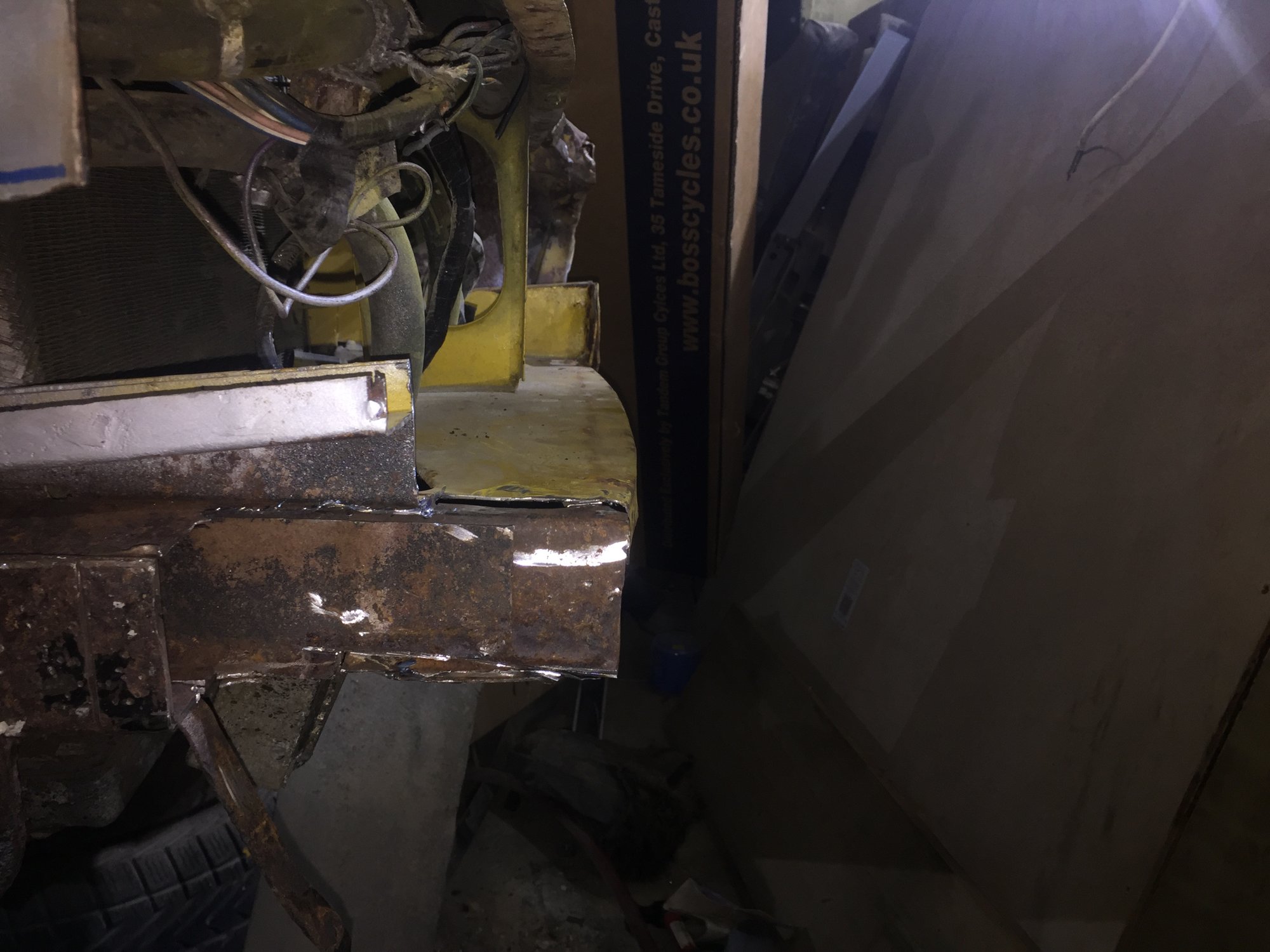

HopefullySoon Member Messages 783 Location Heywood Sep 25, 2018 #260 And how I did the repair panel for plug welding thru the rail 4FC1EF4C-E343-4240-9D21-E7EB28B68C28.jpeg 278.8 KB · Views: 79
