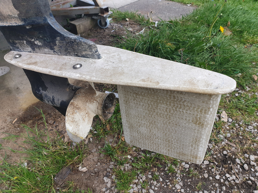

    I mad this during the week after work as to give a break for doing the hull work. I was hoping to get the hull all done this weekend but weather hasnt turned out the best. I hope to god it picks up as i only have two weeks left to do it. Have the operation then and then it launch time so nothing can be done after two weeks from now.
    Ah well here it is. I should of made it ages ago but it completely went out of my head. Very important part.

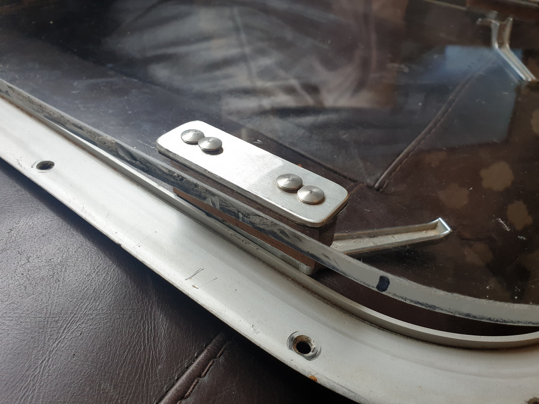

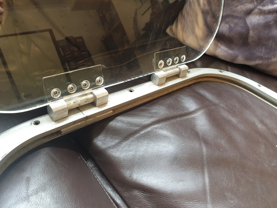

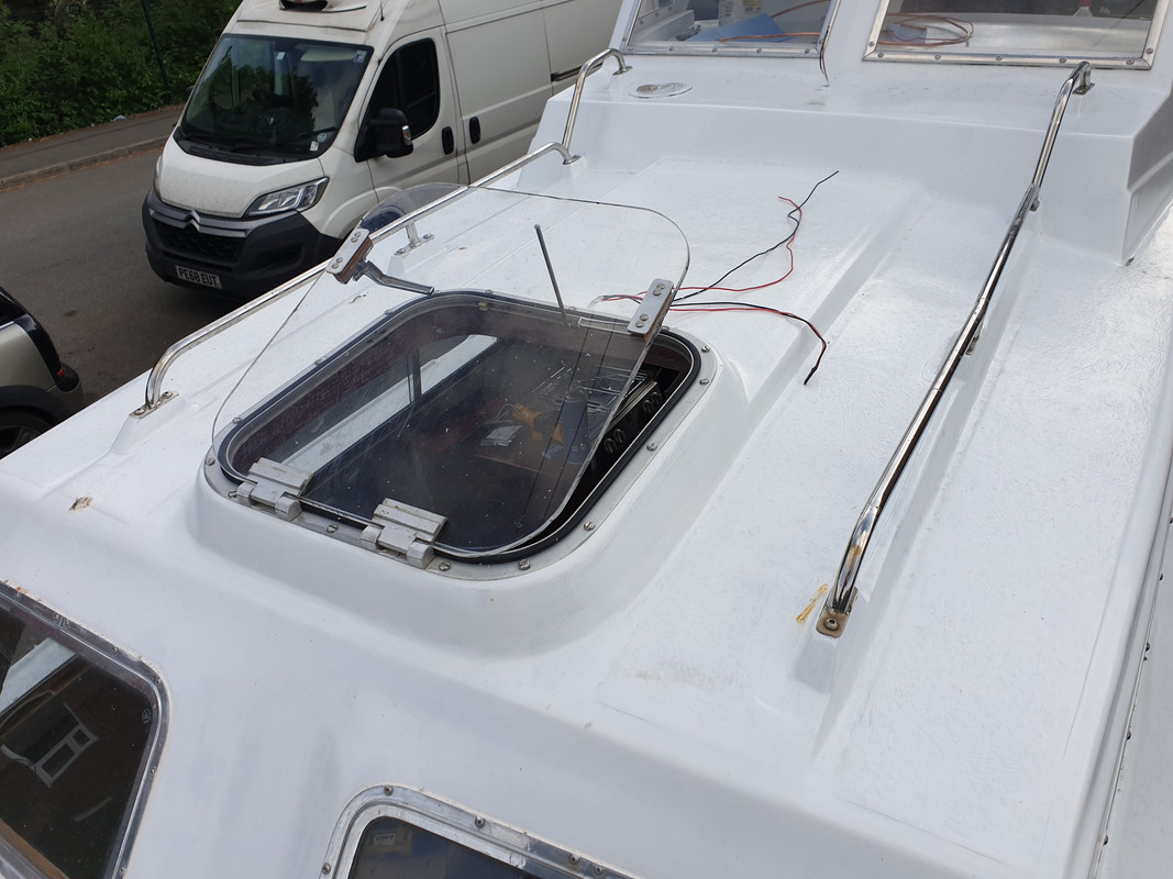

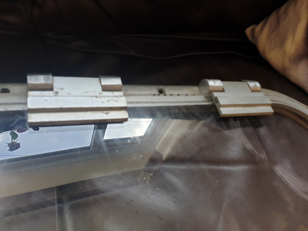

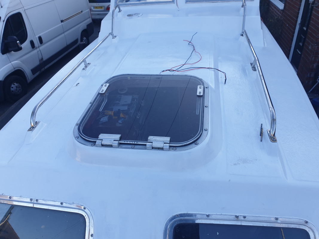

    I also fitted the hatch i made from the lower Houdini 500 frame and handles
    [​IMG]
    I used 8mm Polycarbonate, and made new hinge knuckles and a few hardwood spacers and wot not.
    [​IMG]
    [​IMG]
    [​IMG]
    [​IMG]
    Look good in place aswel i reckon.
    [​IMG]
    [​IMG]
    [​IMG]
    I did try to bend some ally U channel from a former i made to edge the polycarbonate but i failed :(, it wasnt to bad but a few very small kinks appeared. I ran out off channel so gave up.
    If i get around to it i will use some Hockey stick profile i have and see if that works. That will get even better protection along with the D section rubber seal i fitted.

    What’s the bit on the outboard for
    brightspark likes this.
  4. W.olly
    W.olly Member
    Messages:
    1,884
    Location:
    Radcliffe, Manchester
    Its for better control at low speed as there is very little with outboards. When going slow with little revs the direction is rubbish so the Rubber added helps a great deal.
  5. Jlg
    Jlg Member
    Messages:
    2,092
    Location:
    Cumbria
    Didn't know that and I've never had any problems going slow

    So.e boats work better with then some dont need them. If you do struge is just a mayyer of a few sharp burst on the throttle. These jist make it easier when engine has the veryow revs o in neutral.

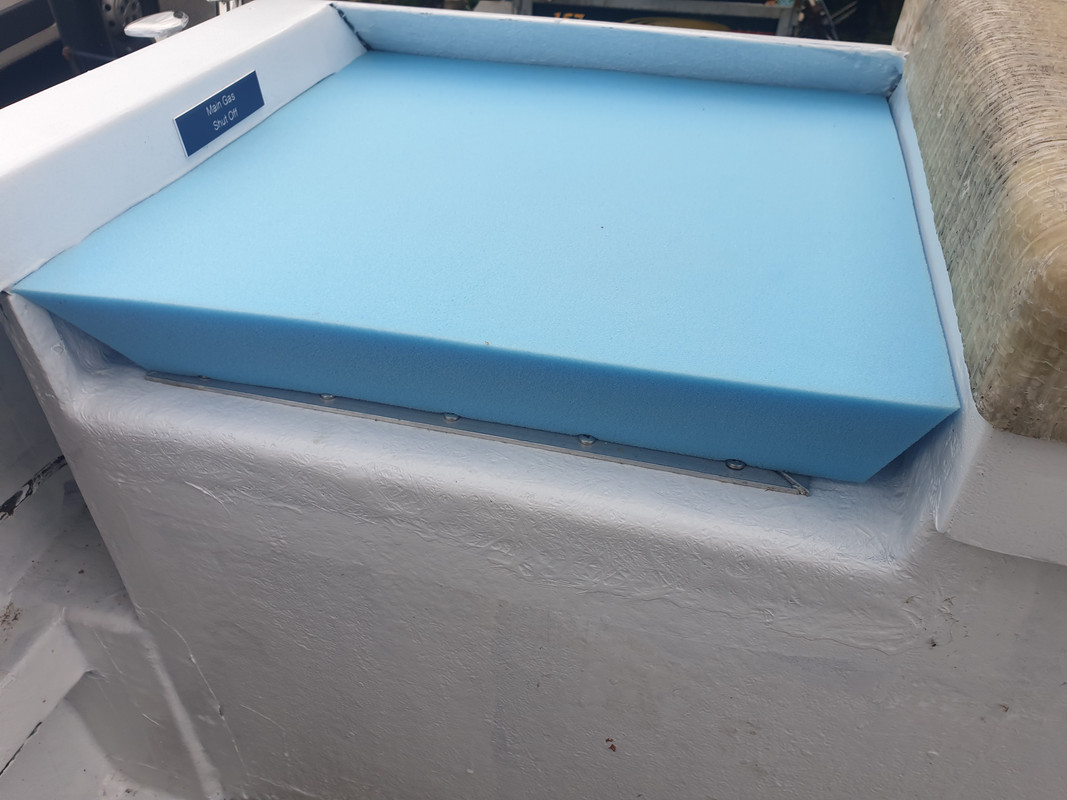

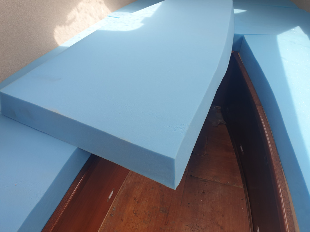

    Now to dampen that mood, not long after the cushions arrived.
    See picks as to why i was annoyed as after two weeks with trying to contact them due to no reply from them once they received the templates they cut them wrong. well three of them.
    These should be as marked on the templates `90 degree edges` i mean come on not a clue what they were thinking.
    I have emailed them and sent pics so will call them in the morning and see what they are going to do. Oh and they didnt send the stockinette either.
    [​IMG]
    [​IMG]
    I spent all morning calling them and no reply but for its engaged then answer phone to a different number. I know they have number recognition as they told me. So i used a landline phone only seconds after i hung up from there answer phone for it to be answered straightaway. Am i being paranoid as they then said the two mian people are not available and there internet is down so unable to see the email i sent them of the pics above.

    love the rudder on the outboard. wondering though, if there will be any vertical forces put on it and the boat moves up and down in the water...that back bone looks a bit thin....Knowing you and your skill set, my concern is unfounded.

    sure is a big rudder....I remember mine had a little fin that one day decided to fall off....lost virtually all the thrust because the prop was cavitating...the little fin just moved the exhaust gas to one side.

    These rudders are only for going at low knots no more than 10 i would say. So no big forces will be put on it. well i dont think they will. Its only for better control when going a few knows and less or no thrust at all.
    Saying that though the rudder can easy be modified but cutting of the cavitation extension and just keep the rudder on if it does need to be.

    Think you will find it will suffer greater foces at speed, a larger cavitation plate helps with high speed stability, espescially if its wider, and you have the power to drive the boat up on the plane above its maximum design hull speed, as they start to chine roll!

    That was my point, at speeds yes it will take pressure i should think but not at less than 6knots. which is what it will be doing . To get this on the plane itswill need more than the 10hp i has.
