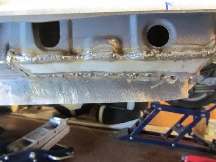

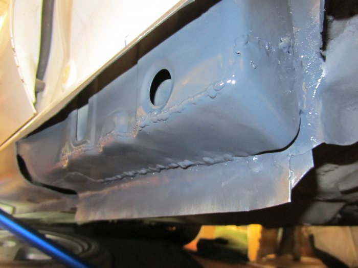

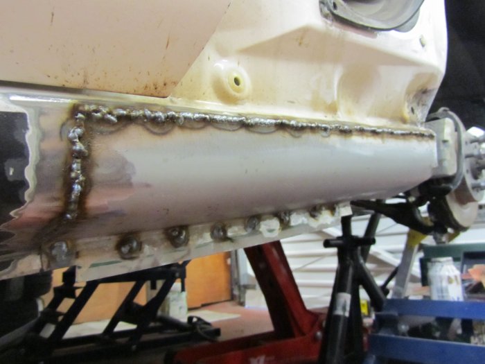

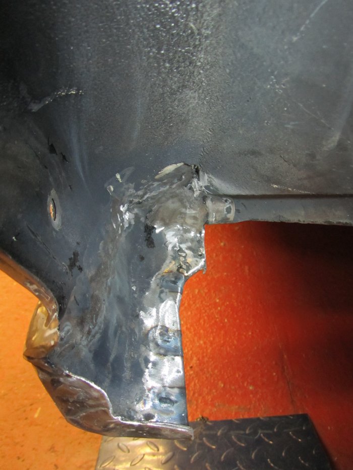

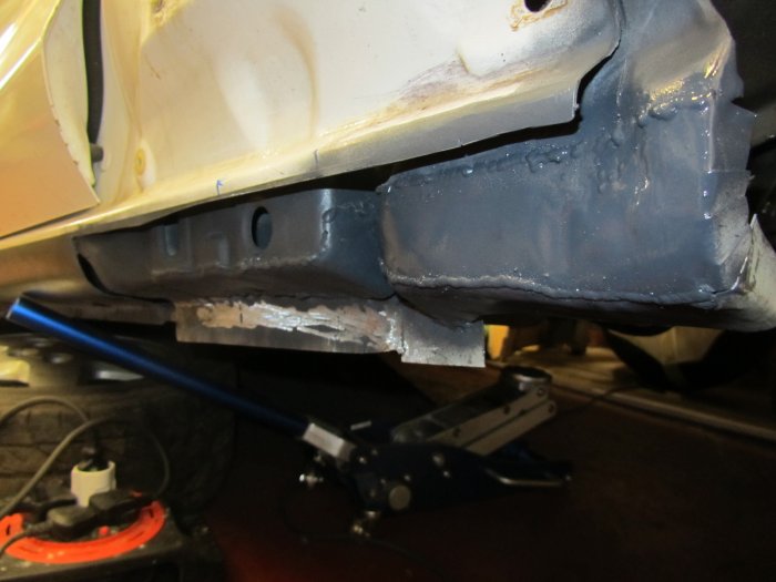

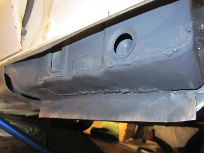

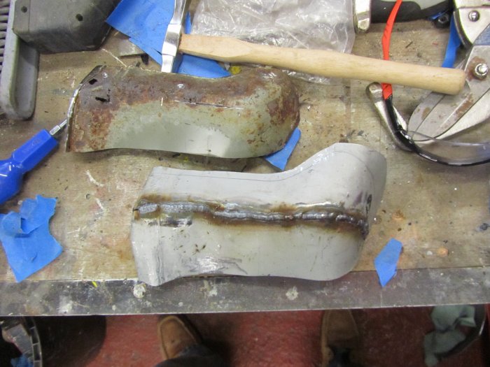

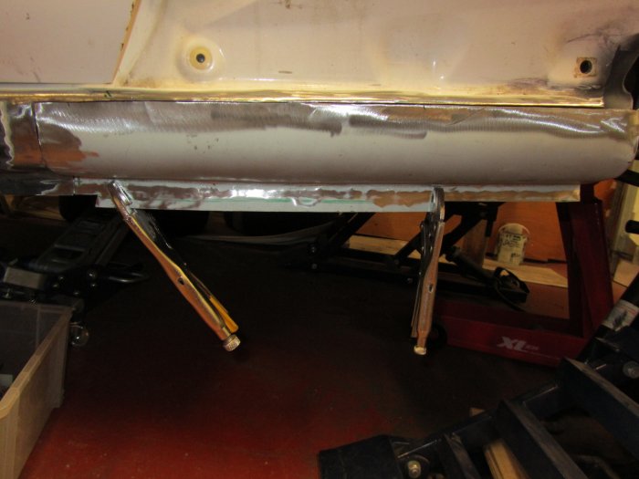

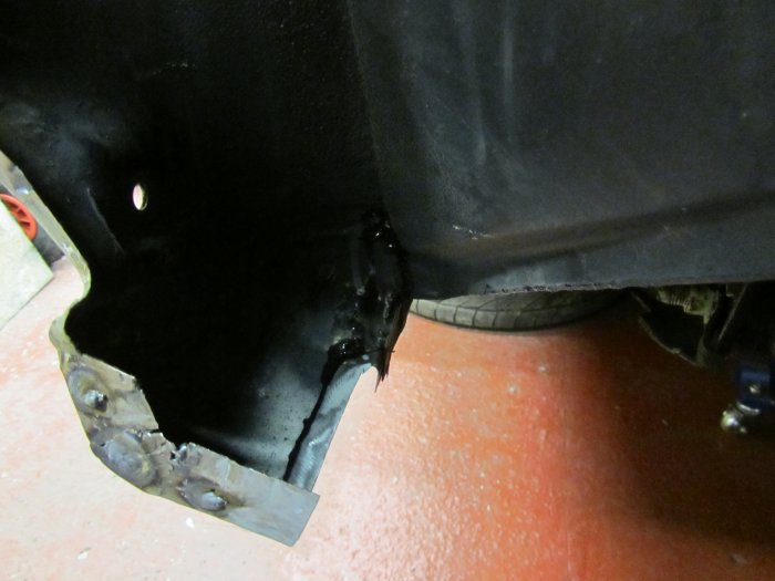

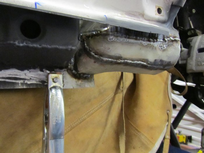

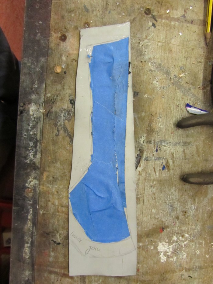

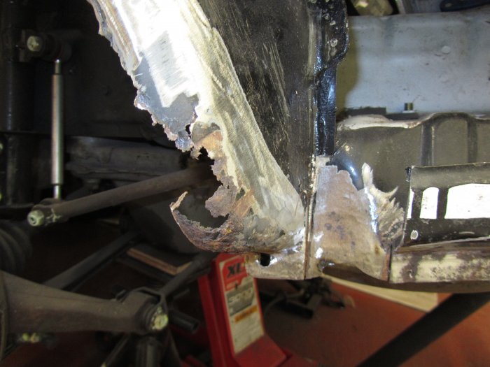

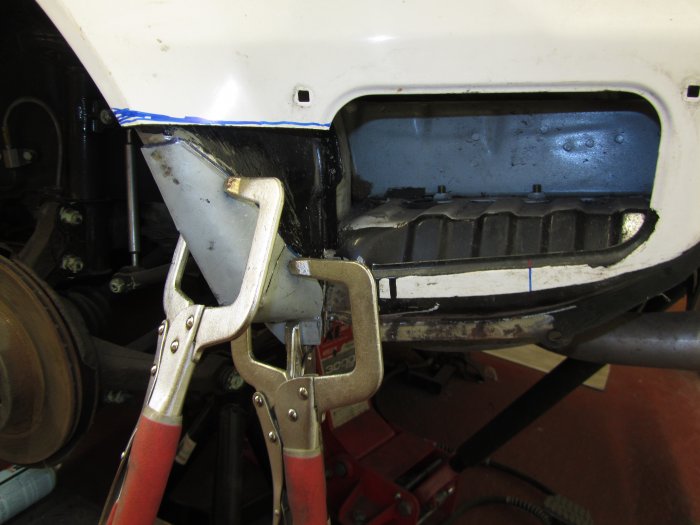

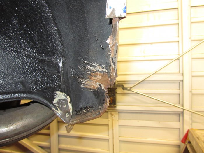

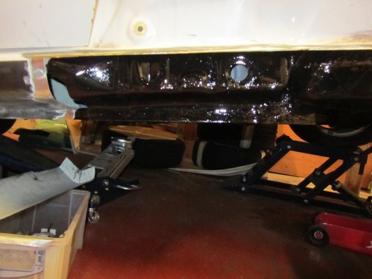

Typical...when I don't put etch primer on I end up leaving it a couple of weeks...when I do I get to carry on the next day! Today I put in the bottom of the box reinforcement. This was originally spot welded in place with 4 spot welds...I decided to lap weld along the back. Went in OK-ish. I find it really difficult to weld upside down so it's always a bit messy. Top part went according to plan...I had a few holes in the corner where I couldn't really get in that easily...had to give the pigeon a squeeze to fill in the holes...luckily I could get a copper plate behind from inside the car. Next job will be to get the rear sill inner arch piece made up and welded in...not looking forward to that as the drivers side was a royal pain.
I take it you had to use a skim of filler on the outside? Looks like you were never there!
