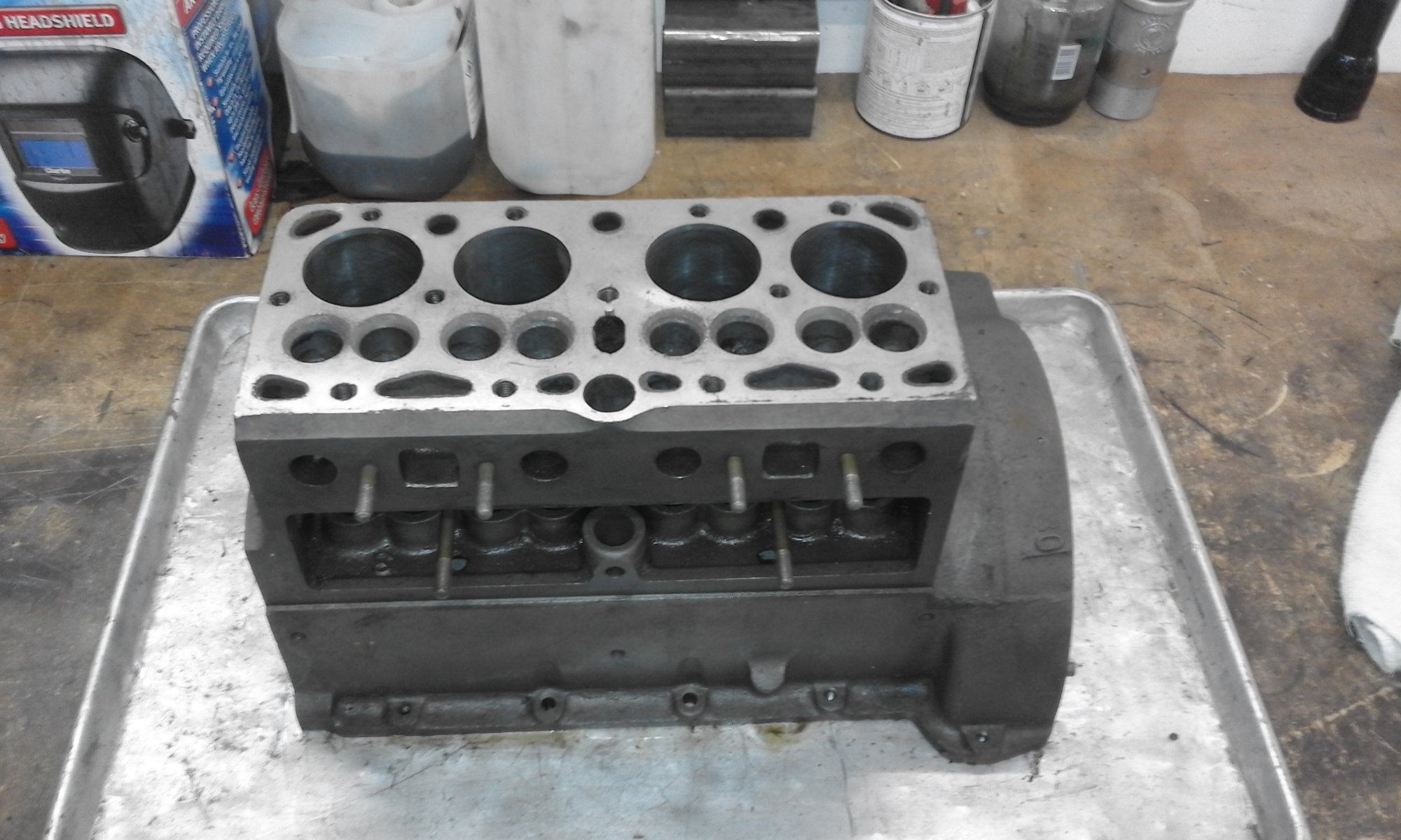

Some of you will recall that I was recently lucky enough to find a later (short) engine which I got home and stripped in preparation for a quick refresh...
... however, the bottom end wasn't in quite the condition I was led to believe it would be so a crankshaft change will be required (sorry, no picture of that). As luck would have it, I have a spare crank, recently reground and with a full set of shells to suit the later block (the earlier blocks were all white metal bearings, a costly process!).
After stripping, the block went off for an acid clean and descale before having that small crack repaired and the top refaced:
I'm now ready to lap the valves in before a full clean and reassembly.
I'll post more as I get bits done and hope you enjoy reading it.
