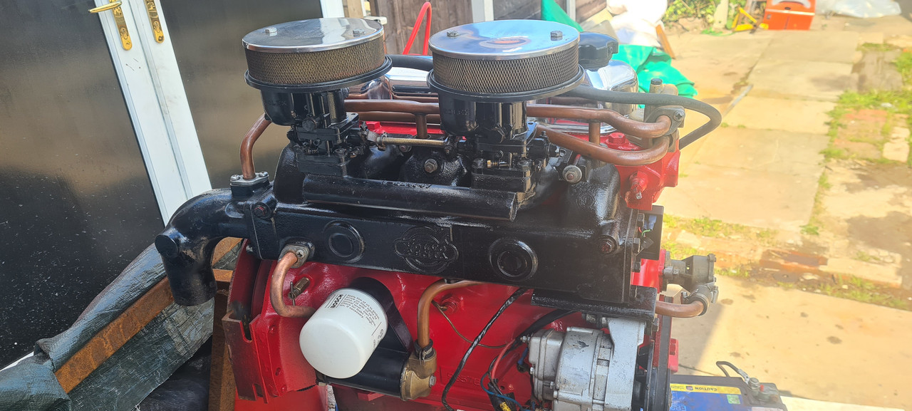

I don't recall reading how clean was the block when it went in? Did you see all of the pitting, and ask for it to be gone, or had you not cleaned off all the previous head gasket remnants, so th efaults were still covered?
If the latter, MAYBE they took a first pass to clean off the crud, and then realised how bad it was. Perhaps it should've gone in clean. Perhaps they should have phoned you to discuss it, or explained when you picked it up. But you were in a hurry (Camping) so maybe they didn't feel inclined to waste your time reading the file notes...

you catch more flies with sugar than salt.If they have misunderstood something. i cant see how as it has been skimmed just very little. and no reason why as thye did not talk to me about anything wen they could of and had chance.
I could of walked out without paying as the chap who put it in the van went off to answer the phone and then talk to another customer. i stood there untill somebody else came and i paid. it seems they dont know what there doing and not organised. Which i so excuse for bad work let out wit no explanation at all.
but as said ill call them tomorrow. I am a decent chap, not arrogant or aggressive so ill be nice even with this.
This is a 1975`ish Volvo block, same as used in Amazon cars etc. Well where they were first used untill modded for marine use by a couple of companies
There high revving engines to run max output upto 4000rpm. so need to be half decent as not plodding around in a car.
this is the gasket kit, i think composite with metal rim for the bore tops.What head gasket is it, composite or Metal Layered Steel?.
Composite are a bit more forgiving but personally I wouldn't use the block in that state.
