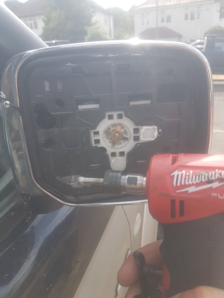

treated myself to the milwaukee ...is a 1/4" chuck easy to come by , seems alot of my bits are 1/4 shaft and a bit too snug to fit 6mm
my milwakee came with 2 different size colletstreated myself to the milwaukee ...is a 1/4" chuck easy to come by , seems alot of my bits are 1/4 shaft and a bit too snug to fit 6mm
yeah 6mm and 8mm ....1/4" tools are a bit snug for 6 and 8 doesnt close up enoughmy milwakee came with 2 different size collets
I was looking at this as I'm thinking of investing in M12 as I want the right angle grinder and 3/8" impact, there are 8mm to 1/4 adapters available, HERE, not used one myself. The 1/4" collet is available as a spare part, HERE, never used this company and £34.18 isn't cheap, £40 for the 6 and 8mm.treated myself to the milwaukee ...is a 1/4" chuck easy to come by , seems alot of my bits are 1/4 shaft and a bit too snug to fit 6mm
‘Kin hell!! A new grinder is only about £100….
u could always turn a 1/4" down if you have a latheyeah 6mm and 8mm ....1/4" tools are a bit snug for 6 and 8 doesnt close up enough
knocked a bit off a couple of them in the drill latheu could always turn a 1/4" down if you have a lathe
They’re a weird double collet. I’ll take a pic and show you what I mean….or make your own collets
You can get a Makita 18v LXT to Milwaukee M18 converter off a guy on eBay, if you don’t want to fork out for a new battery set. I haven’t tried mine yet as my plans on getting a portable bandsaw fell through.This is the thing, I often need it fairly compact where I'm at, but not sure what I will need where I'm going..might wait a while before dropping some cash
Annoyingly all my gear is makita, so would mean starting again with milwaukee.
