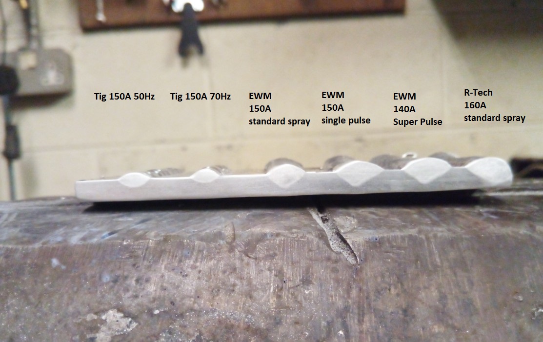

I did do one run but it actually split the Alu right down the centre of the weld as it cooled, just peeled away like a bananaHave you any just mig. (Not pulse)
At the end of the day this discussion or certainly my thoughts around penetration and fusion mig vs tig was based around conventional mig vs tig.

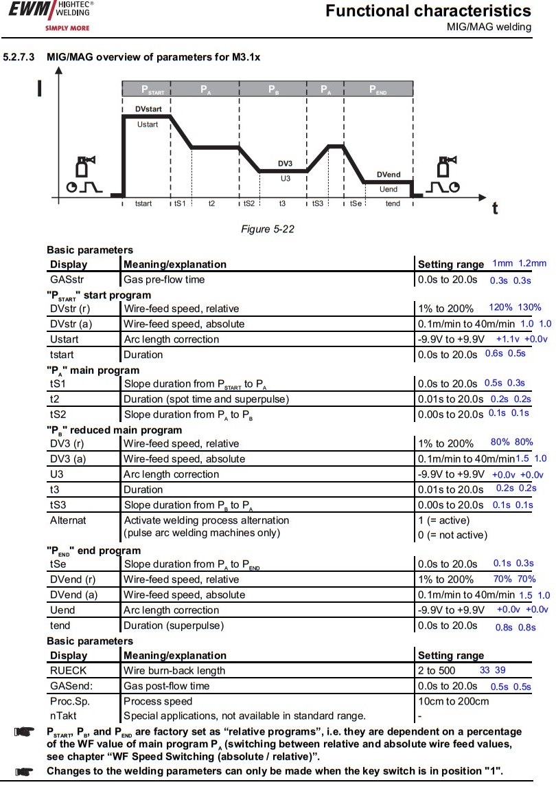

Yes, which kind of surprised me as I was expecting the single pulse to be the better of the two. Another thing that surprised me was there was little difference between force arc and non-force arc, I was expecting the Force Arc to be deeper and narrower. I think maybe Alu is not really the best material for seeing the effects of ForceArc due to the heat dissipation.That SuperPulse setting really whangs the penetration right in there doesn't it?

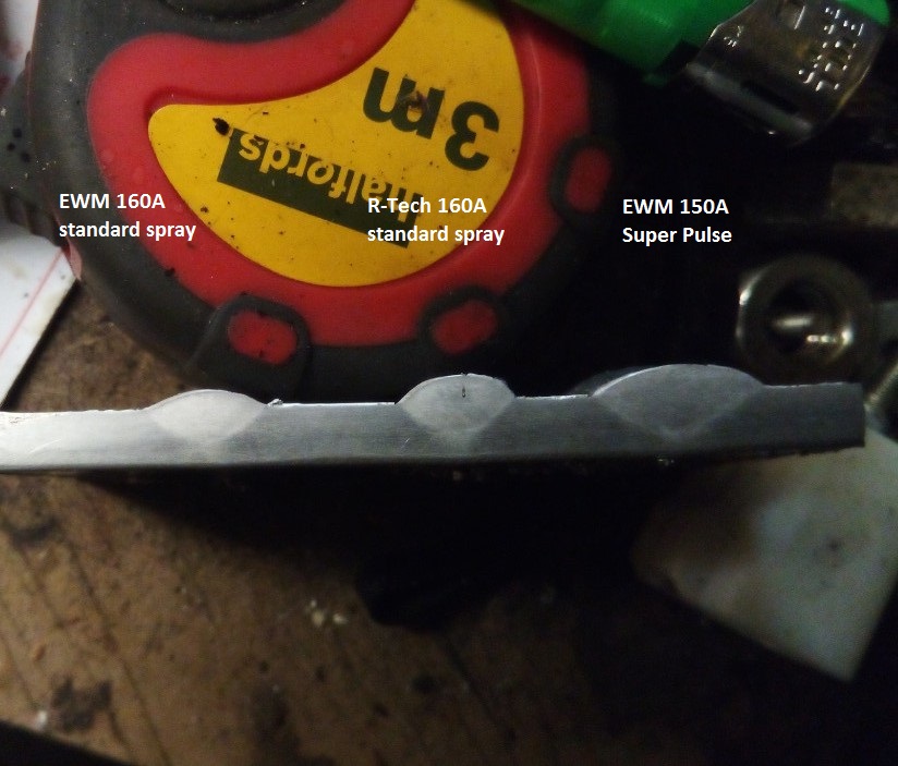

) as it’s just not logical.It’s weird mate. I cannot get anything like that depth of penetration with current that low on our migs.
I wouldn’t even entertain less than 200 amps on Alu that thick. I certainly wouldn’t be convinced it’s going to out perform the tig at such low current. It’s very strange as you seem to weld all your processes much much colder than the norm required to get a sound weld yet you get the results. Are you sure your welders ain’t supplied with turbo current boosters() as it’s just not logical.
But how can that be? it shouldn't be possible, I was away to head home but I think I will do another video showing the machine whilst welding and then I will move the camera over to the weld to show it so that it can be seen I am not spouting rubbish.Nothin wrong with that though mate. It just means your machines are far more useful than ours. You’ve still got reserves when we run out of juice. One thing is for sure it’s certainly not effecting the weld as your fusion is ample.
I’m not suggesting that at all mate. I 100% believe you did those at those settings. It just doesn’t work for me that’s all.But how can that be? it shouldn't be possible, I was away to head home but I think I will do another video showing the machine whilst welding and then I will move the camera over to the weld to show it so that it can be seen I am not spouting rubbish.
Sorry don't get me wrong, I wasn't suggesting that at all it is just I am starting to disbelieve myselfI’m not suggesting that at all mate. I 100% believe you did those at those settings. It just doesn’t work for me that’s all.
