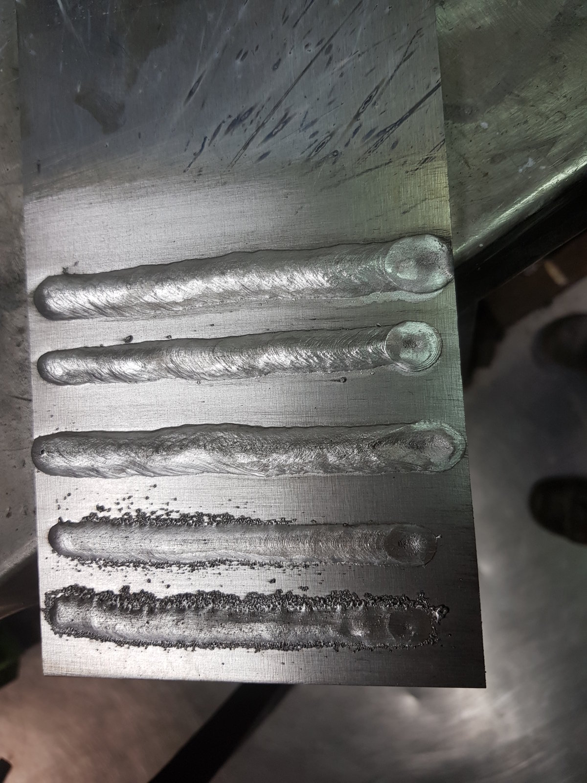

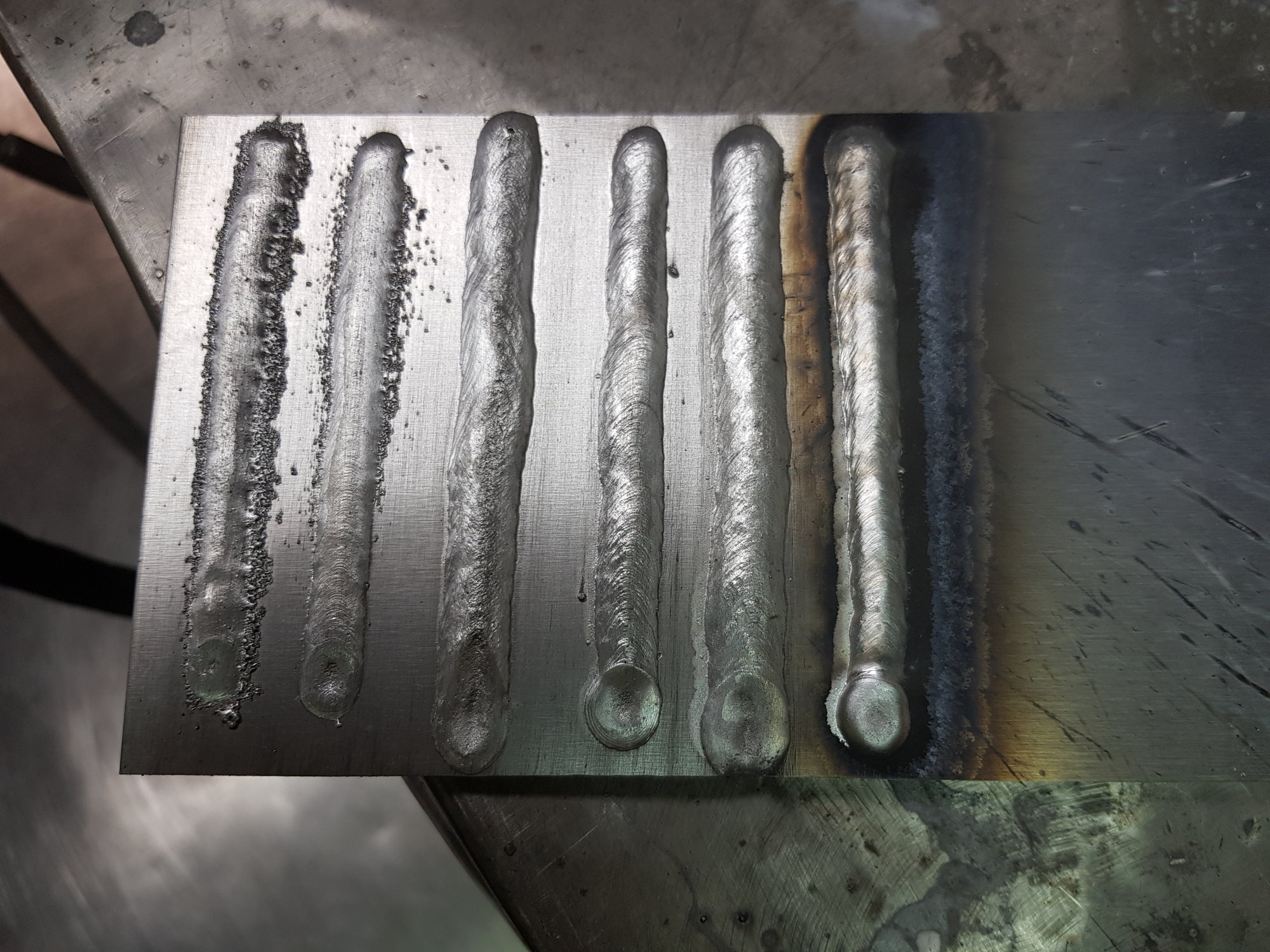

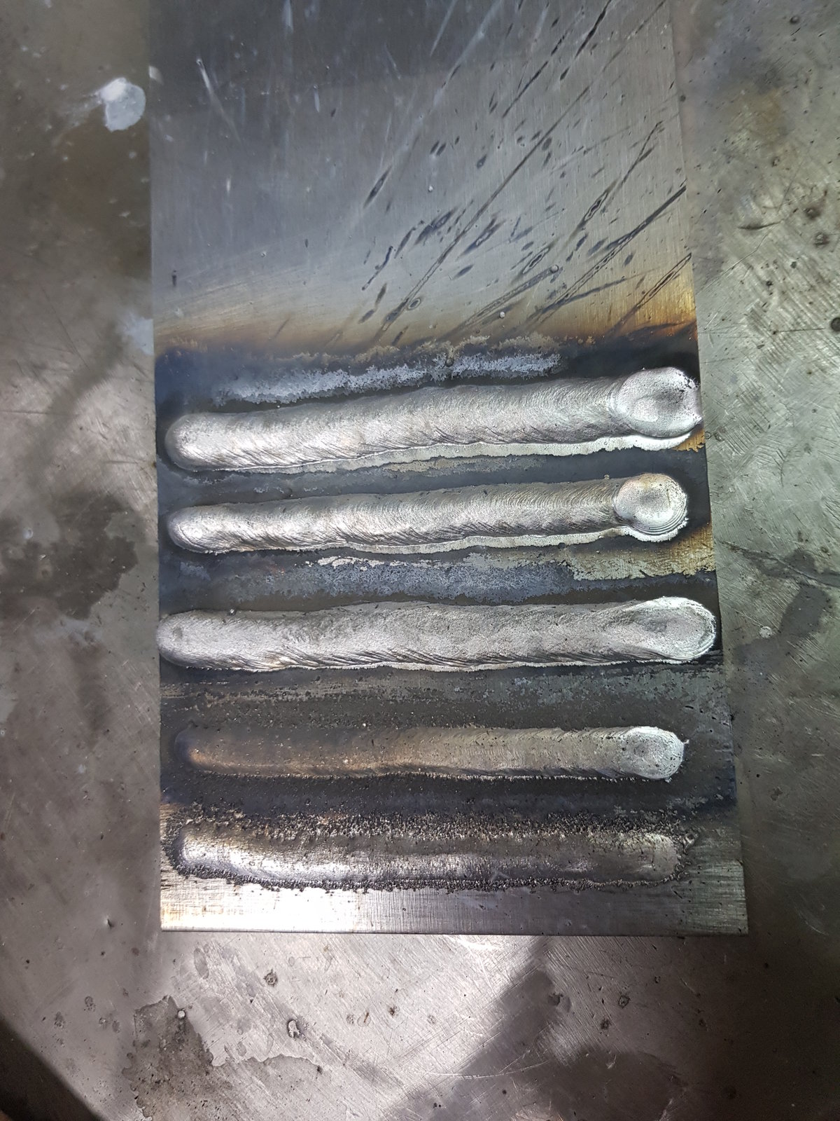

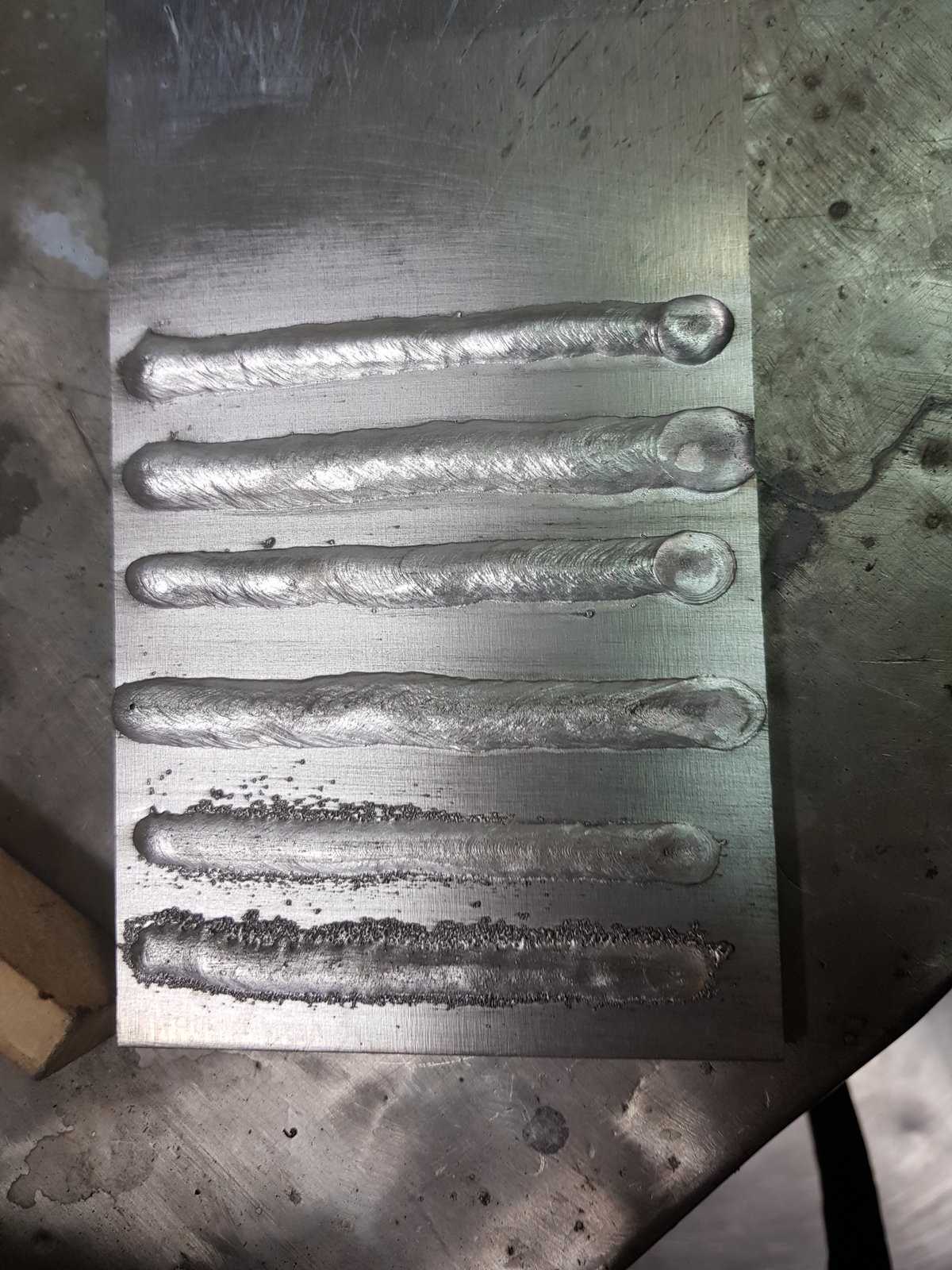

Ok vid here, wire sticking a wee bit at the start but came away ok as I got into the weld. Bit hot for my liking for some reason, possibly because it was a smaller piece of 5mm Alu and I think I may have nudged to voltage up a bit when unwinding the spool gun from the welder, think I had 23v previously.
Anyway vid here.

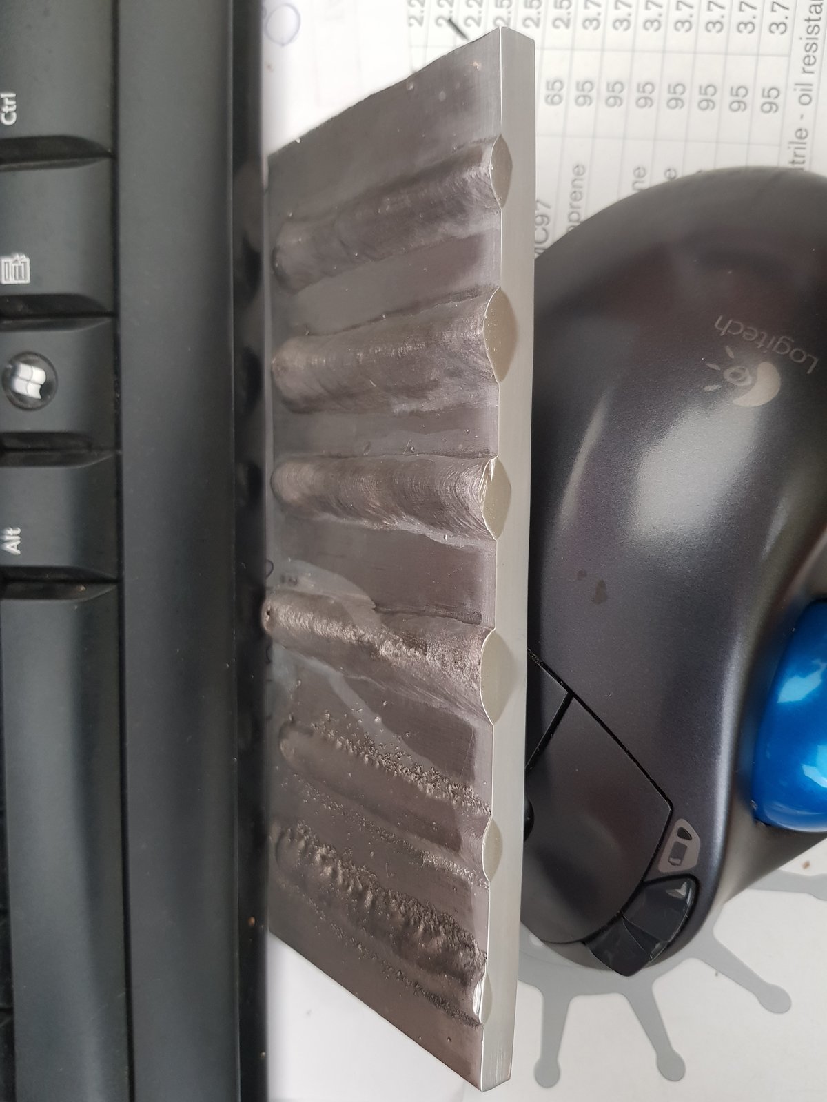

Pic of etch, first showing it was the same part and second showing the bit that made a fool of me, full penetration plus
Anyway vid here.
) I have never tried to do what we have done on this test before, so to see the different results from the different machine settings is good. I can say I never had any intention to use straight mig (no pulse ) on alli before and after this have no intention to do so
