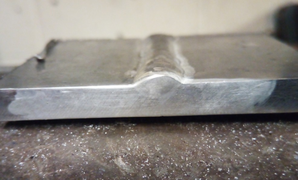

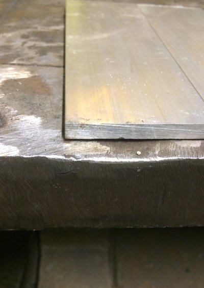

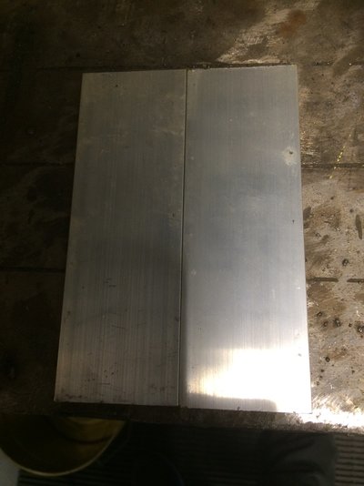

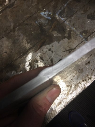

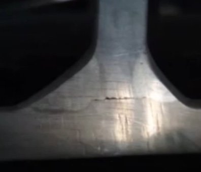

    I’ve just done a 6mm square edged butt joint with tig. Dunno what the pen is like yet. It bit well. Far from the tidiest joint I’ve ever done. But then I am rushing as I’m playing a bit of catch up today. I’ll let it cool down.

    Well here is mine, both welds shocking, pic of Tig one is poor as well but make of it what you will.

    I couldn’t pick a winner there on pen depth mate. What were your currents. Here’s mine.
    3.9mm depth at the deepest point into 6mm plate. Measured 2.1mm exposure of the joint on the back with digital calipers.

    Set thickness on Mig to 6mm and then changed to current view and it was 160/165Amps, filmed it as you can see and hovered around that current during the weld so that was my current I chose for the Tig to make the currents equal and during the weld it also hovered around about the 160/165Amps.
    Voltage on Mig was 24v or so and Tig 14.5v OR SO.

    Certainly as far as overall fusion the mig has covered that. Actual depth into the joint it looks like tig might of just taken it. Very close indeed.

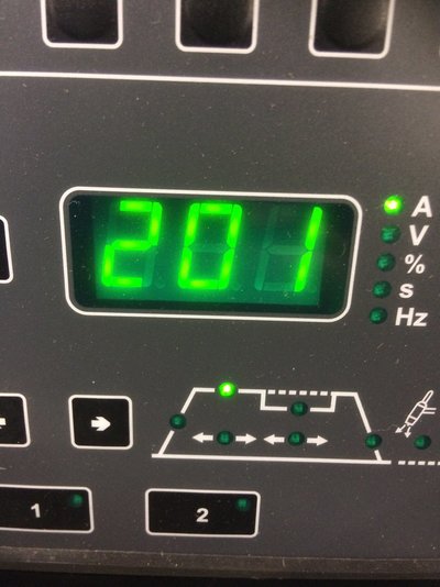

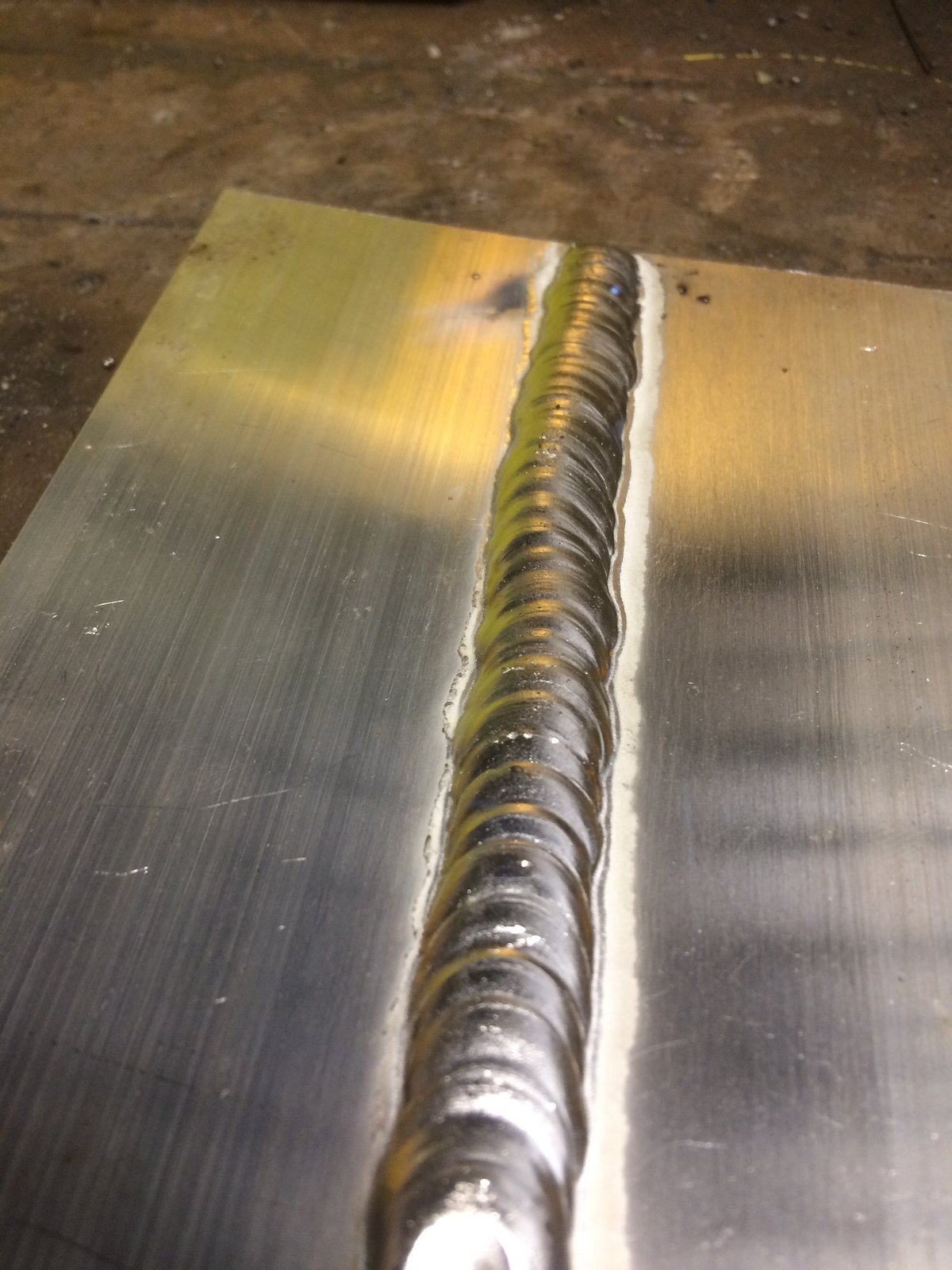

    If you get chance Can you do a 6mm square edge butt joint with the Mig aiming at around the 200 if possible. Be nice to see if you get more or less than what I got here. Makes interesting topic this sort of stuff.
  16. Richard.
    Richard. Forum Supporter
    Messages:
    18,348
    Location:
    Cambridgeshire
    No clear winner here. The fusion depth is quite equal as is actual pen into the joint corner. If I had to give a point it would be Mig based on overall even fusion level but it’s one of those where you could do it 100 times and get 50 wins each.
