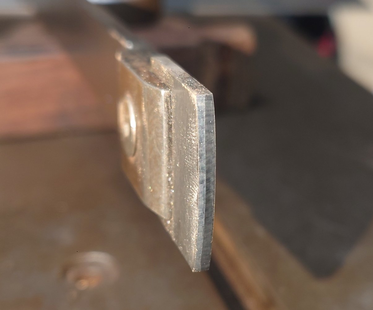

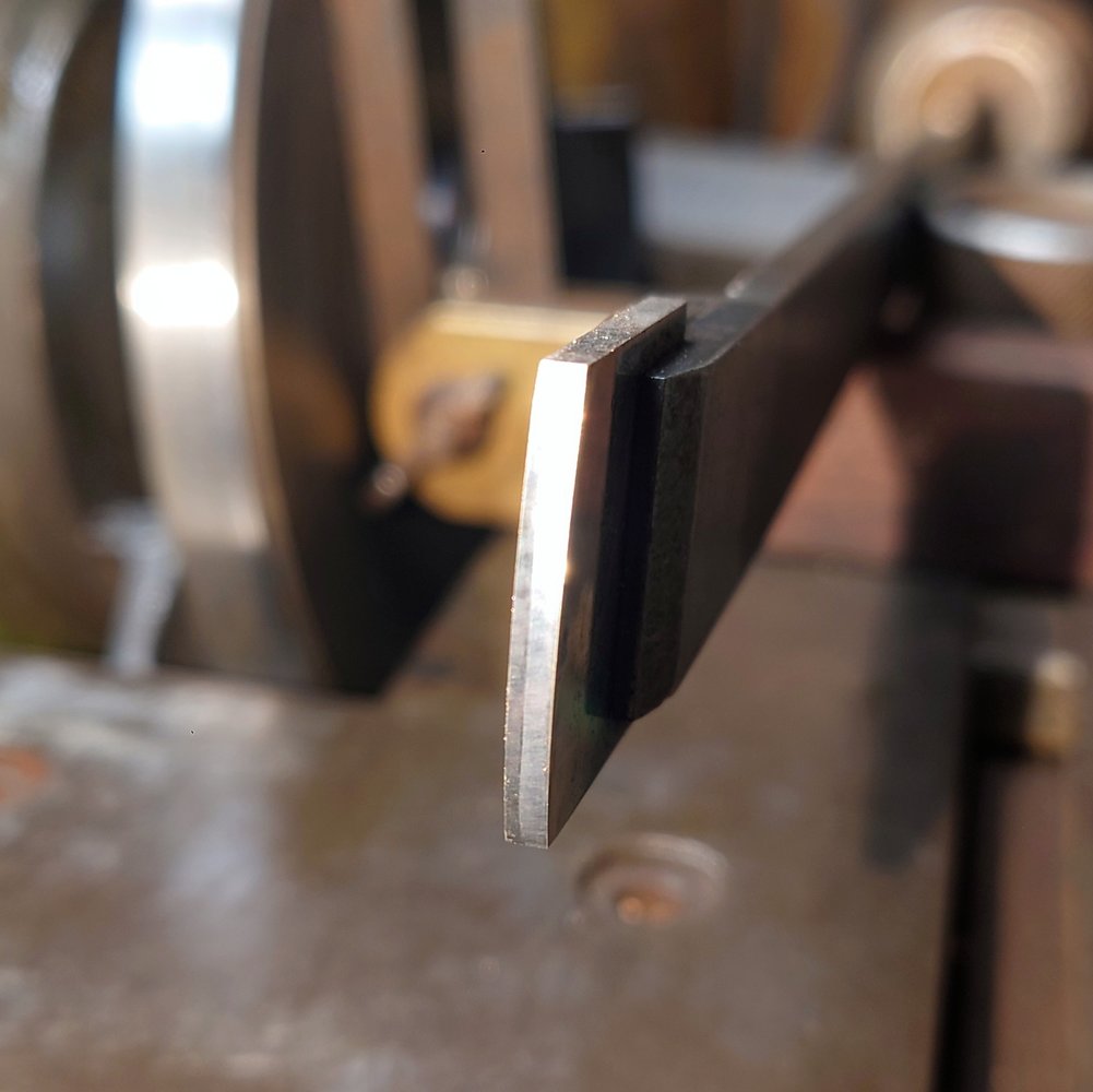

They look a bit fat on the end to me. Probably OK on the flat but not so clever tucked into a vee way and if you're planing to scrape the saddle top ways they are recessed so that scraper won't get in there.
You can easily make a scraper I use 25mm x 3mm or 4mm flat steel bar from Tilgear. You can buy enough material to make ten of them for the price of one of those.
