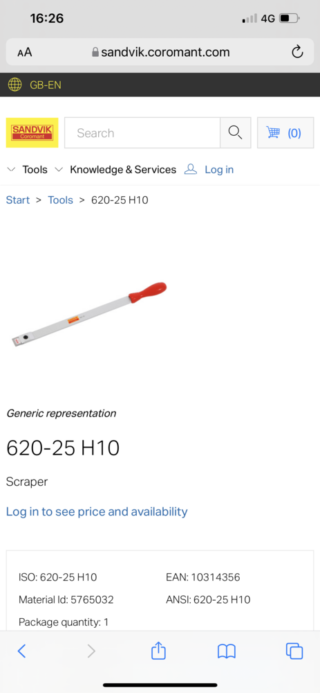

Mmmm, not good in my experience - you need a springy steel handle, long enough to get behind it. Borrow or buy a proper scraper.I have in the past ground an old file for scraping. Not perfect but worked.

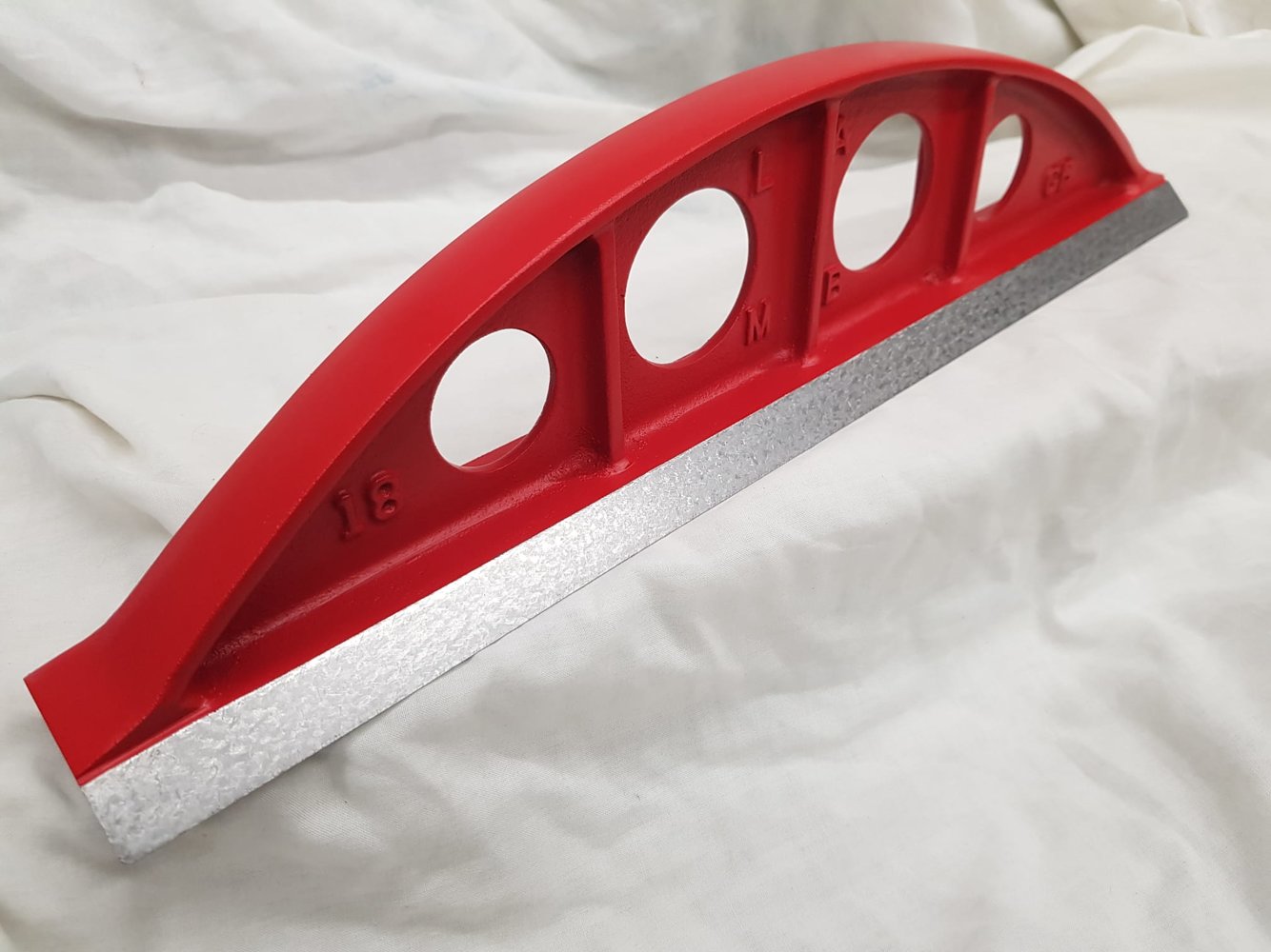

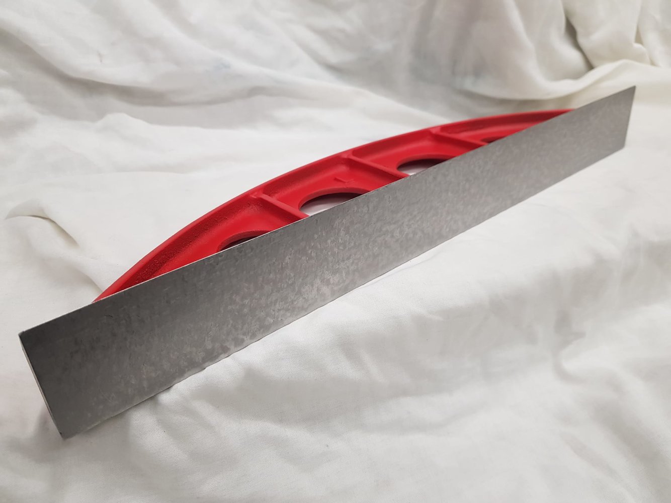

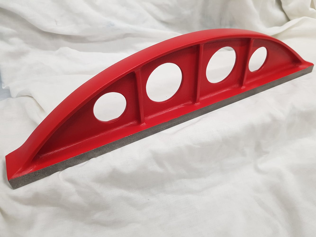

Would I need a bevelled straight edge like in?You'd be best off scraping in the cross-slide and true it up, but be prepared for a hard slog if doing it all by hand. You'll also need a bevel edge straight edge and DTI or similar
@pressbrake1 sells an 18" one....but you'll have to scrape it in firstAny idea where I would get one?
Don’t watch that plum or take his adviceWould I need a bevelled straight edge like in?

They'll be fine, someone will come along and say 'at that price it's most likely Russian carbide'Are these what I should look to buy: https://www.ebay.co.uk/itm/334369762367?hash=item4dd9fdac3f:g:tk4AAOSw5cli6nDa
