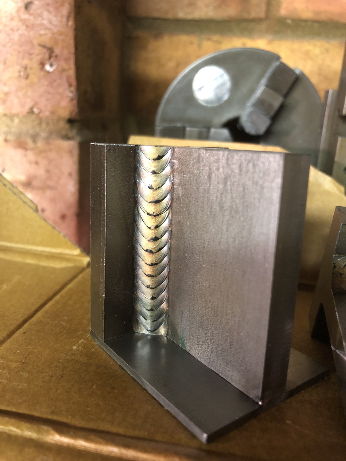

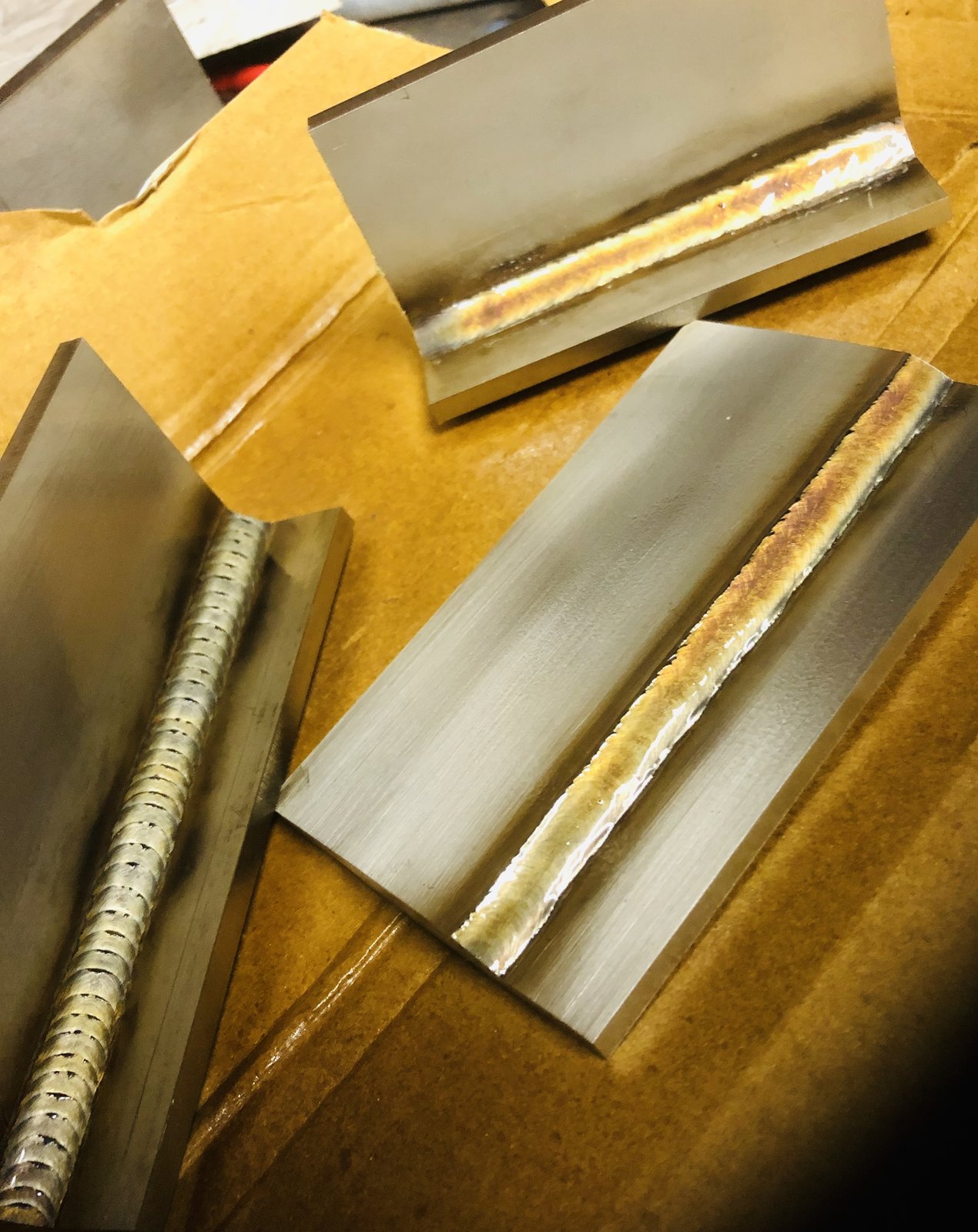

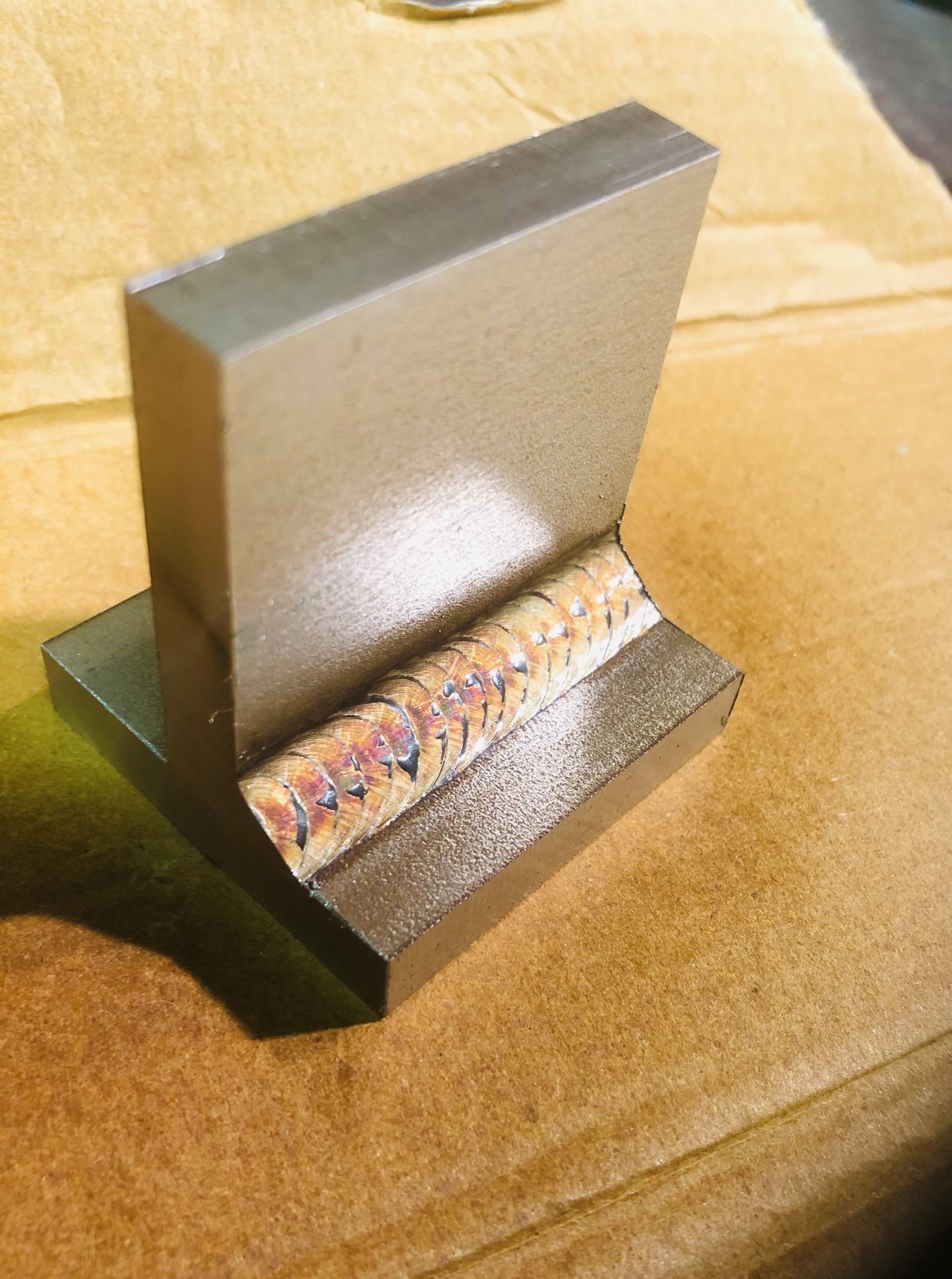

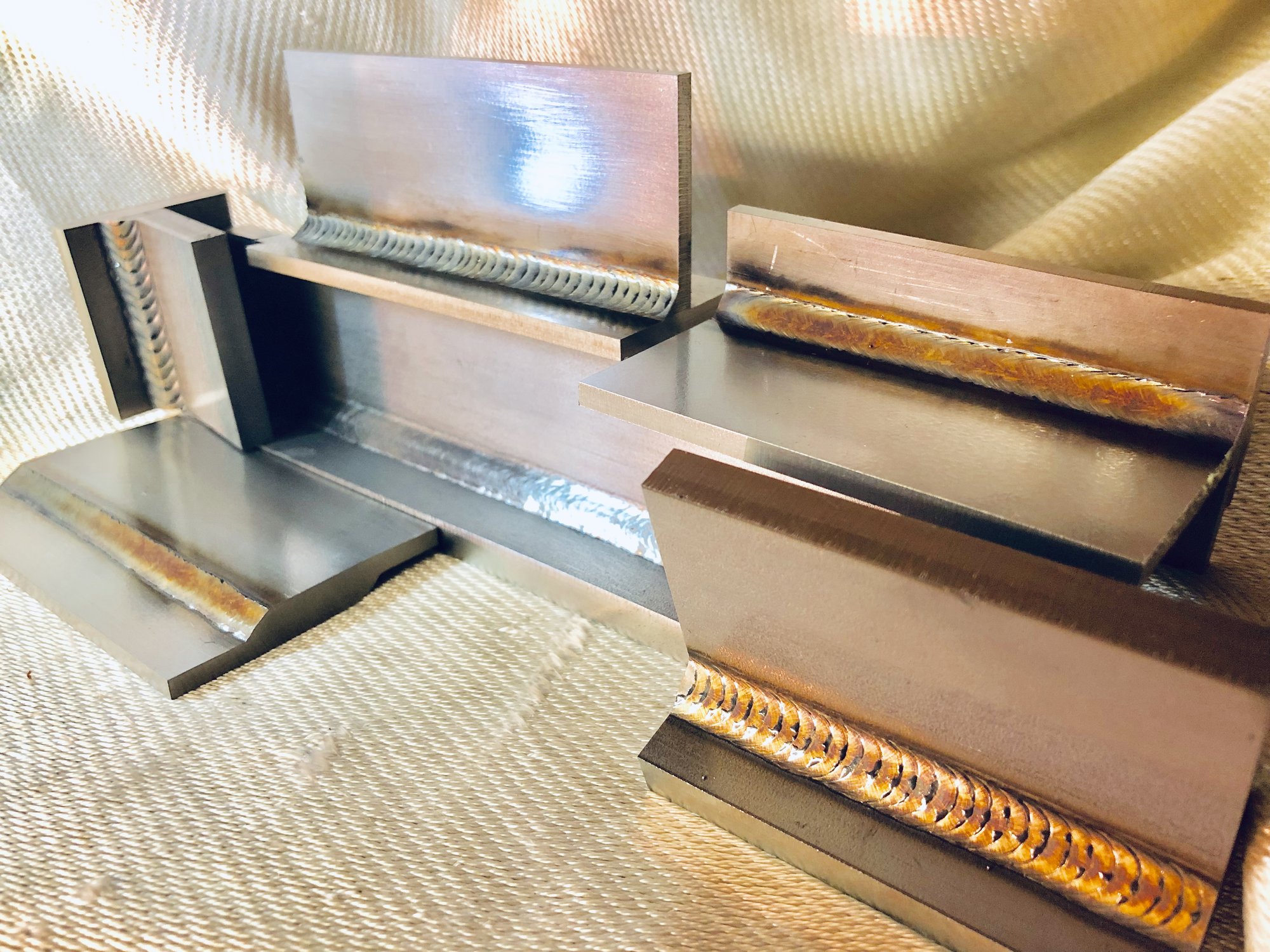

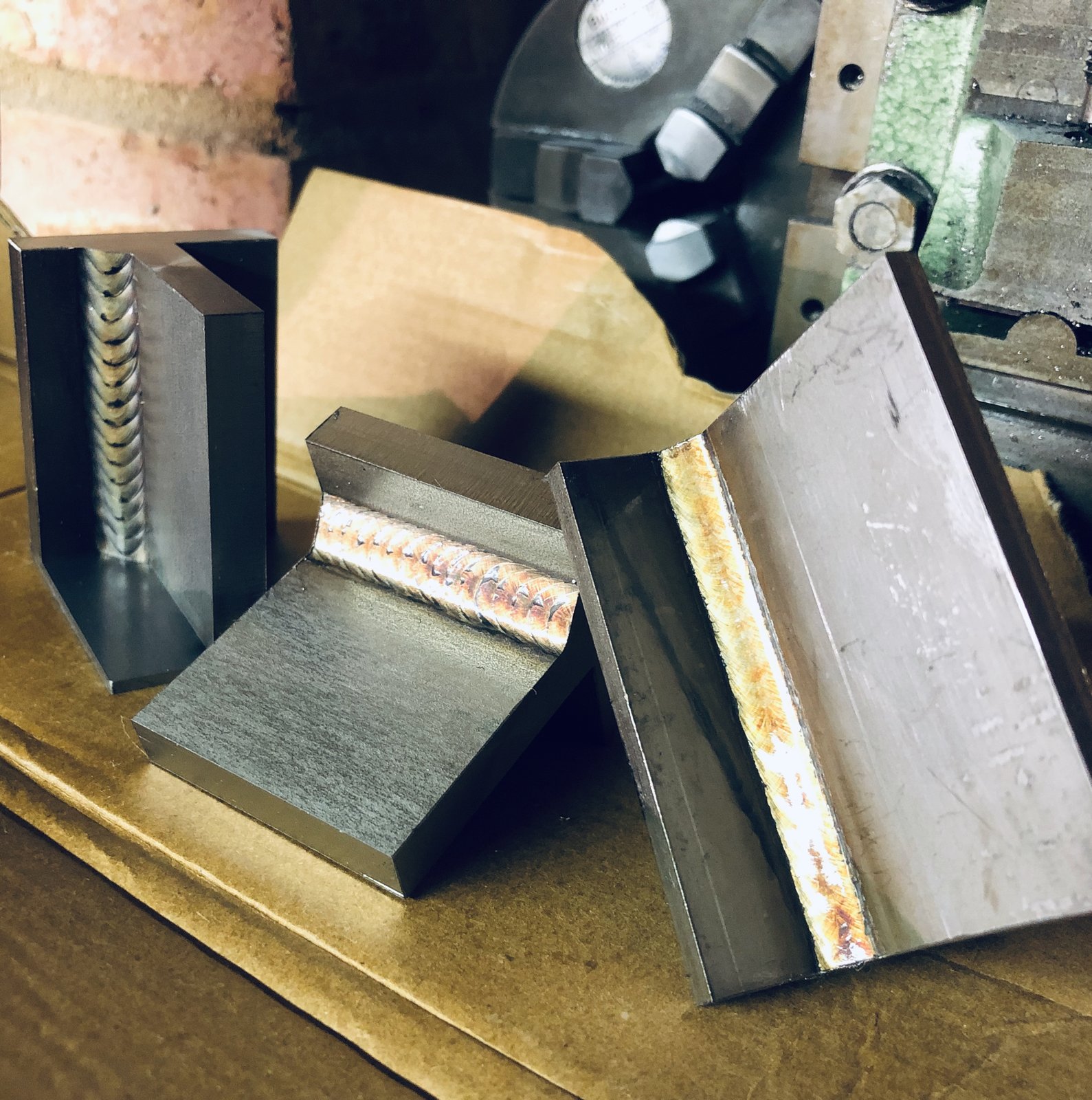

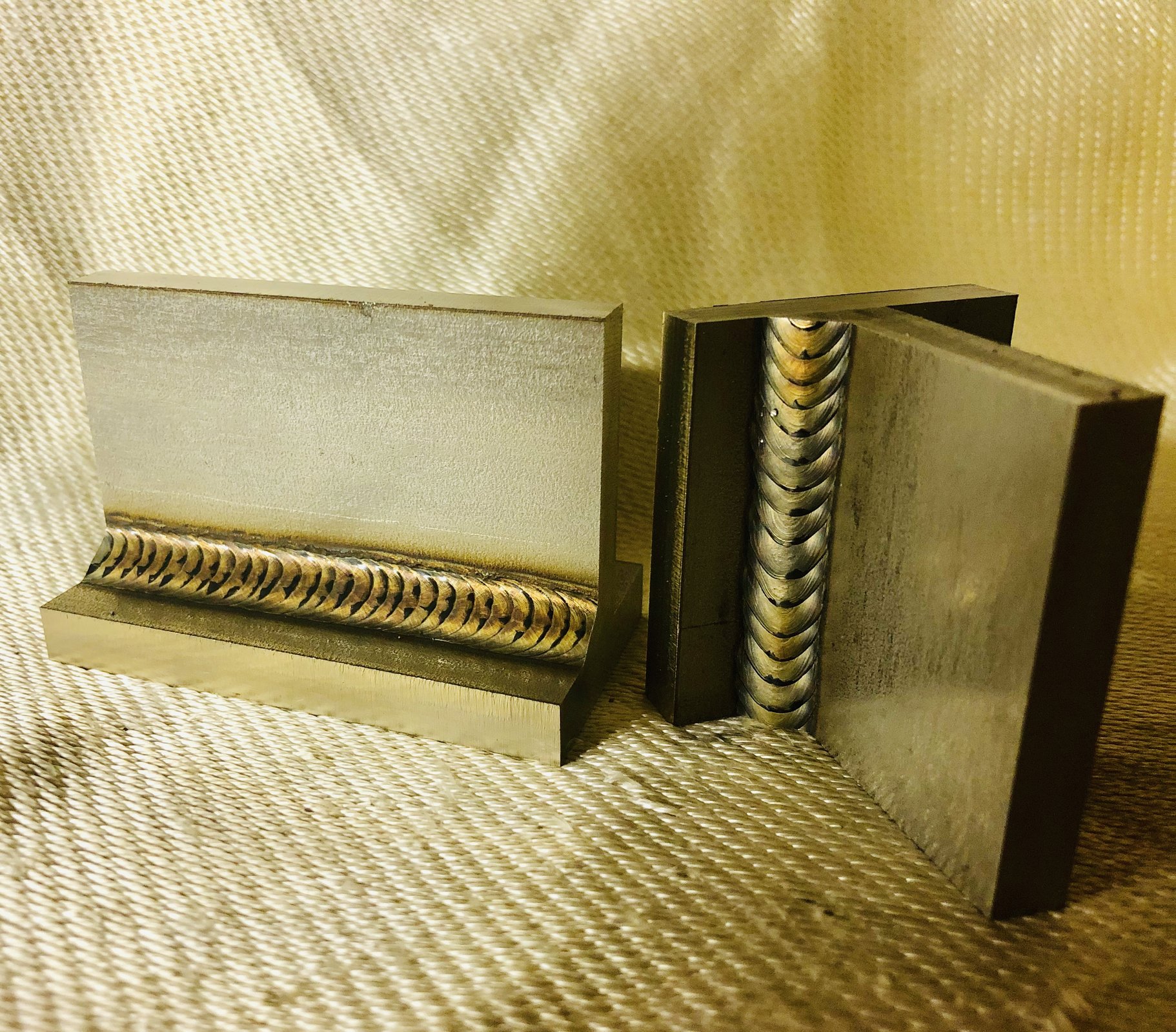

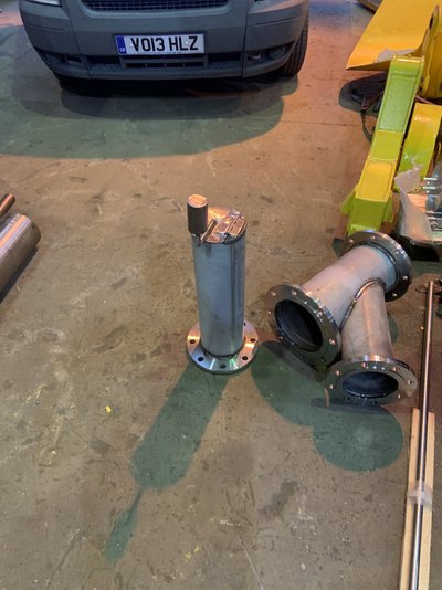

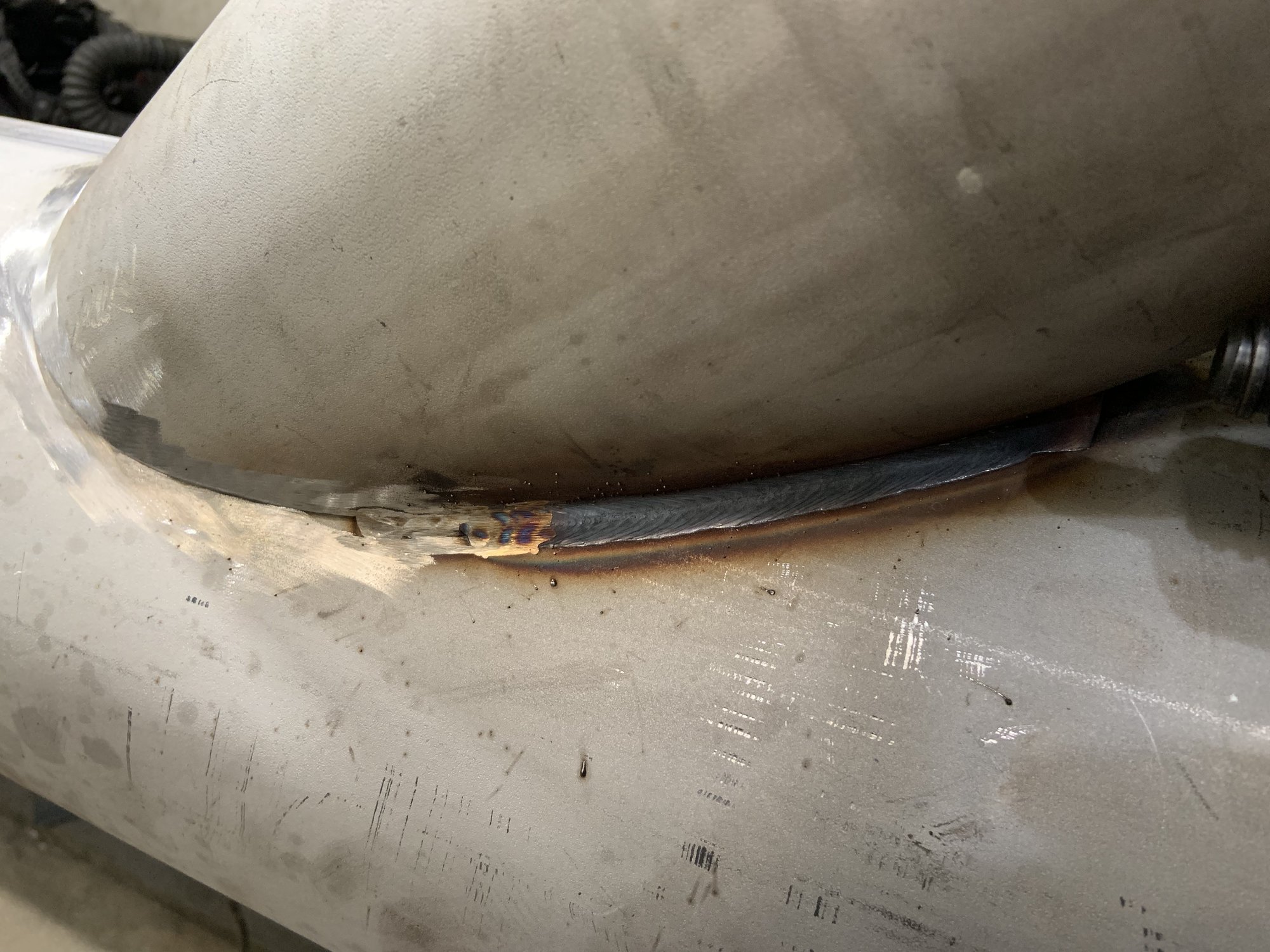

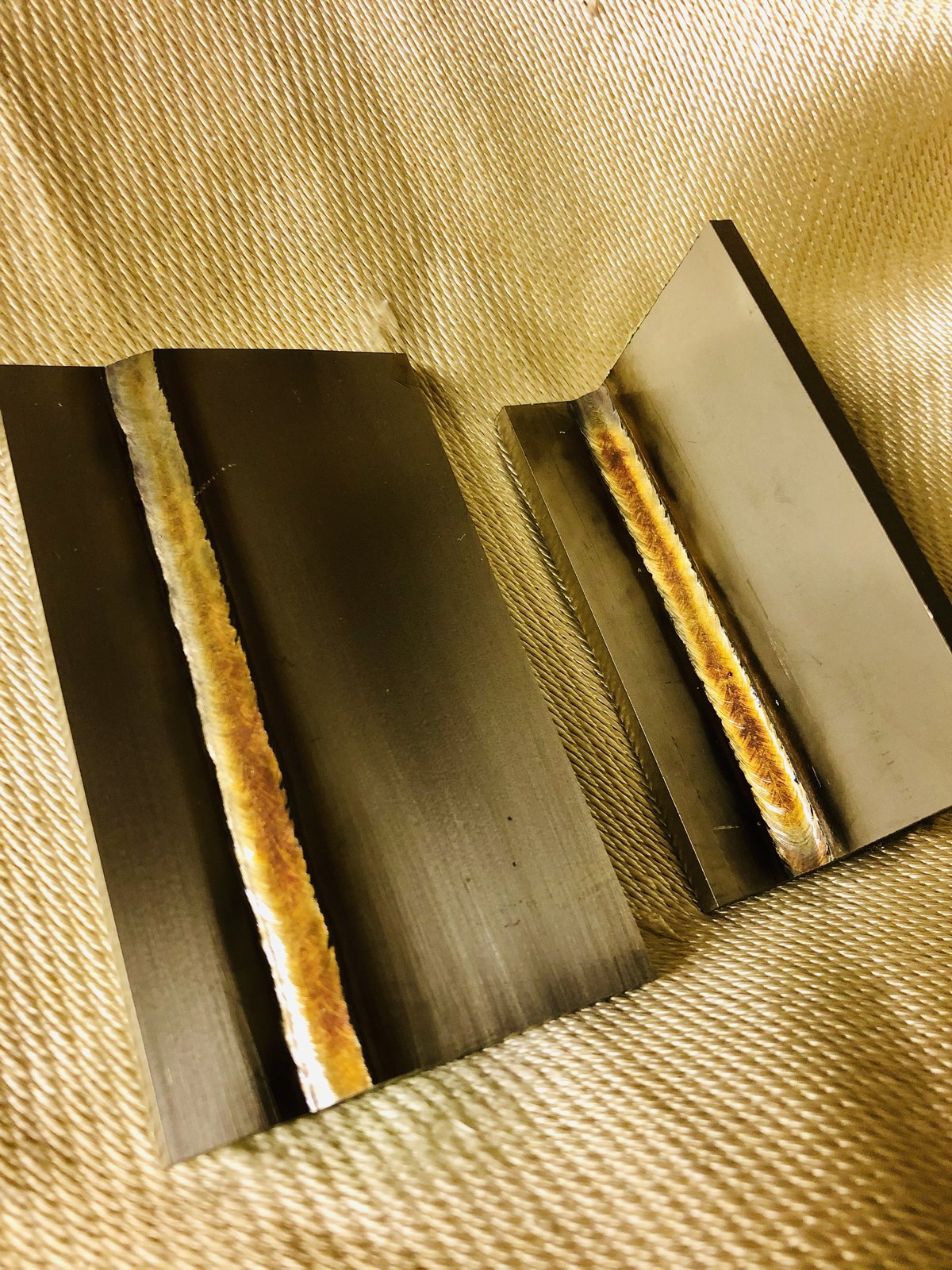

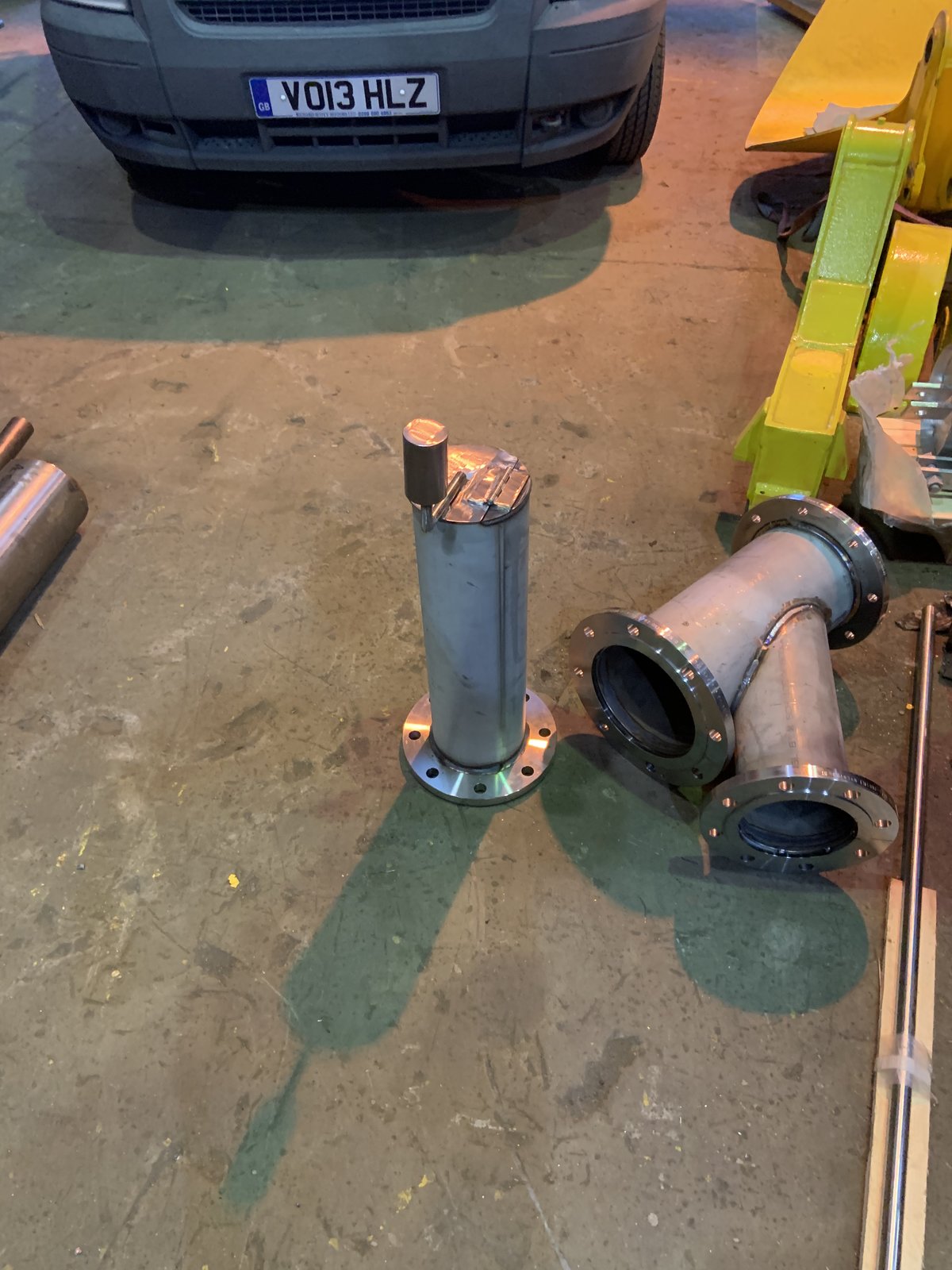

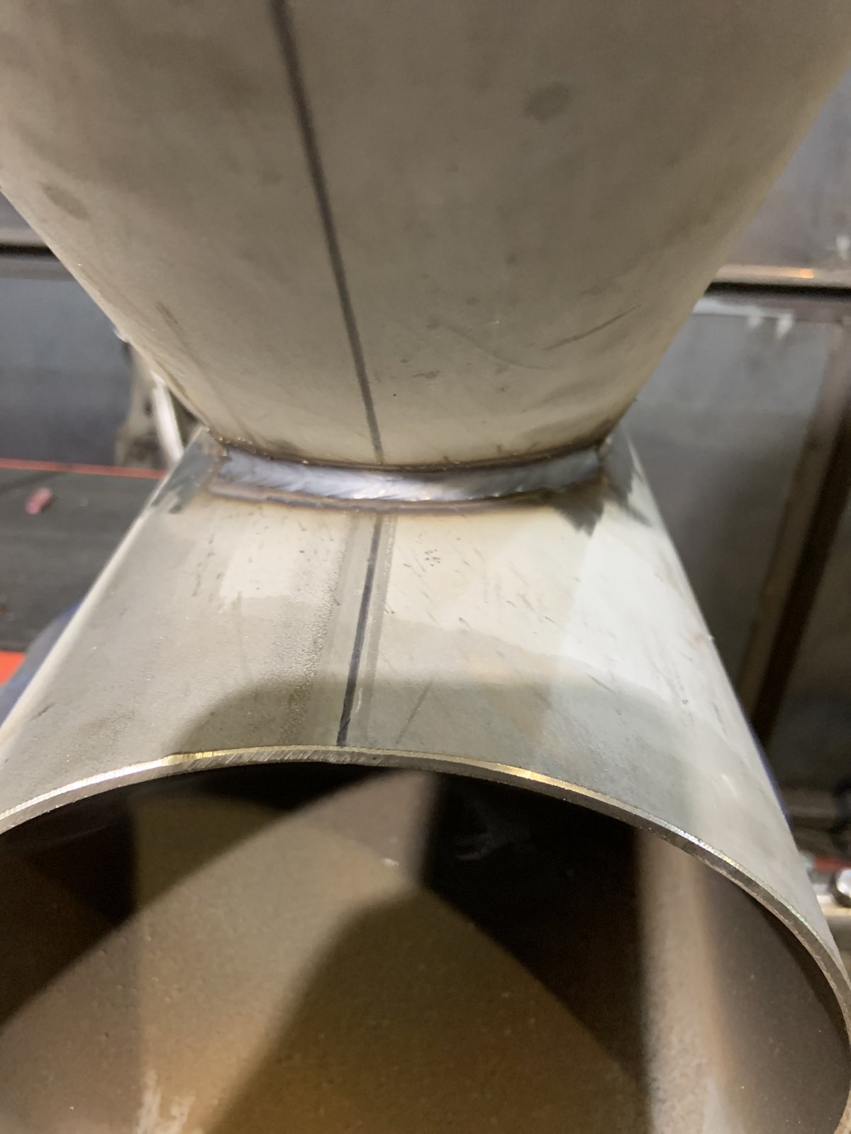

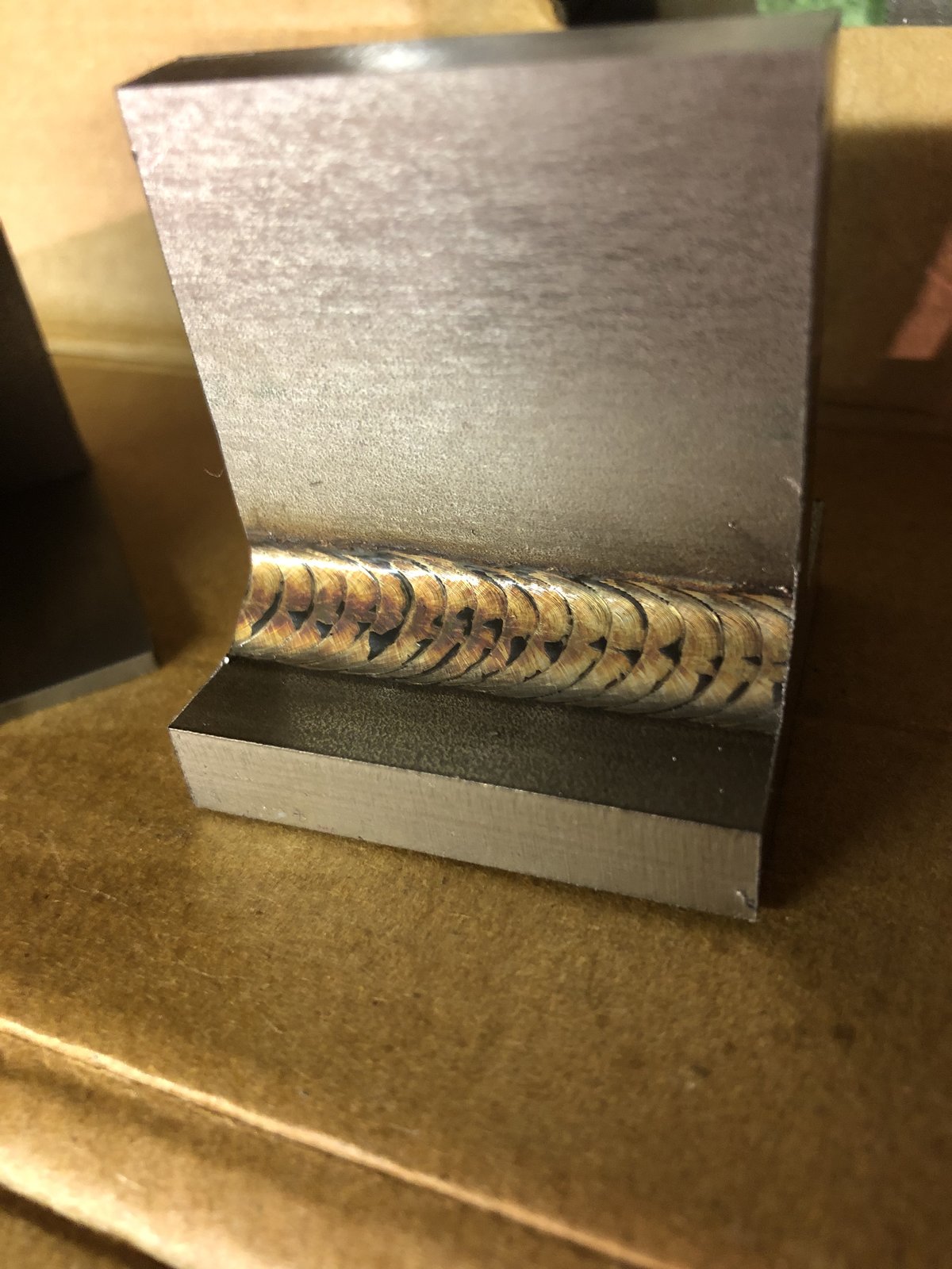

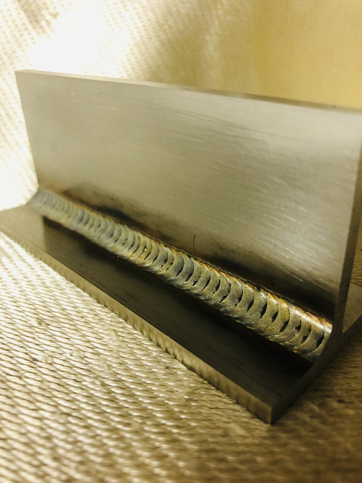

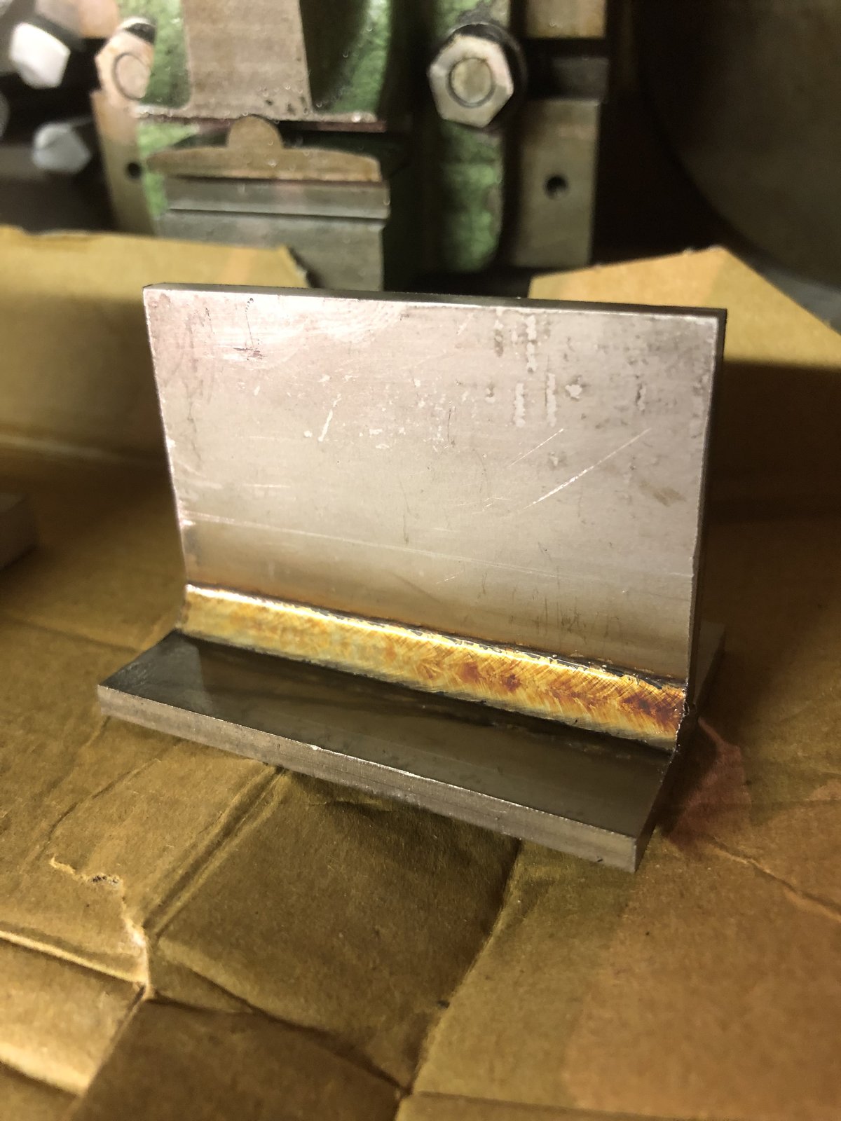

We’ve been doing some small handout samples in stainless steel last week to educate people out there with what’s available from our Speed processes. To start with we concentrated on SpeedpulseXT, TwinPulseXT and SpeedUp
The welded area is presented ‘as welded’ so no cleaning, no abrasives, no chemicals or spatter removal. All I’ve done is clean the plates and protect with clear coat afterwards.
Wire is Bohler 316LSi gas is Air products Inomaxx 2 and equipment is the S3 Mobile with powermaster ML3800.
The astonishing looking welds were carried out by Matt1978 and I cut and finished them at home. Take a ganders
