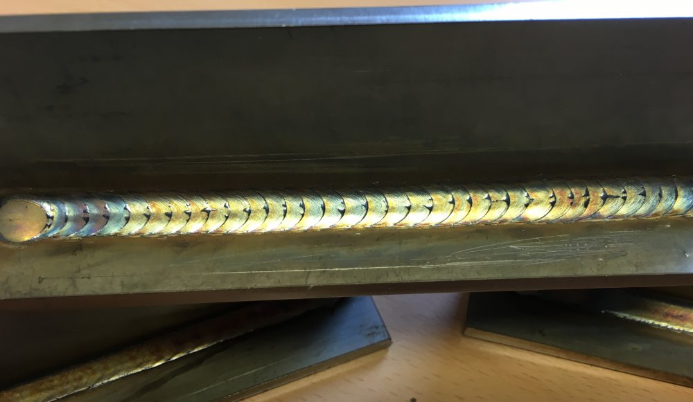

No SpeedPulse and TwinPulse are not the same thing. TwinPulse is the process that allows a Tig like appearance
Try running it on the 1.2mm 308 and 98 Ar 2 Co2 programme.

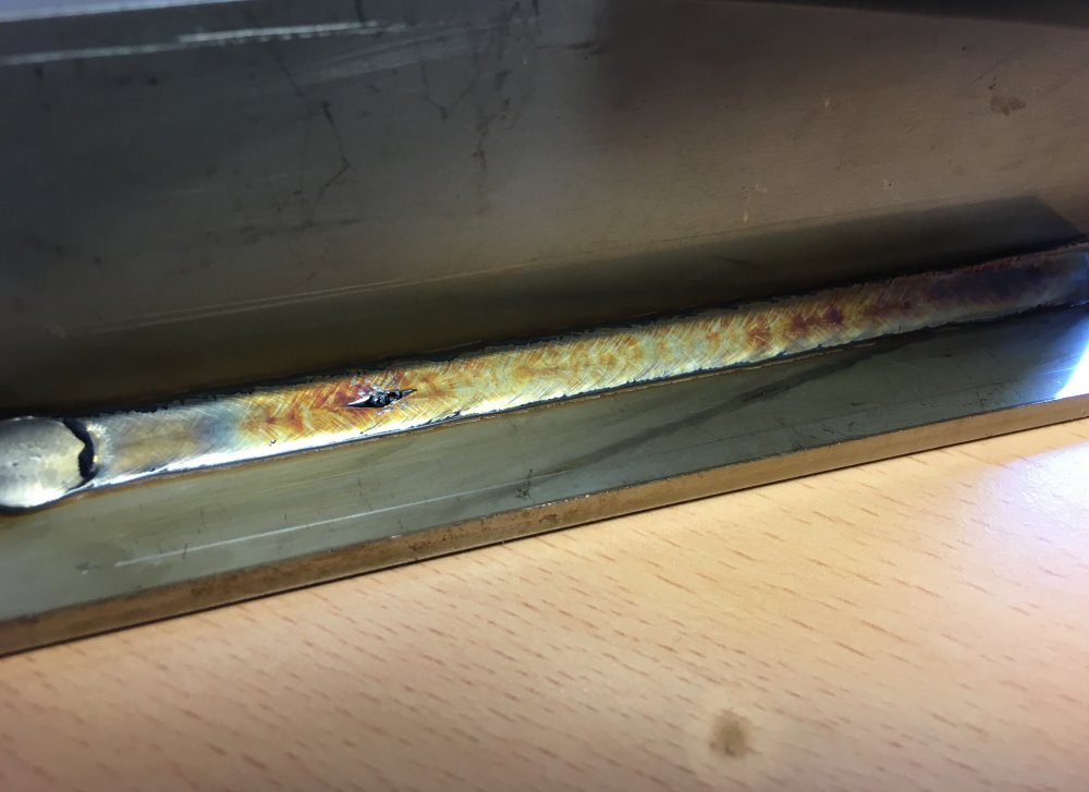

It will be because you haven't selected the 97.5% Ar and 2.5% Co2 on the Gas mix. If you have the wrong gas selected (eg 82/18) it will come up NoP

Do you have the XT process brad on your machineMatt can you ping me over the twinpulse settings you used for this? When I get a new liner I will have another go to try and get some pukka results. My welds were coming out a bit grey today. @matt1978

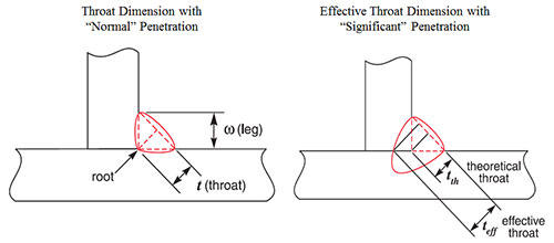

I use a lorch at work and I’d like to know how the mass of the material I weld affects the penetration as my manager believes that on speed arc XT you can have up to five mm penetration on very thick slabs which sounds very unlikely to me . Can any one help pleaseHad some customers here today to look at the new SpeedPulse-XT & Speed-TwinPulse XT process.
Works great on Stainless Steel as you can keep a very close arc length but without virtually any spatter.
