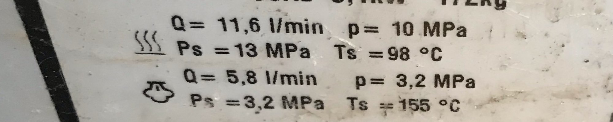

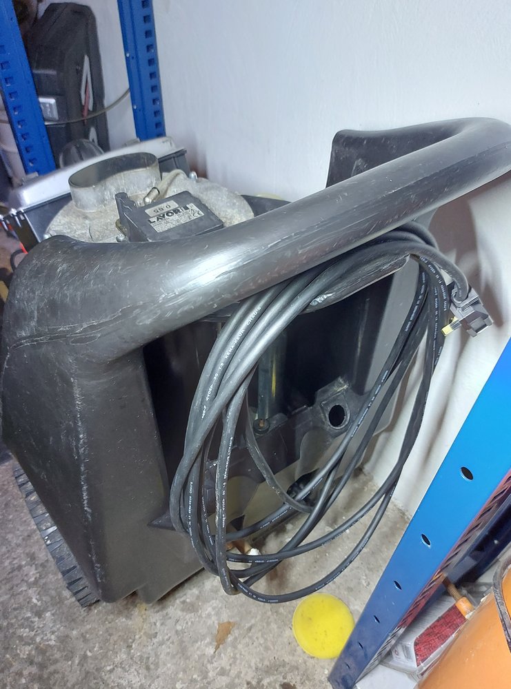

Even with the commercial hot washers they will only achieve about 90c when operated at full pressure. The way they are able to get to higher temperatures is by reducing the flow through the burner coil which allows more heat to be transferred to the water.It appears that the newer ones don't go as high temperature wise. This one is 90c approx
