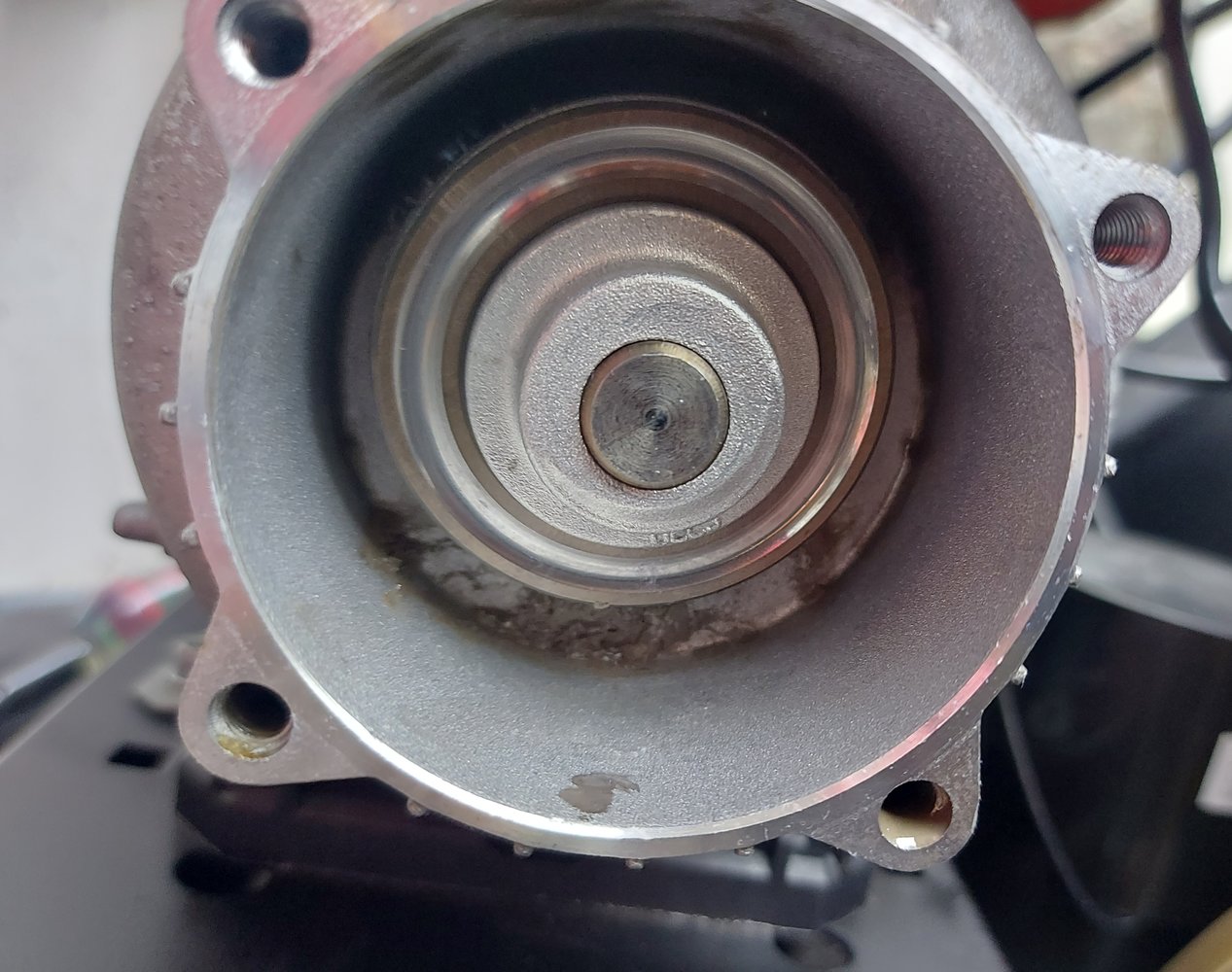

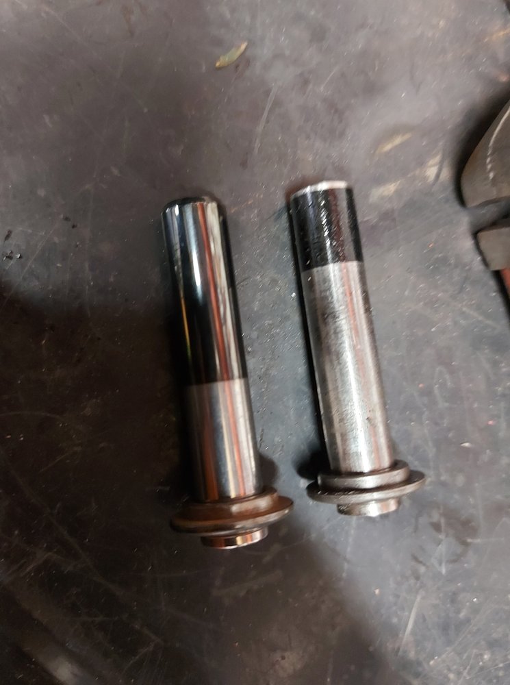

There must be no damage to the coated part of the pistons for them to be serviceable

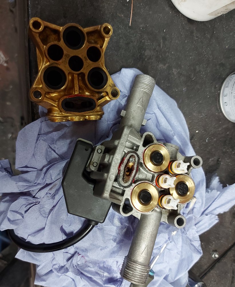

I ordered all the parts. The Italian website was a nightmare but got there in the end.
The springs are not available on their own. It has to be a set of 3x pistons with springs.
The parts may be small but they are expensive! £138 inc tax and international shipping for all new parts including seals & valves etc.
Parts will take a couple of weeks to get here so I'll let it sit until then and a half day will have it running again.
