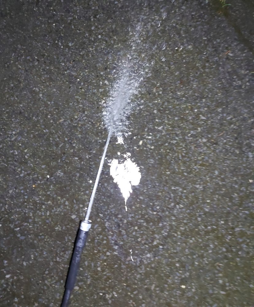

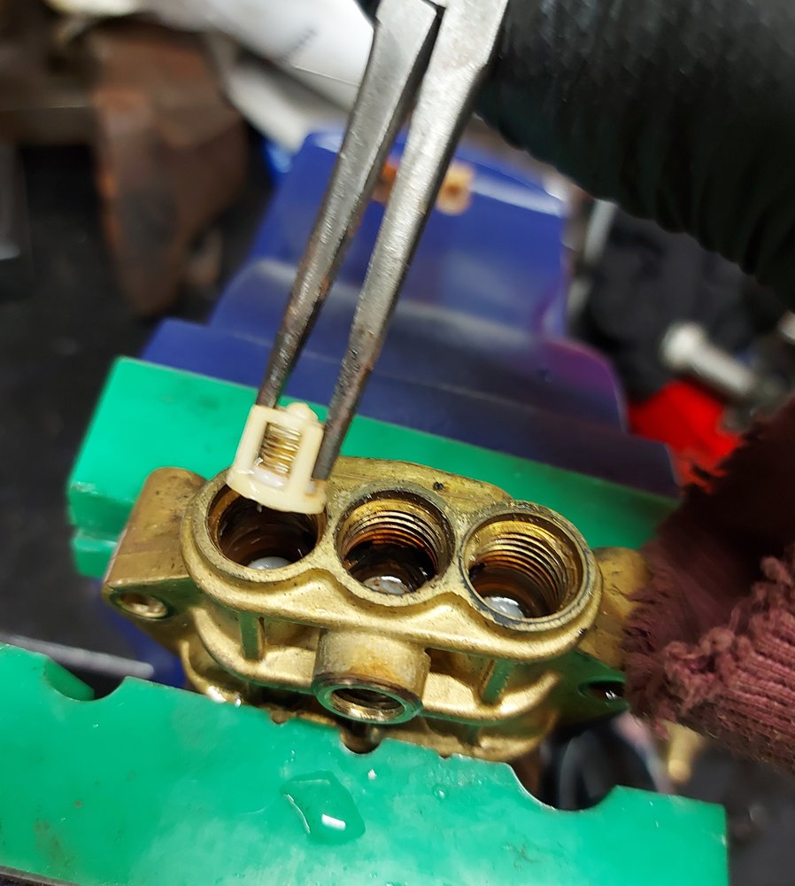

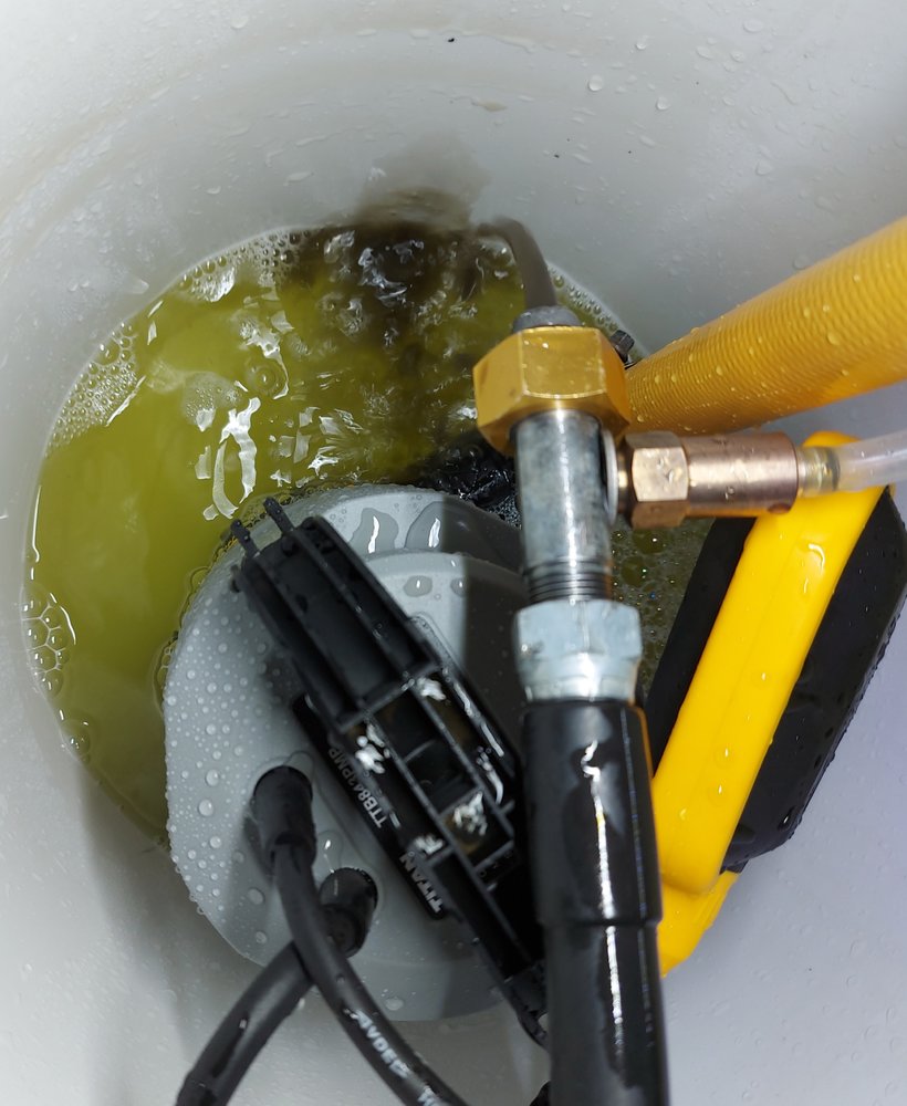

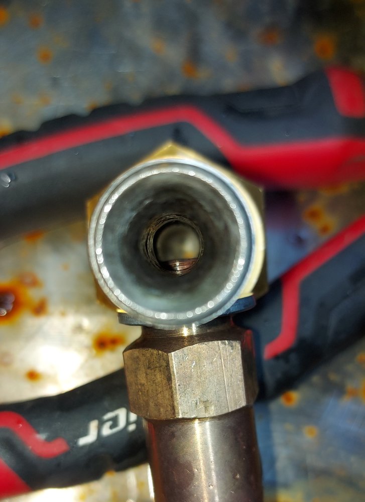

Update, 3 hours in now and I just changed the acid again. Black water coming back through almost immediately.

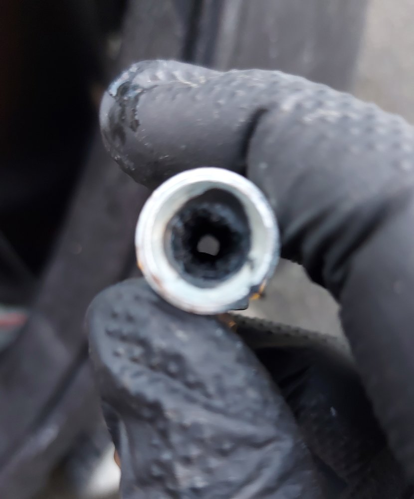

But, its getting cleaner. I checked the fitting in the picture and the bore of it is very well cleaned up but there is still some rust scale visible.
So I'm currently adding all the acid I have left with kettle water again and I'll let it run until 9 or 10pm then flush it all well with clean water to get the acid out.
Ok for the sunday morning driveway blast but dont even consider this type of pump for industrial use. My 21L Interpumps and Cat pumps work 8 hours a day non stop sometimes on roof cleans without a single complaint. Look on Ebay for spares or repair Karcher washers, the place is flooded with them and any other pump/motor integral type. If it was me i would put it back together and get it pumping then move it on as "needs looking at" type of sale.
