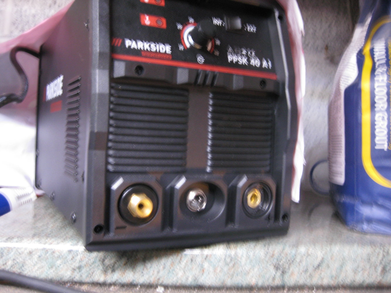

I've previously used the plasma to burn off siezed nuts/bolts. Either when heat has failed to shift them or there are a few to do and look like burning them off will be easier.
I've never actually tried heating one with a plasma.
First thing, I previously had a big 3ph plasma with pilot arc. From memory the pilot arc would only run for maybe 3 seconds and then it would all stop automatically if you had not started cutting.
I don't know if they all behave like this?
If not, I think, with the pilot arc running, once the 'flame' contacts the bolt it will just switch to cutting mode anyway.
Possibly you could just turn the power down so it's not enough to start cutting but I think the flame is so narrow even at low power you'll just get a small line cut into the bolt.
Different size tips are available, maybe you could increase the tip size?
I'd think if it was viable they would sell special heating consumables and I don't recall ever seeing any.
Or, maybe if you just cut a series of lines into the bolt head enough heat might transfer into the bolt but I'm not convinced it's going to work.
There is a lot of air blowing out of the torch and that seems to cool the part down.
If you were cutting 5mm sheet it's probably cooler after cutting with a plasma than it would be if you cut it with an angle grinder.
Probably because the plasma is so much quicker there is not so much time for heat soak.
My thinking / wondering was whether if a Plasma was turned down to a low power level (like for cutting thin steel say) it'd just heat (not kept on too long obvs) and not cut.
Hadn't thought about nozzle sizes (ignorant of them) - but can see that a low setting with a wide nozzle dispersing the power would be rubbish for cutting.... but might ( might) heat a bolt but not cut/melt it.
I expected to be wrong - but hadn't seen anything specific so thought I'd ask
