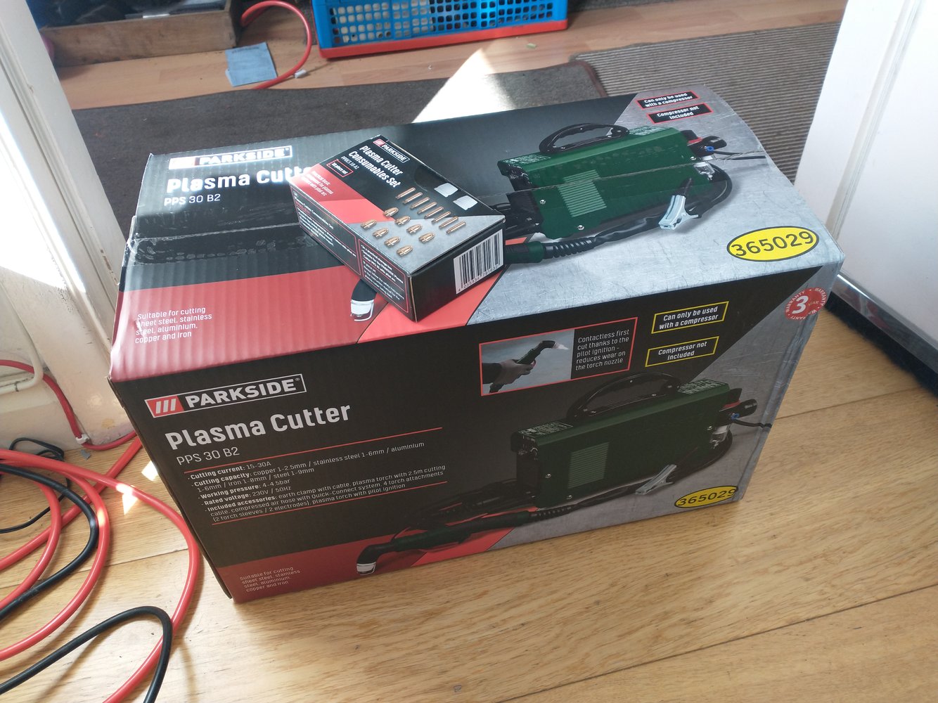

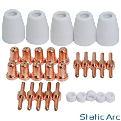

The inner electrode of the torch is live & the outer is connected back to earth, when you pull the trigger an arc starts between them turning the air going past into the plasma jet.Are these blowback pilot ignition? Asking because my powermax30 air is scrap with a board fault and I’m thinking about making a frankenmachine whilst Lidl still have them in at £149
