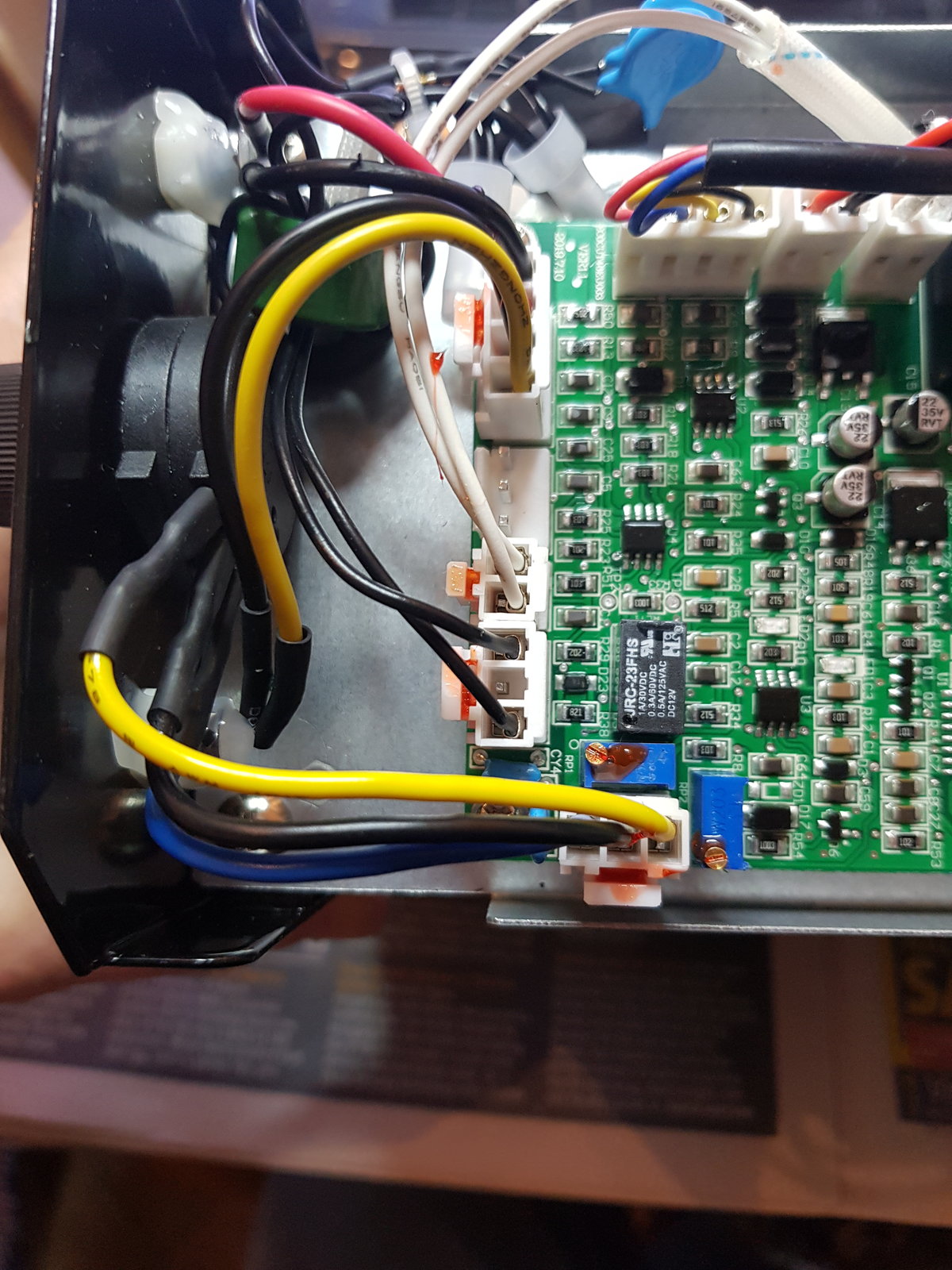

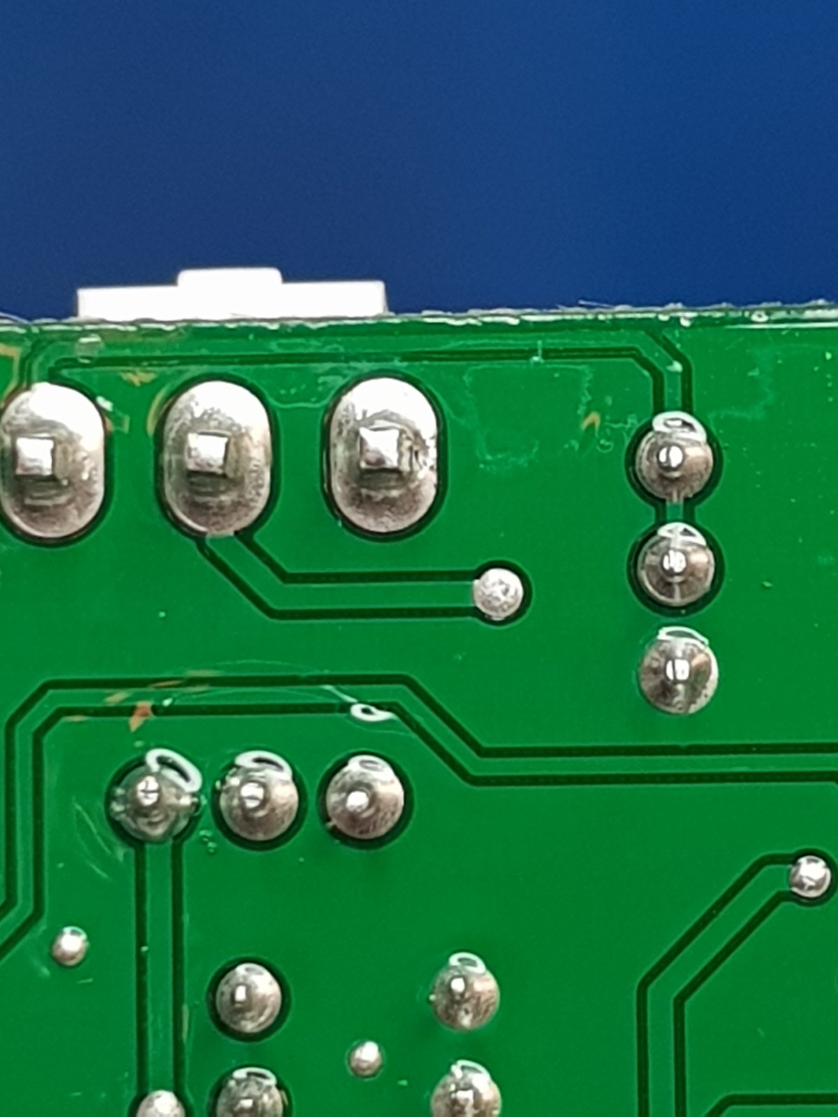

Suspect that's so they can put it on a UK 13A plug without soldering a piece of 1.5mm copper down the back of the fuseI can't see any jumpering, plug or otherwise. I suspect that the two pots on the top circuit board set minimum and maximum current.
The board is marked ECOCUT40EU003
Edit, edit:
which ties in with this product which clearly is identical.

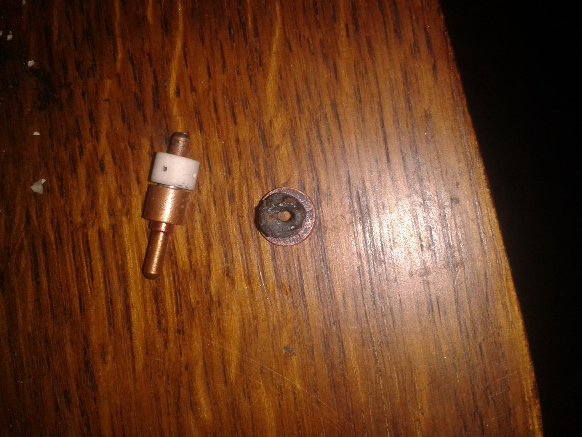

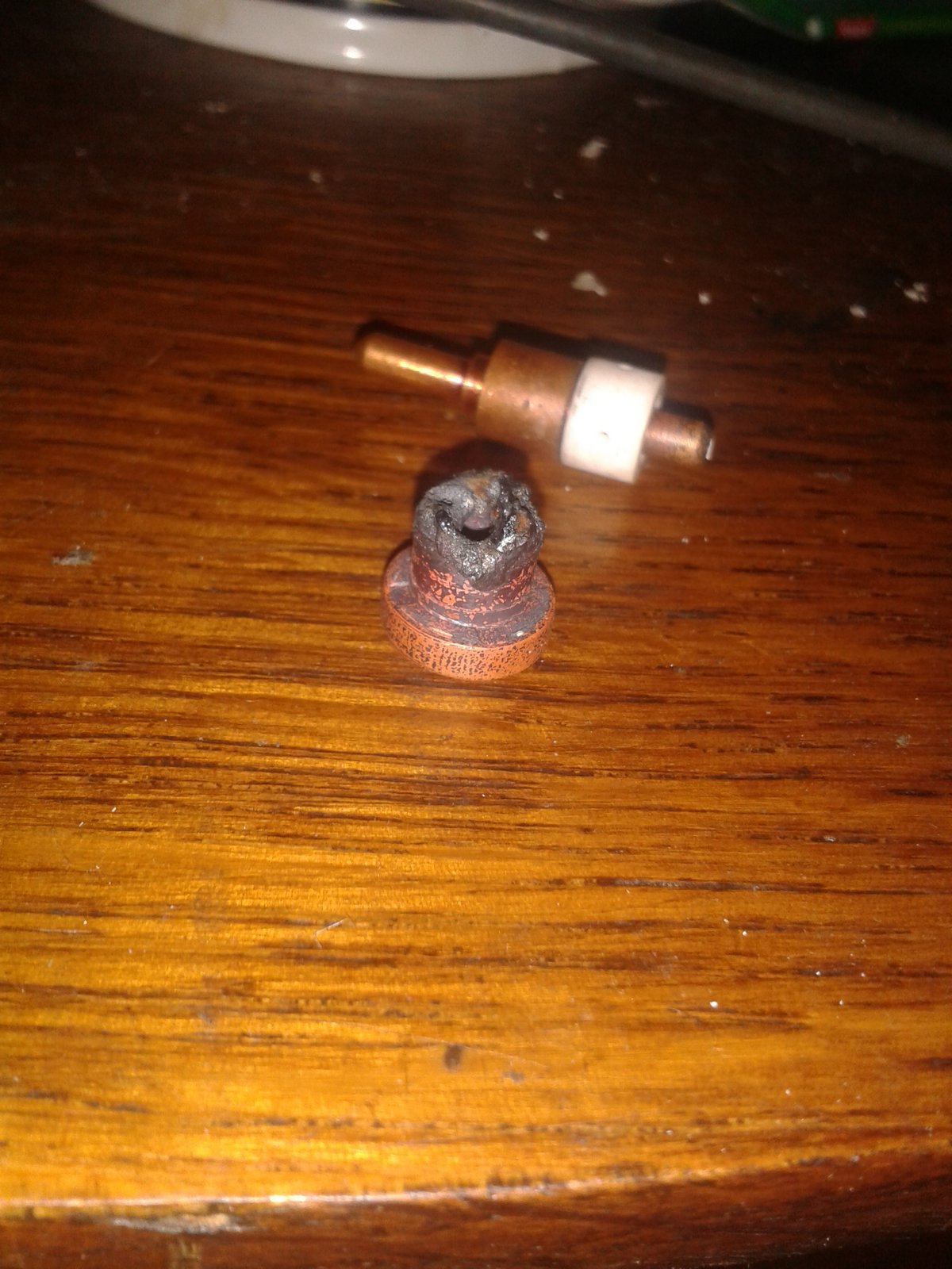

Plenty on eBay & seem pretty cheap!So next question is...what consumables do we order?
Is some lucky person going to get that for Valentine's Day tomorrow?
Which ones though?Plenty on eBay & seem pretty cheap!
Saw these ones:Which ones though?
( Haven't go my hands on it stuck at work)

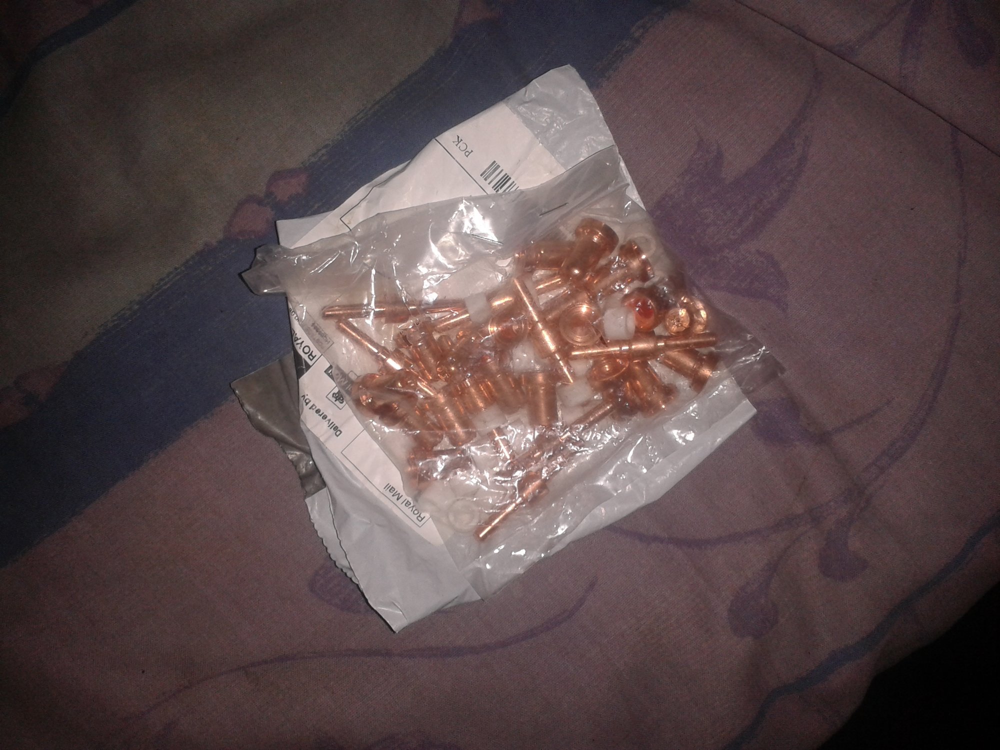

Saw these ones:
https://www.ebay.co.uk/itm/352961051289
Seems there are a number of different length consumables for the pt-31 torch. Going off the main electrode (long, thin on both ends), the Lidl unit uses 38mm part but some are 28mm and some are shorter. I guess if you replace all the bits with a matching set you should be ok.
Anyone else know for sure?
