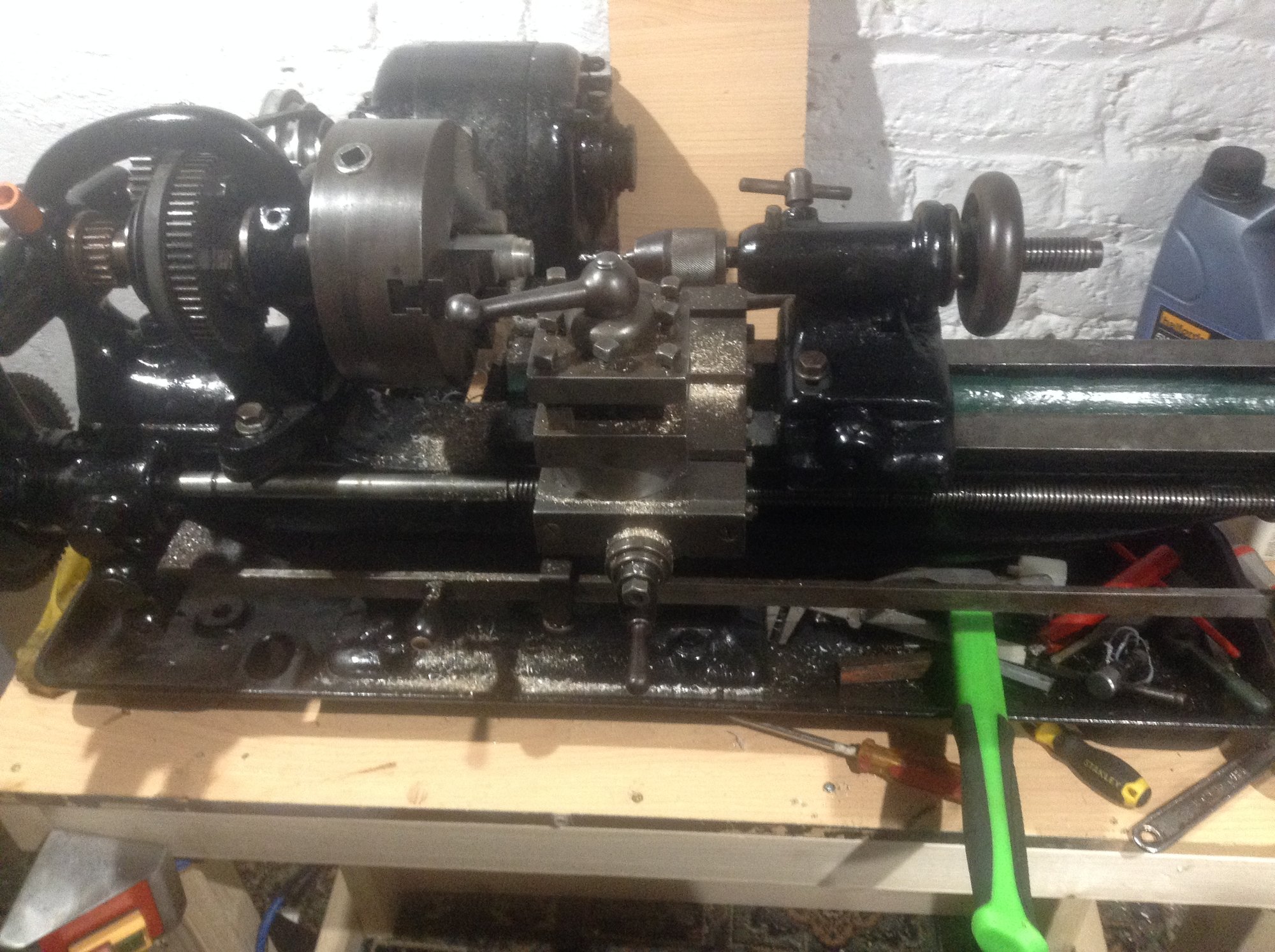

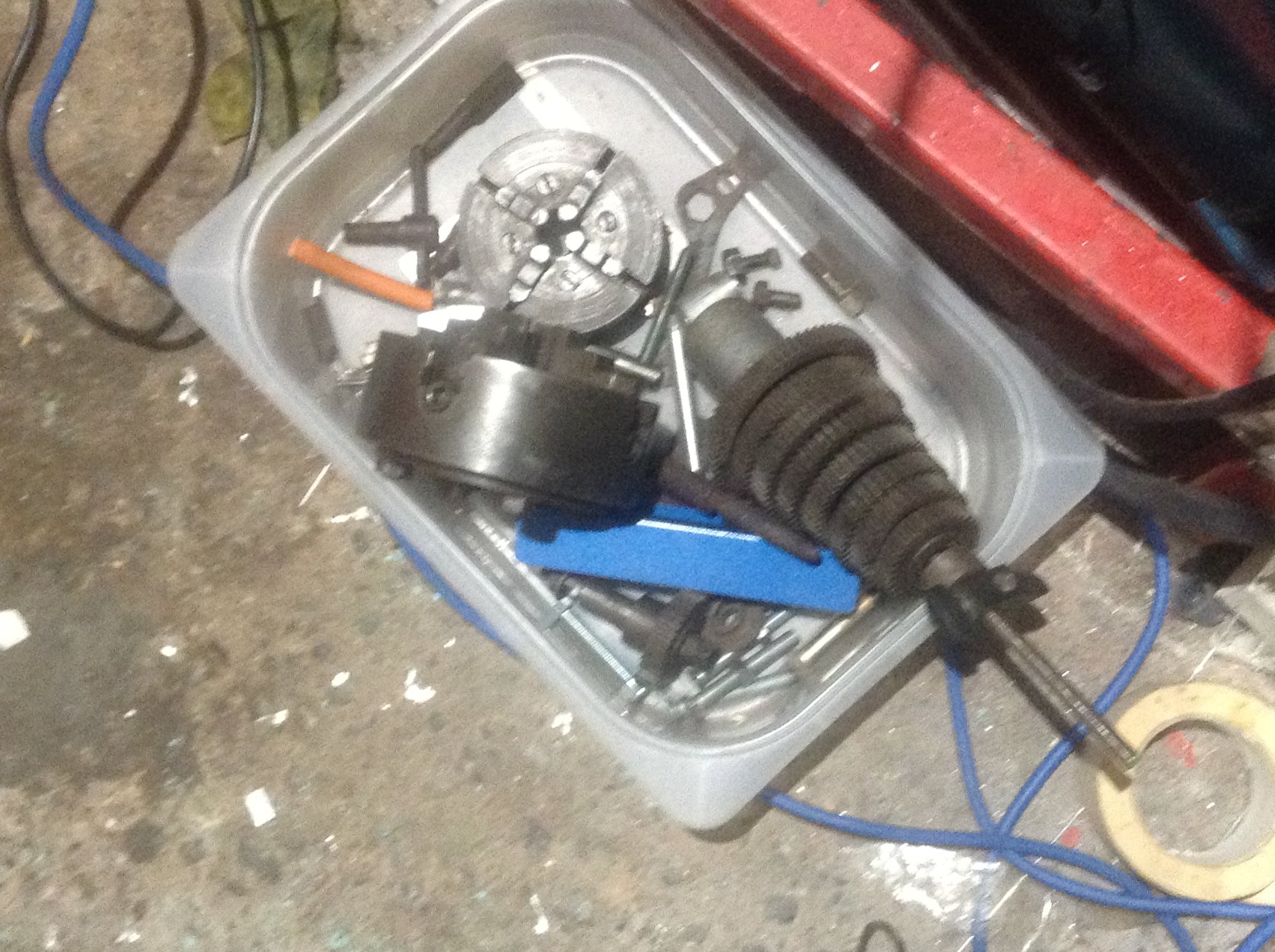

It is it's also got the gear to do left hand threadsLooks like a full set of change wheels too.
If you like the Dixon type I have one of these on the M https://www.rdgtools.co.uk/acatalog...OST-TO-FIT-MYFORD--dixon-type--725MYFORD.htmlI'm looking for a quick change tool post for it now which one would work with it
I like the big ol metal four way tool posts.If you like the Dixon type I have one of these on the M https://www.rdgtools.co.uk/acatalog...OST-TO-FIT-MYFORD--dixon-type--725MYFORD.html
I know many don't like that type of tool holder but it fitted to the lathe with no modification and I can run a 12mm tool at the right height something you can not do with a Myford ML7Though you will need to make a new nut to secure it to the existing stud on the cross slide.
Mine came with a four way tool post exactly the same as the one on Jlg' s lathe, it was limited to a 8mm tool and I could not get a DCMT boring bar anyway near high enough ( other than turning it upside down and running it down the back of the bore).I like the big ol metal four way tool posts.
Yes I no what you mean. They can limit tool size.Mine came with a four way tool post exactly the same as the one on Jlg' s lathe, it was limited to a 8mm tool and I could not get a DCMT boring bar anyway near high enough ( other than turning it upside down and running it down the back of the bore).

I would keep to hss but it will see a lot of stainless and other hard metalLoverly looking lathe, good score, reminds me of how excited I was when I got my first lathe![]()
My advice would be to take your time and avoid inserts, stick with HSS or HSS:Cobalt tools, the edge you can grind/hone on HSS will give better results and be much kinder to a light lathe than inserts. That lathe was designed to work very well HSS with before inserts where invented .
You'll learn so much for free by re-grinding old tools and gain a skill that insert/indexible tools try to avoid, often with disappointing results.
You don't need a QCTP to learn to use a lathe, but they are very handy.
Have fun, keep your sleeves rolled up and the key out of the chuck!
It was when I got it but when I got home I had to build the stand for it and get it out the boot of my mams car in 30miniuts buy my self befor she went to workLoverly looking lathe, good score, reminds me of how excited I was when I got my first lathe![]()
