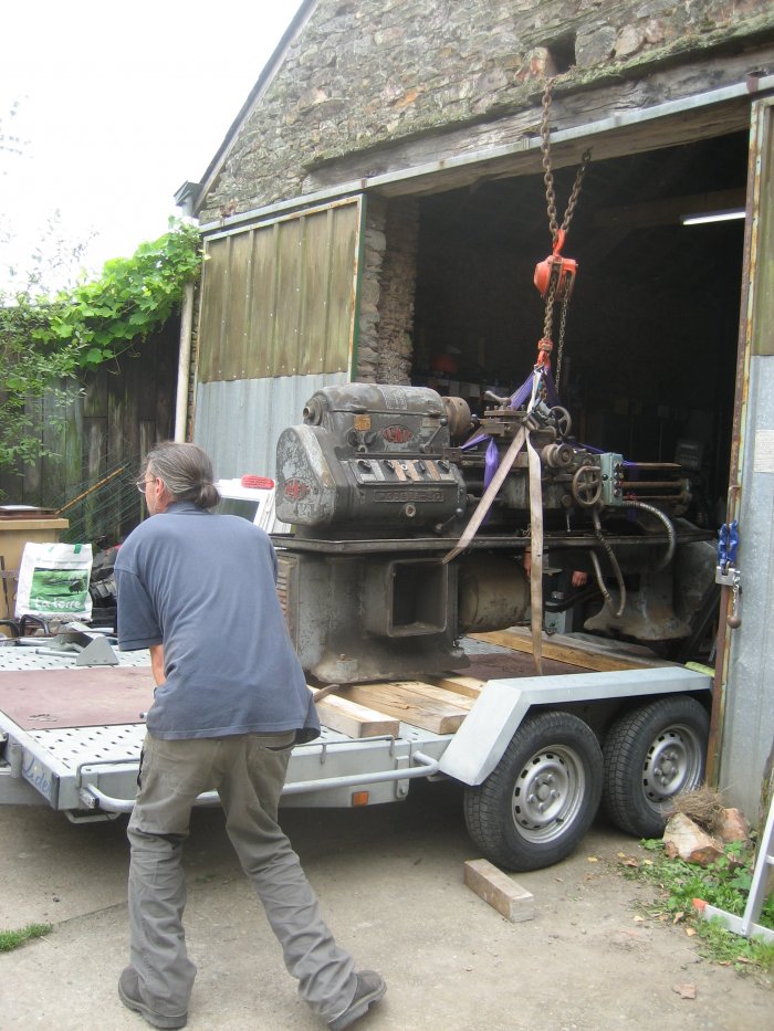

That's worth knowing, you can be sure I'd have wanted to separate them to keep centre of gravity low, assuming we go to collect.I would also avoid any idea of splitting the lathe of the base. You can do it but getting it all set back is not easy or for the faint hearted..
They are set on the base at the factory

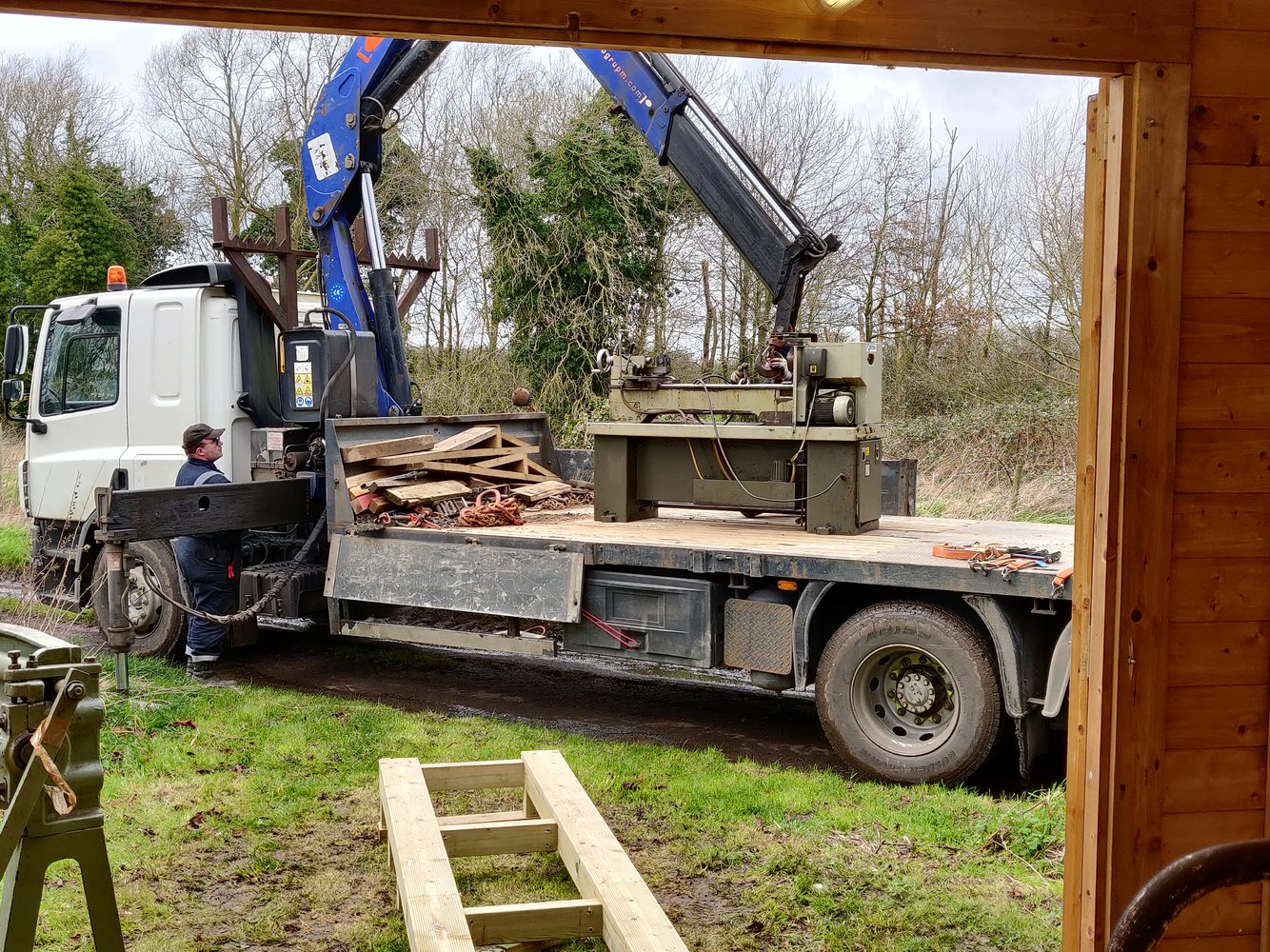

We watch your videos regularly, great stuff.Landy lift has moved a few machines for me .
Not the cheapest but he knows what he is doing .
Also fully insured .
If you contact him use my name by all means .

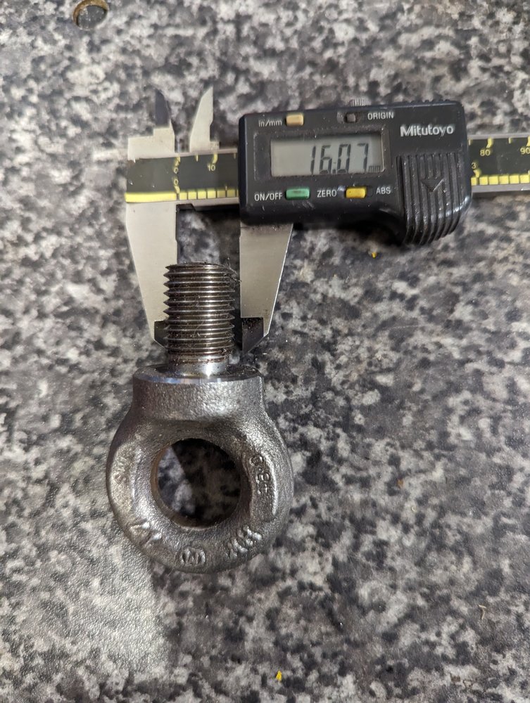

She’s a tidy one….They have a lifting eye thread (M16 I recall), so can be moved and lifted with an engine crane.View attachment 427925

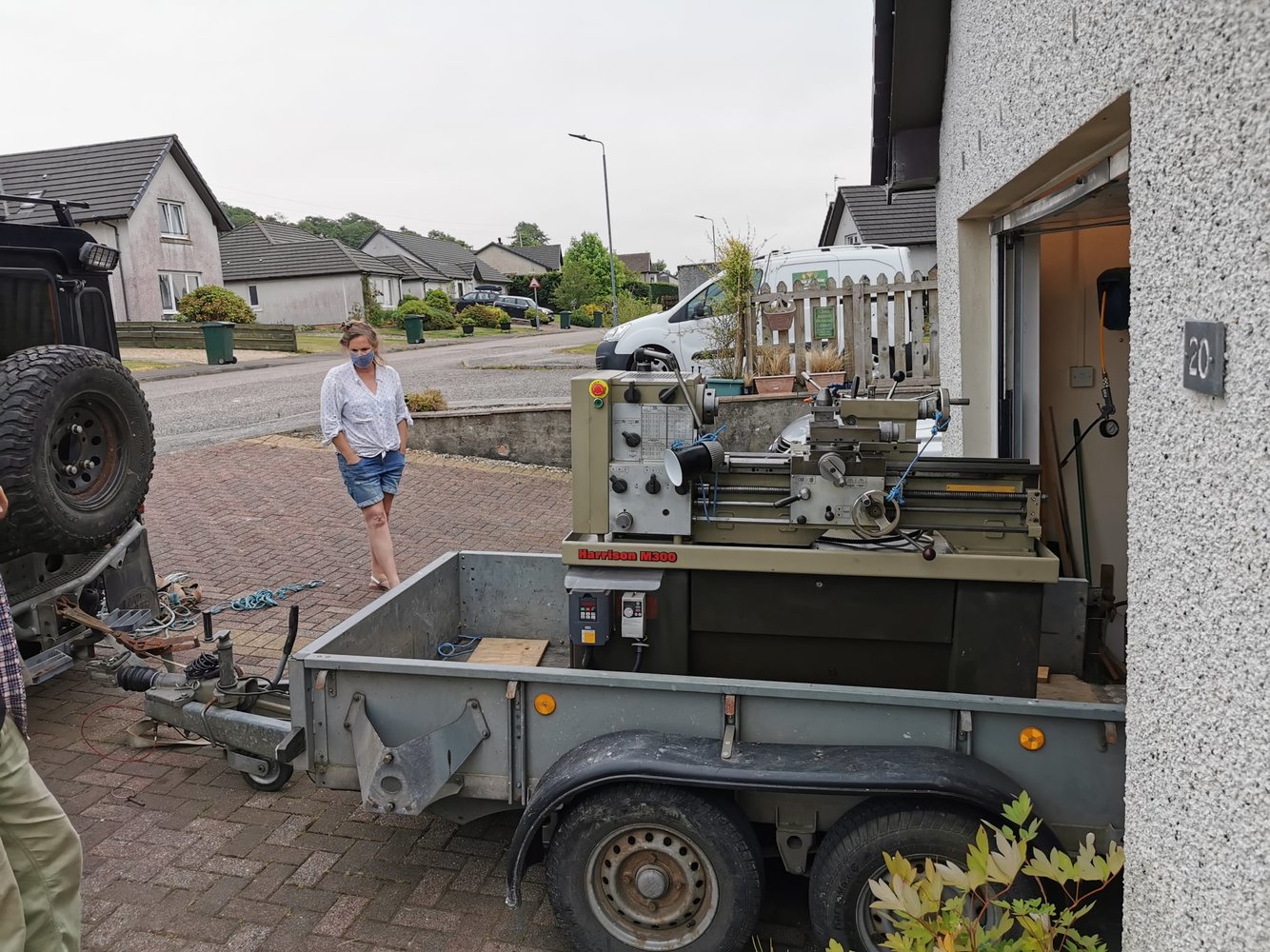

A friend delivered mine using his plant trailer:
