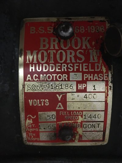

Shows star and Delta on the plate. Looks like 240v but can't quite make out.Had a quick look tonight and appears the motor is a 400v 3ph unit (1hp). Any suggestions on the best and affordable way to get this up and running off of a single phase supply?

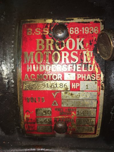

Probably is wishful. Could almost make out a 2 and a four.Are you sure? I think that's wishful thinking. I can't see anything stamped for the Delta.

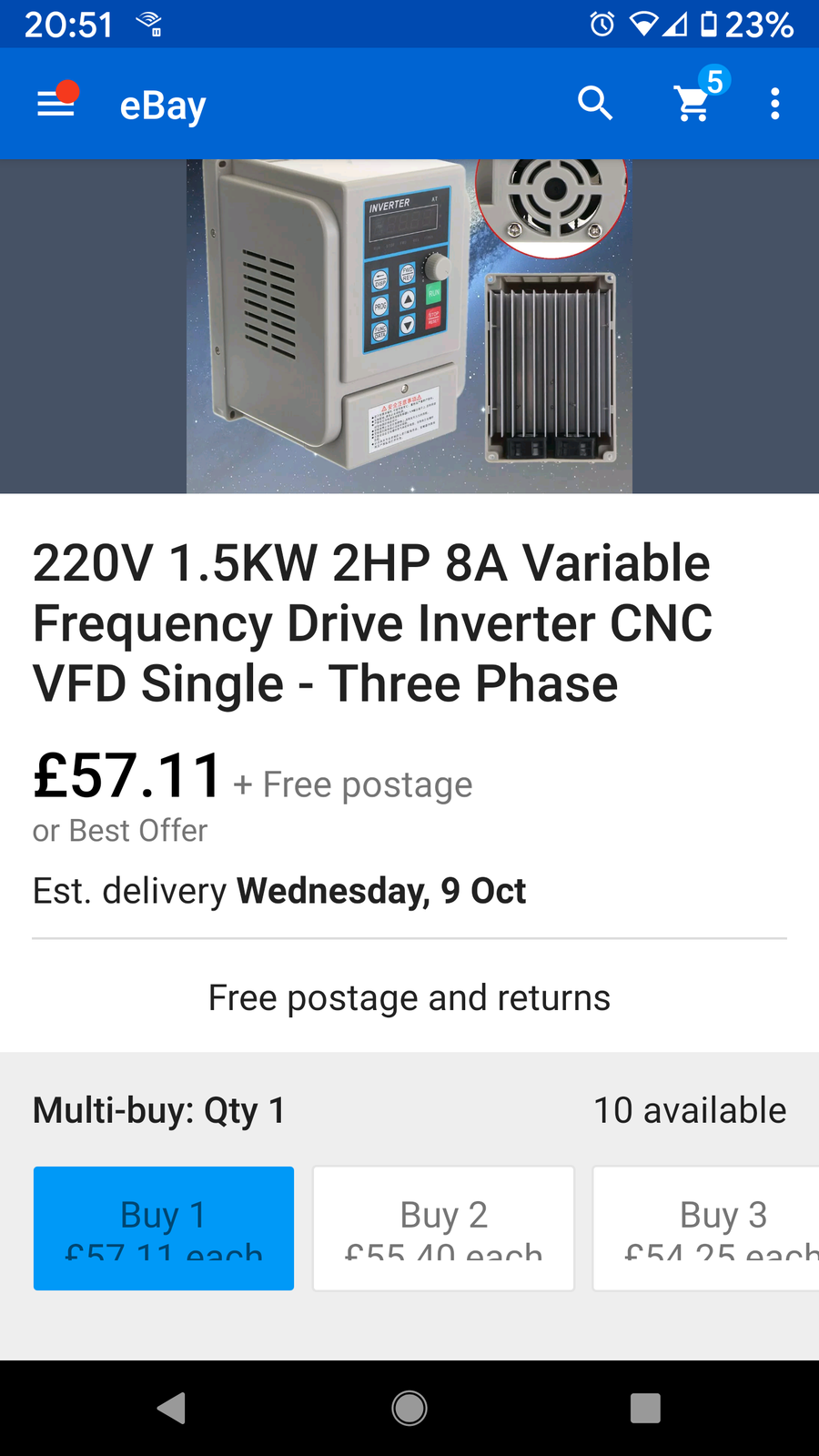

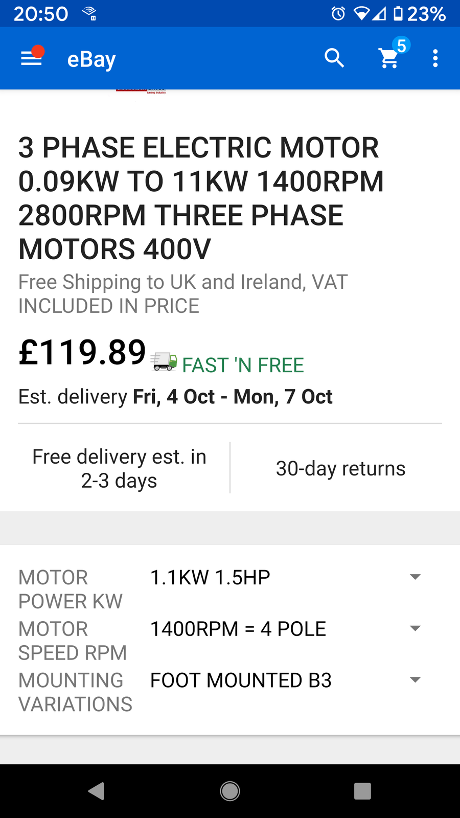

That’s a decent price there Slim, thanks. Anyone local to Inverness that could potentially pick this up and hold onto it until I’m up north next? Beer tokens awaiting
All mine will go that way in the end.Regardless of the small difference in cost, the versatility that running a VFD provides is worth the expense.

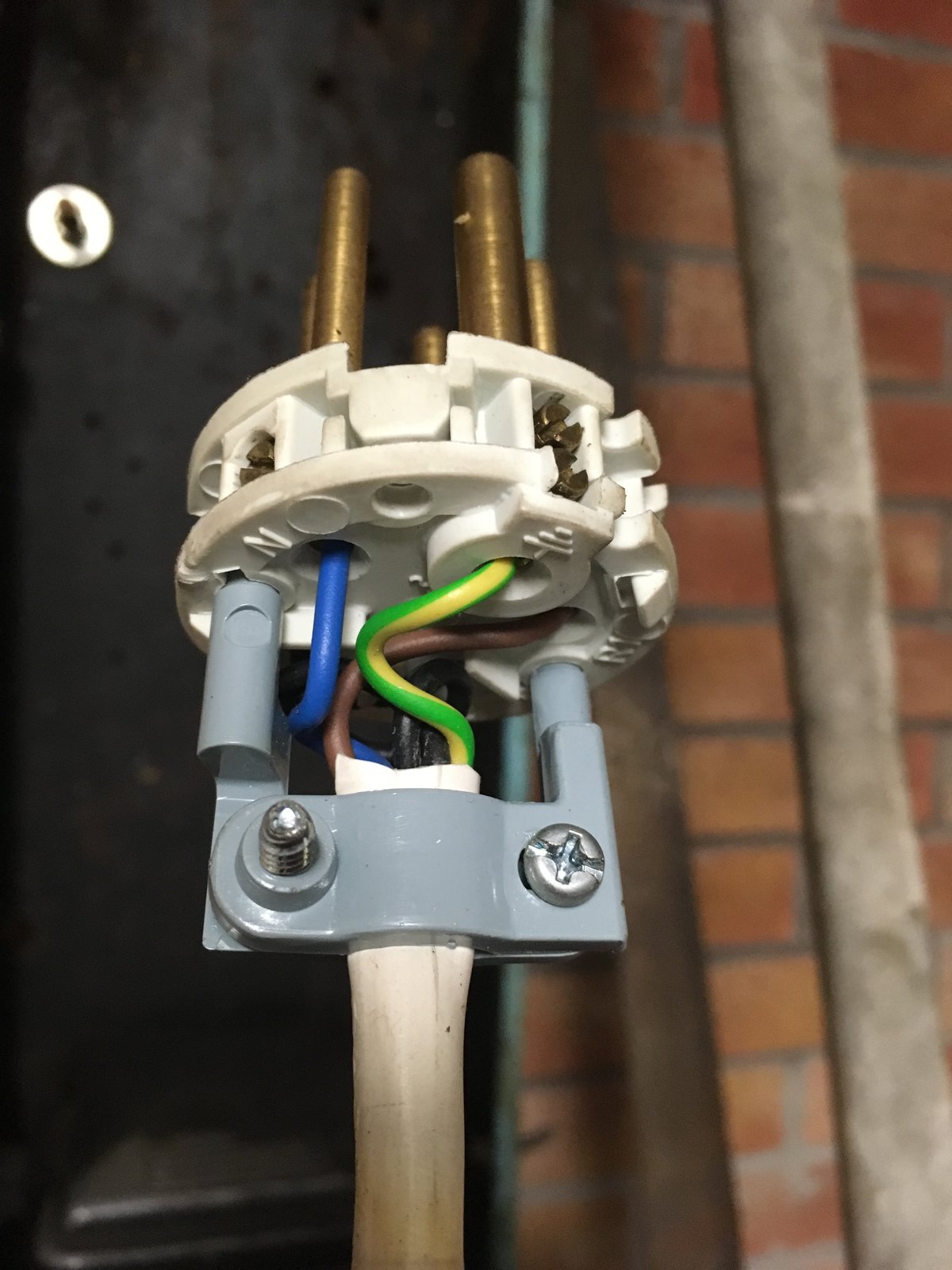

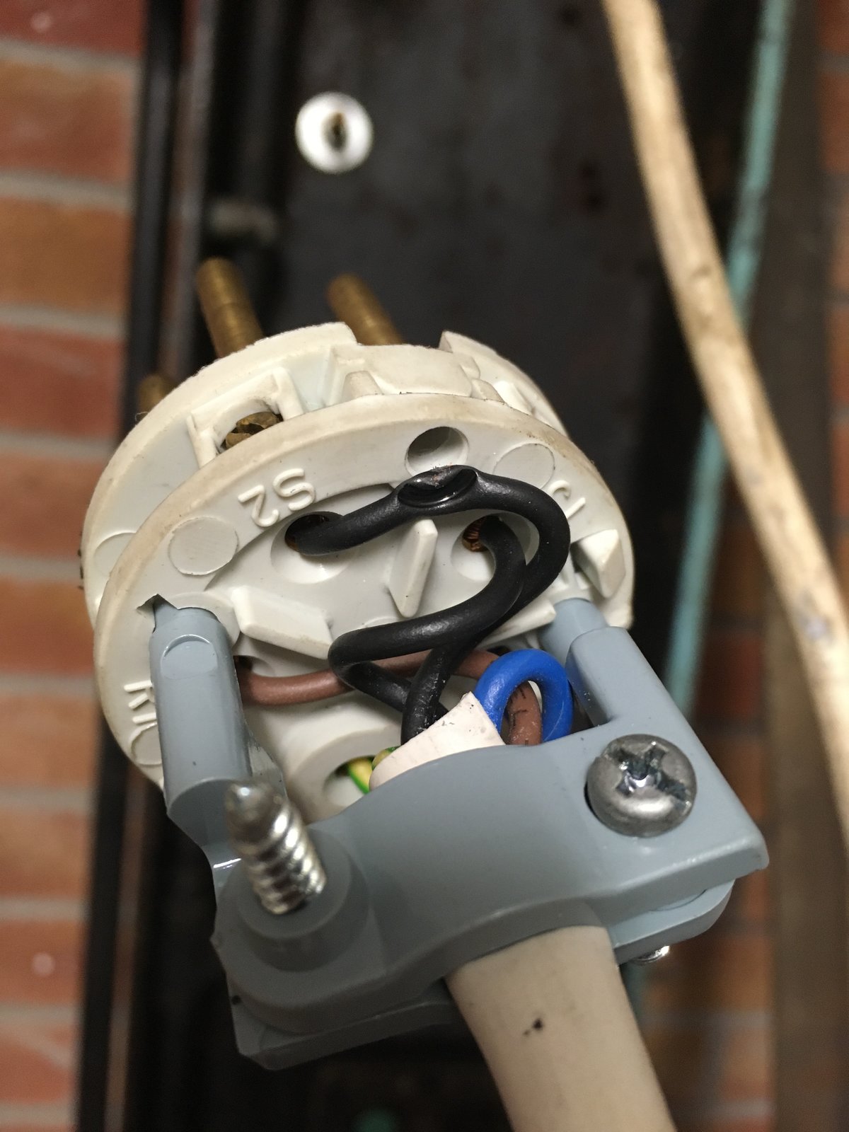

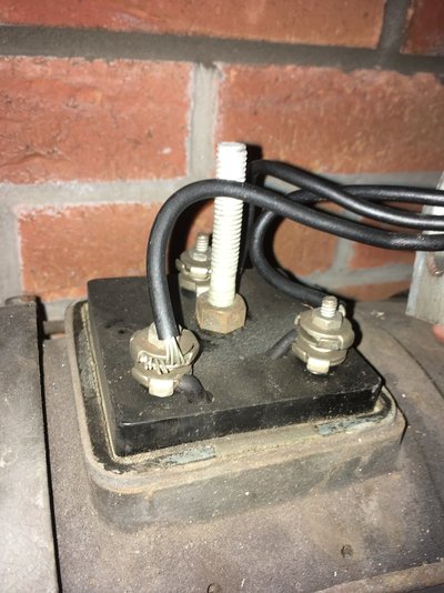

First - top cover removed on motor
Without going to the expense of a 415v vfd you'd need to open the motor to find the star point so that it can be reqired for 230v delta operation.
