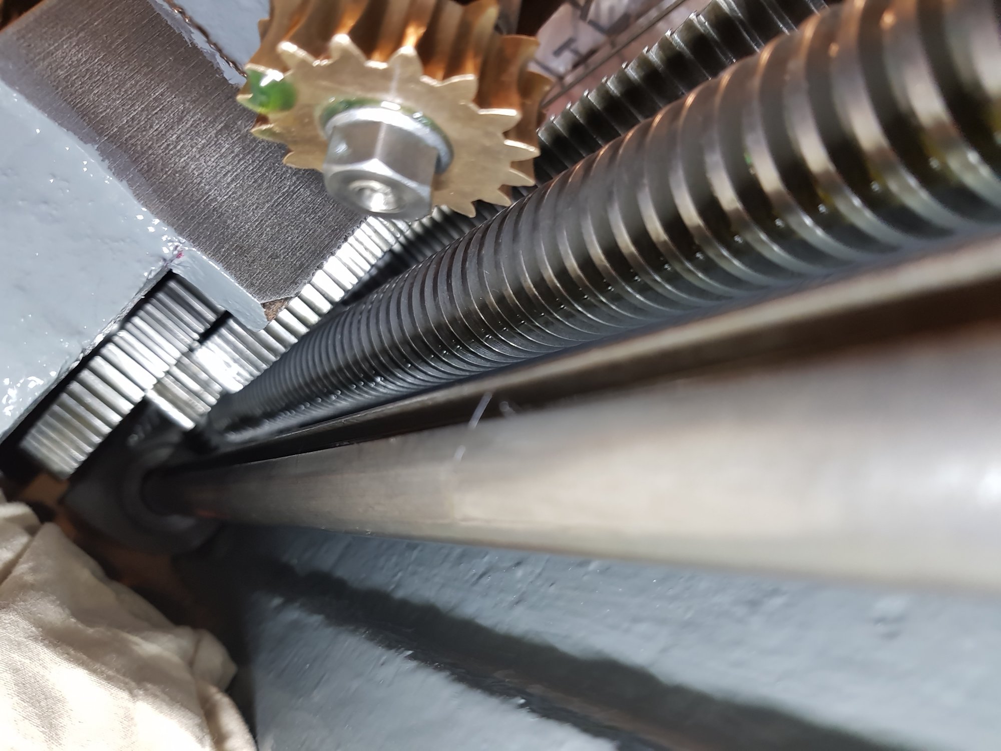

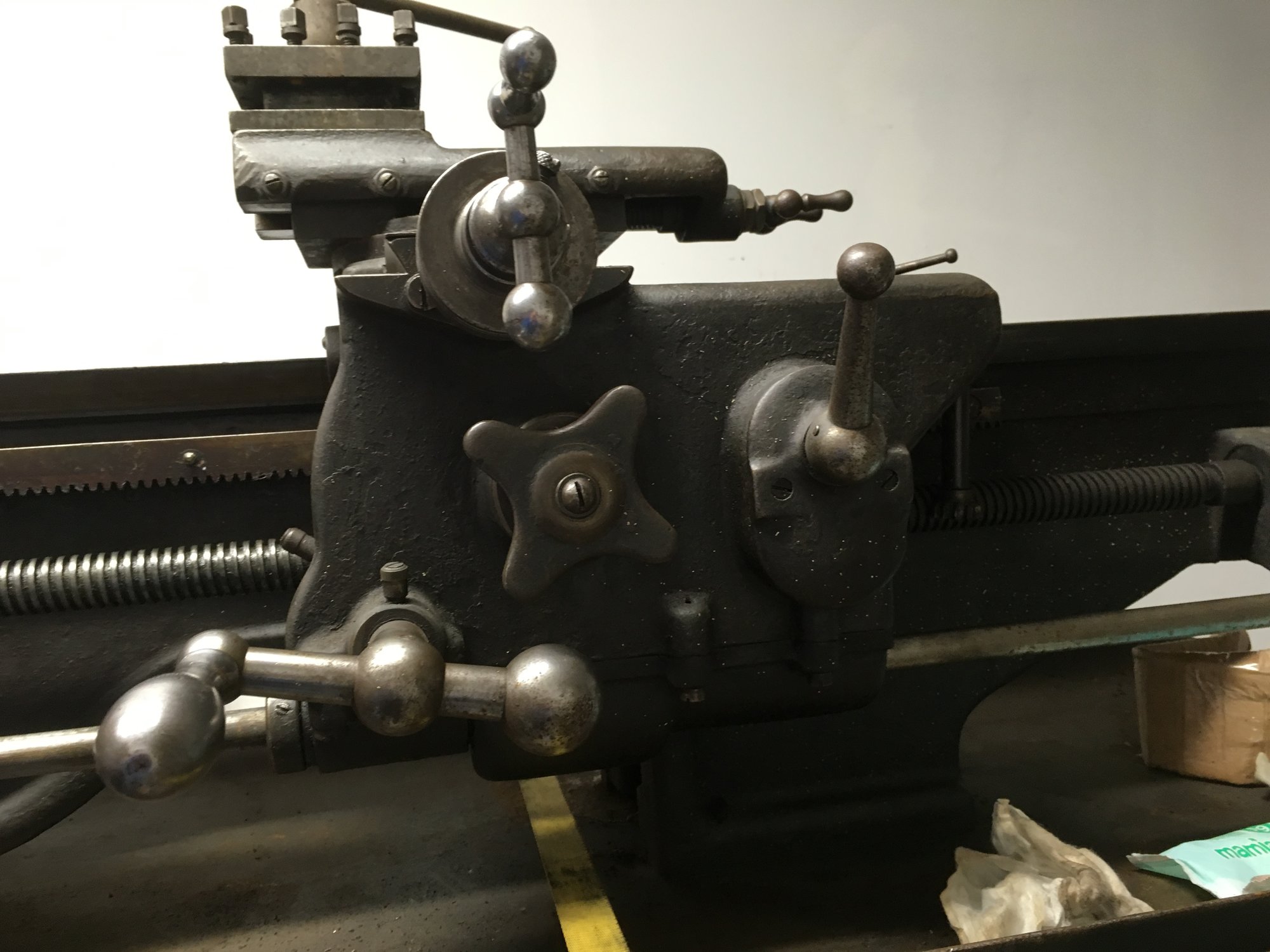

Yes... got ya... that feed shaft has got to come out unfortunately. My Mellor lathe carriage is bolted underneath. But you can't sperate the two until you remove the whole unitThe feed shaft looks like it is a pressed pin that holds the end on whereas the lead screw was a threaded nut with grub screw. That’s the main reason I avoided removing it last night.
Rear of the carriage is free. There was a metal bracket fixed up to the underside using three bolts. If you look at the third picture of my post from last night at 1035pm it shows the rectangular bracket sat atop the bedways
Edit: second picture shows the pinion on the rack that’s stopping me from lifting off the whole assembly
