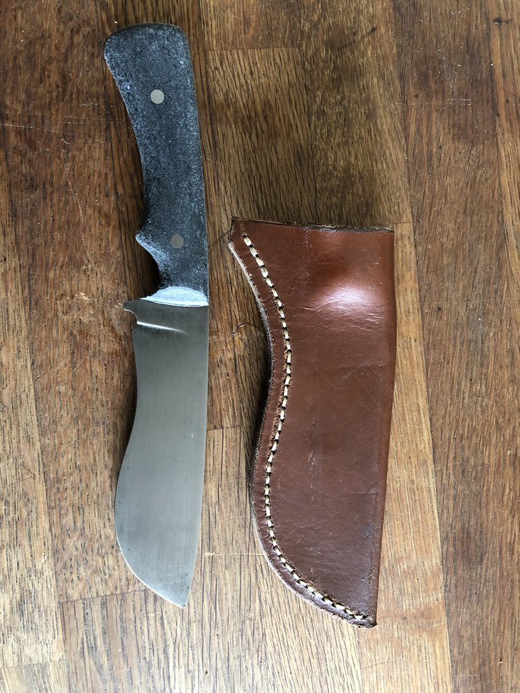

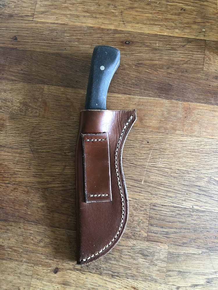

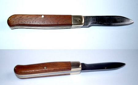

Looking very smart, I like the simple sheath. Excellent workHere's that knife above all finished and the first sheath I've made, it's not great but it fits snugly. I tried something new by using HDPE for the handle, I'm struggling to get a good finish on it even sanded up to 1000g, I've ordered some blue buffing compound and I'll give it a go when it arrives. Stainless pins.

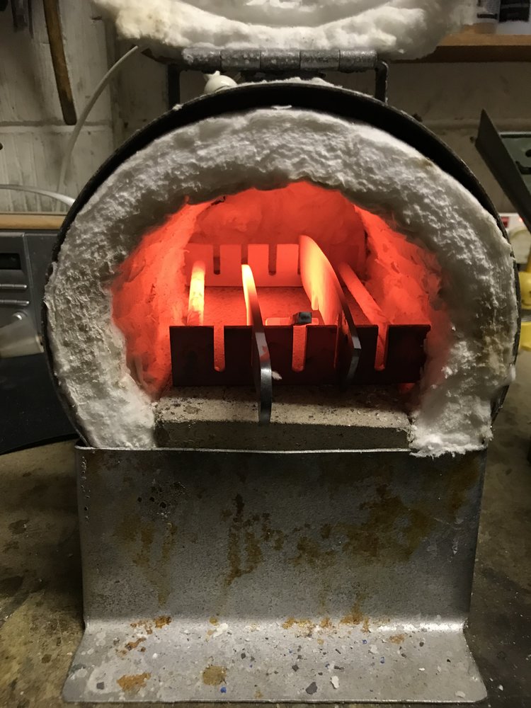

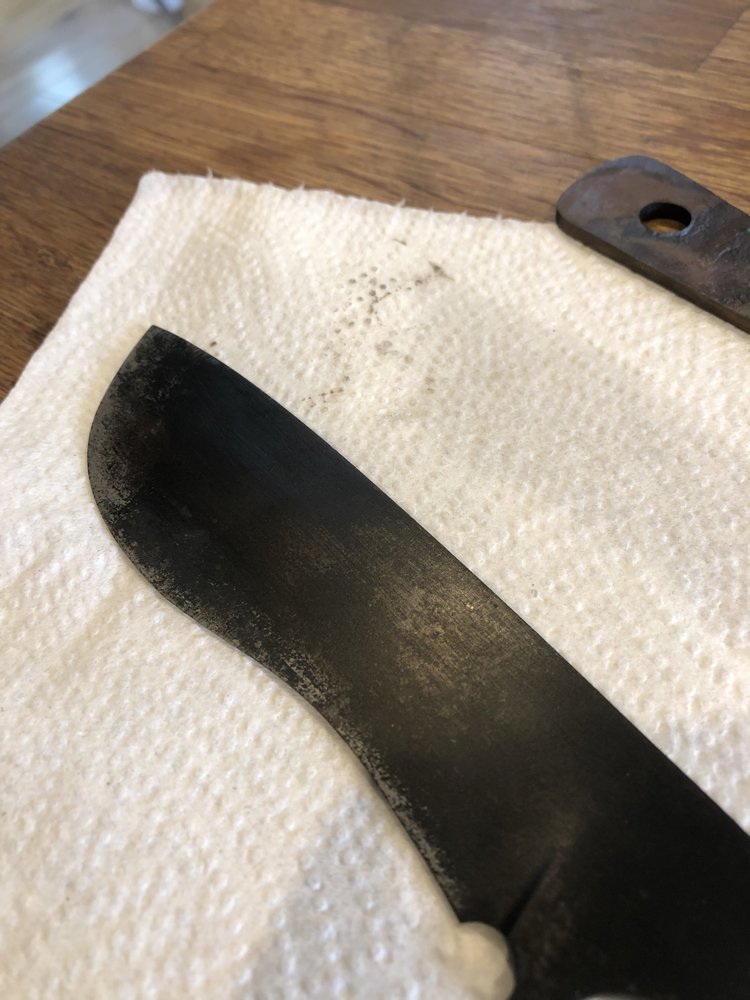

Well, that went badly. I did a normalising cycle and I could hear the coating ping off and cracking as it cooled. I should have cleaned the blades and stuck another coat on.
Got some dragon skin scaling. Getting very fed up with this game. Going to have to start again at 180 grit. Working without power, it'll only take a short eternity!
