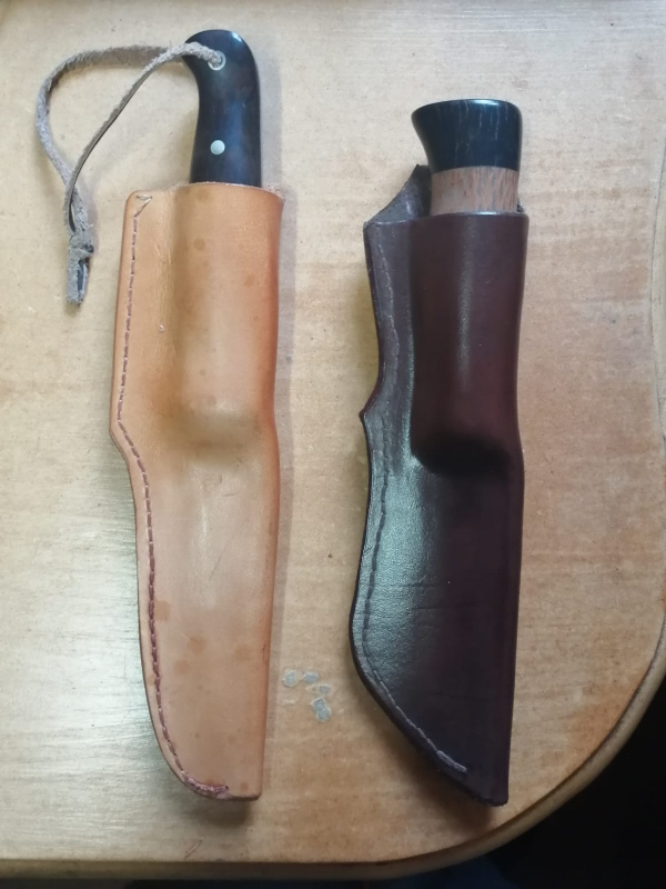

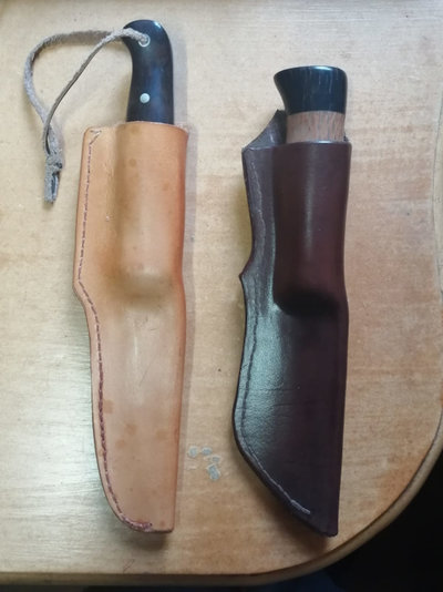

Thanks, I was in two minds whether to grind it all off originally, but I ended up just flattening the tips of the teeth and keeping the pattern.I like that a lotvery nice, the file bit just adds something to the look of the blade .
 I haven't done any knife  stuff for a couple of years now, probably longer I can't fit everything into my busy schedule being retired

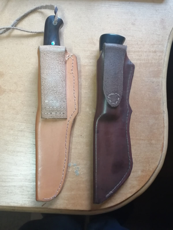

 Sheaths are something I'd like to get better at as well.
It's made from an old Nicolson file, hard all the way through. You don't need to anneal for grinding or drilling. For grinding a Zirconium linishing belt will remove metal quickly, aluminium oxide a bit slower. For drilling use carbide drills - the one I used is a re-ground masonary drill, don't let it get too hot or the braize will melt and the carbide fall off. I also ground a starting point for the drill with a Dremel prior to drilling.I always like file knives, how did you soften the file for grinding ?
Usually the old stamped (Made in India " files are cast steel. then hardened & tempered.I always like file knives, how did you soften the file for grinding ? I'm looking for an old file or rasp that isn't case hardened like the modern stuff, pity the farrier across the road passed awayI haven't done any knife stuff for a couple of years now, probably longer I can't fit everything into my busy schedule being retired

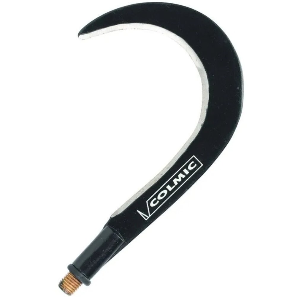

Not that I am into knives but rather more in need of a Reed cutter.
Most commercial ones are made of cheese and just do not sharpen enough.
What sort of steel would I get to make one. And where from?View attachment 364560
				Good luck with that, heat treating could turn it into a nightmare, it wants to be something thin and springyNot that I am into knives but rather more in need of a Reed cutter.
Different steels can need heating to specific temperatures, your method is a good rule of thumb if you can't tell the temp and you're not sure of the material. But I would never quench a thin edge in water. I heat treat hammers, axes and chisels daily and while I either heat them with a torch or induction heater thin profiles can easily crack in water, you might get away with it, but if you've spent ages working on a knife it's not worth the risk.Usually the old stamped (Made in India " files are cast steel. then hardened & tempered.
Hot Pony Shoes may have old farriers rasps if you ask him nicely.
