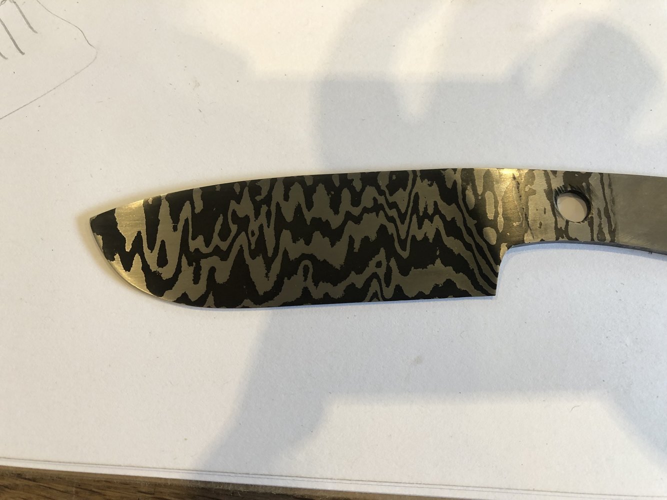

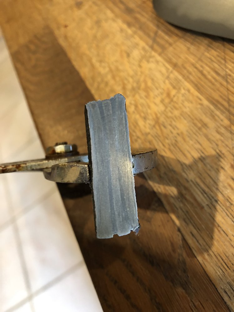

I might be lucky, just chopped the end off and chucked it in the ferric chloride for five seconds.
Looks superb. I really must have a crack at san mai...

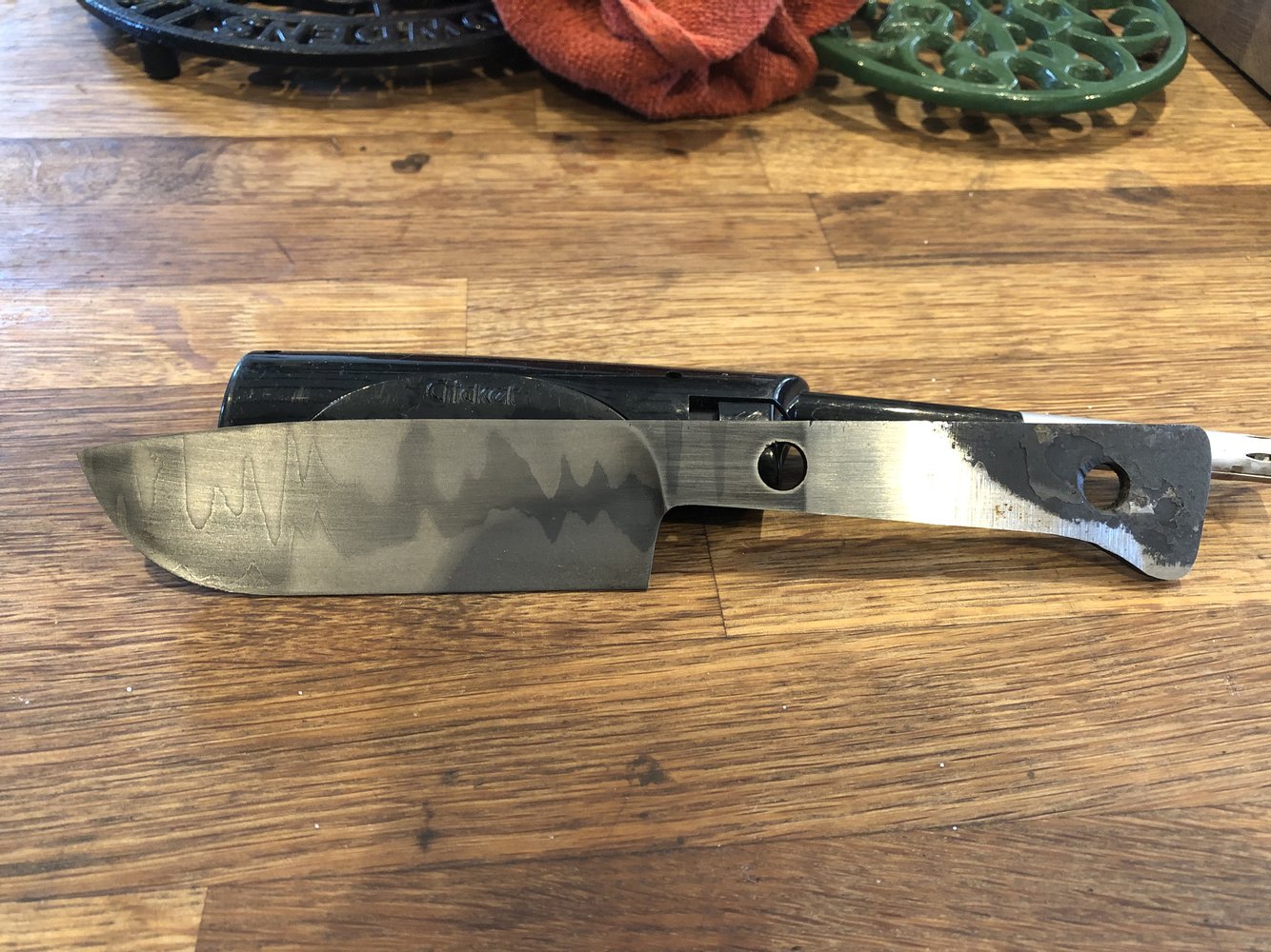

Lost my way with this one slightly!
That is now sanded to 1200 and is ready for heat treat. What is the wisdom on Normalising cycles? I now it is important if you are working with forged and hammered blanks. This is purely stock removal. Is it necessary?

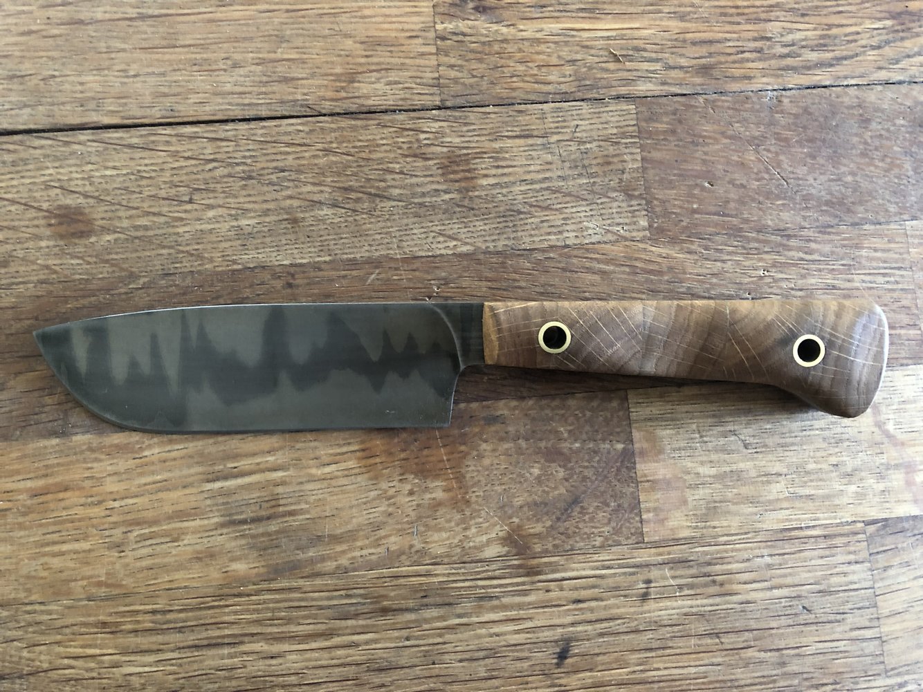

That looks really cool! A blue tinge will make it look like lightening (if such a thing is possible?)Well, I've ground the bevels, heat treated, hand sanded and etched my latest attempt. This is from the billet I made and posted a photo of on Wednesday. Heat treat went perfectly, hardened up in oil and tempered in the oven for 2x2 hour cycles allowing to cool to room temp in between.
It was originally 7 layers, 4 layers of 01 and 3 layers of an old file but I have ground off the outer layers of 01 getting it straight and flat so really what you see is the 01 has etched darker than the file. I didn't expect any contrast so I'm pleased. Handle needs a little more shaping but apart from that it's ready for scales.
