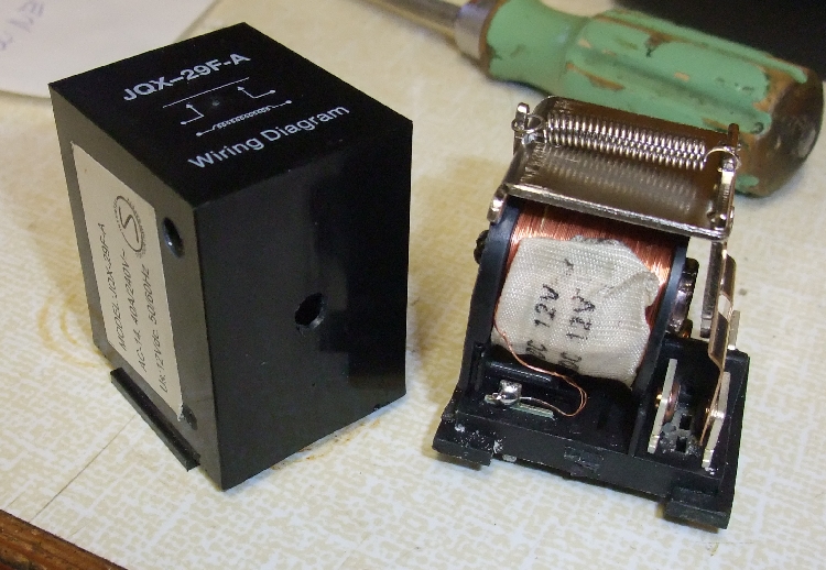

The problem is inside of the relay JQX-29F-A. This at least worked for me. The wire is open circuit in the coil of the relay.
When searching for this relay, I have found that no one provides them right now.

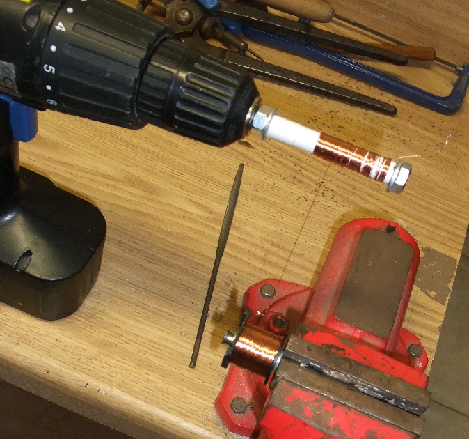

But the relay is easy to disassemble and rewind.
When unwinding the wire I have found water in the middle of the coil winding. The wire was kind of rusted at several points and at these points it was interrupted.
I think humidity soaks inside of the relay due to temperature change and can not get out. I made some holes in the plastic cover in order to keep humidity out.
Hopefully dust will not come in.
I hope this will work for you as well.
Good luck Martin
hi im new here just happen to buy ozito mwr 135 . mine is same it clicks no feed no spark i open these big relay and lots of moisture insode and the coil is open . other than rewind whats the other option?
