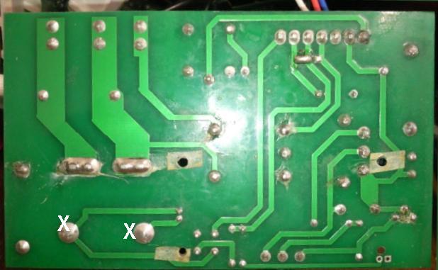

Yes ive metered the wire speed control... across the outer points there is a good reading... left outer and inner is 0 but increases when turned up and right outer and inner is 0 but increases when turned down
Yes i was able to remove the cover on large relay... which contact points do i replace, the two soldered to the board or the contact plate... shall replace if i can get hold of some.
Shall replace the bridge recitfier... tomorrow.
Checked both fuses on the pcb more than once and there fine.
