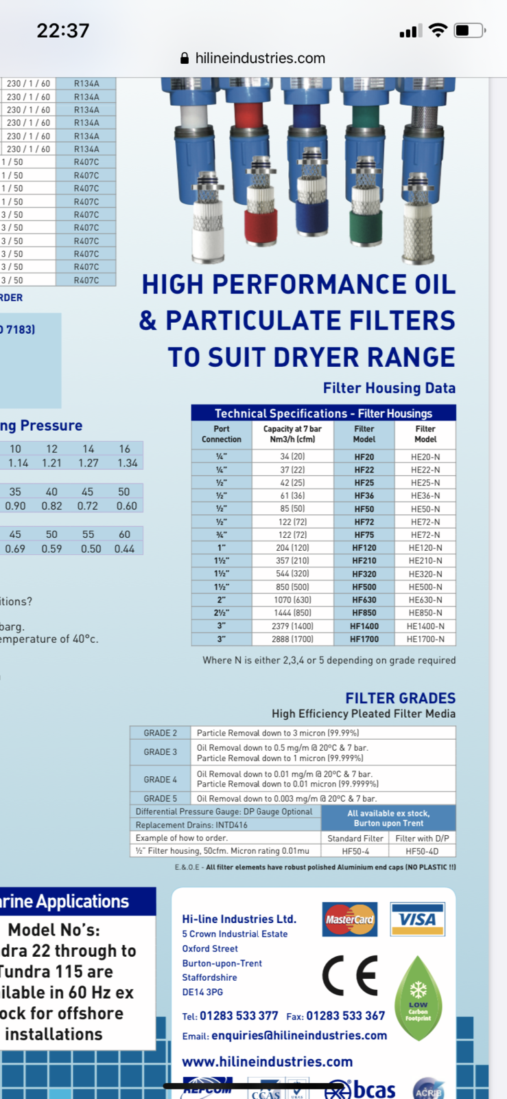

Meant to ask, do you just leave your dryer on all the time as the manual seems to suggest you have to start unloaded and it takes quite a while to start, 3 minutes or so I think it said.
Can you ping me a copy of the manual if you’ve got a PDF?Aye, good stuff and not cheap, well unless you get it for free
