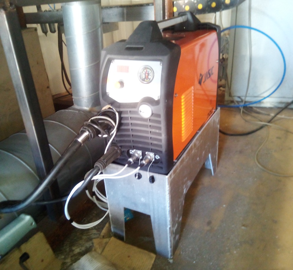

10mm Alu is probably pushing a 40Amp plasma a bit too much, especially if it is one of the cheaper types. I think I saw somewhere you said it was a 40Amp anyway but maybe I am getting mixed up.
My TecArc 65 was 28mm on steel but I found 20mm Alu was about the max it would play nicely with. I don't often do more than 12mm, occasionally 16mm and very rarely 20mm so it was fine for me, we will see what the Jasic can do in due course.
