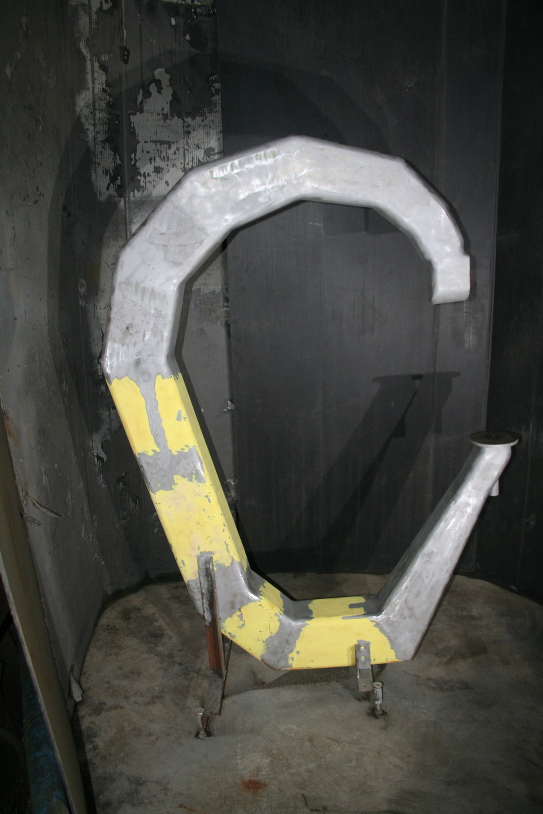

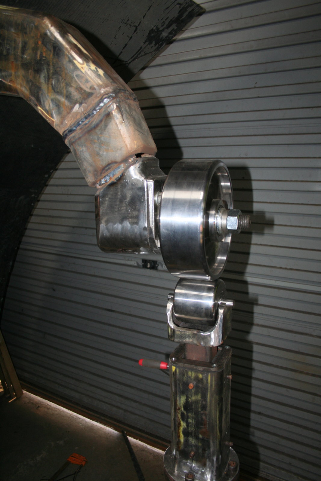

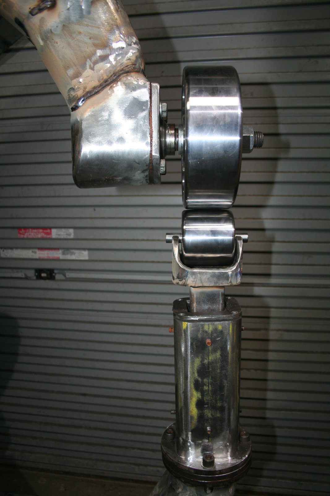

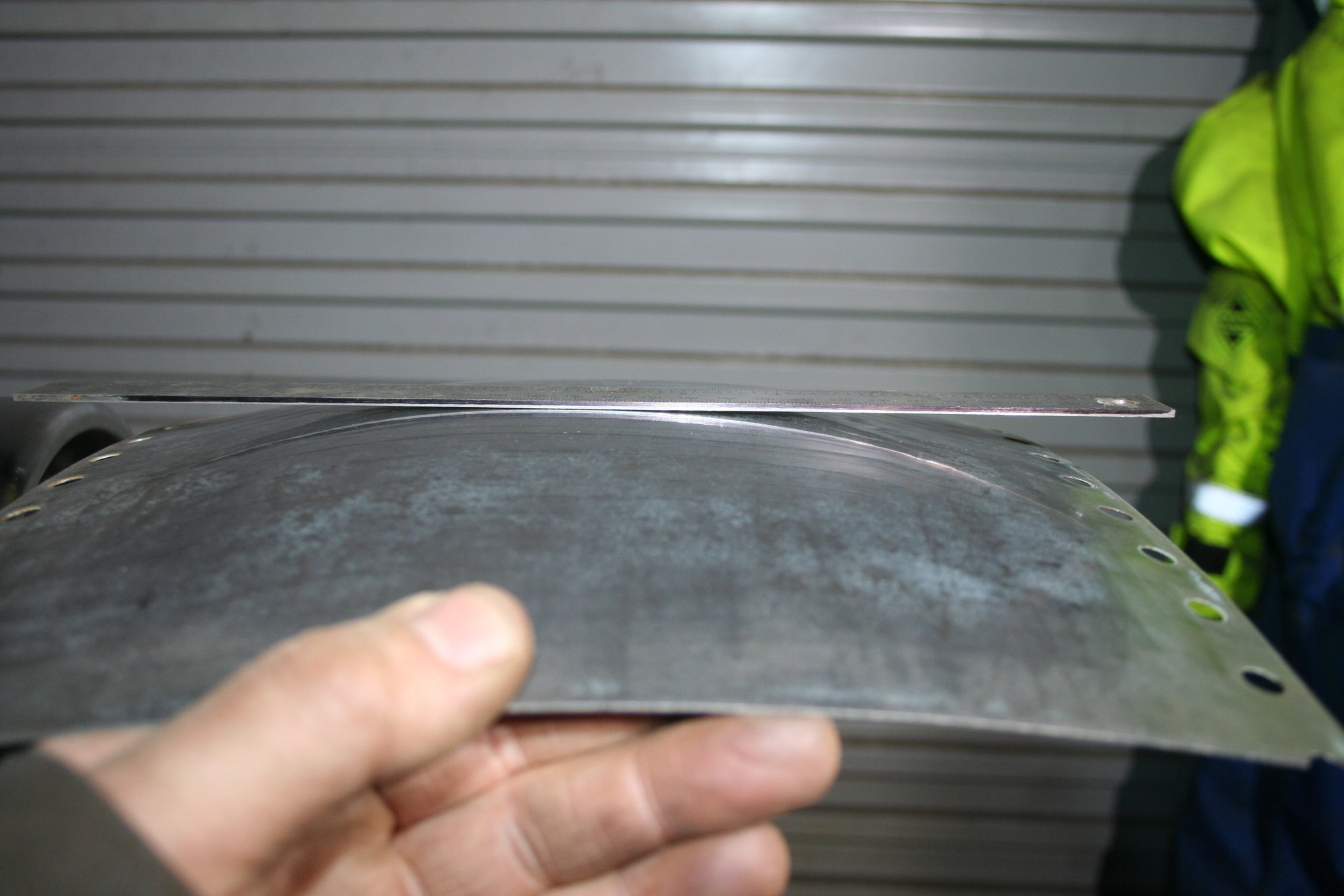

The platen wheel is too high up against the frame, you are going to have really really flat thumbs. I have seen some machines where the top wheel is adjustable too, time for a solution.
I did wonder about clearance to the left of the wheel for curvature. I know 98% of the time the panel is curving down but i have seen times when the panel has been put in 'upside' down for reverse curves. Admittedly my knowledge of using a wheel is a few hours at college 25 years ago, the rest has been the internet, which is reassuringly a reliable source of information
