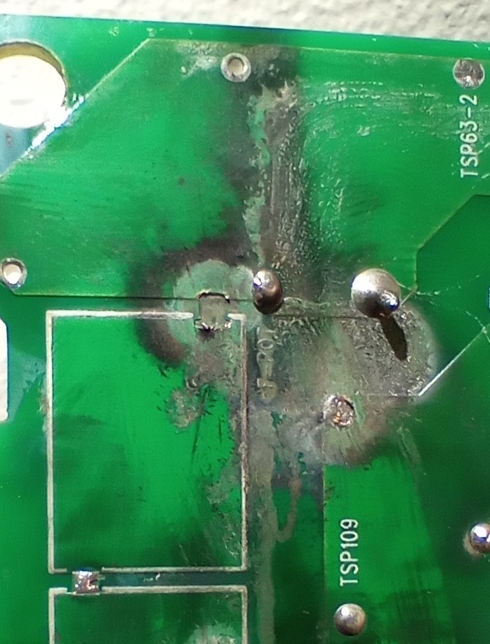

bit of tin foil would do it as it was in a chop saw i had a few days agoFitted the new bits. Did as advised and left the original legs on the board. Never thought I'd say my welding is better than my soldering but there you go. Had to fire up the 25W iron as the old CS18 struggled a bit.

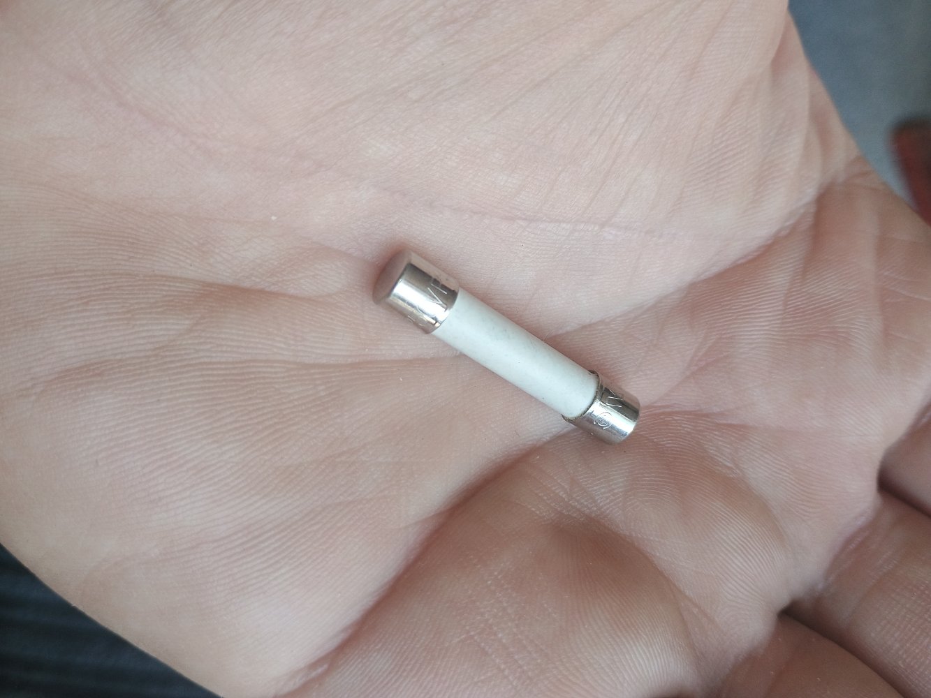

Went to put the lid back on and realised I'd not ordered a new 20A fuse!
Other than 20A/250VP it's also got "326" written on one of the end caps. It's white, like ceramic...HRC or something?
I had one similar in a welder and soldered a piece of fuse wire to the caps as a stop gap. I bet it's still in there.Fitted the new bits. Did as advised and left the original legs on the board. Never thought I'd say my welding is better than my soldering but there you go. Had to fire up the 25W iron as the old CS18 struggled a bit.
